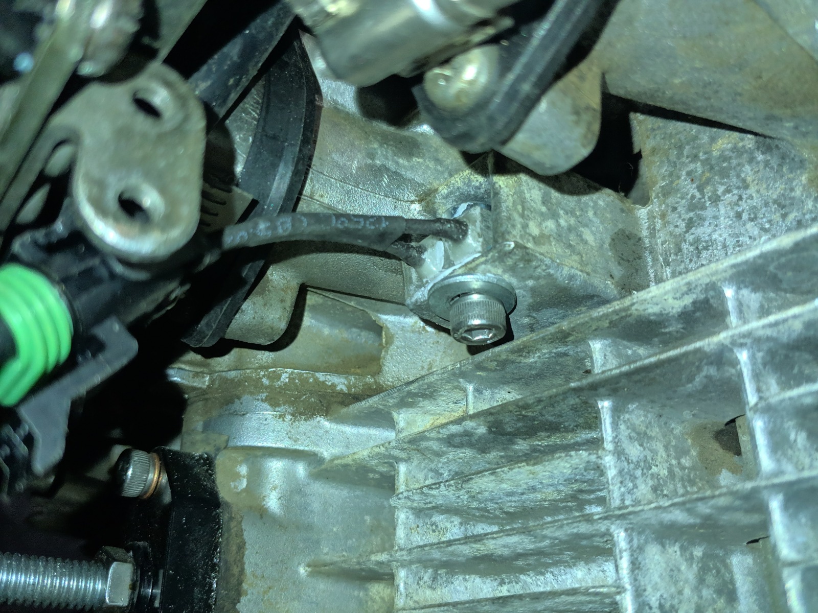

I also changed direction on the engine temp sensor. Instead of going off of oil temp I decided to use cylinder head temp. Crazy idea i know. Anyways, i bought some NTCDS3KG203HC4NB thermistors and potted them in little aluminum blocks. I mounted them in that odd little square feature between the intake runners on the head.

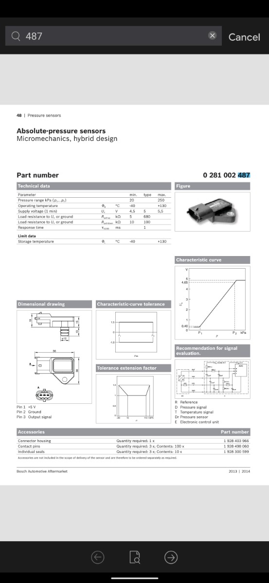

I made these slightly ugly vacuum accumulators and map sensor mount. Oh, also, i changed my map sensor. The GM 3 bars have a terrible response rate, so i got a bosch 0281002487

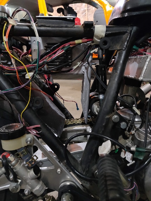

There are still a hundred things to do though.... none of the body is wired, fuses, relays, kickstand spring needs to move so the foot pegs dont hit, secondary fuel tank, that whole turbo thing. Back to work i guess haha.

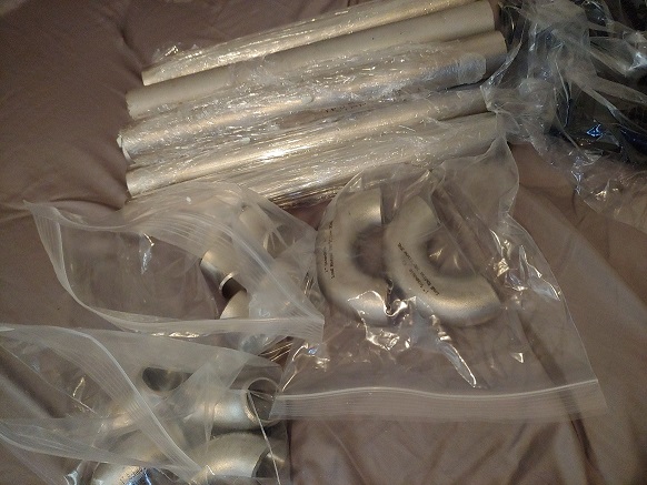

the exhaust tubing (stainless 304 sch10 1" nom pipe) and a few bends has arrived for the turbo header. still working on the turbo flanges and head adapters (Kawasakik1e is helping with these

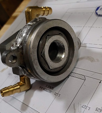

Made a turbo oil sump. The scavenge pump will draw from here. Kawasakik1e is trying out the mech scavenge pump, but im currently stuck with a facet pump as the 650 doesnt have a nut on the secondary shaft

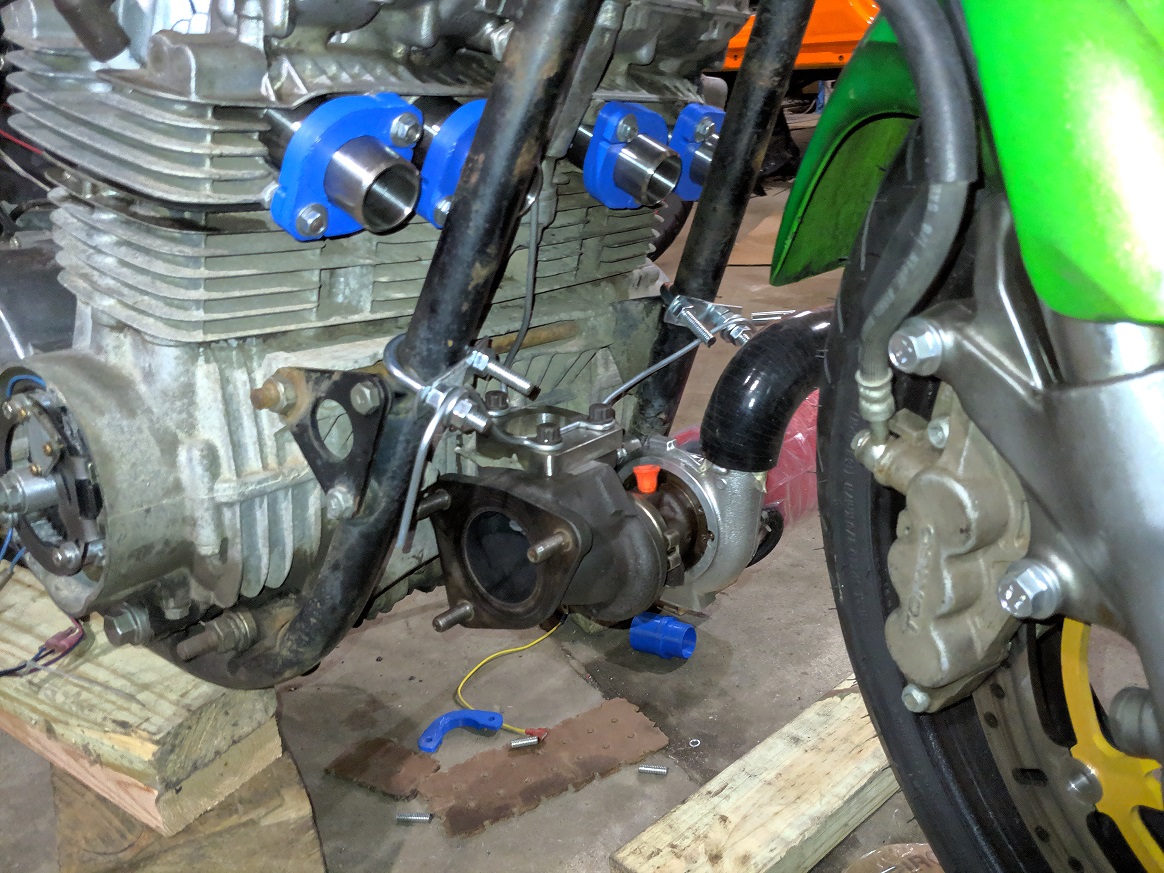

Turbo manifold is now done. I'm still working on the clamps for the head as the first version was not really weldable. Have more parts coming and I made a jig to get them right this time.
Boost piping has also been jigged up in the photo below... 1.5" 16ga aluminum. A 2" CLR bend works perfectly to get into the bottom of the airbox with the low profile breather cap. I lathed a little adapter that goes from that 2" CLR bend into a kz1000 boot (the same ones i used on the TBs... Its probably not required... a bead roll would probably be fine.
Put ubolts on the frame and used 1/8 steel wire to hang the turbo. Digital level used to get it aligned to the frame.
The lathed head collars and V1 clamps.
Close up of the header. this is 1" SCH 10 SS pipe and a few cast bends. Lathed collars for the head out of some 304 tube. Laser cut / machined turbo flanges. 1/2 for the inlet, 3/8 for the outlet. This guy was a pain mainly due too warping even with it bolted to the head and i tried to keep the heat down. the compounding merge angles did not help for sure. I had to heat up the header and put it in a stretch jig to get it back straight.

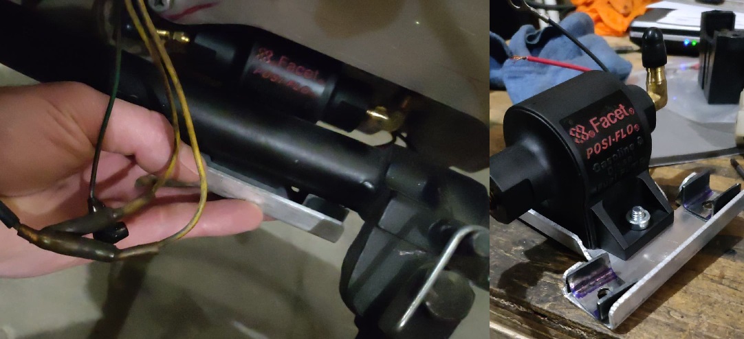

Made a bracket for the fuel stuff... 30u pre filter, e85 sensor, fuel pump and 10u post filter.

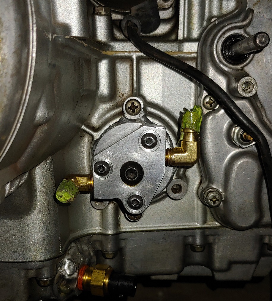

I also figured out oil line routing. The stator side galley has very little clearance (due to the stator cover), so i had to buy a smaller m18x1.5 to 4AN adapter to feed the turbo. The original banjo style fitting would not work.
Facet pump will return oil to the breather cover most likely. Its here or the clutch cover above where the kick start would be.
On timing cover side, any fitting will fit, so im using a 10AN m18x1.5 banjo style fitting to return the oil from the cooler. I originally planned a straight adapter and a 90 10an hose fitting but it sticks out pretty far.

Out of all the weldable metal alloys out there, stainless moves the most with the heat of welding. I can't imagine what you had to go through to get the head pipes to all line up again!! It gave me a shudder when thinking about it... great effort, dude!

that's good to know. I've seen so many people make headers out of these cast SS bends/pipe and I have massive respect for those guys now.... what a pain. I didn't know what else to use as i couldn't find anything with cast or pre bent bends in this size of tube/pipe. I would've been fine with mild steel and coating it.
Welding everything in sub-assemblies (runners, 4-1 collector etc) and then doing the final welds seems like the best way... so the long welds on the merges really killed me.
Keeping it on the head kept it within 1/4" so this is what i did to get it back in shape... all thread adjusters, a map torch, and some square tube to keep the collars in line

Excellent idea with the spreaders. On good source for stainless exhaust tubing is Burns Stainless. They carry many sizes and shapes of mandrel bent tube.

What I do to mitigate stainless moving is to fully weld each seam as I go. Starting with merges. That way any movement has occurred before you fit the next piece. super tight fitup helps too
