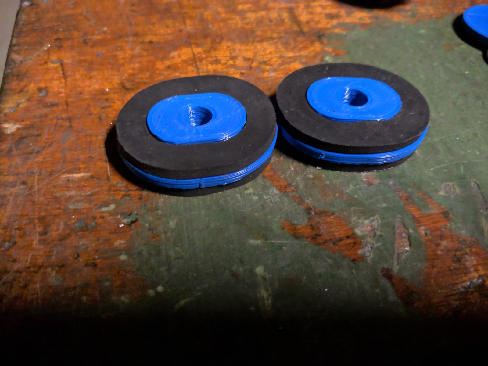

Also made some washers for the headlight bucket.
Jig for making the washers nice and smooth on the OD with a belt sander:
Completed washer assy. will need to make the blue plastic bit out of aluminum.

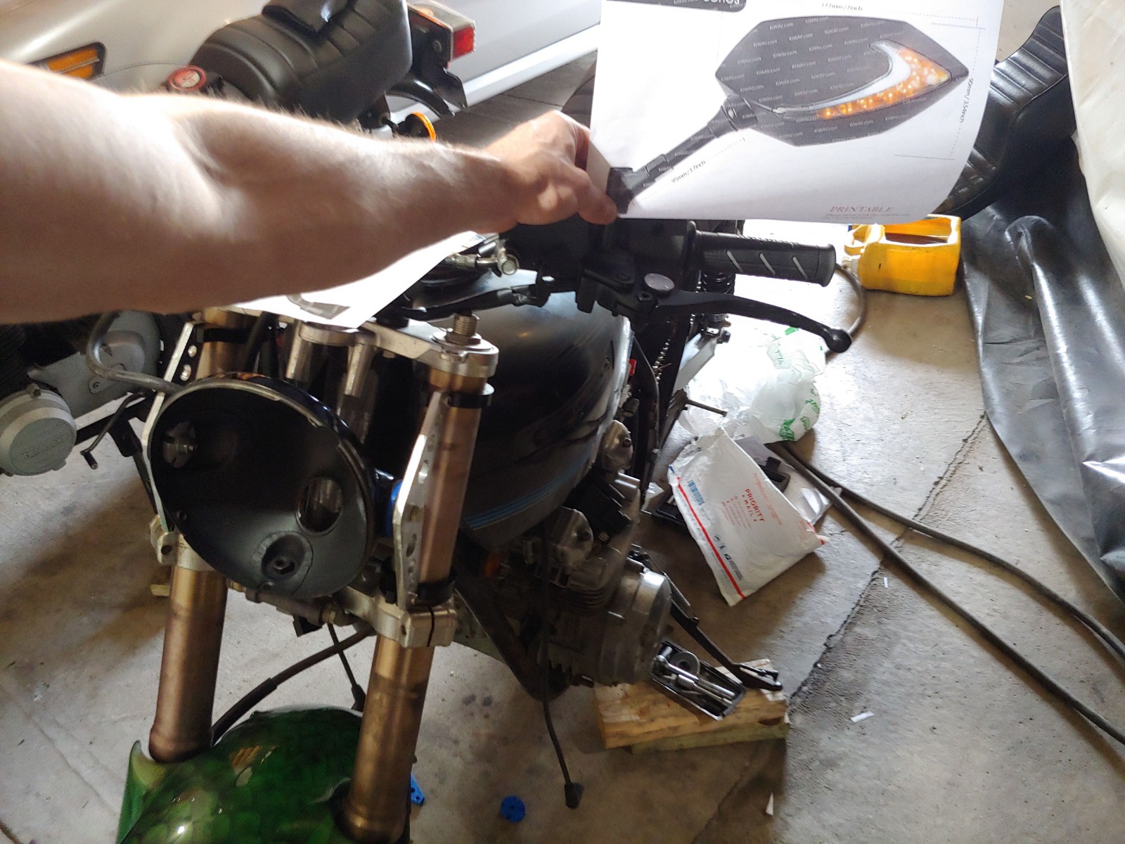

Also bought some mirrors. These are Kiwav Lucifer mirrors and seem to be of decent quality. Made in Japan.

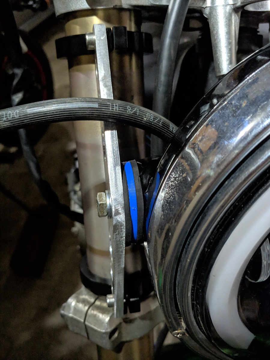

Made a headlight spacer with an aluminum base and plastic centering parts
No more ugly blue sticking out

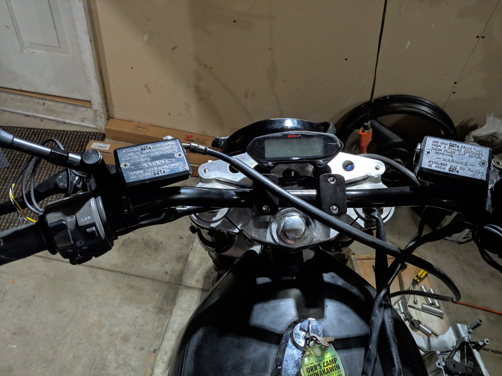

Made a mount for the Koso gauge
Rider view:
