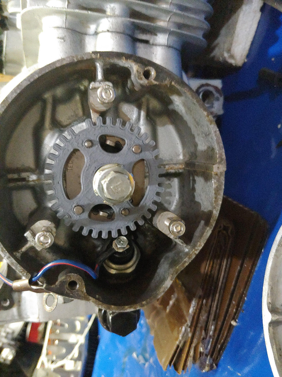

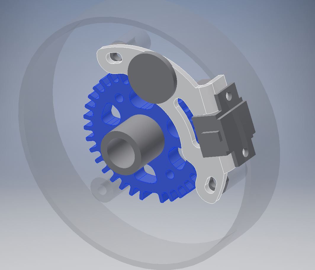

Here's where im at with the crank trigger...
Test fitting the 3d printed crank trigger wheel to verify my TDC offset. Im using the stock advancer base as a mount for my wheel. Now that i have an accurate model of the TDC offset, i could get rid of it for a completely custom mount. But it's also nice keeping the 17mm crank nut.
Model of the new bracket (white), trigger (blue), and existing mounting locations (transparent)
I'm hoping the wheel is large enough for the sensor to properly detect the teeth and gaps of the wheel... If not ill have to reduce the teeth down to 24 (currently a 36 tooth)
Magnetizing the sensor will also be a challenge. I plan on throwing a 25mm neodymium magnet on the mount plate and see what it does!
Edit: test fit of the brackets
