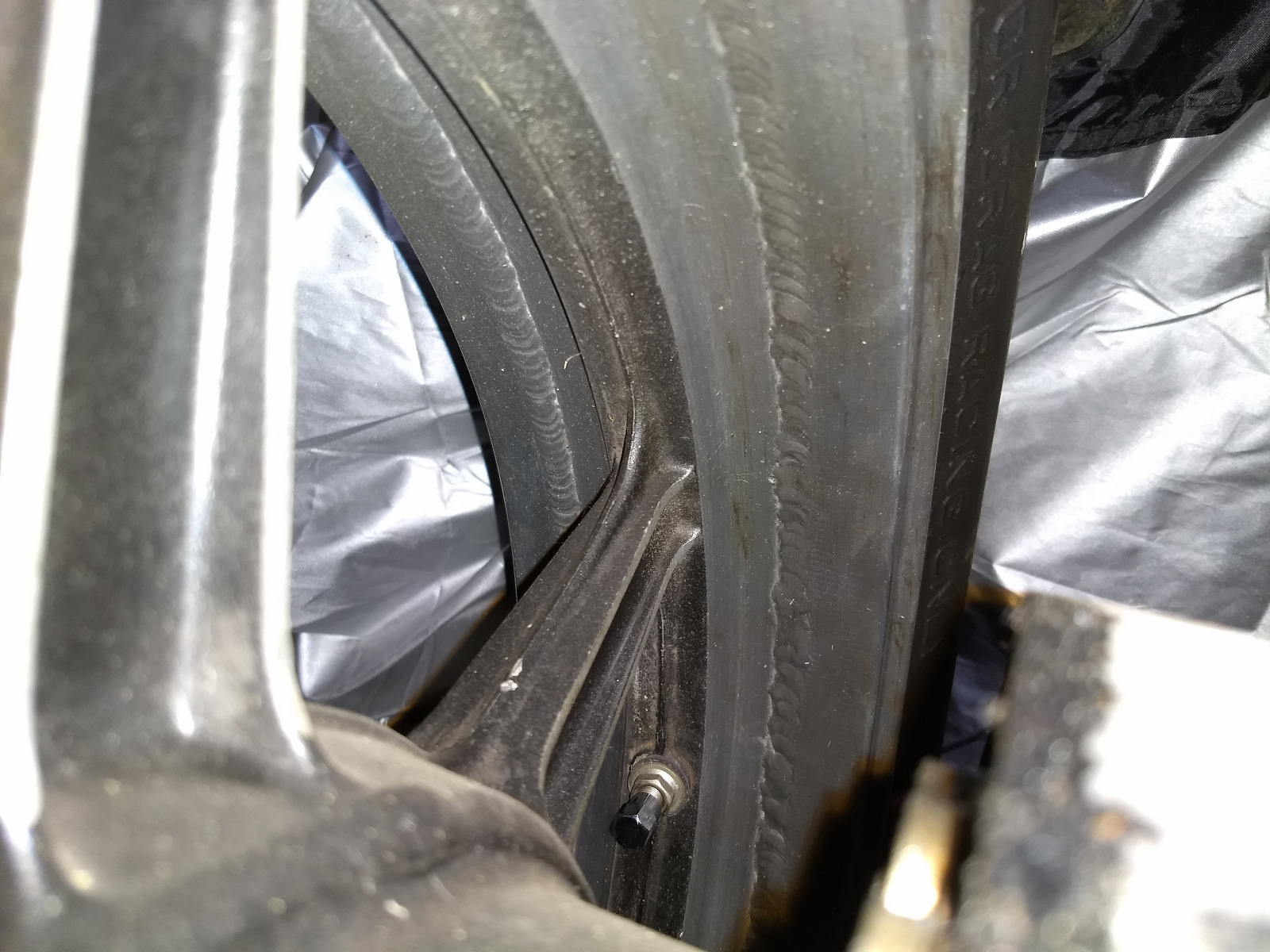

[Also, z1kzonly, I talked to my dad about his wheel. The first half was done by Puppet, just like yours. He ran it like that with the tire offset, and then later my dad and some friends did the other half.
WOW! Yes "Puppet" was an artist genius! He was the master fabricator! All by hand! That weld on the left looked like his work. We all had a saying. "Pup could weld stainless steel to toilet paper" Before CAD CAM Computers, Puppet Built Larry McBrides old Blue, he ran for 20 yrs. He Built Elmer Tretts bike when it was the fastest and quickest bike on the planet! And Jim "Da Judge" McClure's Harley that was the fastest HD Fueler.Wow memories! I might think of that! I am pretty sure it is the 2.15" I have to dig thru a snow drift to get into garage today! Our first real snow this winter! Ya' Buffalo's 1st snow! :laugh: :laugh:
[/quote]

There is a spoke rim that Pup built, that is an old legend, triple weld!! That I have seen!! "Mike Pugs" Mike Puglia was an old record setter 2 stroke racer bake in the day. He is hoarding it. And would never sell it. LIke I said way back Puppet built the jig for holding the pieces for welding. Then sold it to Paul Gast from FBG back in the day!
