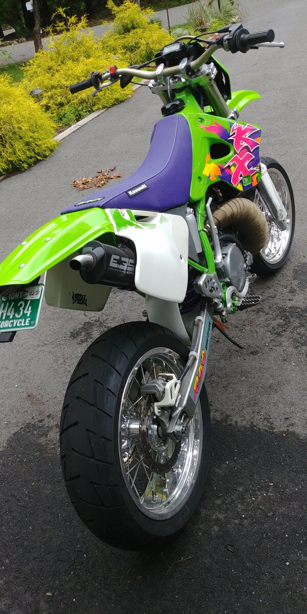

Besides controlling heat the wrap can reduce sound and give new life to an otherwise cosmetically ruined exhaust.
A couple notes, soak the wrap in hot water while you are installing it. Wrap from the back to front so you dont catch debris in the pleats. I think 50 feet will be enought. It took about 20 feet feet to wrap my 2 stroke expansion chamber. You can buy it on Amazon pretty cheap.
