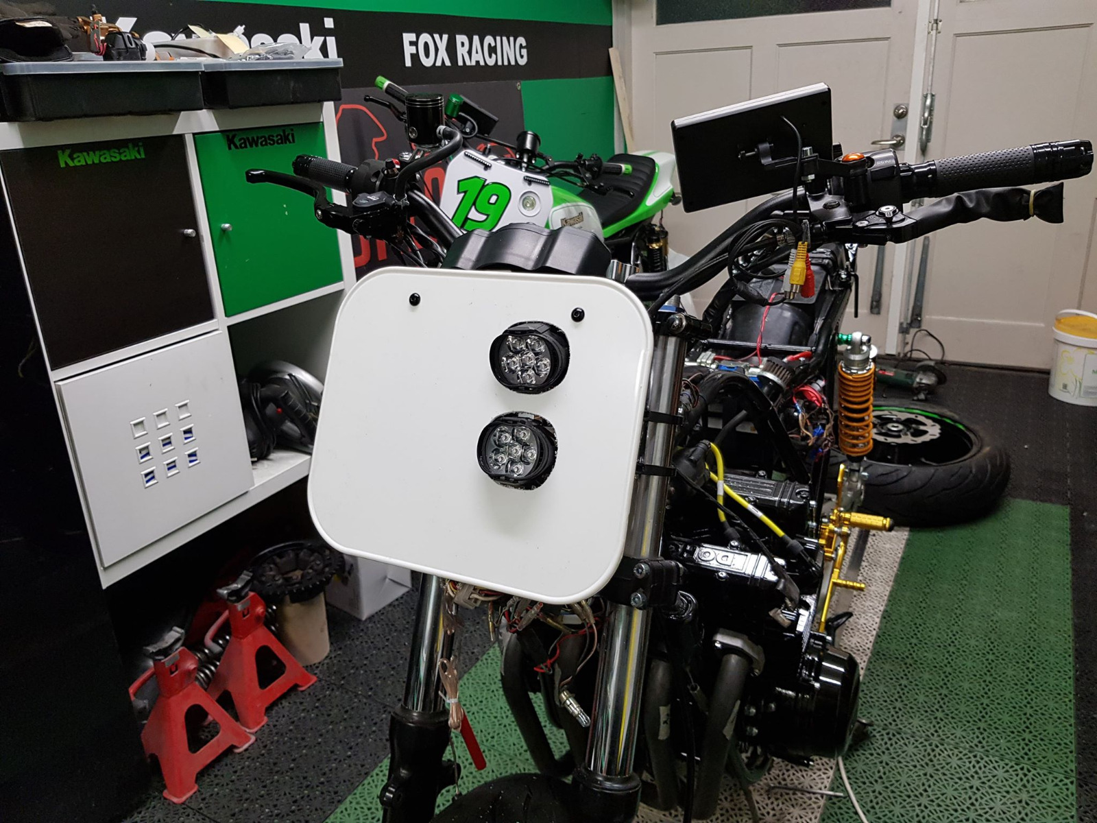

The front headlights will be like this. The plate will be Kawasaki green with number 21 beside the lights.

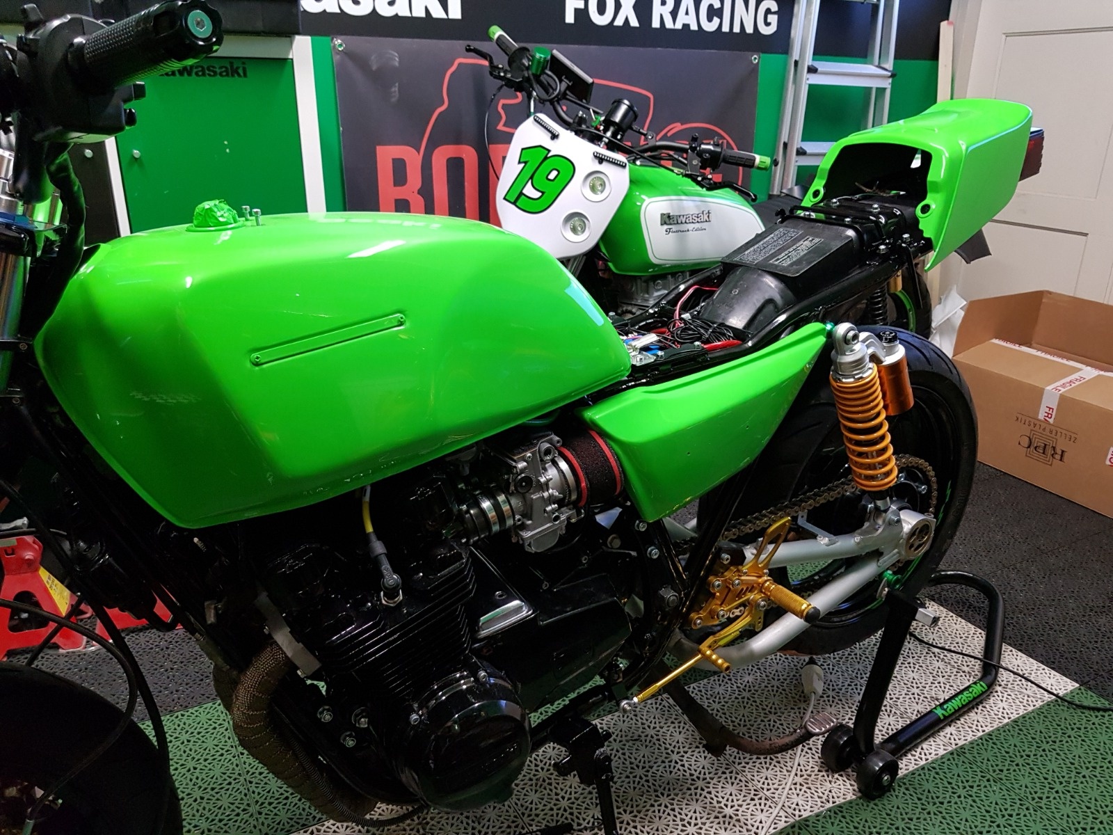

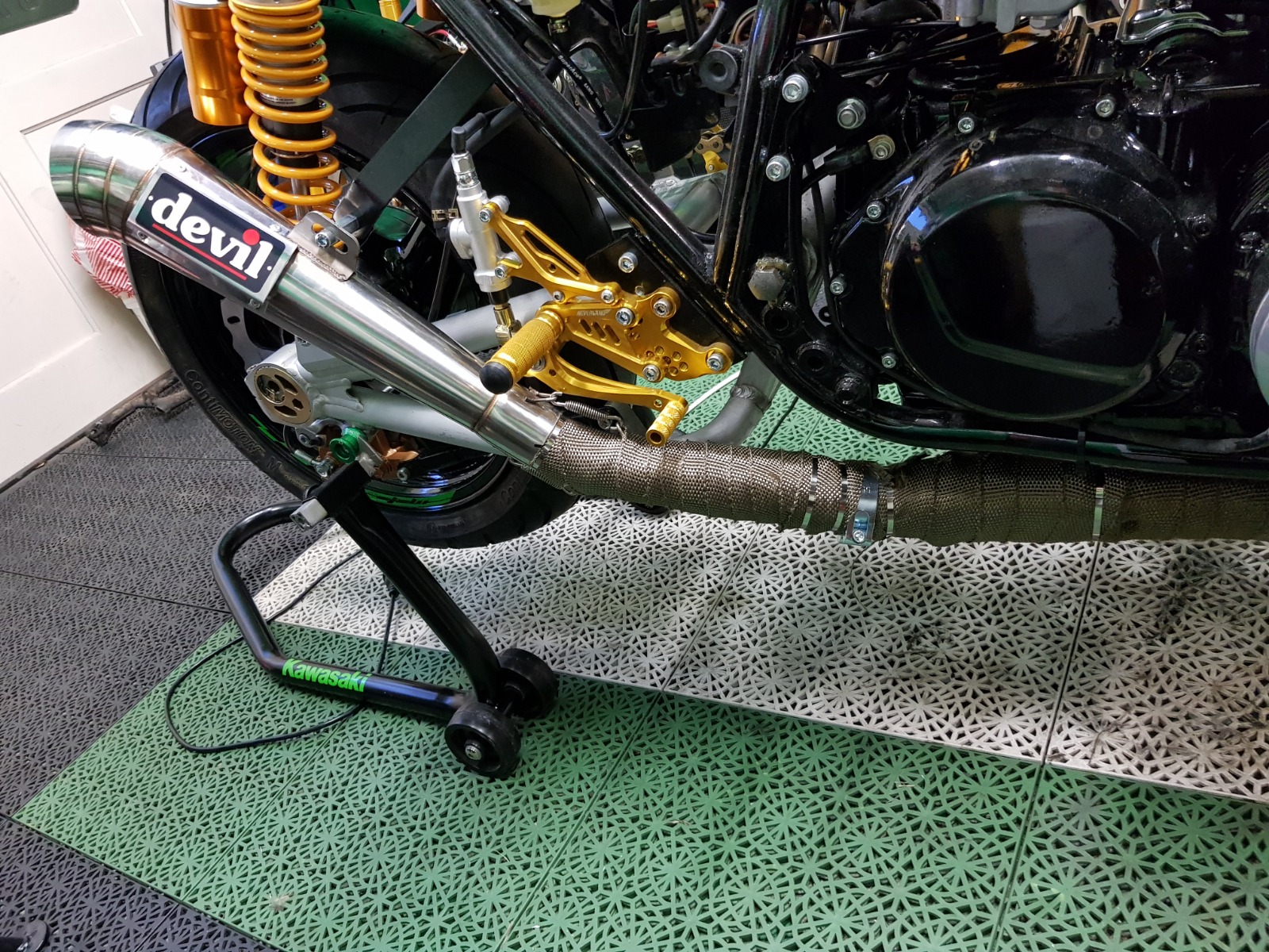

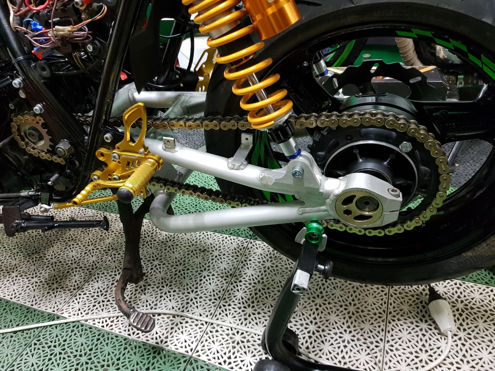

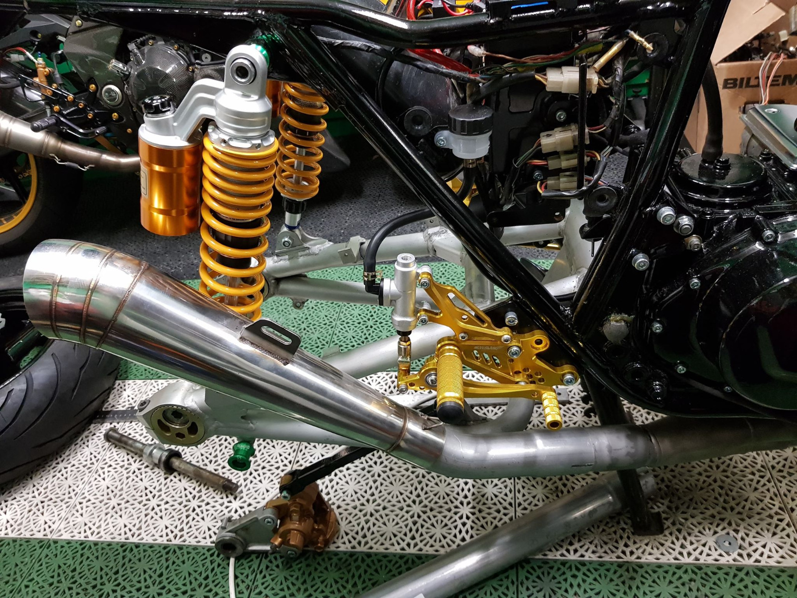

This weekend shell i weld the midpipe to the exhaust and line that up.
The swingarm is now complete and the sprockets are in line. Mounted a 3/]8" offset front sprocket and turned off 9mm of the rear hub. [attachment=131491]82245735_568315917345190_2454830506974380032_n.jpg[/attachment

Two questions - what brand are those rearsets? And where did you source those rear shocks? Part numbers would be helpful. Thanks!
Retired gearhead
'81 KZ-750 E2
  • foxkawa
  • foxkawa's Avatar Topic Author
  • Posts: 33
  • Thanks: 6
Re: Gpz750 1982 will be a Eddie Lawson replica. Almost :-)
15 Jan 2020 11:22
#817136
Skidmark wrote: Two questions - what brand are those rearsets? And where did you source those rear shocks? Part numbers would be helpful. Thanks!
Both rearsets and shocks are from ebay.
I don't have any brands on these. The rearsets is to a cbr600rr and are bought from China.
The shocks is 360mm between the mount holes and are bought from UK.

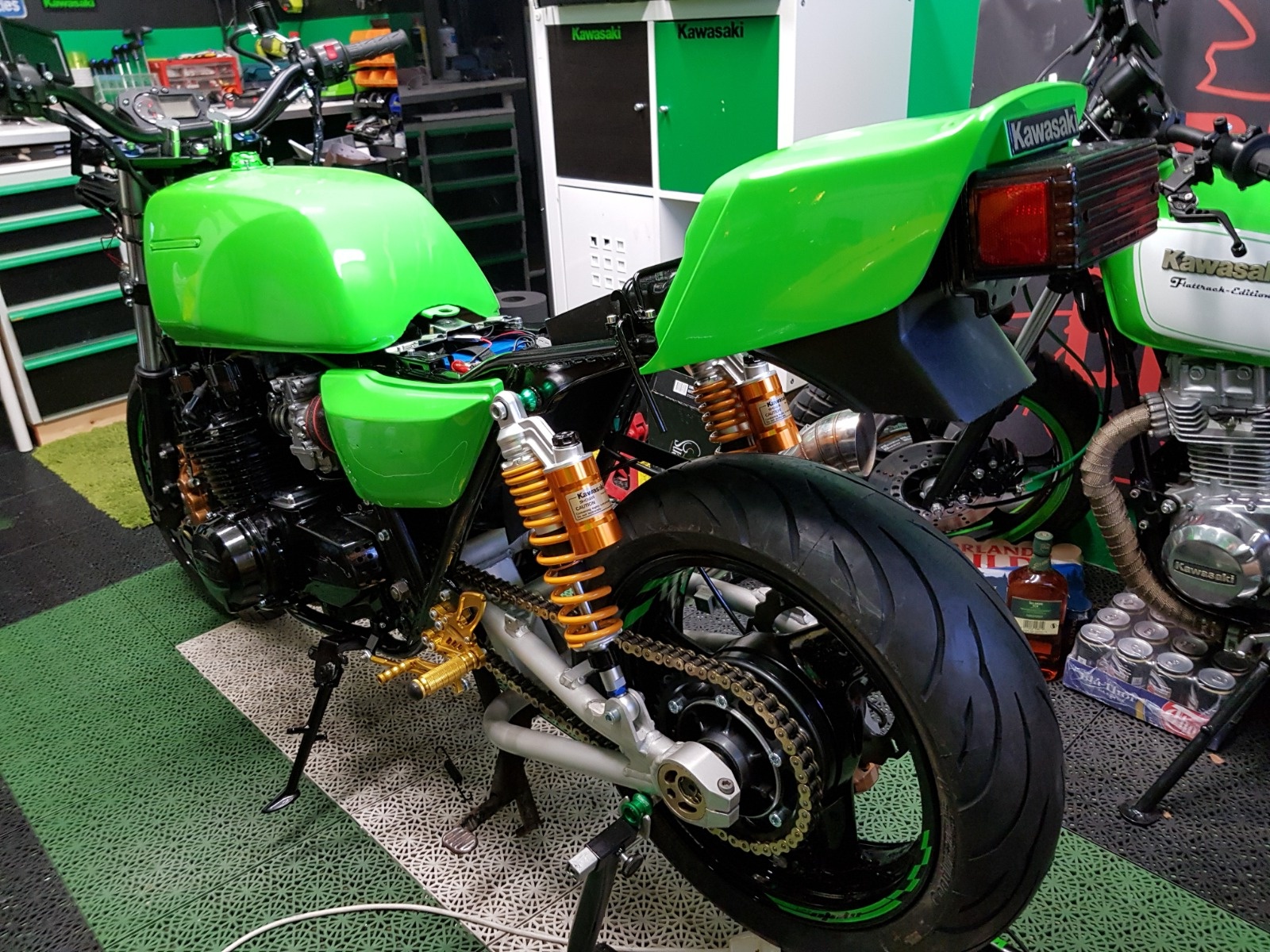

First coat of kawigreen painted. Now it's time to sand it and then draw the lines for the fields who shell be blue and white.

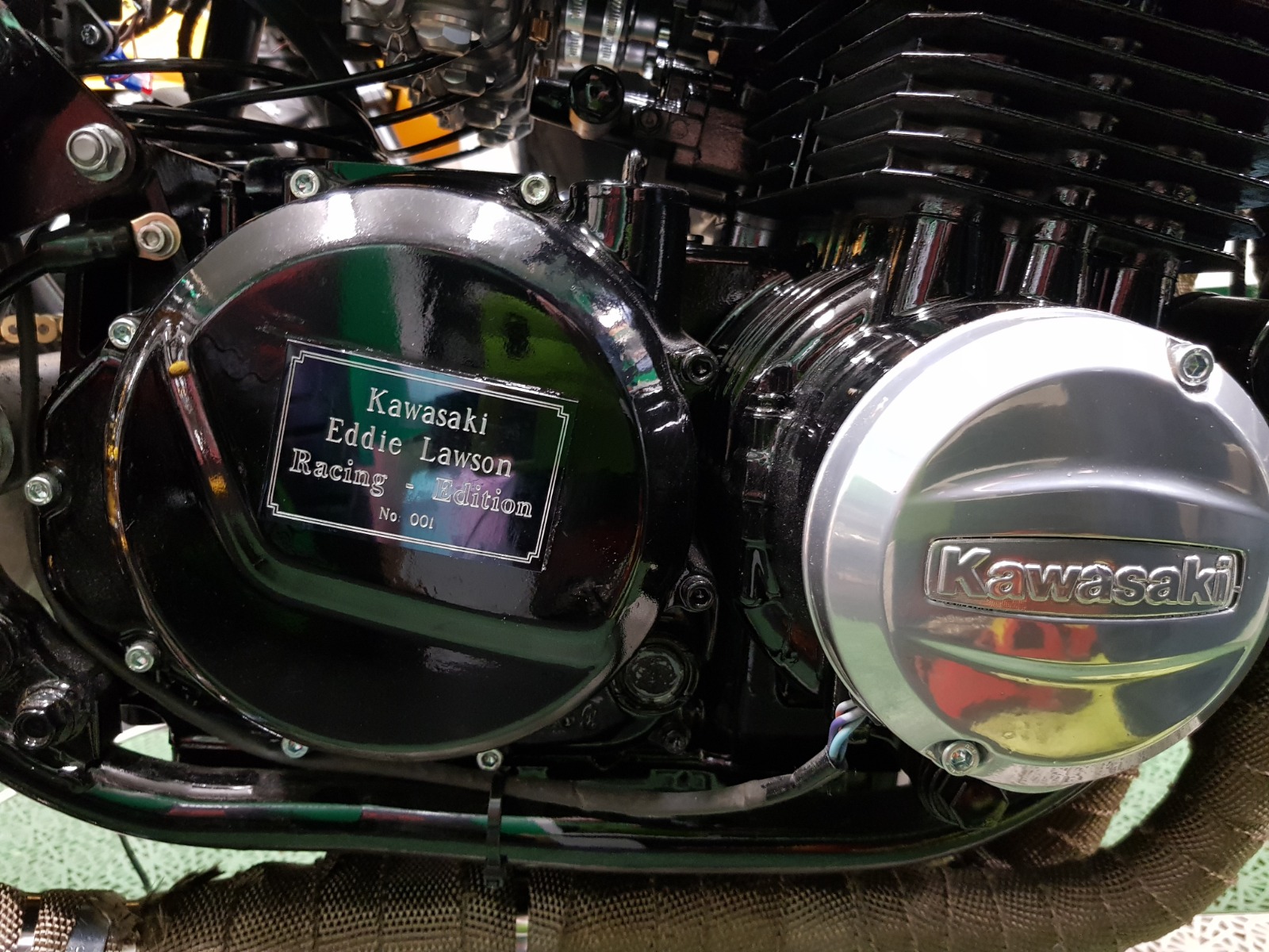

Just the finishing touch left. Got a plate that i put on the clutch cover.

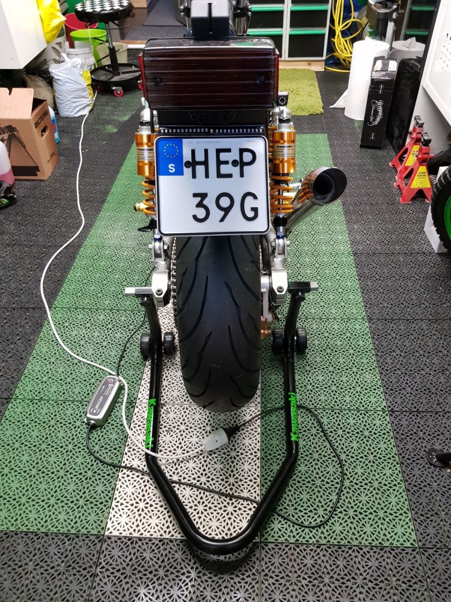

The look from behind with the license plate mount. Also the exhaust is finished and mounted.

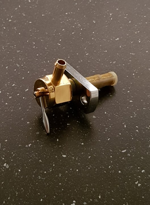

Got a small package today. It was a pingel petcock with an adapterplate.

Hi Jan.
If you are going to ditch the old fuel tap I am happy to buy it as I restore them.
/Anders
