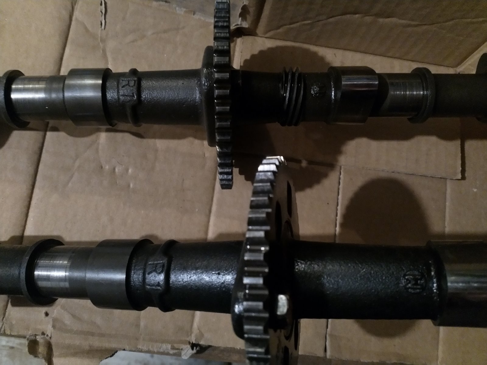

Need some help on this one. Apparently, the cams have been swapped out on this bike. I can't confirm this as this is the first KZ I've taken apart (first bike for that matter). I checked the cams and they have a capital R (exhaust) and S (intake) stamped on one side and a capital M in a circle as well as R1 stamped on the other side. There are no other discernible markings.
Tried searching for some info but came up empty (or rather, got so many results that I can't find what I'm looking for). Can anyone identify the cams for me?

Usually the R1 cams are Kawasaki and come from the GPZ models but they don't have the tach drive and the R1 is not stamped like the one's you have.

Thanks. I did see some Z 750 GT cams on ebay with R1 (intake) and R2 (exhaust) stamped in the same way as mine. These had the tach drive (didn't know the GPz had an electronic tach). Leads me to believe that these cams have been pilfered from another 750 model.

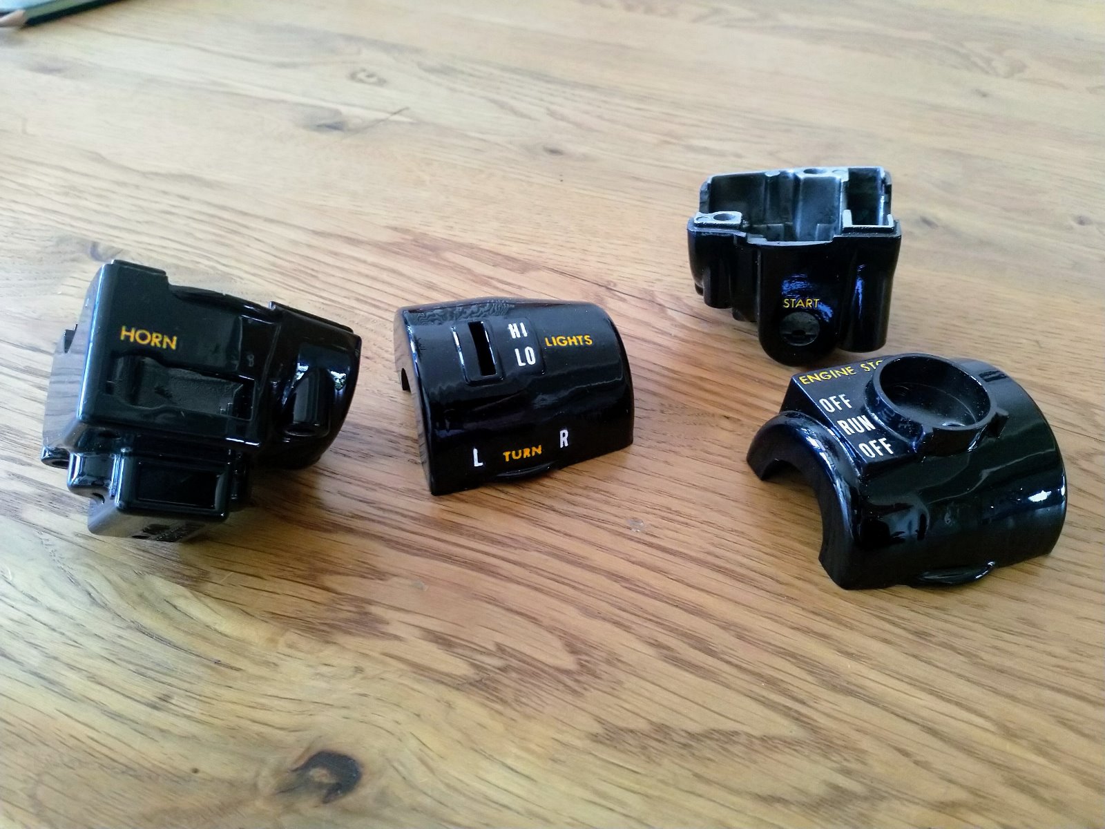

Really nice job on the handle bar control housings.

Thanks Mikaw, could never have got them looking like that without yours and asphalt900's tips!

Kidkawie was my inspiration to try it. Thanks for the kind words but I would not have tried it without his original post.
