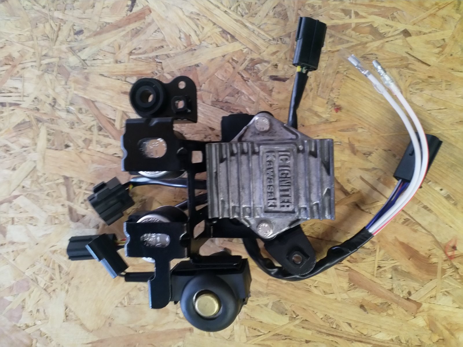

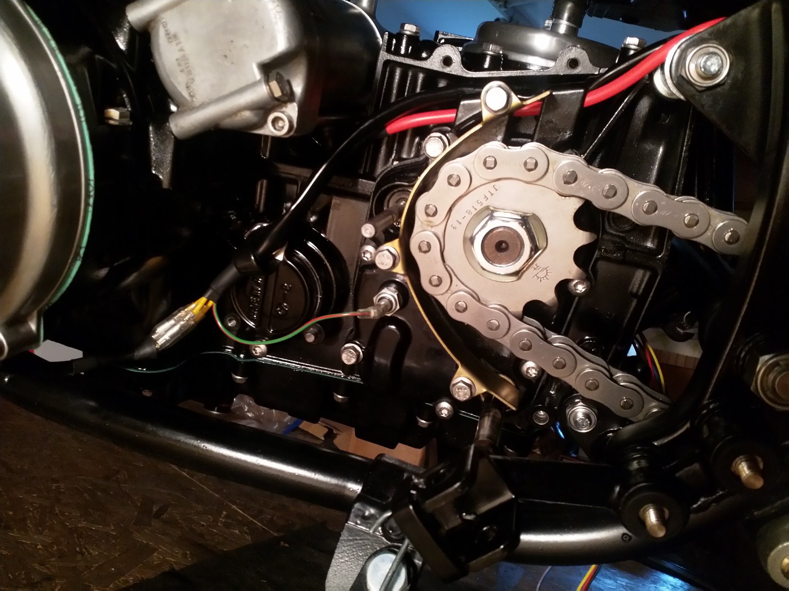

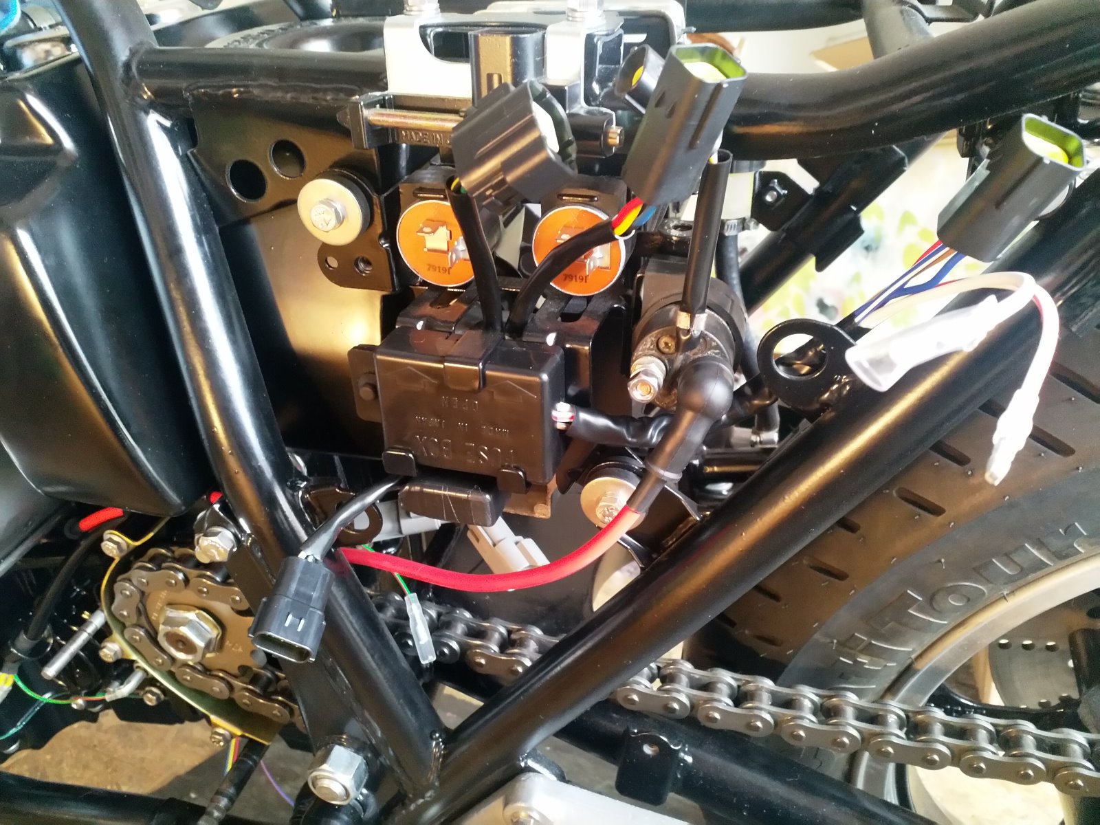

So, getting back into things - finally. Got all the parts I need to start her up now, so just need to get to work. Started the wiring today. Got the rectifier, alternator, neutral switch and starter wired up. Took a while to sort out all the wires and connectors - everything is getting replaced, so I have a load of stuff. Put two 3-pin plugs on the rectifier so I can easily separate the alternator. Will get the plugs on the igniter, brake failure sensor and fuse box replaced tomorrow and wire it all up.
Here's the wiring under the sprocket cover (I now realise that I need to route the wiring under the engine mount spacer if I want to get the sprocket cover back on :rolleyes: ):

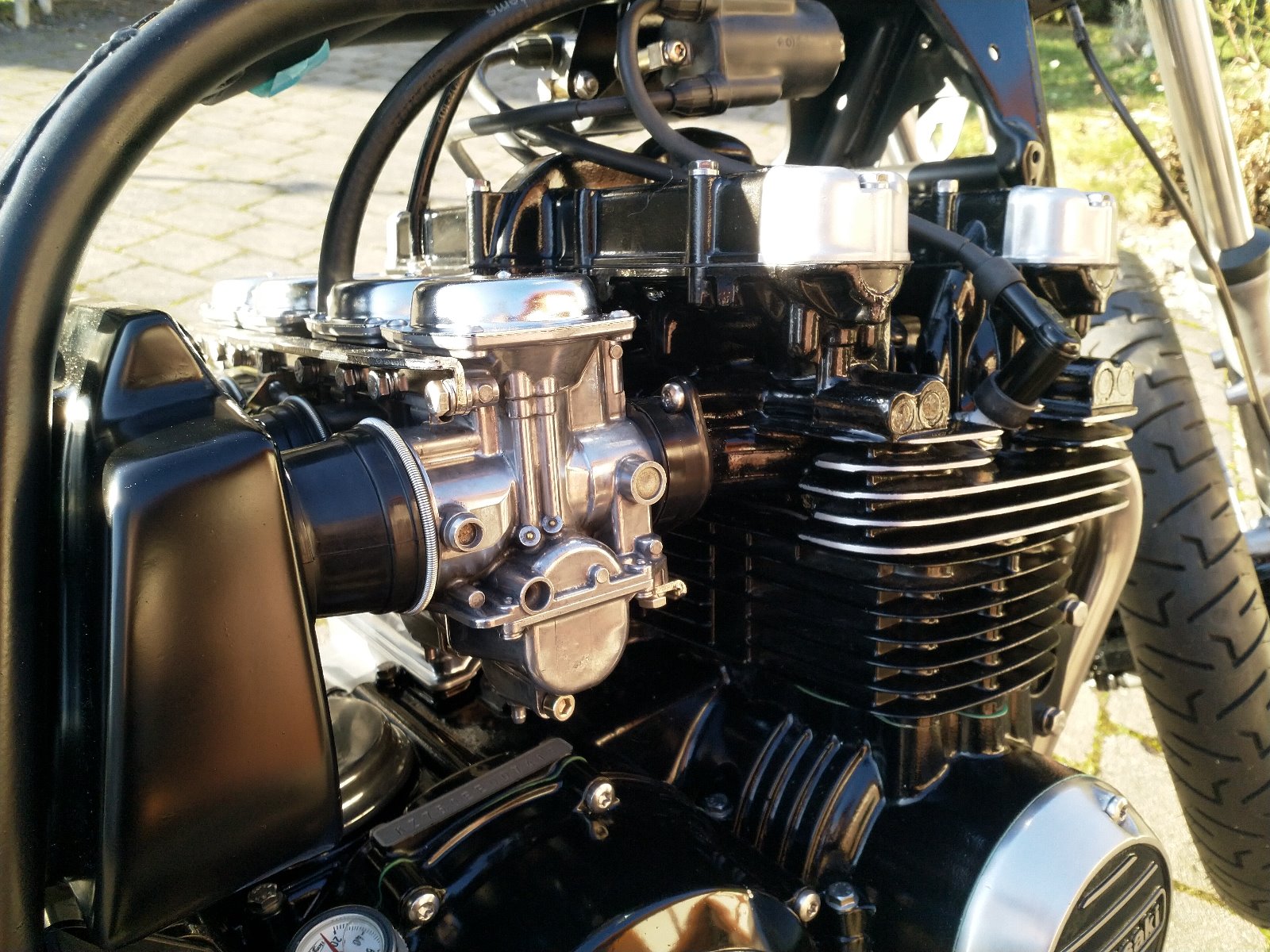

Nice work on those carbs, they look better than OEM.

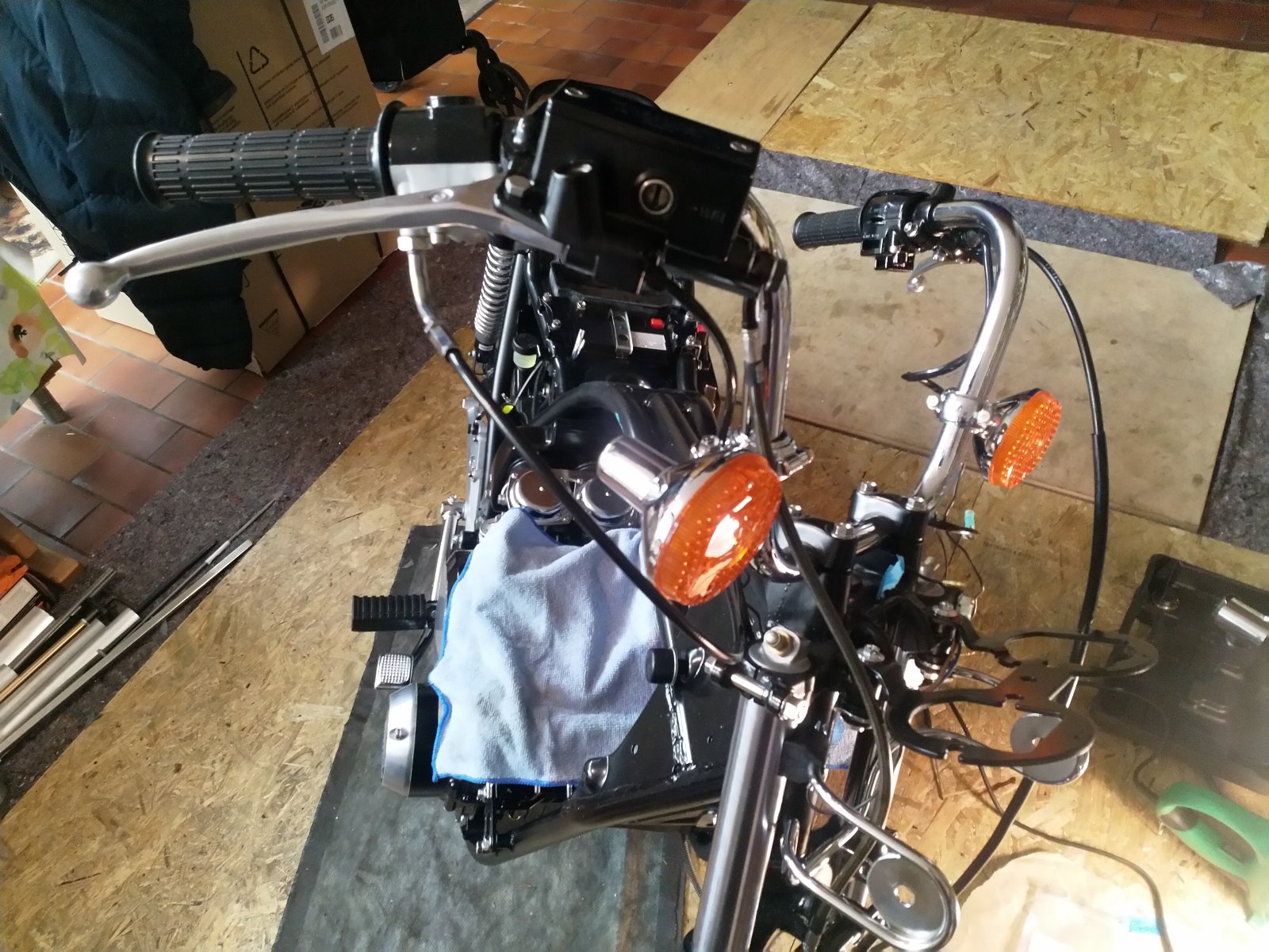

Got a bit more done today. Tried to get everything sorted out so I can do the main wiring harness in one go. Got the front indicators on and the brake and clutch switches. Mounted the backup set of controls (just the empty housing) so I could get the spacing for the master cylinder and clutch bracket sorted. Hopefully the headlight housing will be back this week so I can get he meter and ignition connectors done.

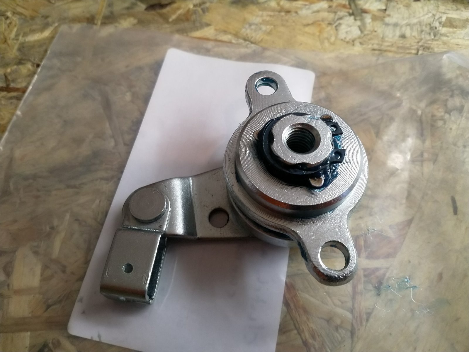

Got the clutch actuator reassembled and the sprocket cover back on. Finished the last of the wiring prep as well (ground cable, reserve lighting device and the rear brake switch). On to the main harness on Wednesday (my day off).

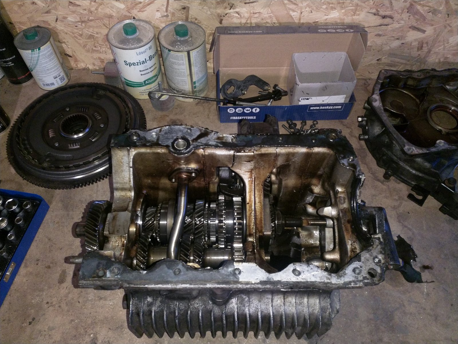

The other project is coming along as well... Will leave it until next weekend to replace the sync rings so I can just work on the bike on Wednesday:

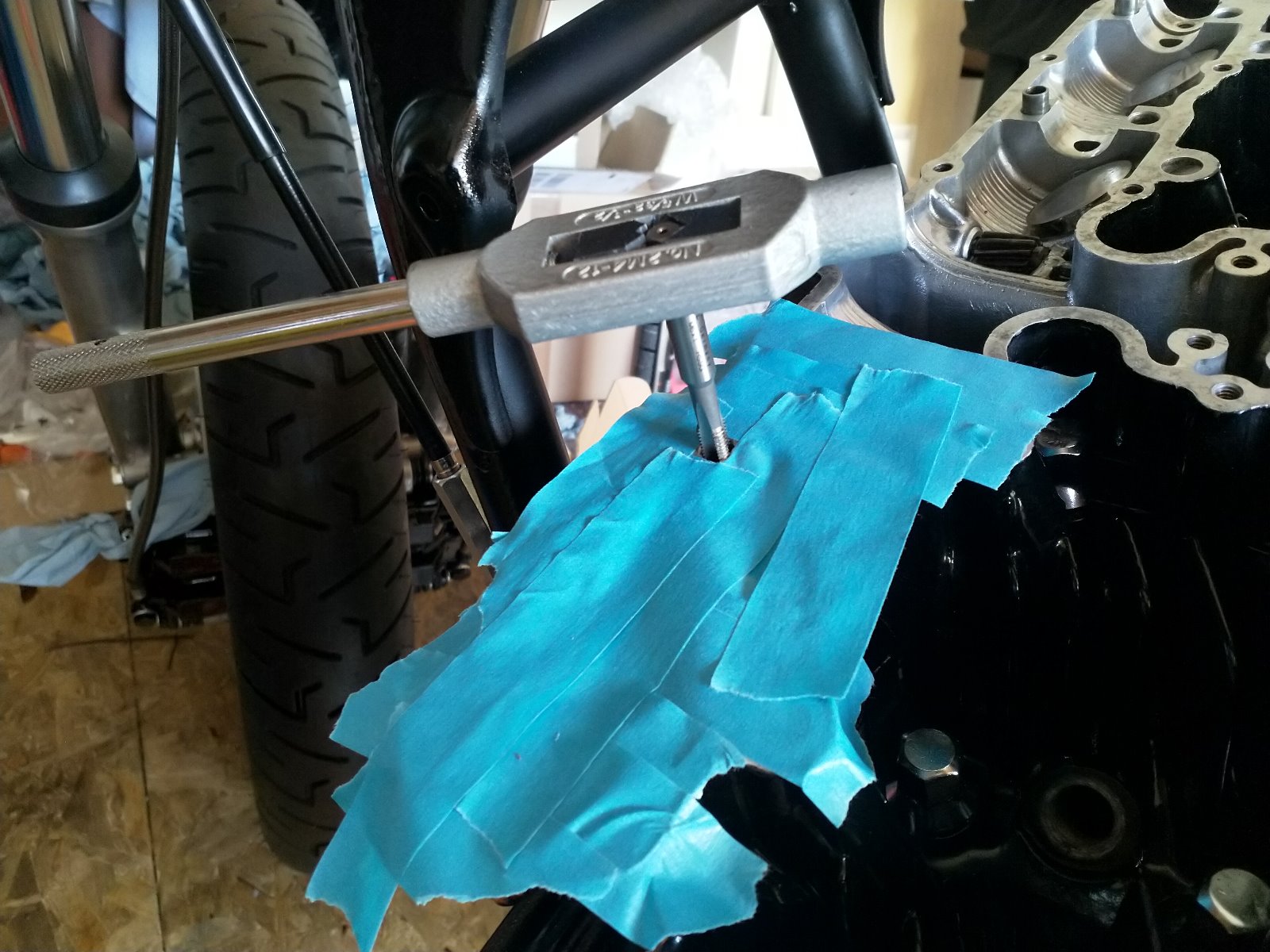

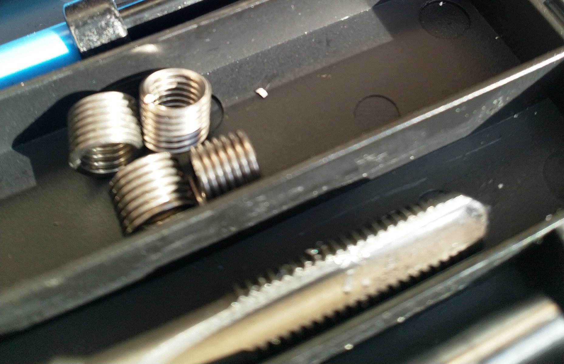

Did some repair work today. The threads for the cam cap bolts have taken a beating over time. Two of the threads couldn't hold the 12 Nm torque when I checked the valve clearances the first time, and two more went when I put the new shims in last night. Helicoil time:
I taped up the area around the holes and used the vacuum cleaner to suck out all the shavings. After the thread insert was in I blasted a bit of compressed air in to get the last of the crap out. I had a brain fart on the second hole and blasted with compressed air before vacuuming the shavings out... Metal shavings went everywhere! The camshafts were covered but the spark plugs weren't in. Looking at the distribution of crap around the engine one or two tiny shavings may have gone through the hole on cylinder no. 4. I figure that a tiny aluminium shaving (like the one next to the m6 helicoils in the picture) will be dealt with pretty quickly though and shouldn't do any damage - am I wrong?

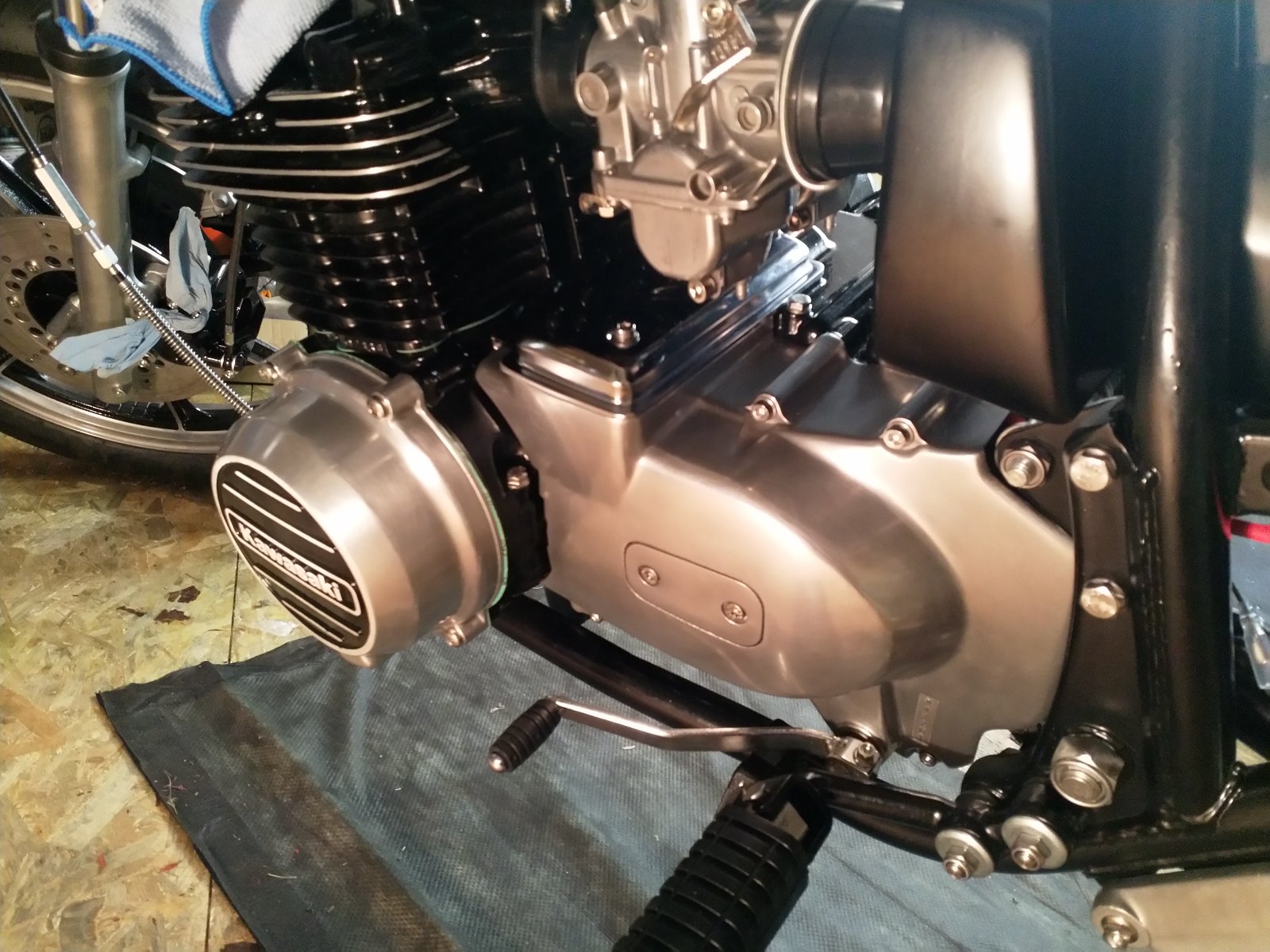

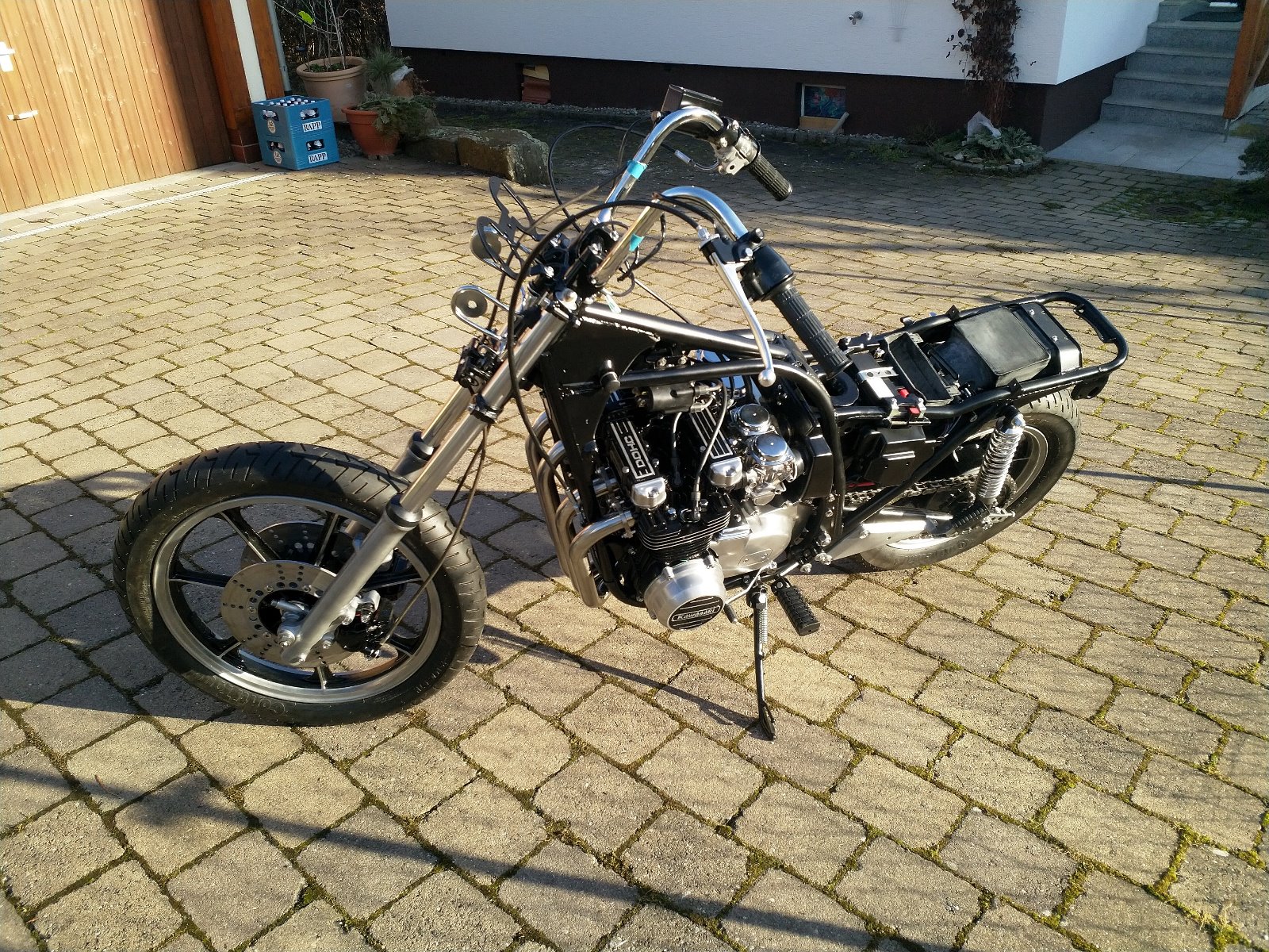

After the valve clearance was done I got everything assembled ready for a first test run. Still need to do a bit of wiring, will hopefully get it done on Friday or Saturday.
Here's the state of things at the moment (the rear mudguard needs a coat of paint - it's just in there while I'm doing the wiring):

About the metal shavings, you should buy a bore scope off amazon, they are pretty cheap now. To remove you can try vaccuuming out by reducing down to a tube that fits through the splark plug hole.
Dont try to turn it over until you can confirm there is no debris inside.
