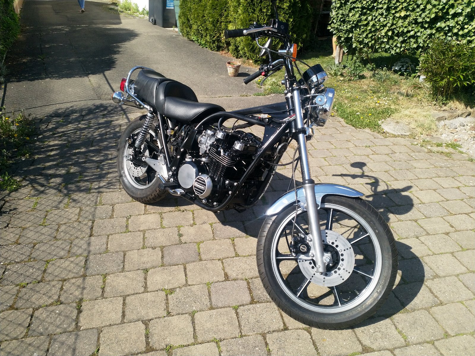

- calum
- Posts: 1144
- Thanks: 415
Re: KZ750H Restoration
20 Apr 2020 11:45

- Skidmark
- Posts: 1087
- Thanks: 312
20 Apr 2020 12:39
Nice... I hope your tank is in better shape than mine!

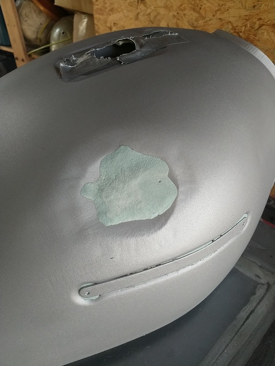

- calum
- Posts: 1144
- Thanks: 415
20 Apr 2020 13:41
Thanks. There's a bit of surface rust as I was a bit careless putting it in storage (should have sprayed some wd-40 in there). Should only need a quick soak though. The major is getting the dents sorted.
Some of the old filler even survived the sandblastng. I just filled it again last summer, primed it and have let the new bog settle. Now I just need to do a bit of touch up work.
