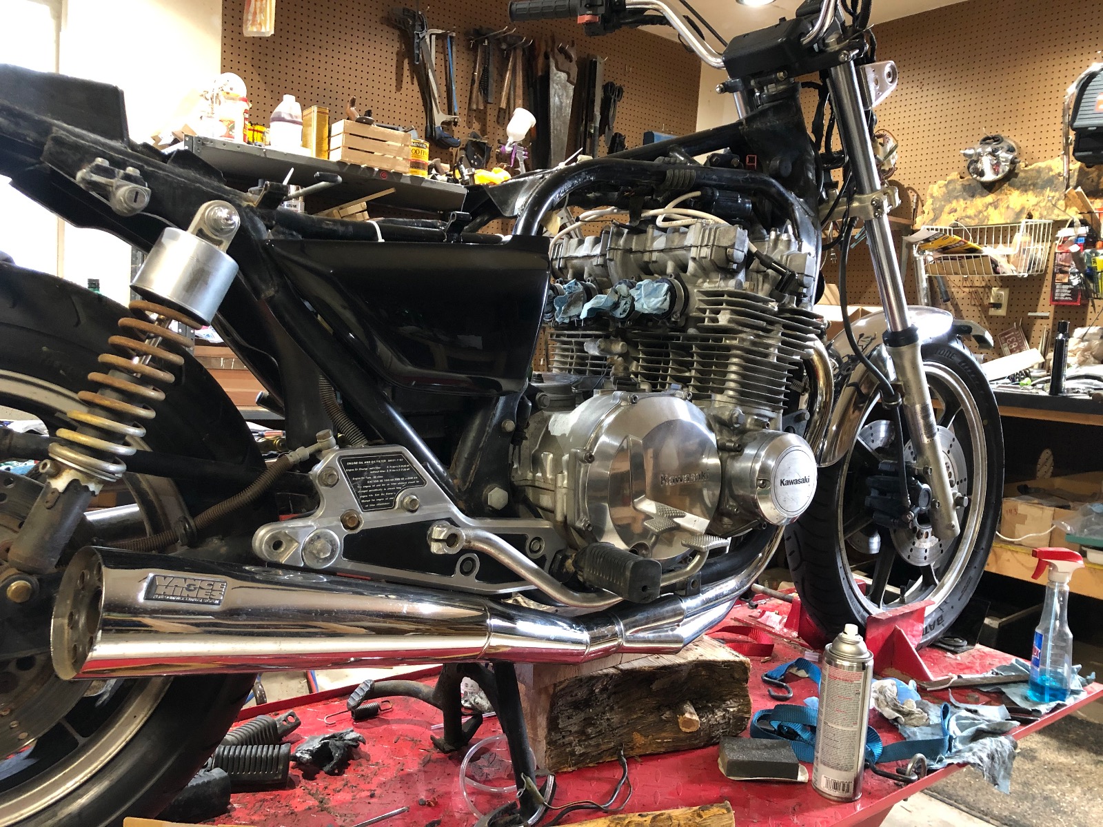

Hey guys new to the forum and new to the KZ’s but I found a KZ1000 at an auction and bought it for next to nothing with the hopes of restoring it and getting it running. It’s a 1981 according to the vin 11/80 is what the date says on the frame. It has 6000 miles. I’m curious to hear what people think of it’s potential. It came with a new Vance and Hines exhaust but not installed in the pictures.

Great bikes you scored.

I don't know much about the KZ1000's after 1980 but it sure looks like you hit the jackpot. Good luck with getting it back on the road.

Cool, great score, that is a real good year for engines, got the title?

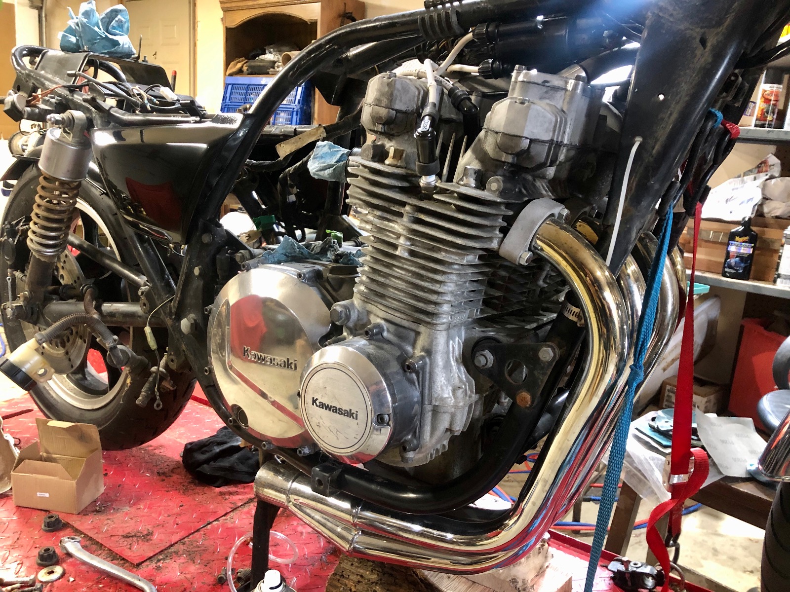

Update on my barn find, carbs where removed and cleaned, brake calipers were all removed and rebuilt, rear brake master cylinder was good and left alone, front brake master cylinder removed and drilled out and put a sleeve in it (first time doing that). New battery put in, fired right up and took of for its first drive last night. Still a long road to go till complete.

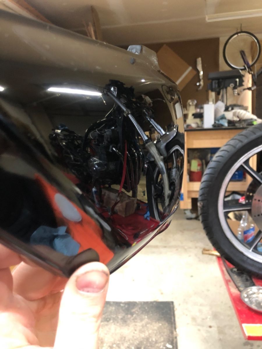

Has anyone been able to find the meter dampers or an alternative one for this generation kz1000? Part number 92075-1315? Mine are in horrible shape. Other than that started painting and cleaning this bike up not that the goldwing is done. Decided to return it to black.

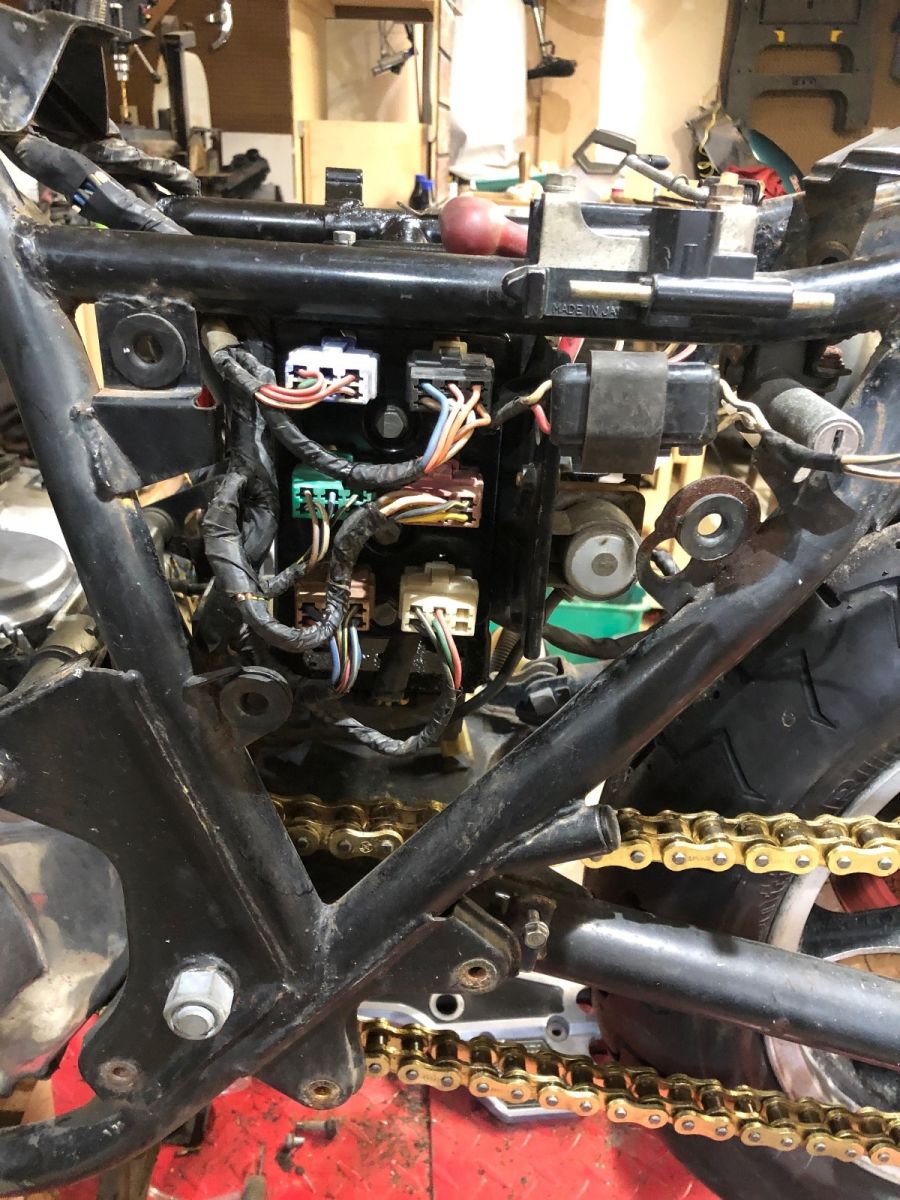

I took the battery box out and repainted everything got it put mostly back together but I’m a little stumped on how all the wires were ran so the tool tray would drop in nicely. Mine was never ran correct even when I took it apart. If someone could send me pictures of theirs that would be super helpful, just a top down and from the sides with the covers off ought to do. The left side is already put back together with the six big connectors
