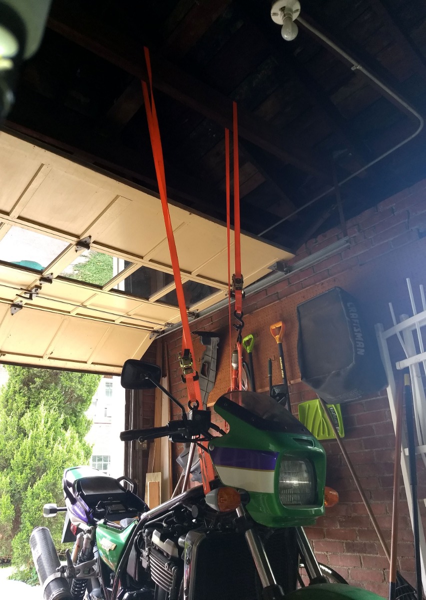

Hang the bike from the rafters with strap style bike tie downs / Chainfall then change to straps at triple trees.
Obviously secure the back end too so it doesn't fall over

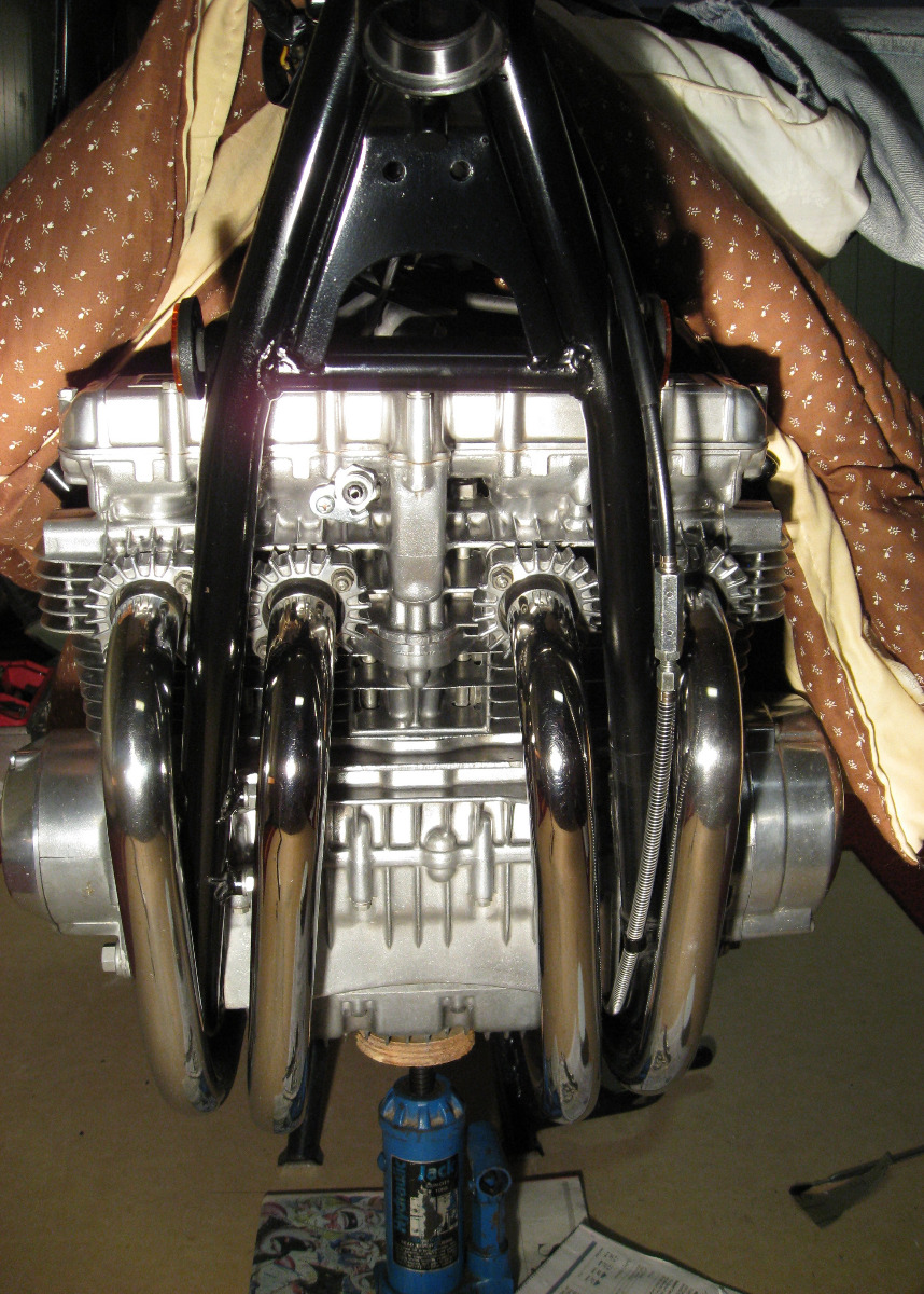

That all sounds like way too much trouble to me, but maybe it's because I have a KZ650. To remove the front wheel I simply place a bottle jack under the front of the engine with a wood block between the jack post and the engine to protect the engine. Then I just jack it up to lift the front wheel off the ground. In fact, I even removed the whole front fork assembly that way when I replaced the lower fork legs (see image below). Removing the front wheel that way is very easy. Ed

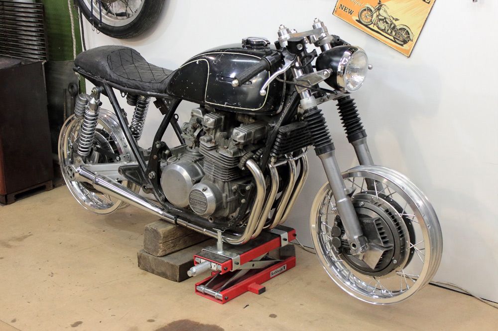

No eBay APP ID and/or Cert ID defined in Kunena configurationOur member gazzz is using a bike lift that fit under the frame tubes and can lift the front and rear for a wheel change.
A friend of mine had bought this lifter for his Harley and it works great. Seen this lifter on evil-bay for less than 50 euros.

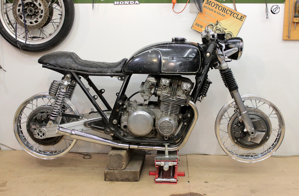

I do it the same as 650ed, but use a homemade engine block stand >> two 2x4s sandwiched together & attached to a 2x6 base using long deck screws. It's pretty solid with the weight of the motorcycle on it. The stand also serves a couple of other functions for the carbs & front brake.

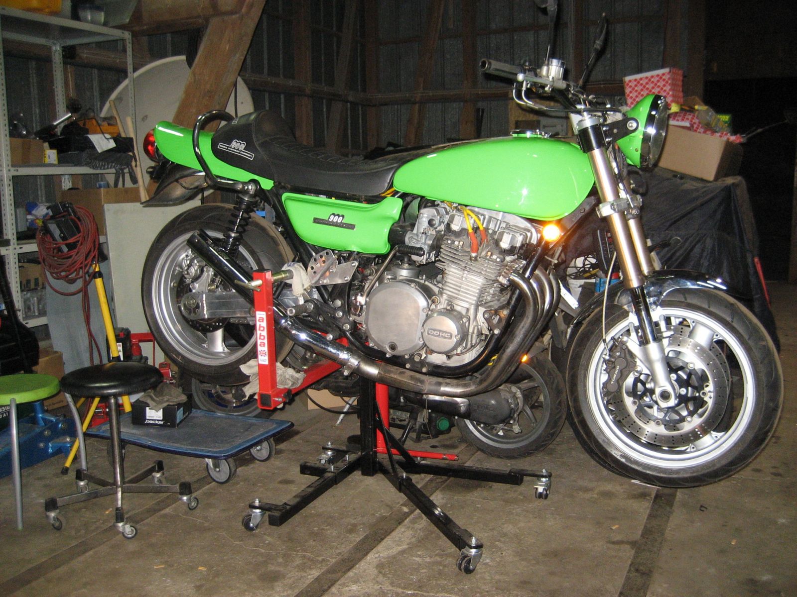

I use my ABBA bike lift for the maintaince or wheel change and and i have the possibillty to move the bike if needed.

exactly what i did with my chopper lastnight kz750b..put the 82 750n1 air over oil forks duel disc wheel and tire....ratchet straps over rafter 6ish feet apart and couple wraps round handle bars and ratchet away

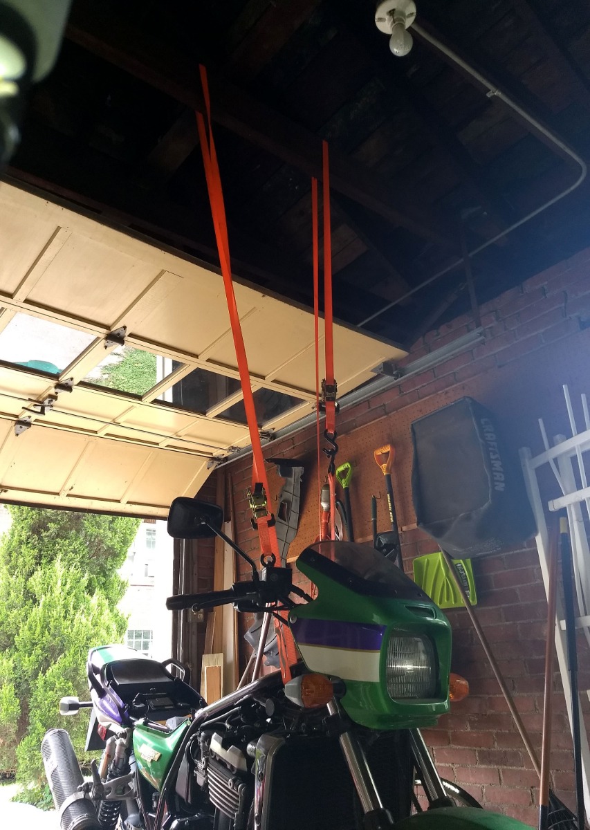

Re: front wheel removal
01 Sep 2020 20:33
I was trying to figure out the same thing this afternoon, as my ZRX needs new tires. I have one of those scissor jacks, but the saddles do not go high enough to reach the frame with the pipe installed. So I used the jack with a block of wood, along with a track stand for the rear (no center stand), and also two ratchet straps looped over the 2x6 rafter, just for good measure. The front wheel is off now.
