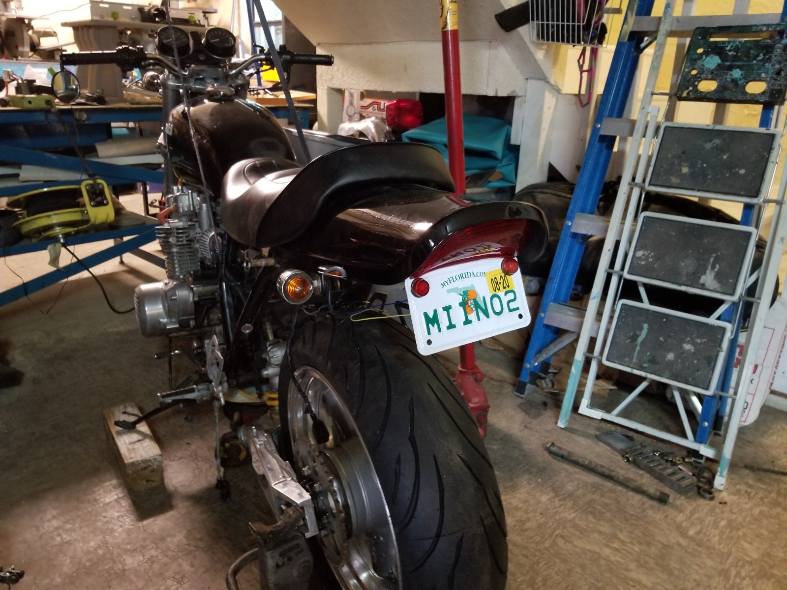

Looks wise I think it's perfect.
Not as comfy as the stock seat but way more comfortable than my $600.00 Sargent seat on my ducati, and that was a improvement over the stock seat.
So feels great to me.
Probably sell the stock seat and buy more parts.
Looking for a oil cooler and fittings now.

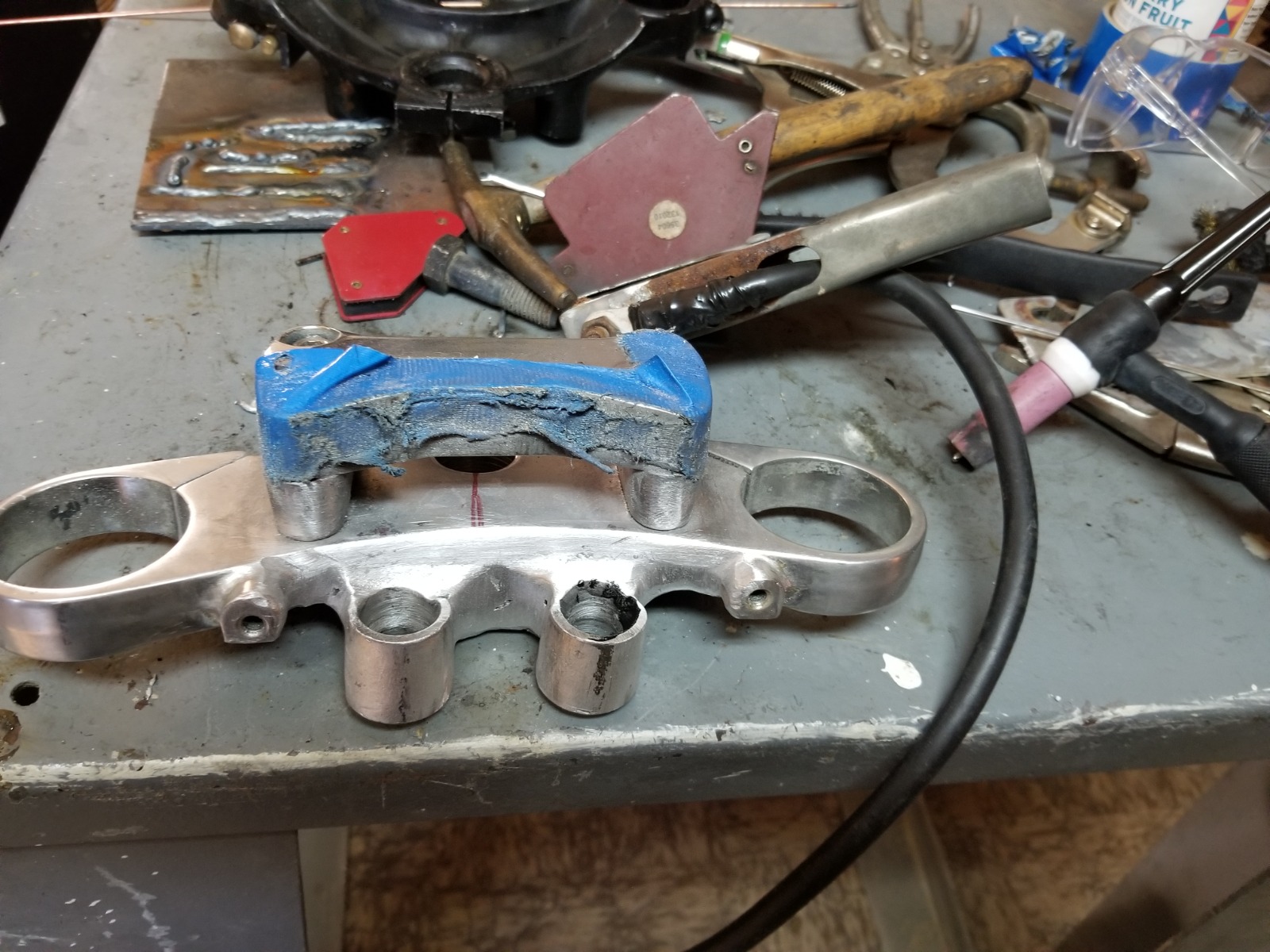

Got some work done on it.
The new front is on.
Forks are rebuilt with 3/4 " spacers.
I welded brackets on the upper tree and a steering stop / steering damper bracket.
Polished everything and put some new rubber on it.
Starting on the rear next.

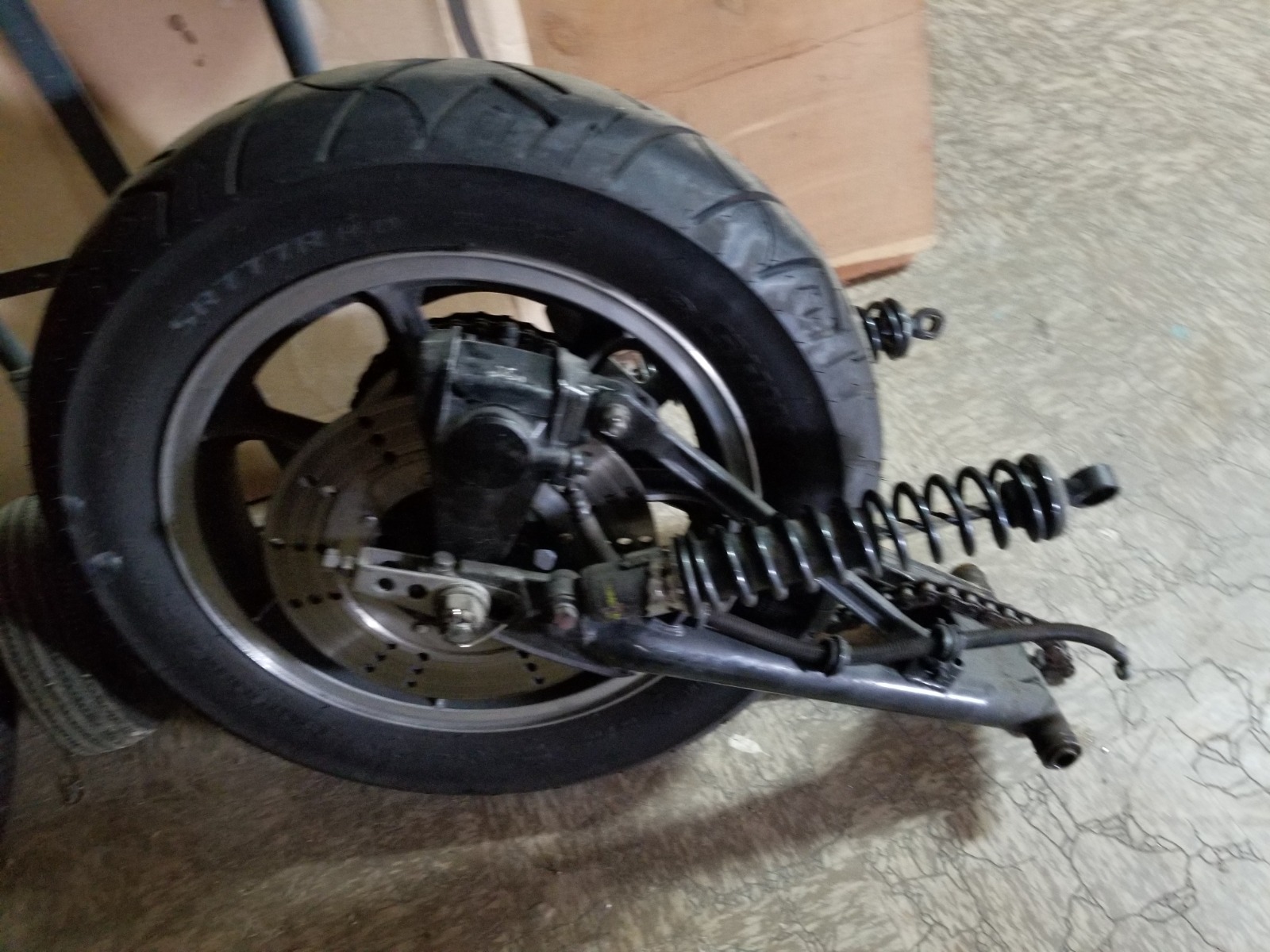

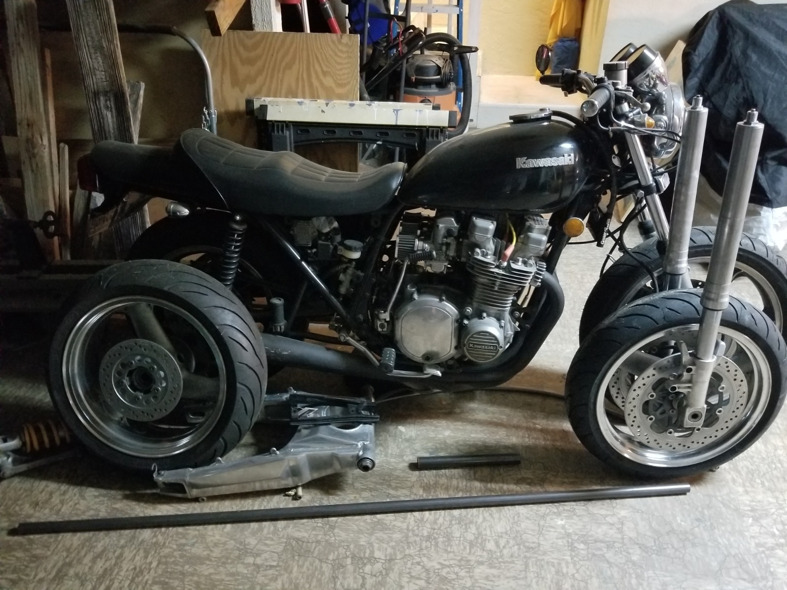

Just did a test fit. There is no way that zx7 swingarm will fit.
Even if I took all I safely could off the swingarm and frame I would still need 3/8 .
Guess I will start shopping for a zx6 or 636 swingarm.
Glad I smoothed and polished this one first.
Probably scrap it with the zx7 frame.

GSXR 600 swingarm dropped right into my frame.
In fact,this is a list Leon made when I was looking for a suitable swingarm;
97-03 gsxr 600 (no upper brace)
92 gsxr 1100 (no upper or lower brace)
those should install much like the gs arm.
these will take some modification but have been used on kz's in the past (and present)
99-07 busa needs upper brace removed(possibly lower brace added)
03-04 zx6/636 needs the pivot machined narrower
01-05 fz1 needs the pivot machined narrower

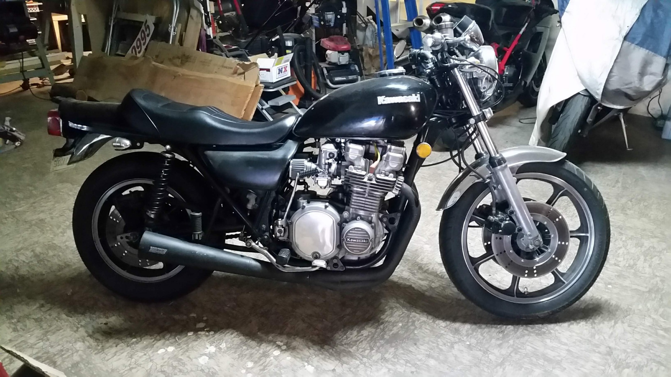

What do you all think these are worth?
Its all in great condition, just put on the new tires so I could ride it for a few miles so I knew it was running right before the build.
Would be nice to start recouping some money to finish it.
Not having any luck selling the parts off the zx7r parts bike .
