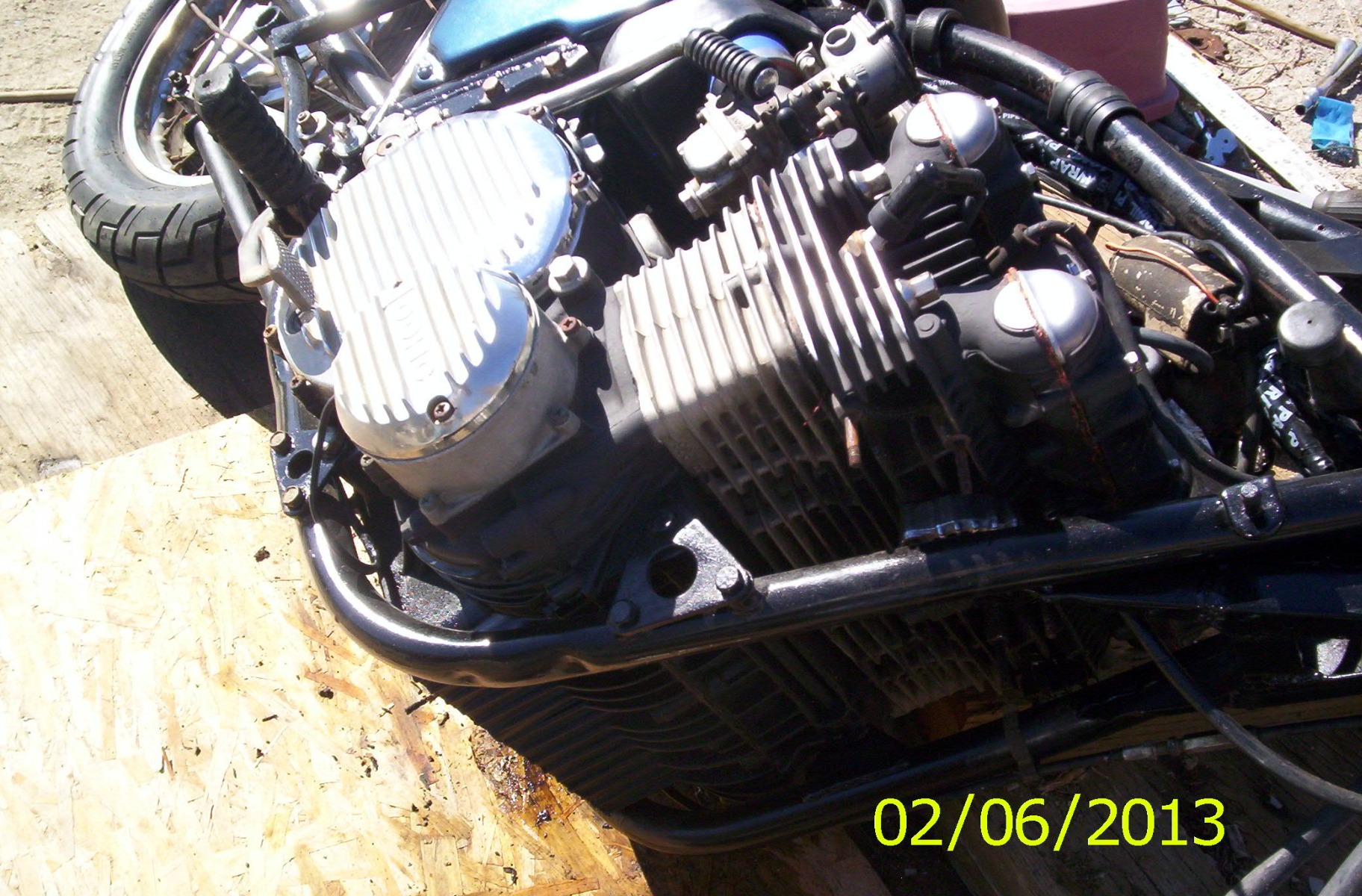

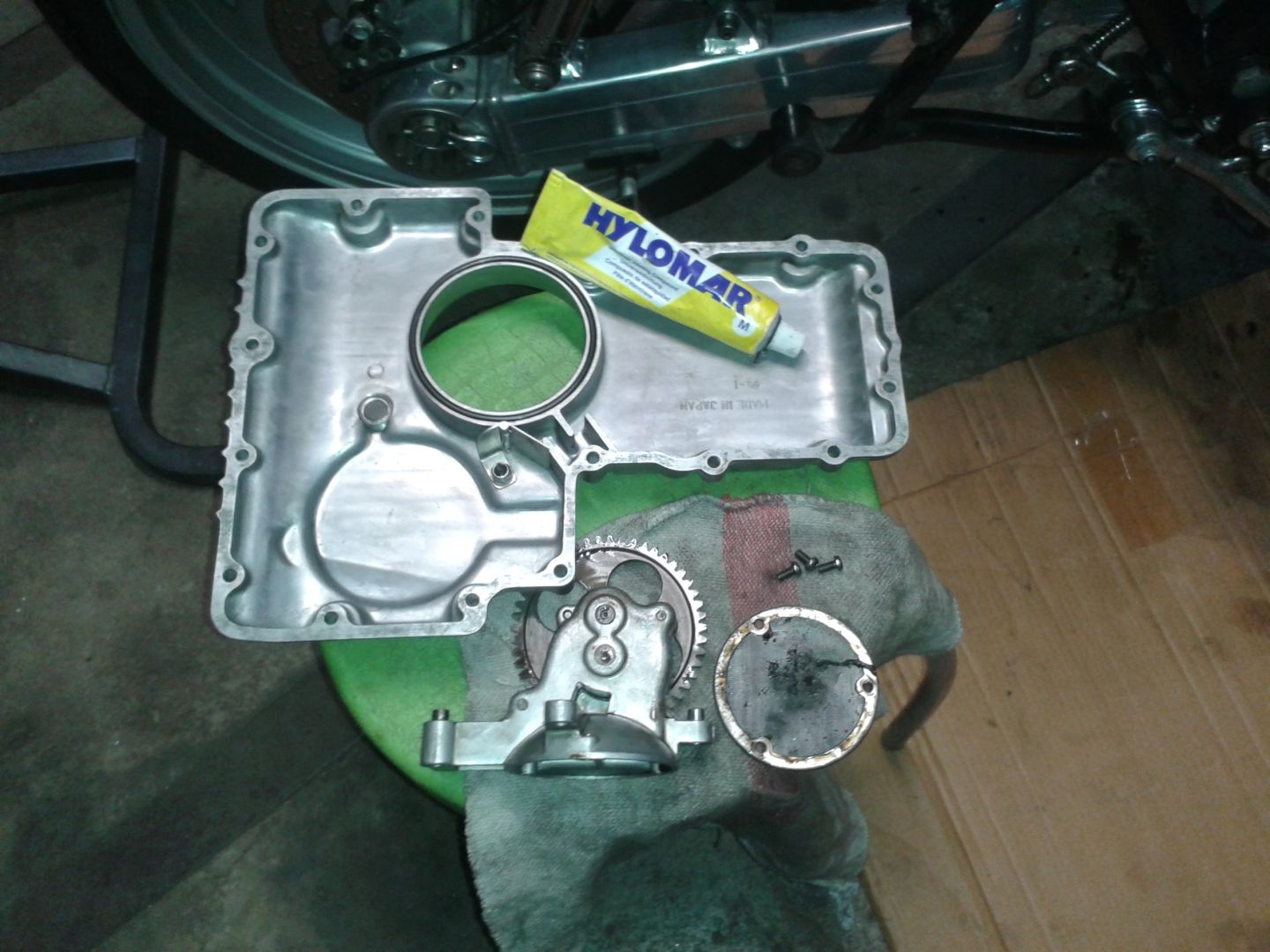

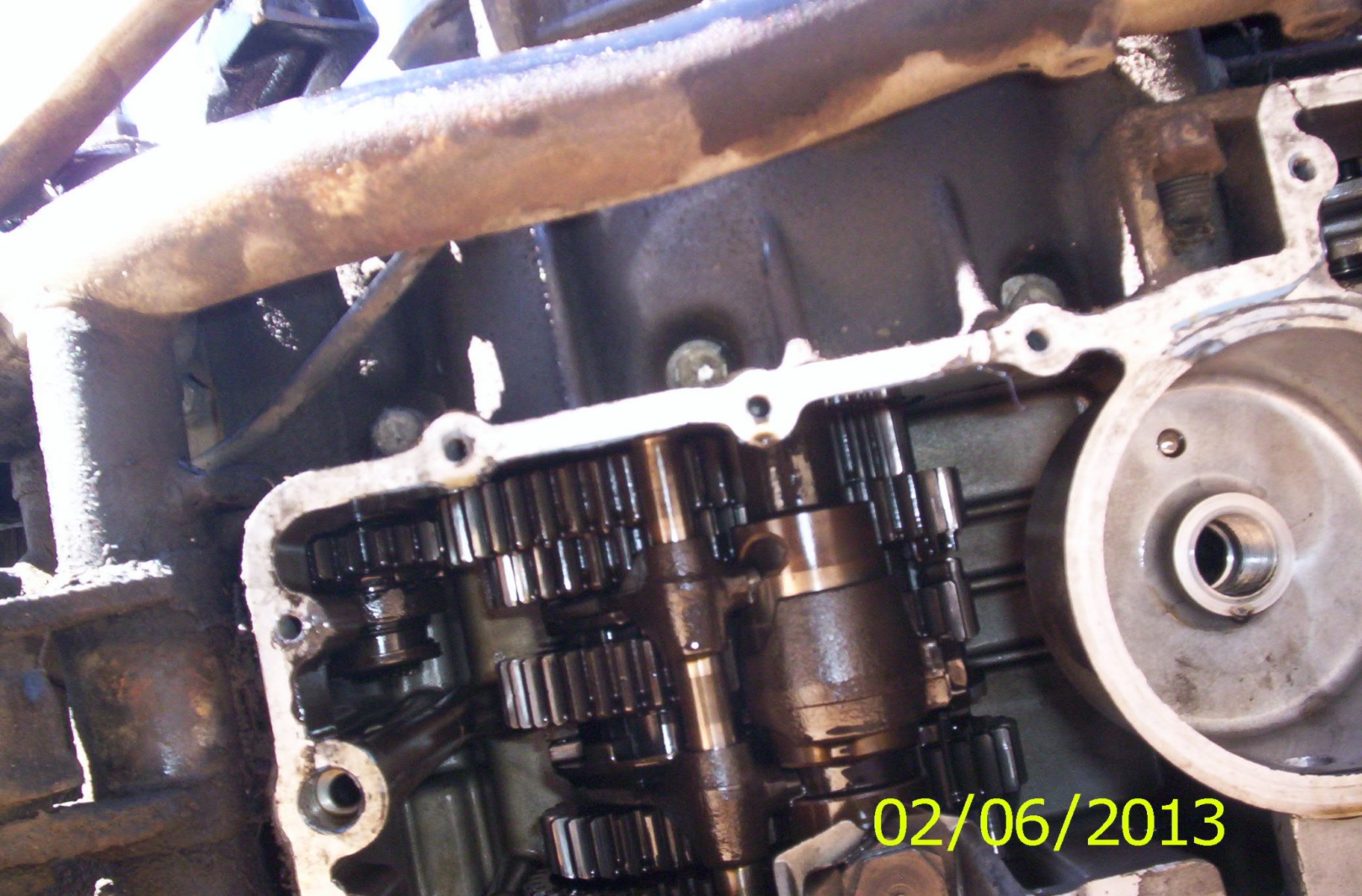

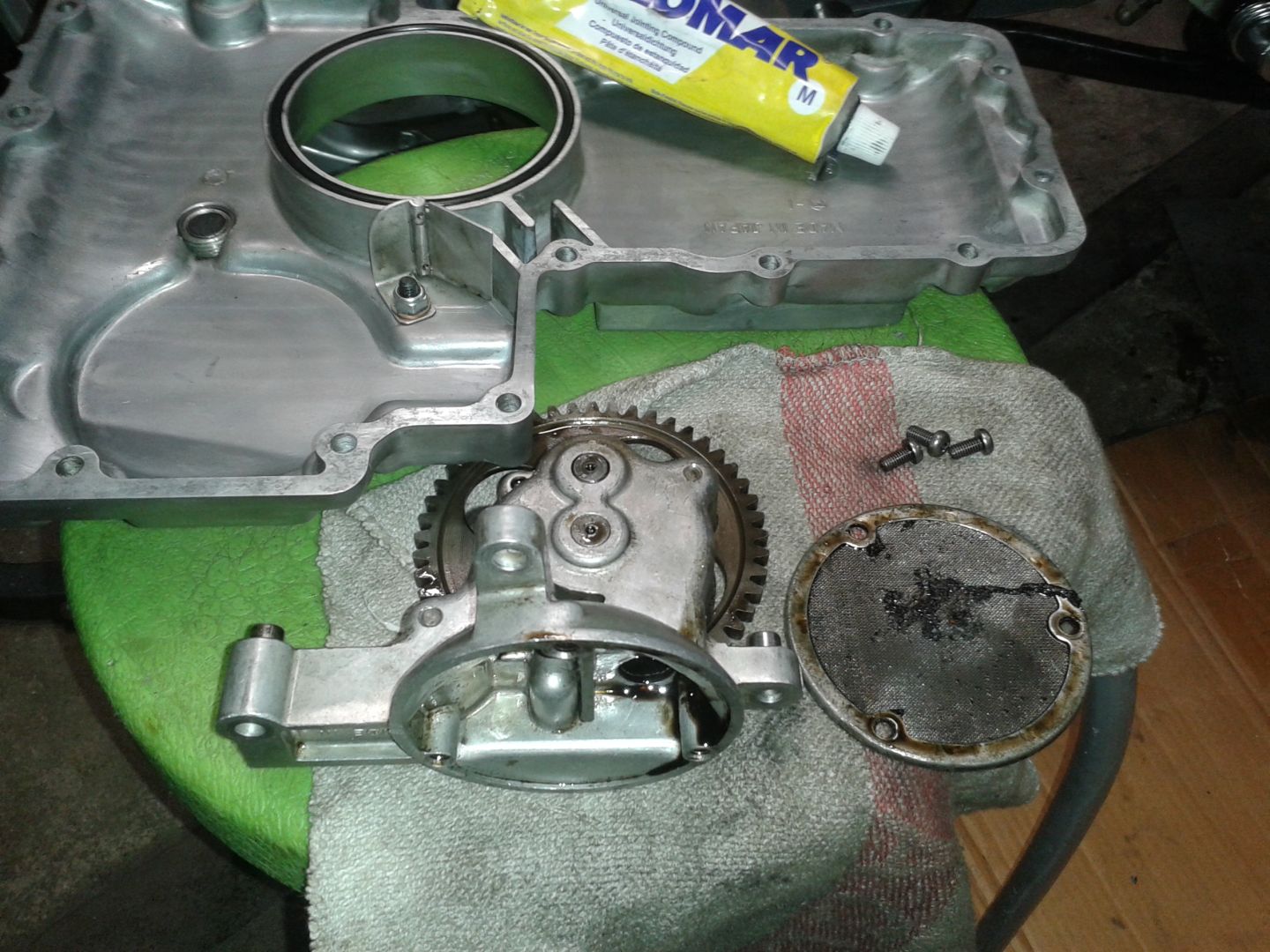

Not a good sign...
Agree with pulling the sump cover off to inspect. Hopefully no corrosion damage.

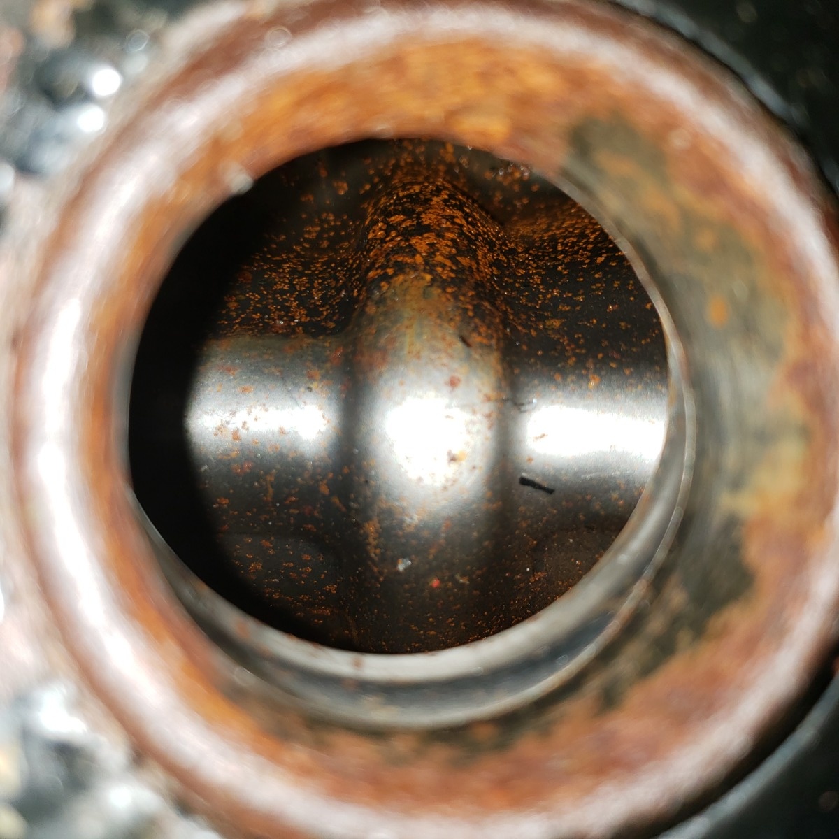

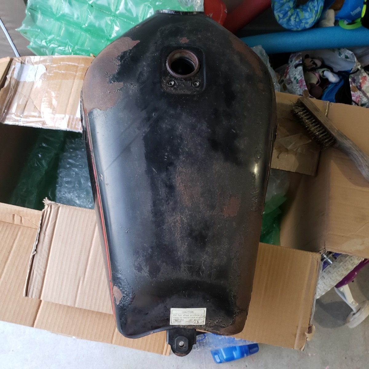

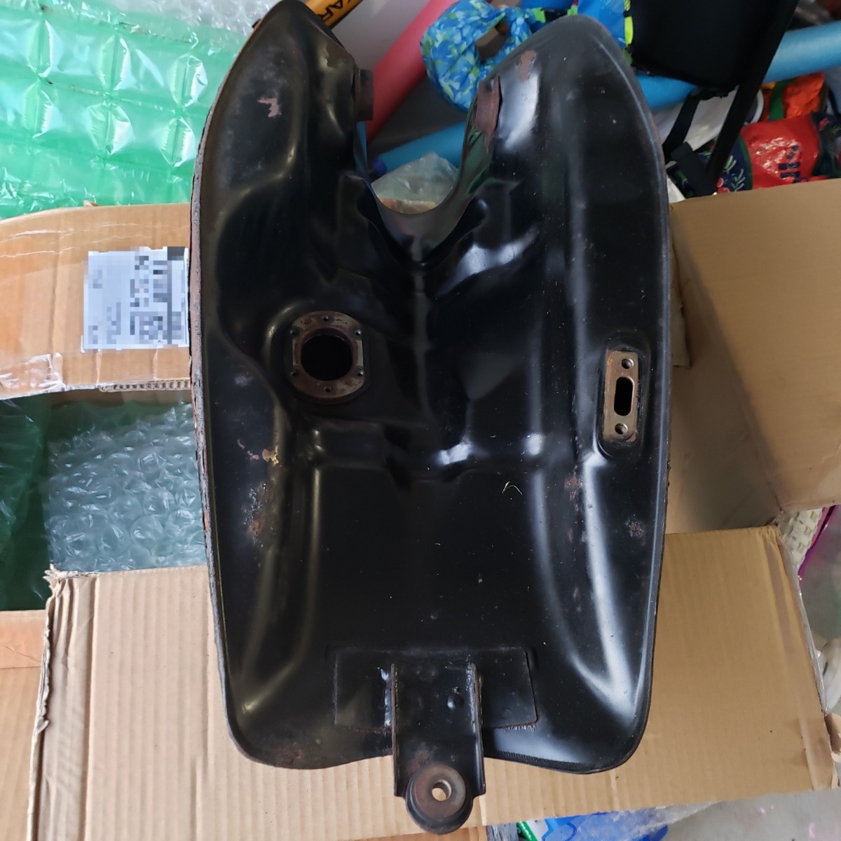

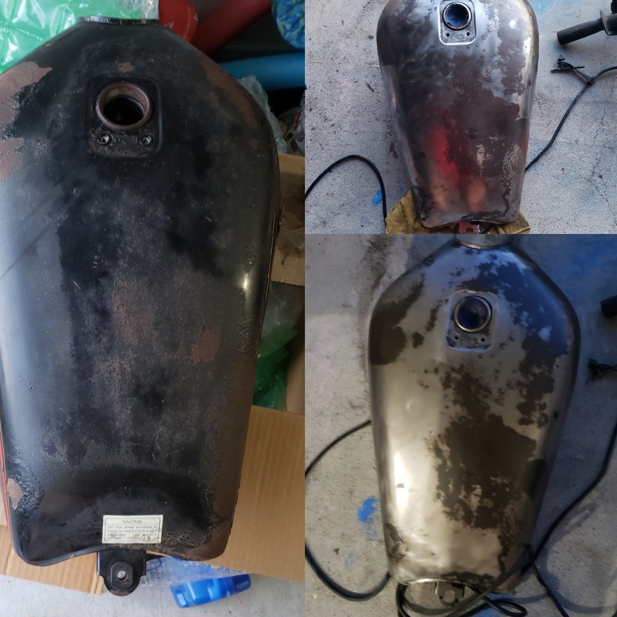

Thank you all, I will be cleaning that this weekend
Here are some picture of the tank I got from Ebay
Leaving the tank on vinegar overnight, hope it would be clean tomorrow night

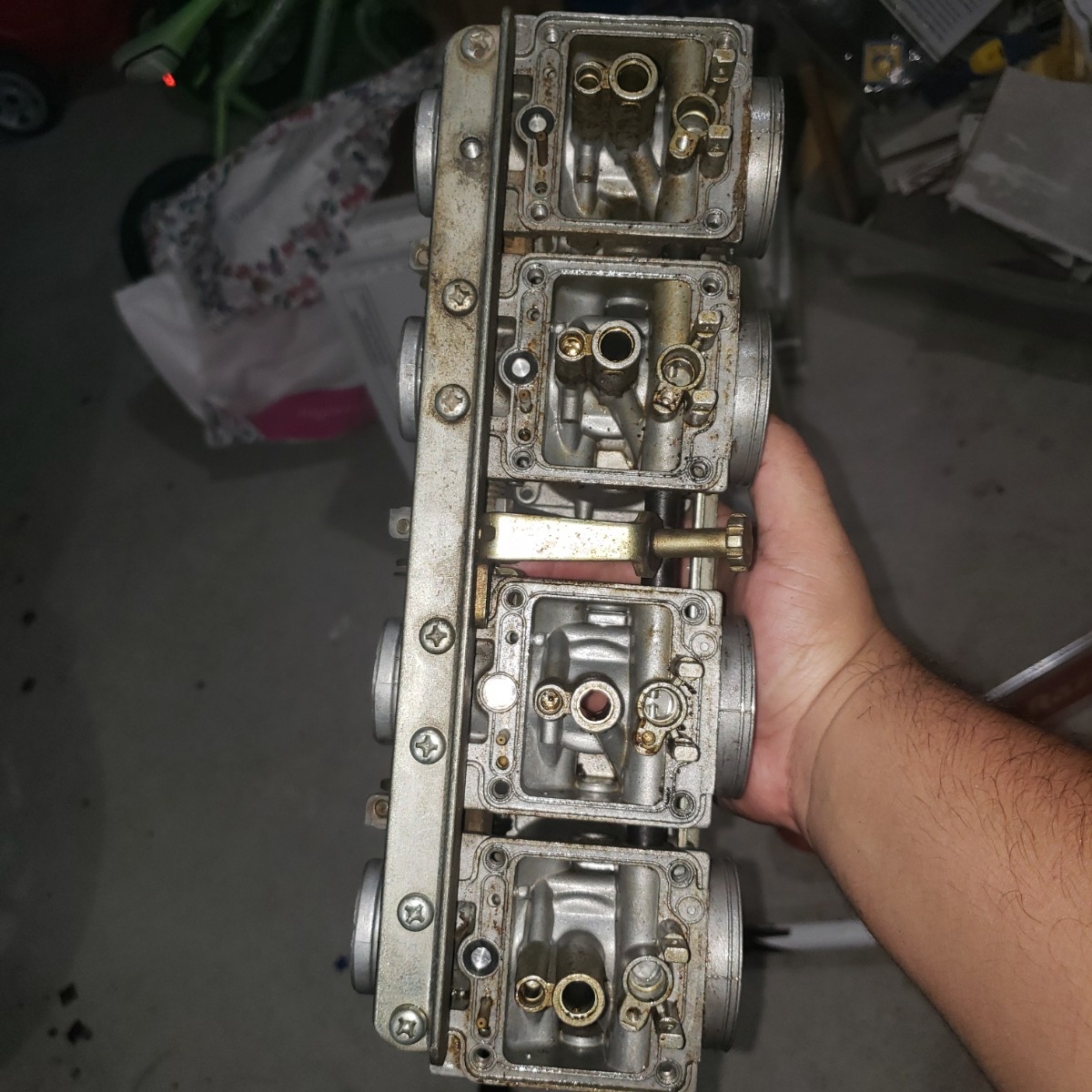

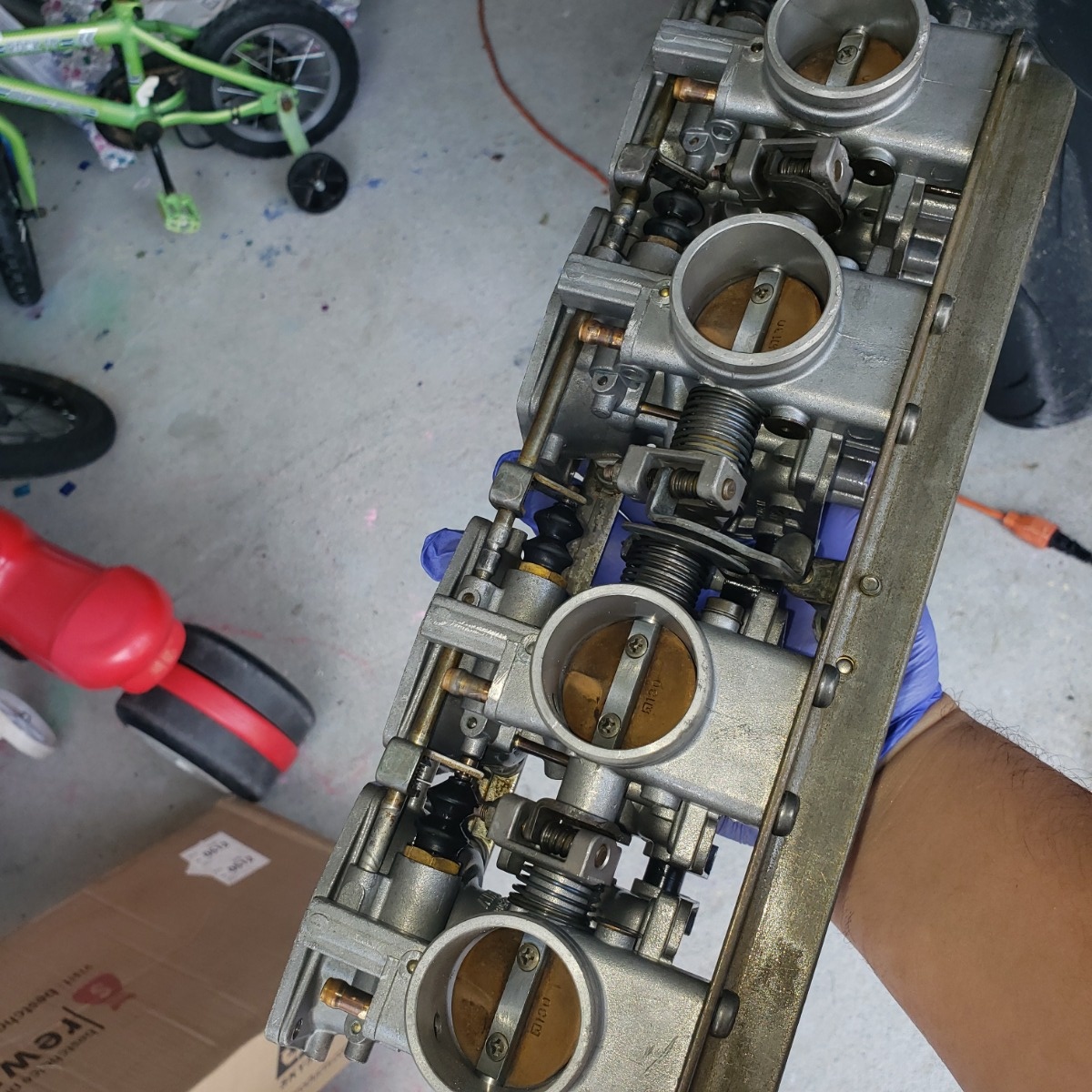

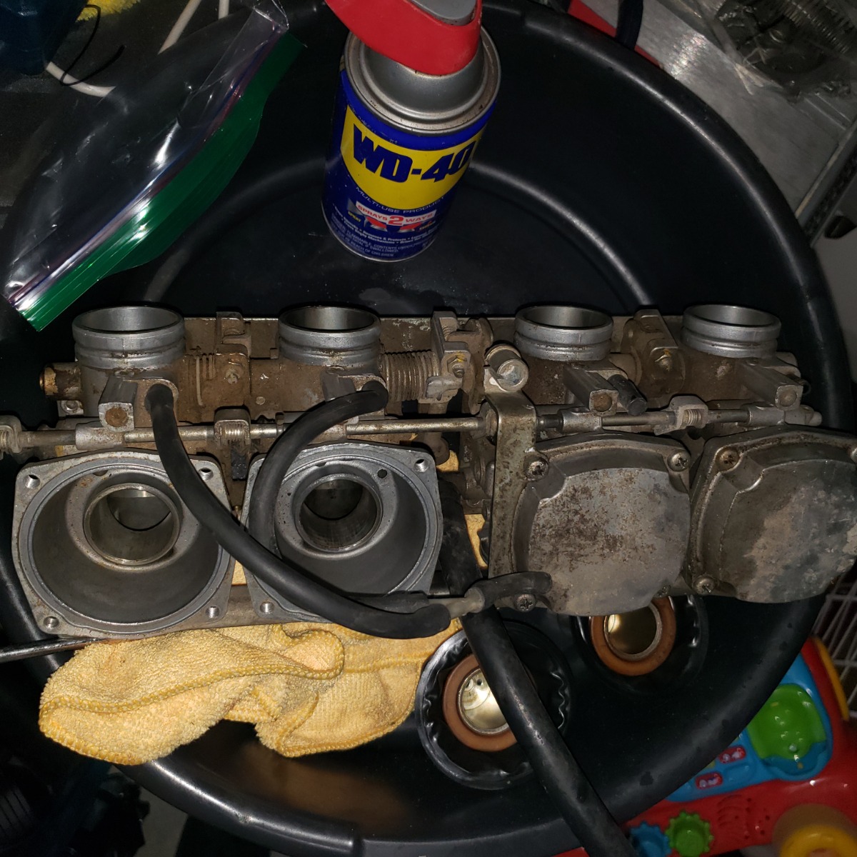

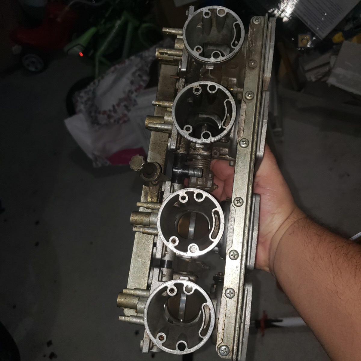

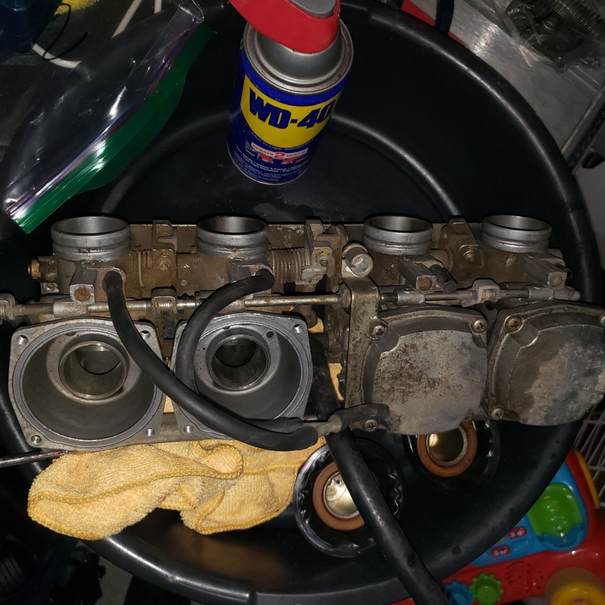

Quick update

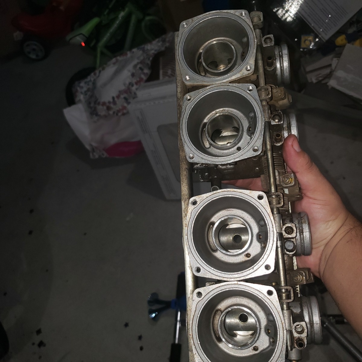

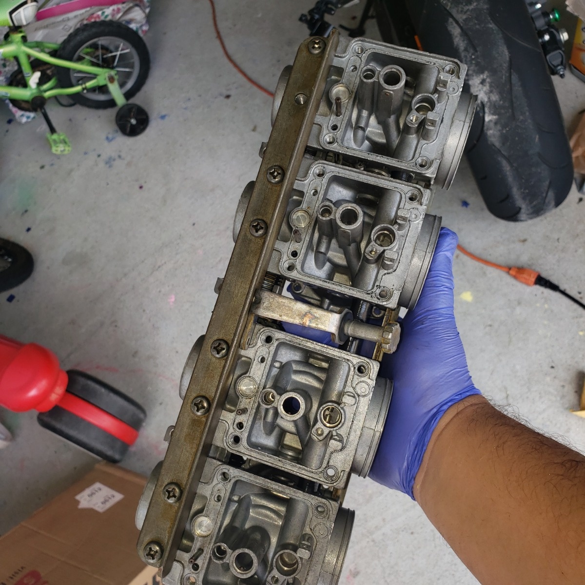

Carbs have been taking a part and clean
Here are some pictures from before
Let them soak for 24hrs on pinesol, washed out with pressure water and finished with carburetor cleaner and air
Now waiting to get the carbs rebuild kit and the dynot-jets stage 1&3
81 kz1100 broken girl
Last edit: 03 Aug 2019 11:19 by Mangajulio.
- Posts: 8141
- Thanks: 2647
Re: 81 kz1100 future cafe race
03 Aug 2019 12:31
The carbs need to be taken completely apart. That includes removing each body from the rack. That is the only way you can really clean them, and it is the only way you can replace the orings on the fuel transfer tubes. Also, depending on exactly what carburetor cleaner they soaked in, the cleaner may have destroyed those orings along with the rubber parts of the enrichners.
It is much easier to do that now than to wait until they are reinstalled and leaking.
04 Aug 2019 08:30 - 04 Aug 2019 08:35
Your carbs do look pretty good after the external cleaning. The enrichment booties also look to be in good shape, be extra careful with those, since that little piece of rubber is still available, yet pricey when sooo many other parts need replacing.
BUT, I agree with the folks recommending un-ganging them to clean the rest of the area's, such as the pilot circuits that are combined with the enrichment plungers circuits.. They don't look to have sat in water or fuel varnish at all.. They are actually pretty clean internally.
Becareful not to loose the 1/8" detent balls and ESPECIALLY not the >tiny springs< behind the the "choke rod".. They are made of unobtanium, :pinch:
Attachment not found

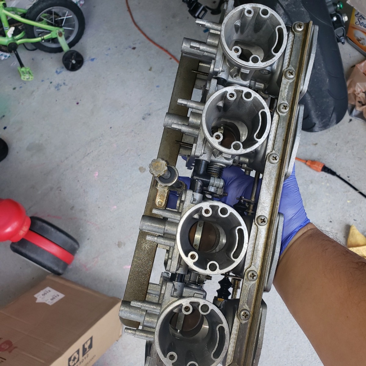

- Mangajulio
- Posts: 48
- Thanks: 4
10 Aug 2019 11:22

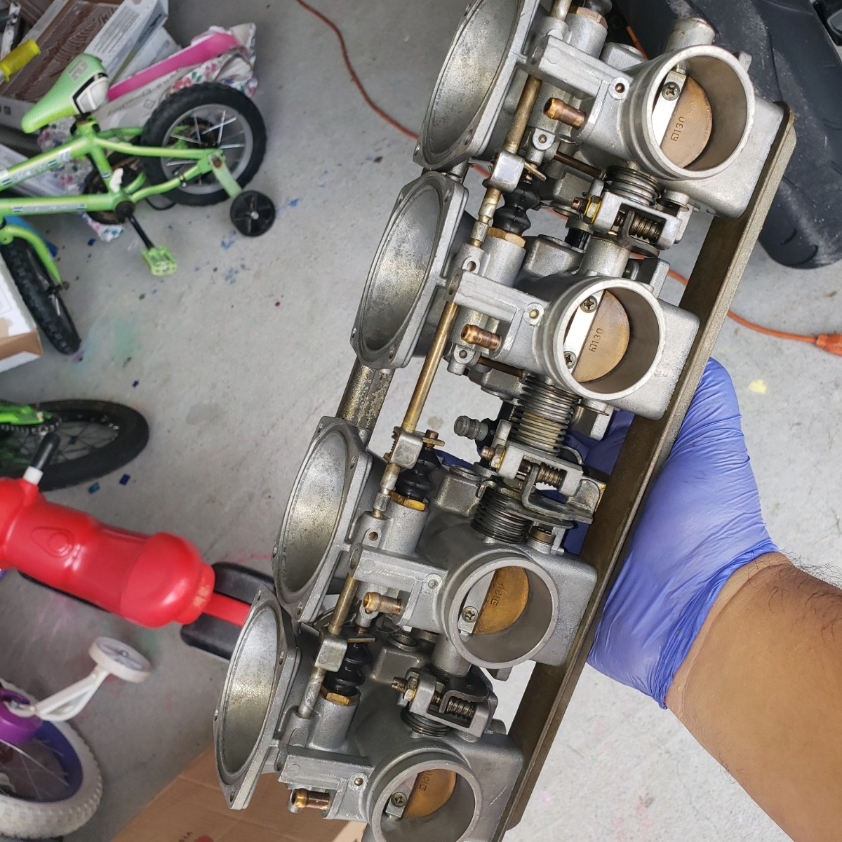

She is a live
Put carbs back, clean electris connectors, and I was able to run for a few minutes
Bike come with some pod filter but carbs are all stock, so I have the dinojet kit state 1 and 3 so I would be installing that next
