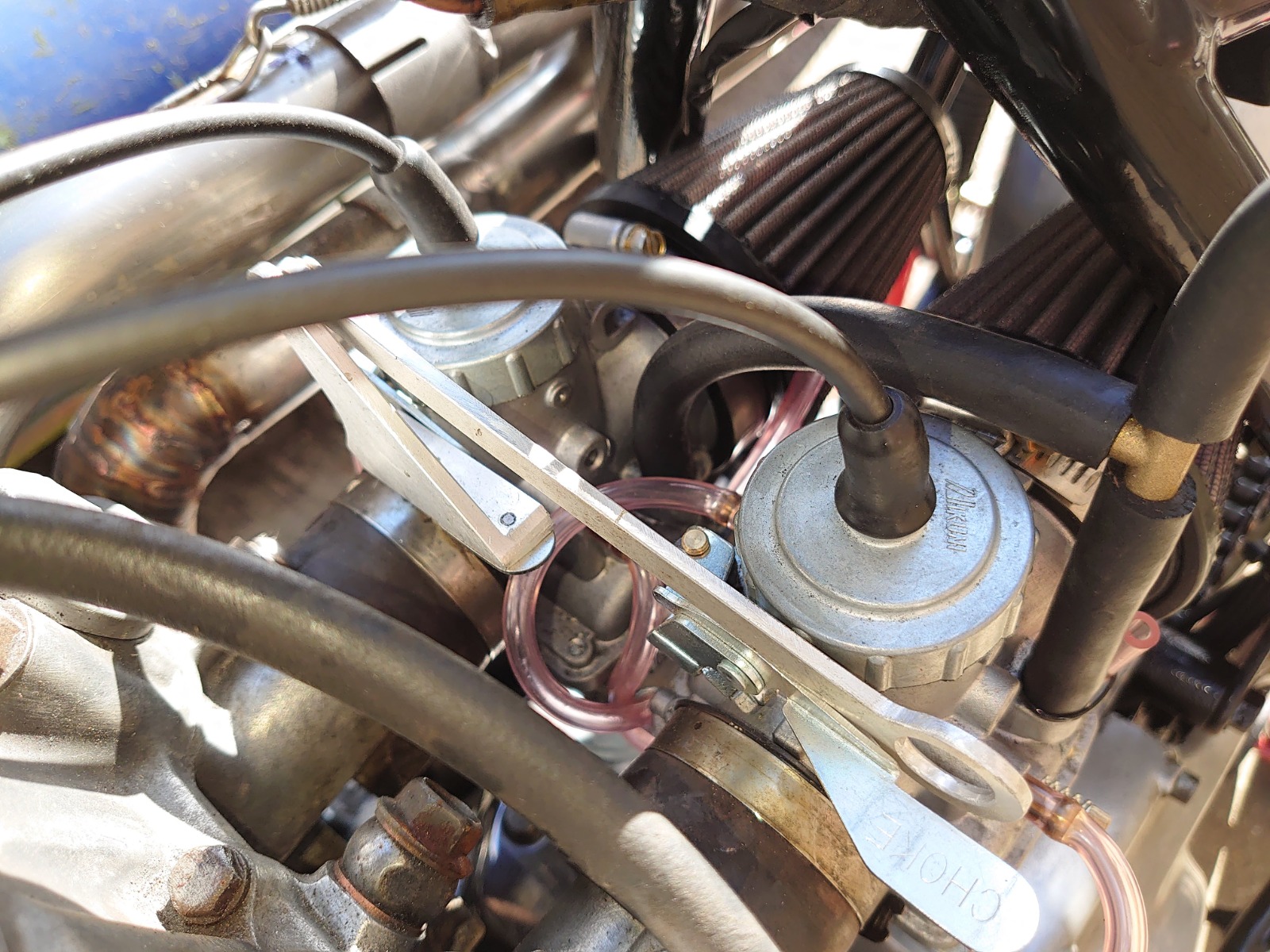

This is how I rigged the choke lever, the high level exhaust pipes are in the way so can now operate both from the left
-hand side.

That right side choke lever looks great! I'm going to have to figure out a similar mod on the dual carbs I'm working on.
