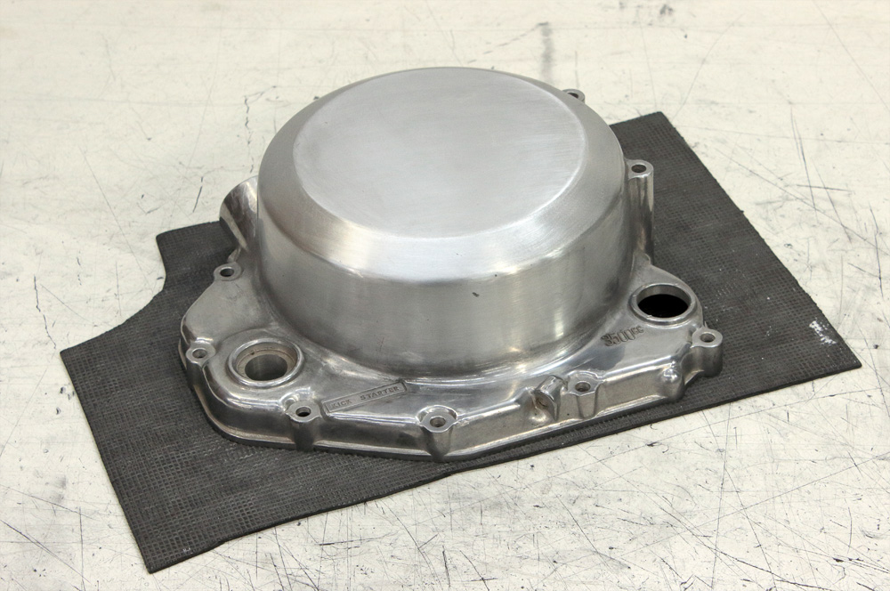

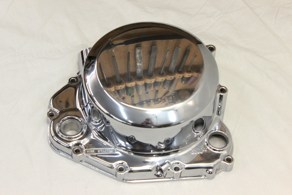

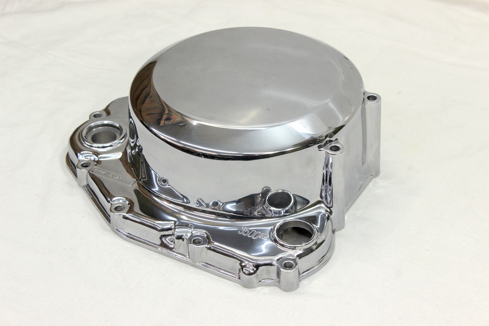

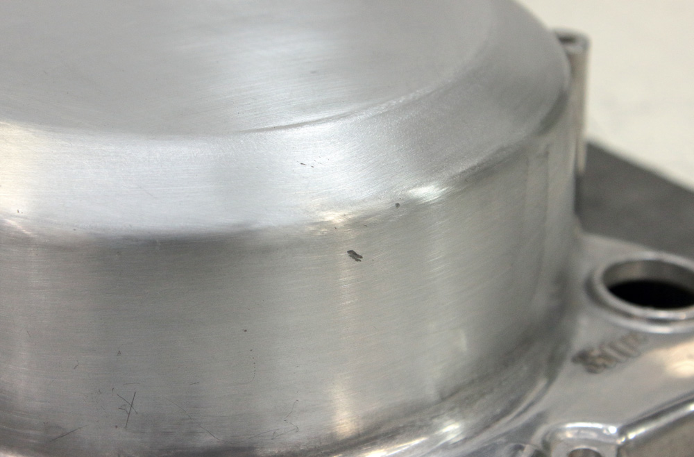

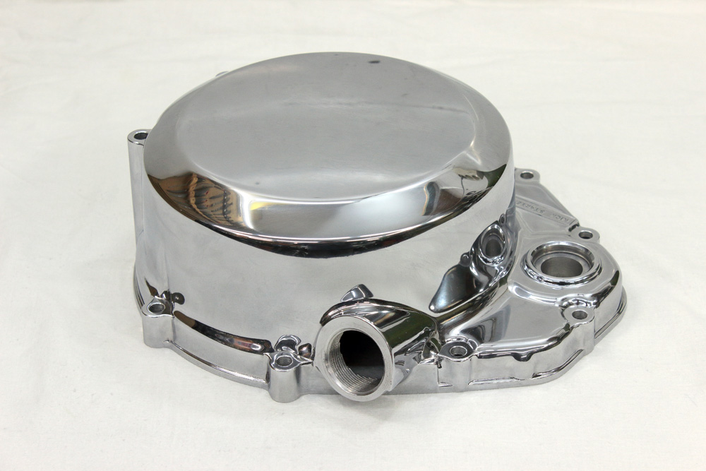

Another batch of parts I polished for our Kawasaki KZ650 project engine. It so happened that once, rummaging through ebay I came across New Old Stock clutch cover. It looked like a good deal so I bought it. Factory polishing was part of the mass production process thus it never intended to be brilliant, and sure, this clutch cover, being stored for 40 years, has got some number of scratches during its “shelf life”. Here you may see how it looked in the beginning of sandpapering. Scratches and factory non polished areas are quite visible:

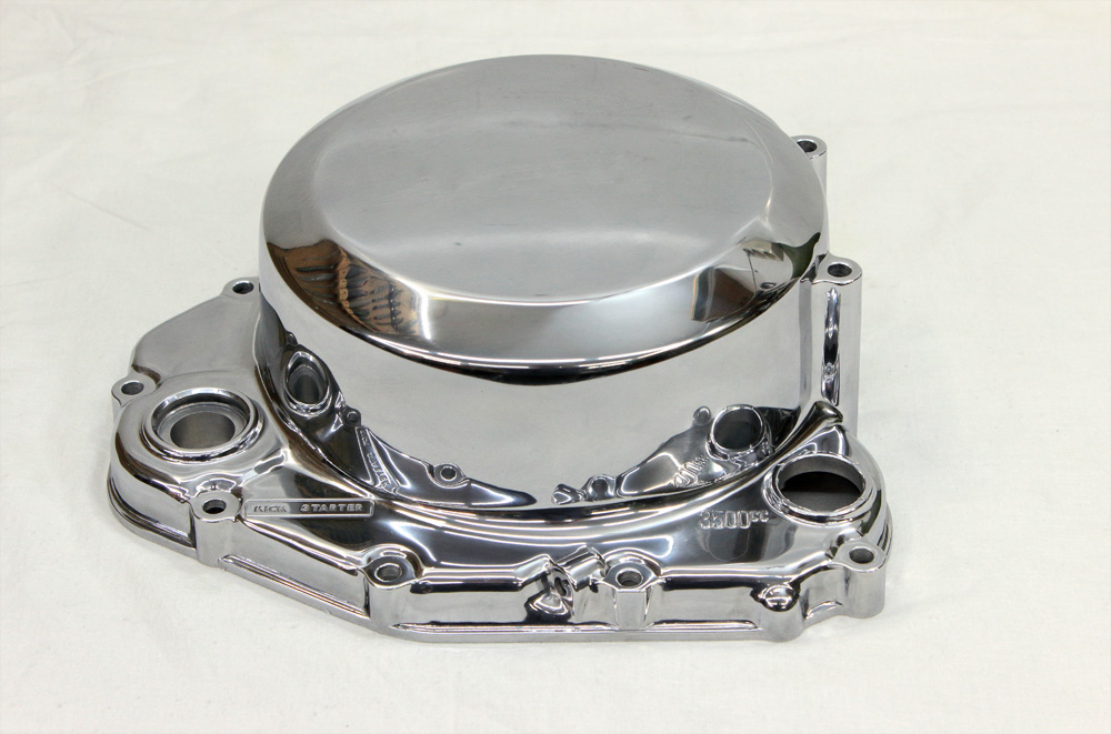

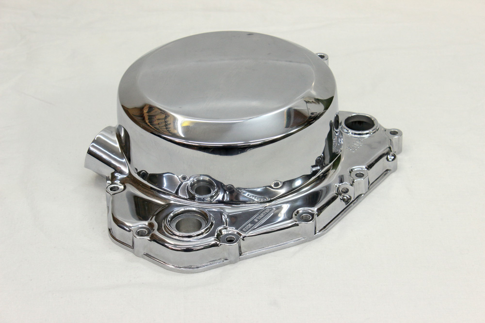

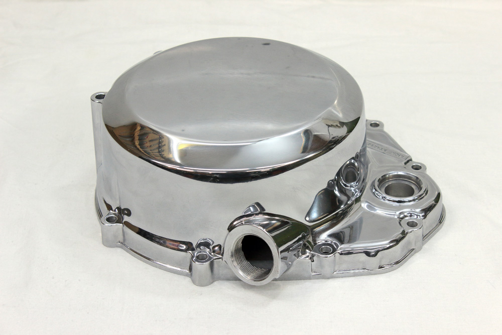

Polishing revealed some unevenness of alloy, but it’s a pretty ordinary thing even for more modern cast parts. However, I was satisfied with result:

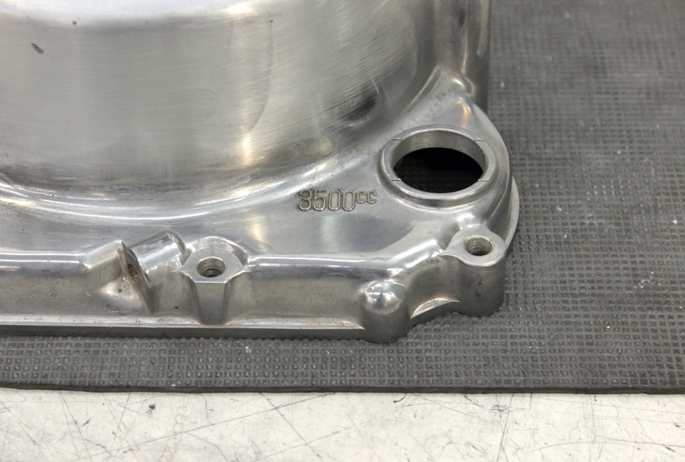

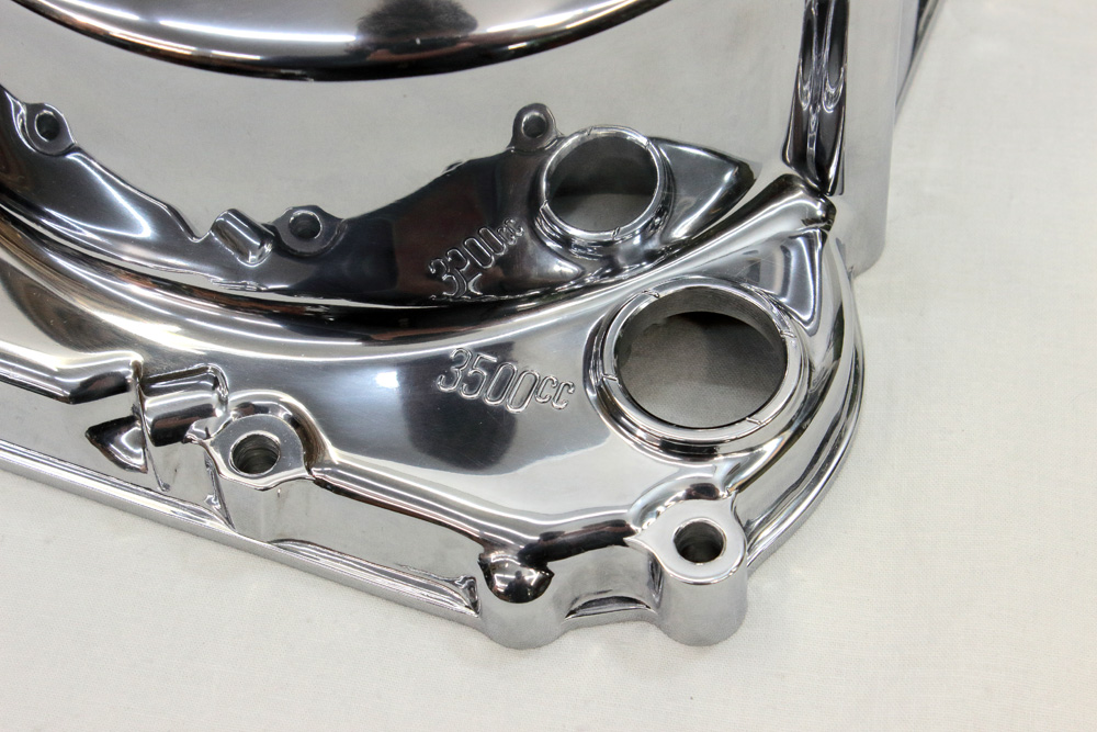

I was forced to work accurately on lettering, since they are pretty thin, but result like this will do for me.

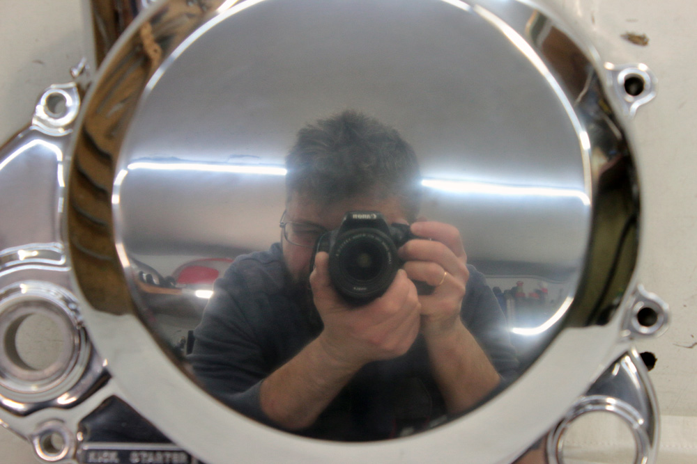

And talking of reflection, it was hard not to notice them during photo shooting:-)
Bit closer:
Bit closer:

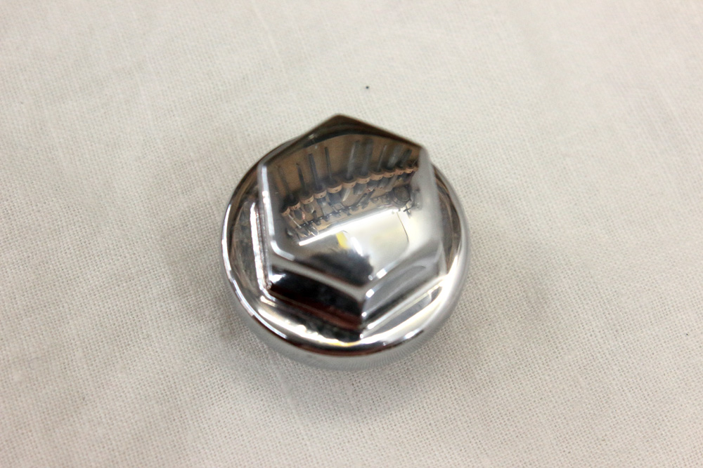

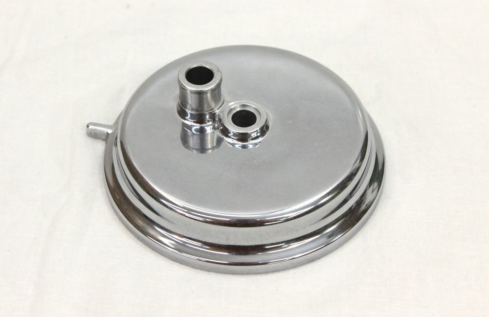

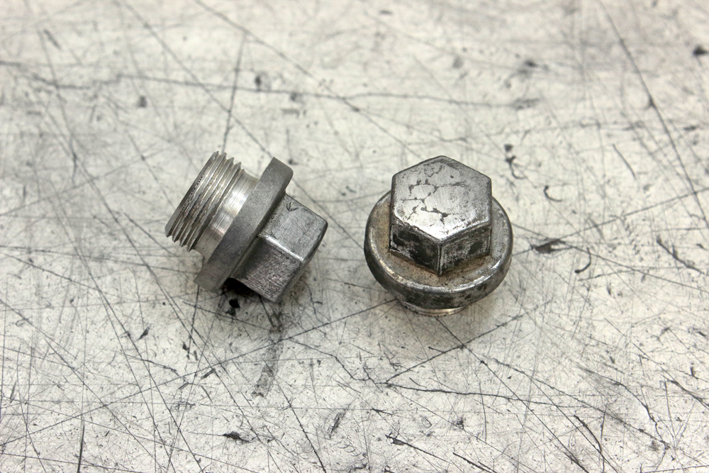

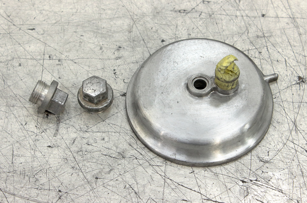

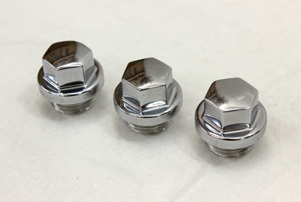

However, let’s proceed to smaller parts, like breather cover or plugs for the main oil gallery. Here they are, plugs before sandpapering and breather cover already in process:
Plugs were pretty rough and since they have to be tightened by wrench, I couldn’t take much aluminum from them.
But the result looked much better even with such limitations.

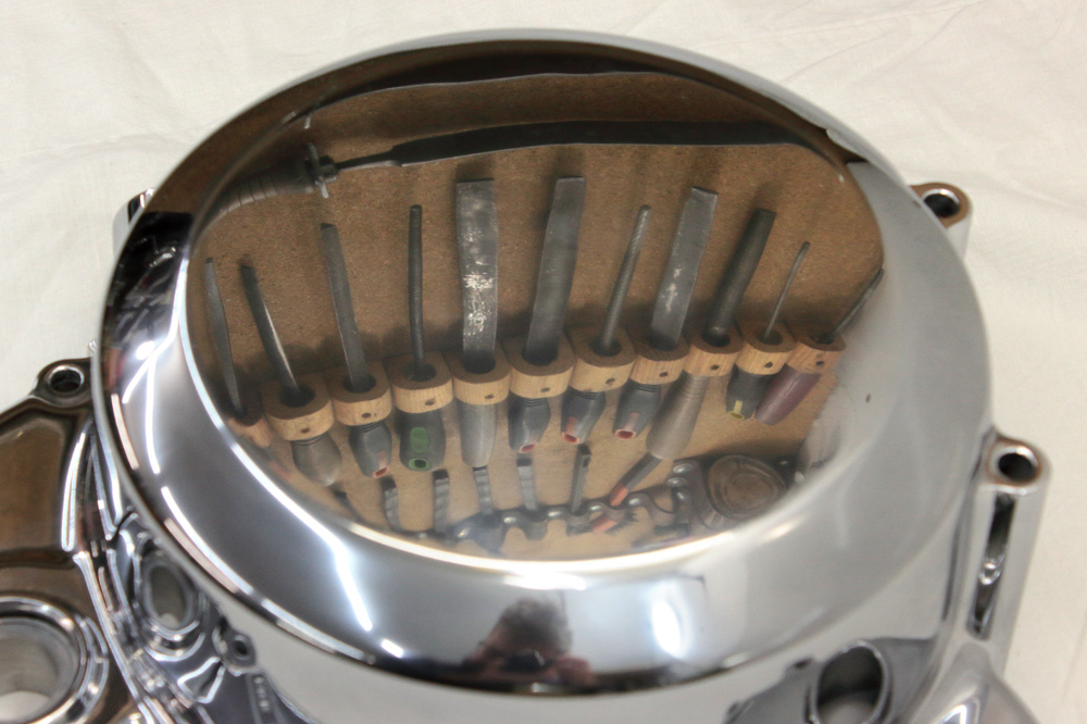

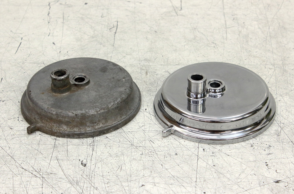

10 Mar 2021 11:56Same I could say about breather cover. Here is it in comparison with another non treated KZ650 breather cover I have in my possession:
Not perfect since I didn’t sanded out all corrosion dots, but I think it will do:
At this point I ran out of parts for polishing because the ignition cover turned out to be beyond saving and this fact caused change in my plans about ignition and alternator covers.

But, jokes aside, how do you plan to maintain this finish? My understanding is that bare aluminum even polished will dull overtime.

All my motorcycles have polished aluminum parts. With initial polishing done it's not that hard to keep aluminum shining. Liquid polishing compounds will vary from region to region, but the principle is same: your bike, your hands, some polish, some rags.
