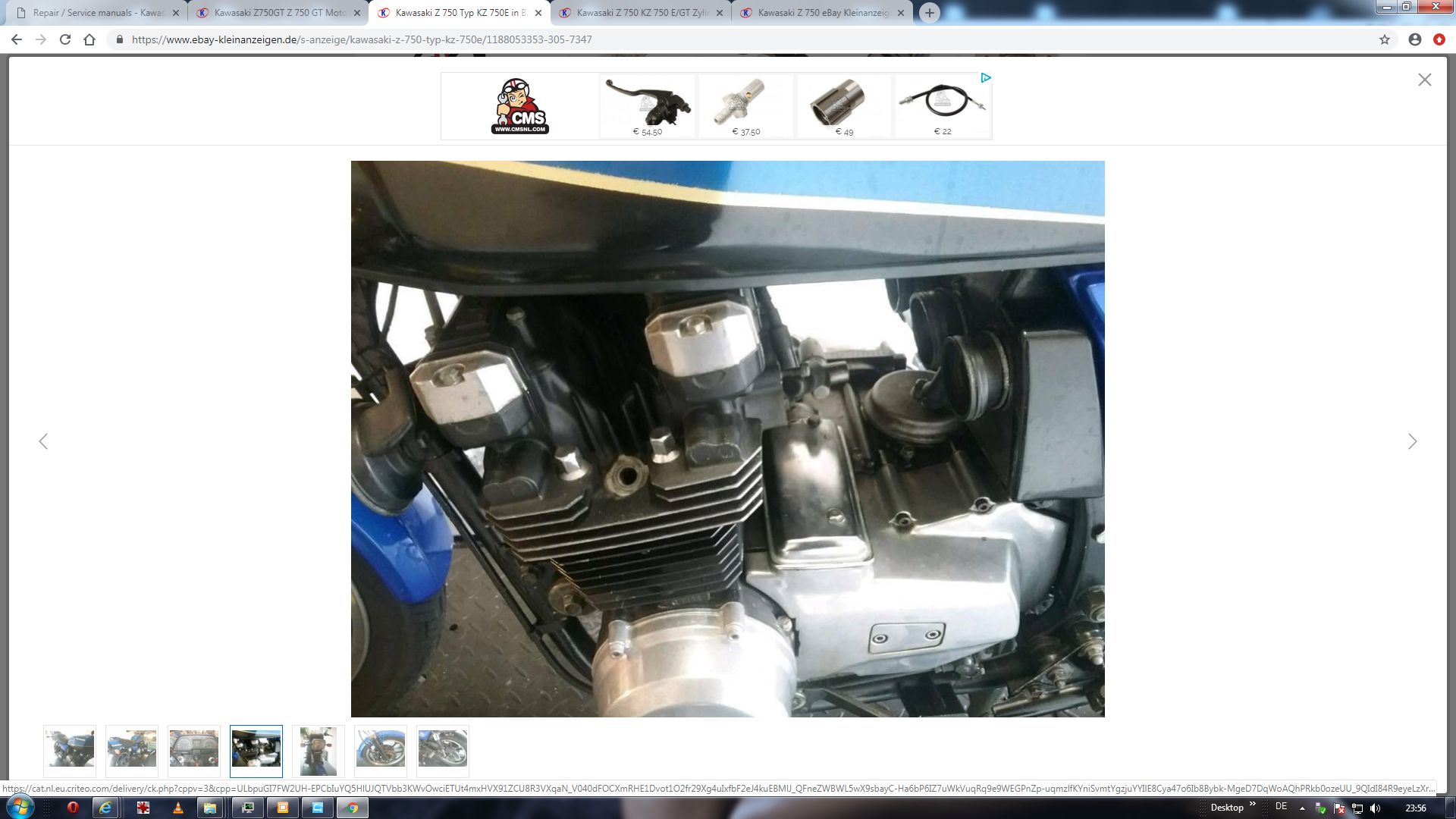

E-Bay Germany (private offers) listed a Z750 for 399 Euro and a cylinder head for 130 Euro.
The cylinder head is 40 km away from my home town so if you are interessted i can take a look on him for any damages.
www.ebay-kleinanzeigen.de/s-anzeige/kawa.../1188053353-305-7347
www.ebay-kleinanzeigen.de/s-anzeige/kawa.../1185099915-306-1455

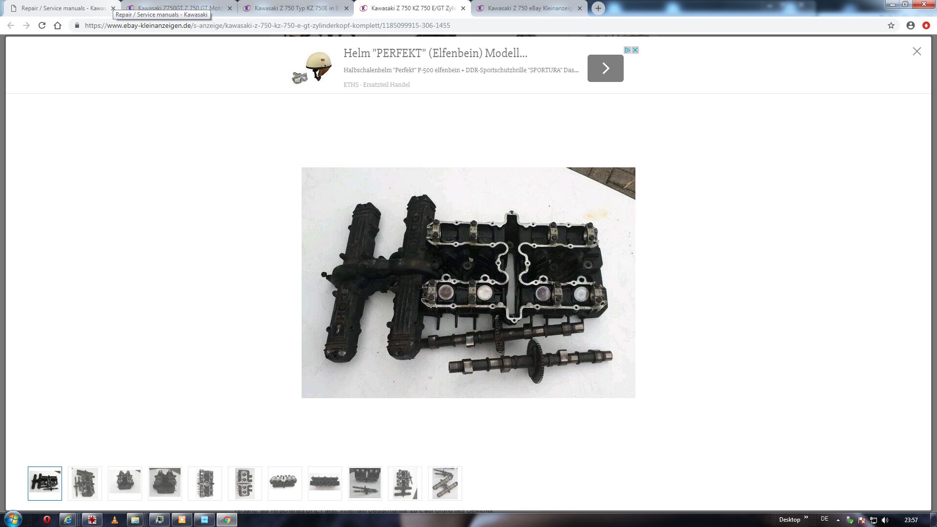

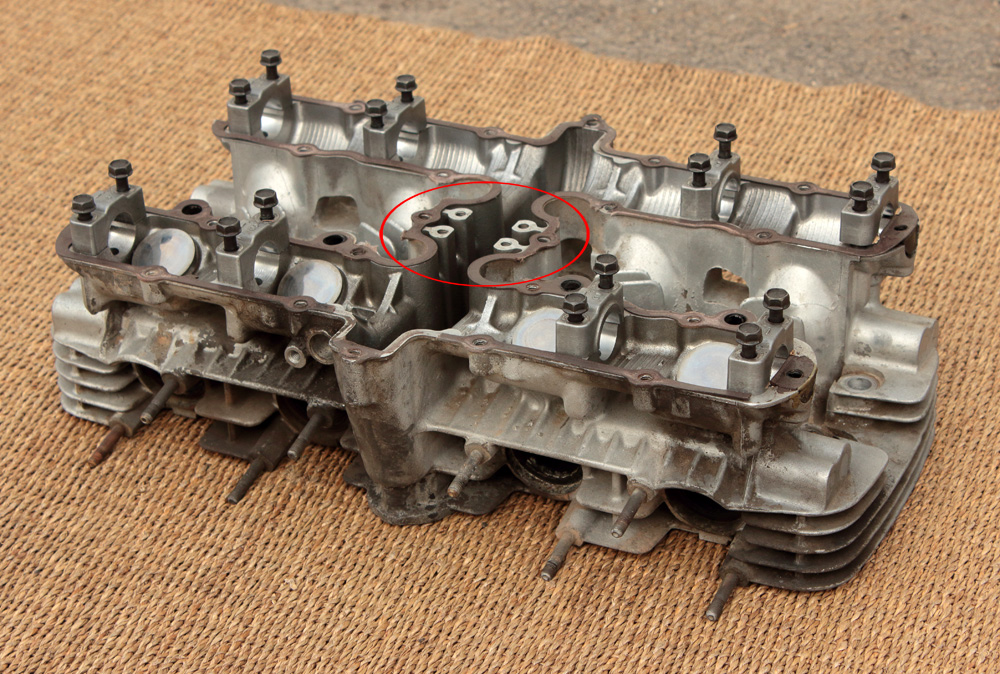

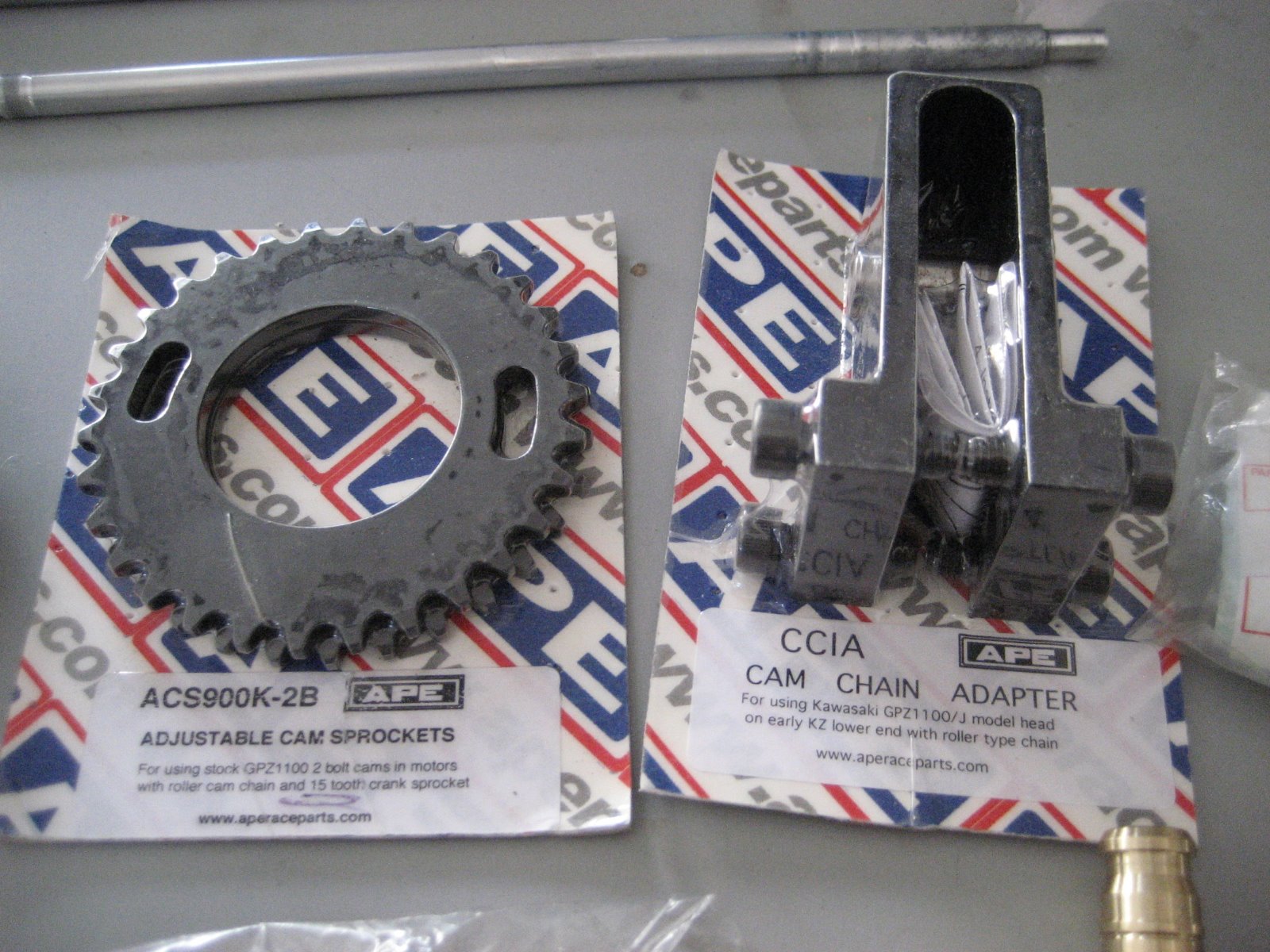

Only early KZ750 heads fit KZ650 with roller chain. The distinctive feature is four mounts for upper tensioner sprocket:
I used to search parts on German ebay and webshops as they often are a source of good parts . I even know German names for most of motorcycle components. For the moment I see two offers that might be of interest:

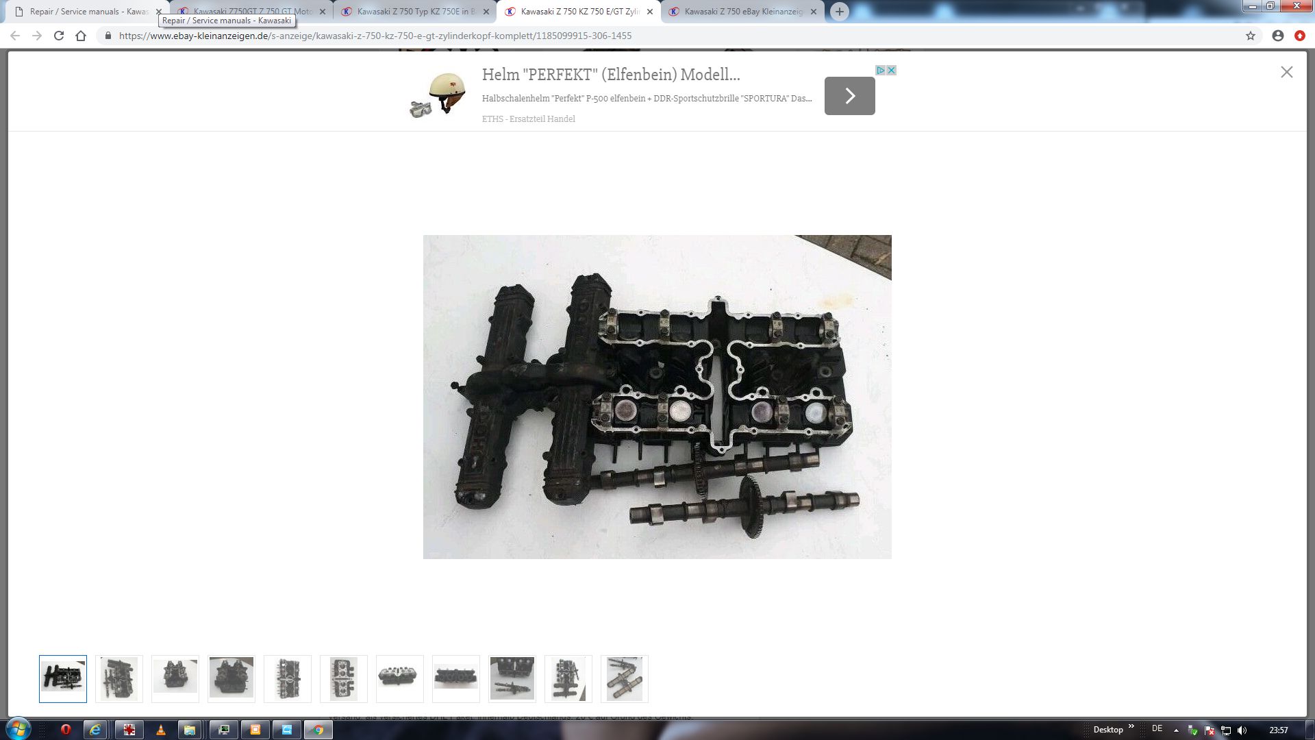

This one is perspective, but I need no camshafts and I am slightly worried by information about issues with threads in description. It also has small crack on lower mount of exhaust stud of second cylinder.
This one has no camshafts but it also has no detailed description and seller has quite low rating. Seller also made mistake in title. I found this lot searching for cylinders.

With your metal fabrication skills you can made your own CCIA for a KZ/GPZ 750 head gazzz!
A CCIA (roller chain) on a J/GPZ 1000/1100 cyl. head should work on KZ/GPZ 750 head with some modifications!?!?!
Give it a try gazzz.

Thank you! I forget that later KZ650 has same part number for cylinder head as KZ750. However first I'll try to find head closer to me as time is essential. I am already far out of schedule.
