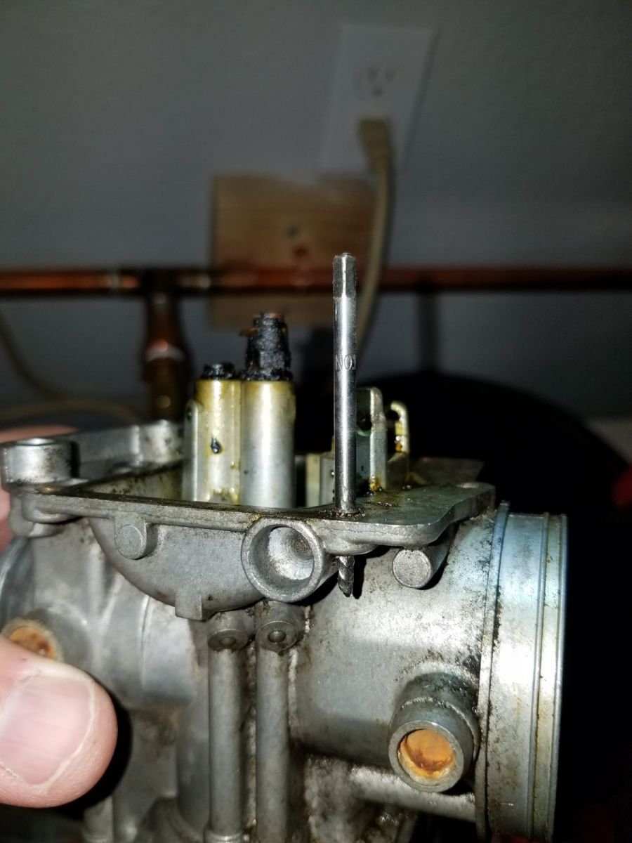

After a break for the Thanksgiving holiday (with lots of family visiting), I am back at it. I finally got the first carb disassembled and into the can of carb cleaner. It was a bitch getting those two float bowl screws removed, but I finally won. I had to get a tap (4mm x .7) to get all the threads clean. I also bought all new screws and lock washers for the float bowls. I am sure I will be doing this a lot with this project since all of the zinc plated factory fasteners are rusted.

I went ahead and ruined the screw driver slot on one of the primary main jets, you know, because it will be fun removing a boogered brass jet that doesn't want to come out... grrrr, I have managed to remove one of the plastic plugs (successfully). I haven't tried the others yet.

left hand drill bits are good for extraction

Those primary mains can be a bugger. I've striped the head on them before too and also had the threads strip out of the carb body. Be careful.

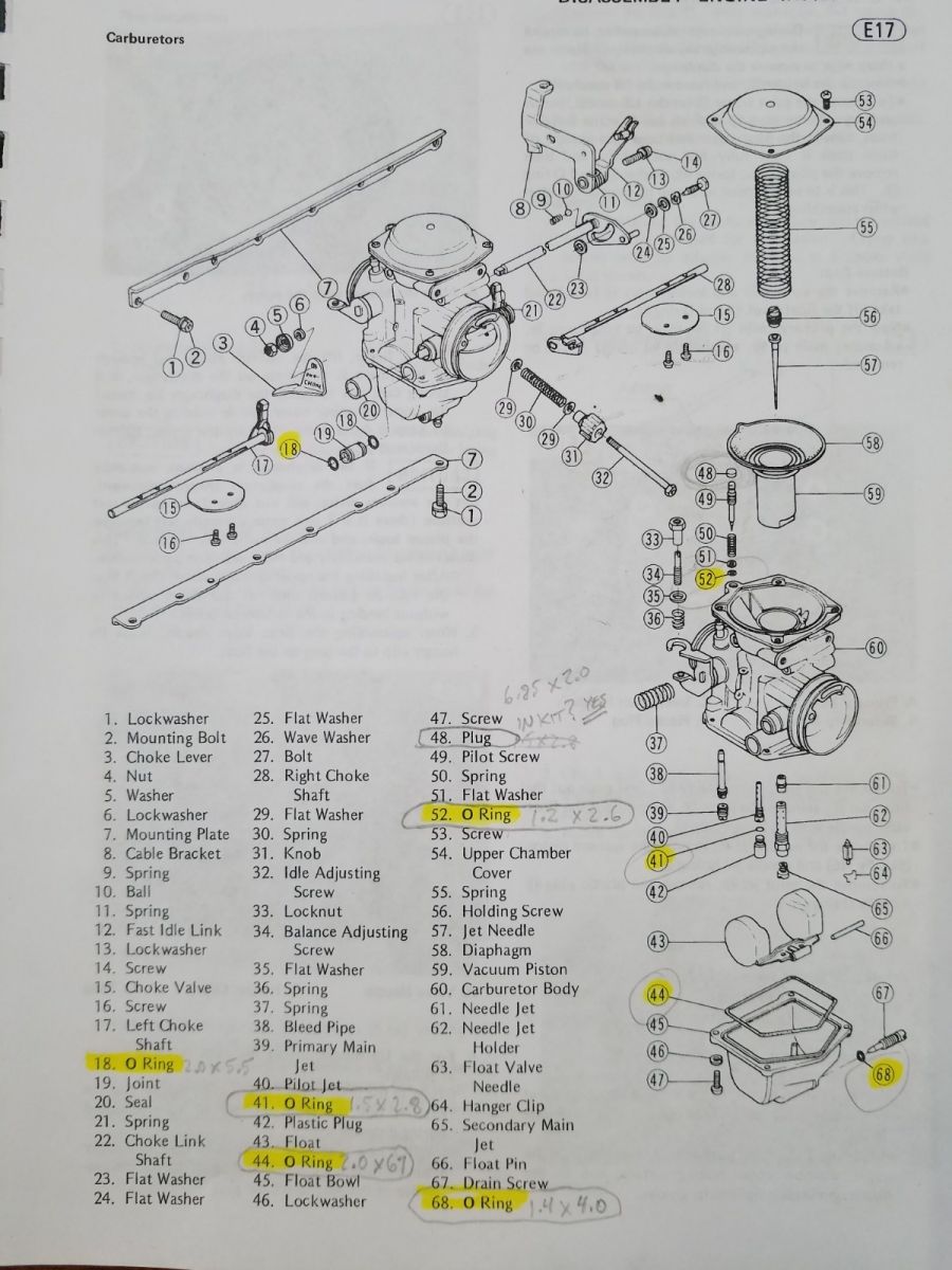

The Kiehin CV34 carbs have both a Primary Main Jet (the part I messed up), and a Secondary Main Jet. The DynoJet kit states t replace "the main jet" with the one supplied in the kit (stage 3), but does not specify primary or secondary. It does state to make sure you are replacing "the main jet". The part I messed up has a larger thread than any of the parts supplied in the DynoJet kit. After checking on Partzilla, the part I messed up is no longer available. Has anyone run into this issue with the DynoJet kit before? I am assuming due to the thread size it is the secondary main jet that gets replaced - but then I need to find a source for the jet I messed up. Partzilla p/n 92063A.

#39 Primary Main Jet
#65 Secondary Main Jet
Also, how does the bleed pipe (#38) come out? Or does it need to?

DynoJet technical support suggested replacing the "secondary main jet" since it was the only one of the two that had the correct thread size (that was what I was assuming to be the case). Which leads me back to a source for replacing the "primary main jet" #39, in the diagram. Sometimes it's not easy to avoid damaging old parts that are frozen in place, soft material like brass, plastic brittled by years in fuel, etc.

I searched by year/model/carburetor parts, and they didn't show up. Thanks for the tip, Nessism! I find some things hard to search for on their website. Inventory is not cross linked very well.
