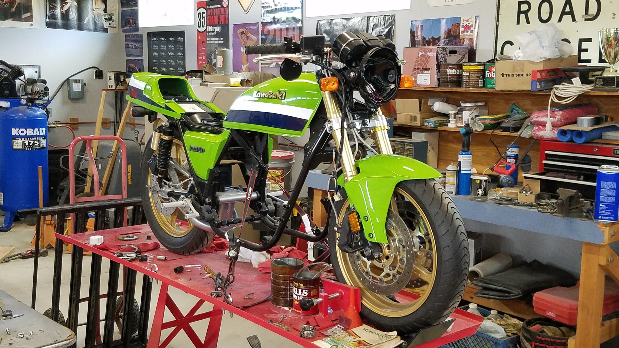

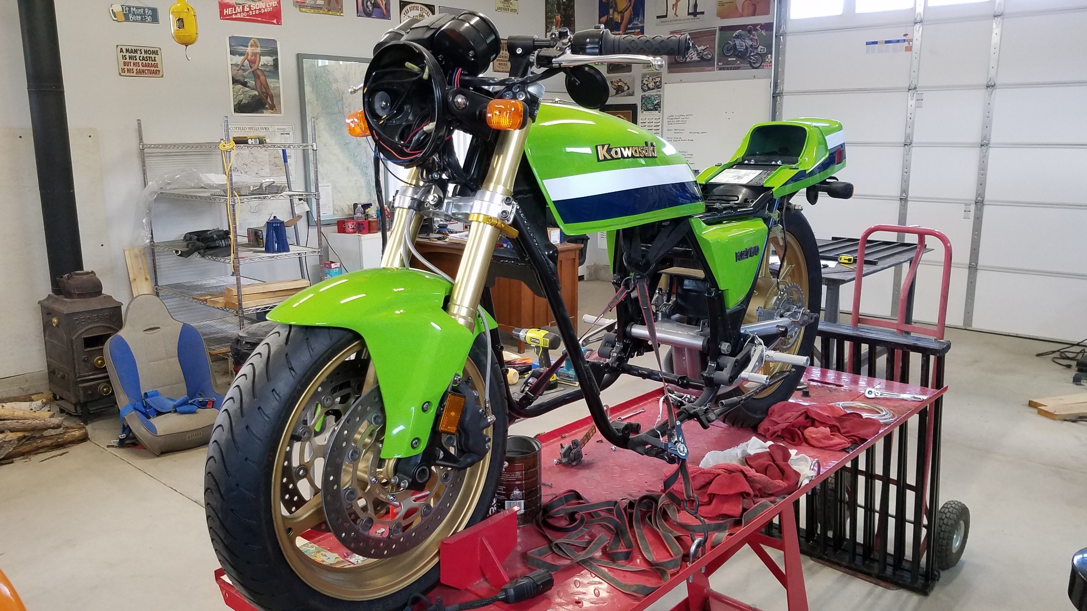

Re: Saving a '81 KZ750-E
13 Jun 2020 17:22

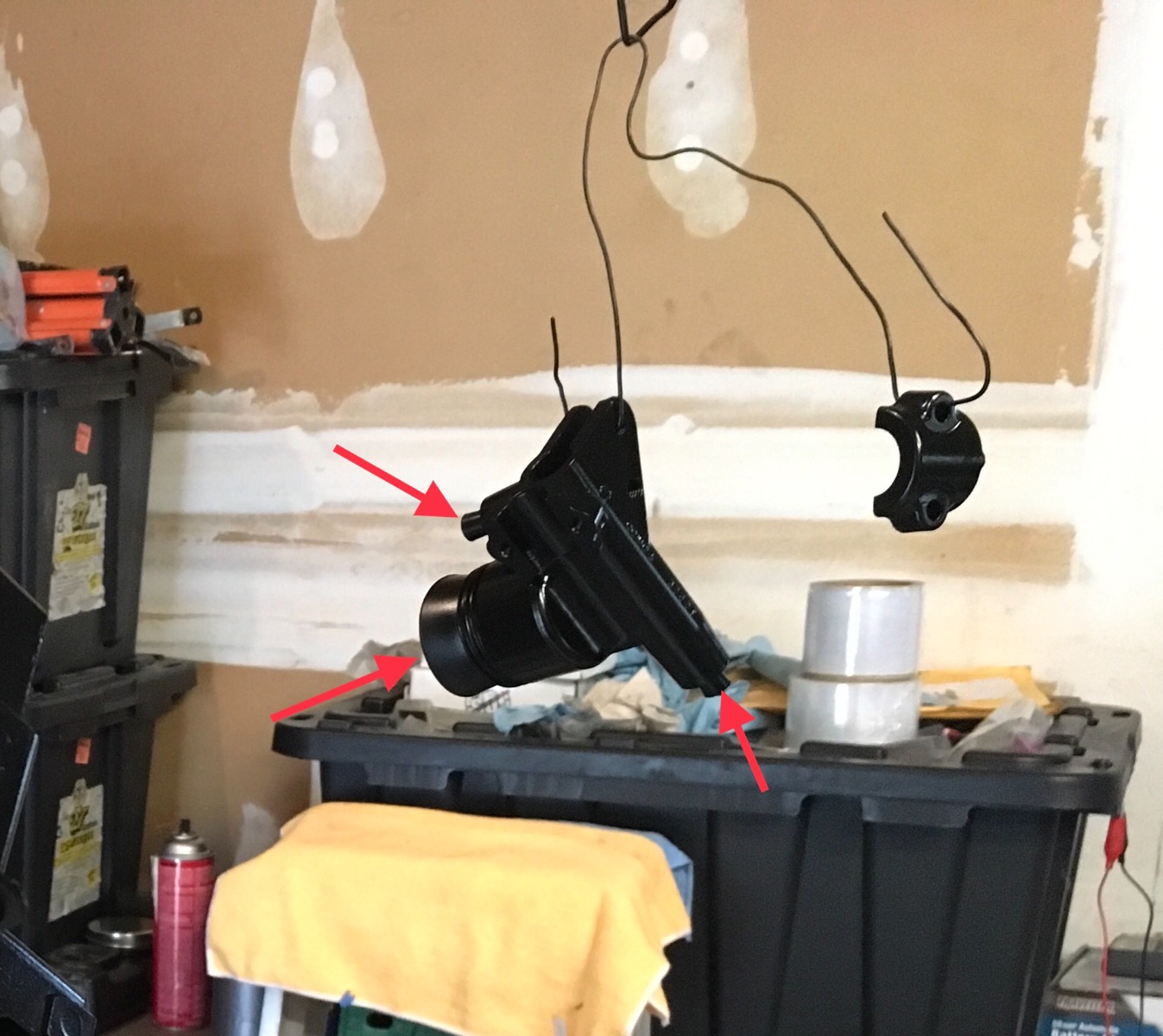

Got the tail cowl and front fender bolted in place. Had to post another view! I can't stop staring at this bike!
13 Jun 2020 17:48
Looking good! I just spent all day battling with a set of very similar forks (2012 Hornet). A very special case of idiocy, that damper design :pinch:

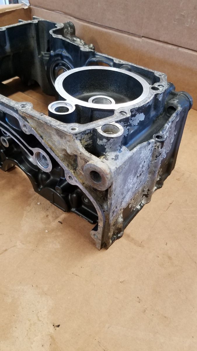

I am looking for ideas to soften up the 40 year old cylinder block gasket that is stuck to my upper case half. After a couple hours with a single edged razor blade, I figure there has got to be a better way. It's almost like the paper gasket has begun to turn into the aluminum itself. I am not making much progress here. I was considering using the phosphoric acid solution I used on the tank - apply it with a paint brush, and keep the entire gasket wet for a period of time to see if it would make it easier to remove. Anyone have any garage hacks to deal with original factory gaskets that are stubborn to remove? I am all ears at this point!

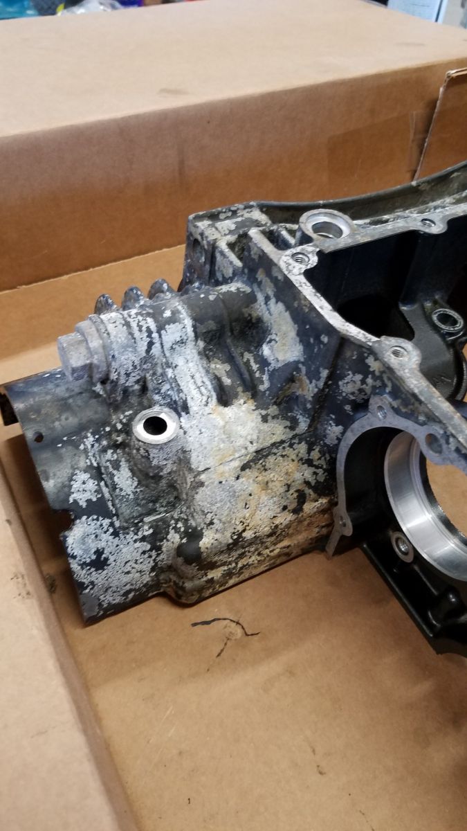

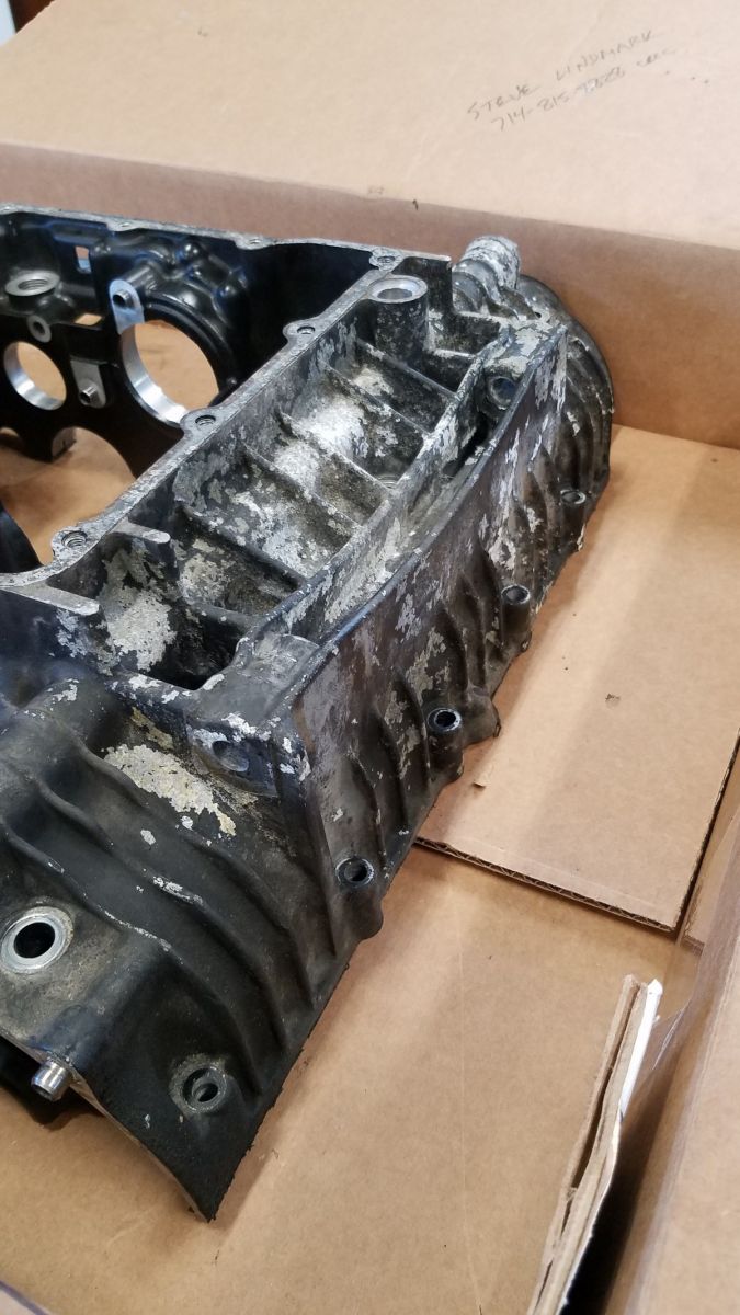

16 Jun 2020 13:53 - 16 Jun 2020 13:55

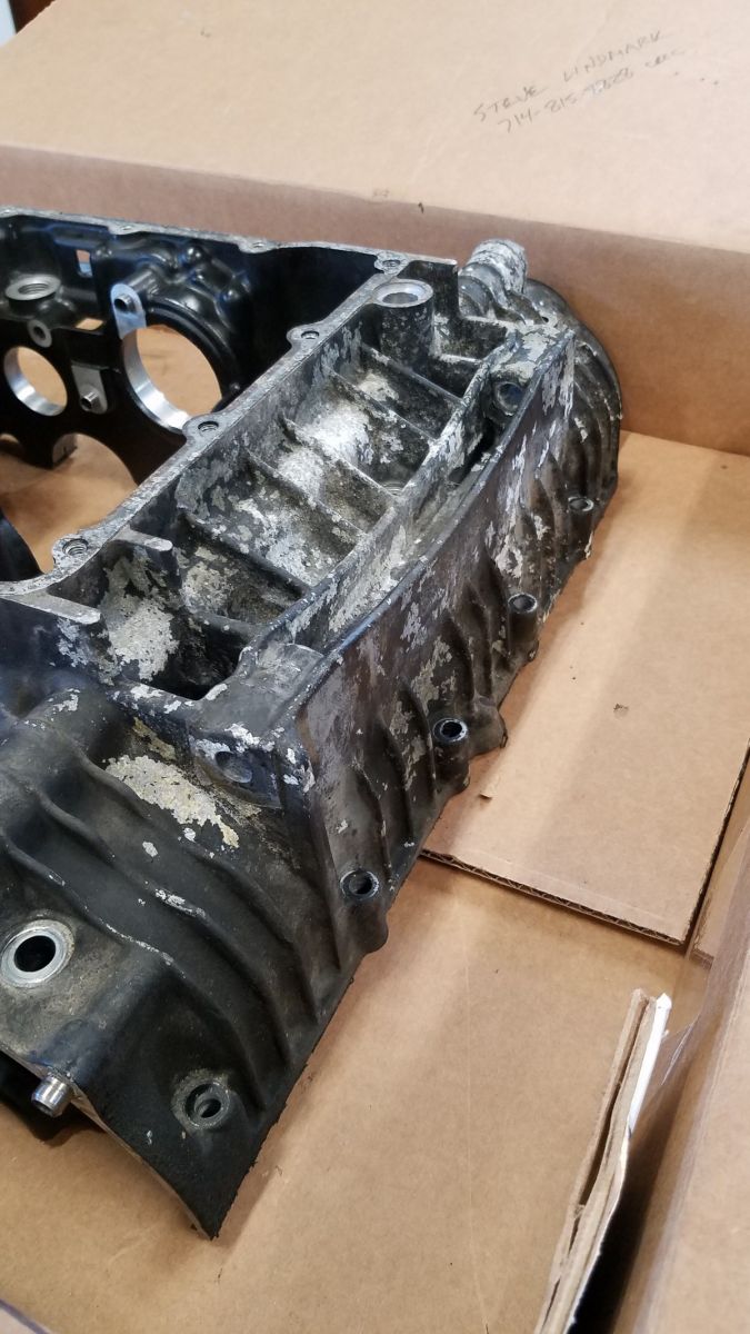

I picked up the other case half from the hot solvent tank today. To get this engine ready for paint a lot of surface prep needs to be done!
