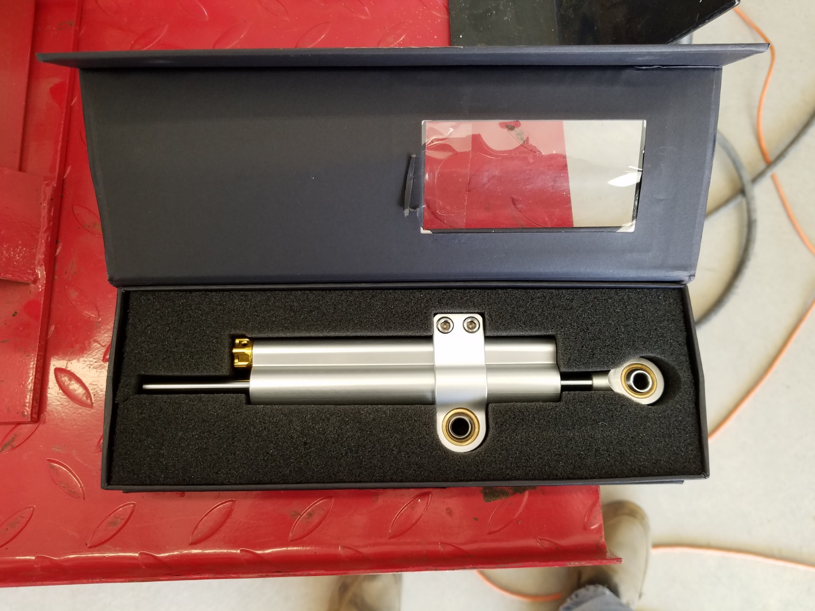

The last piece of the front end puzzle arrived today. This will stop those little wobbles from turning into tank slappers.
Retired gearhead
'81 KZ-750 E2
'81 KZ-750 E2

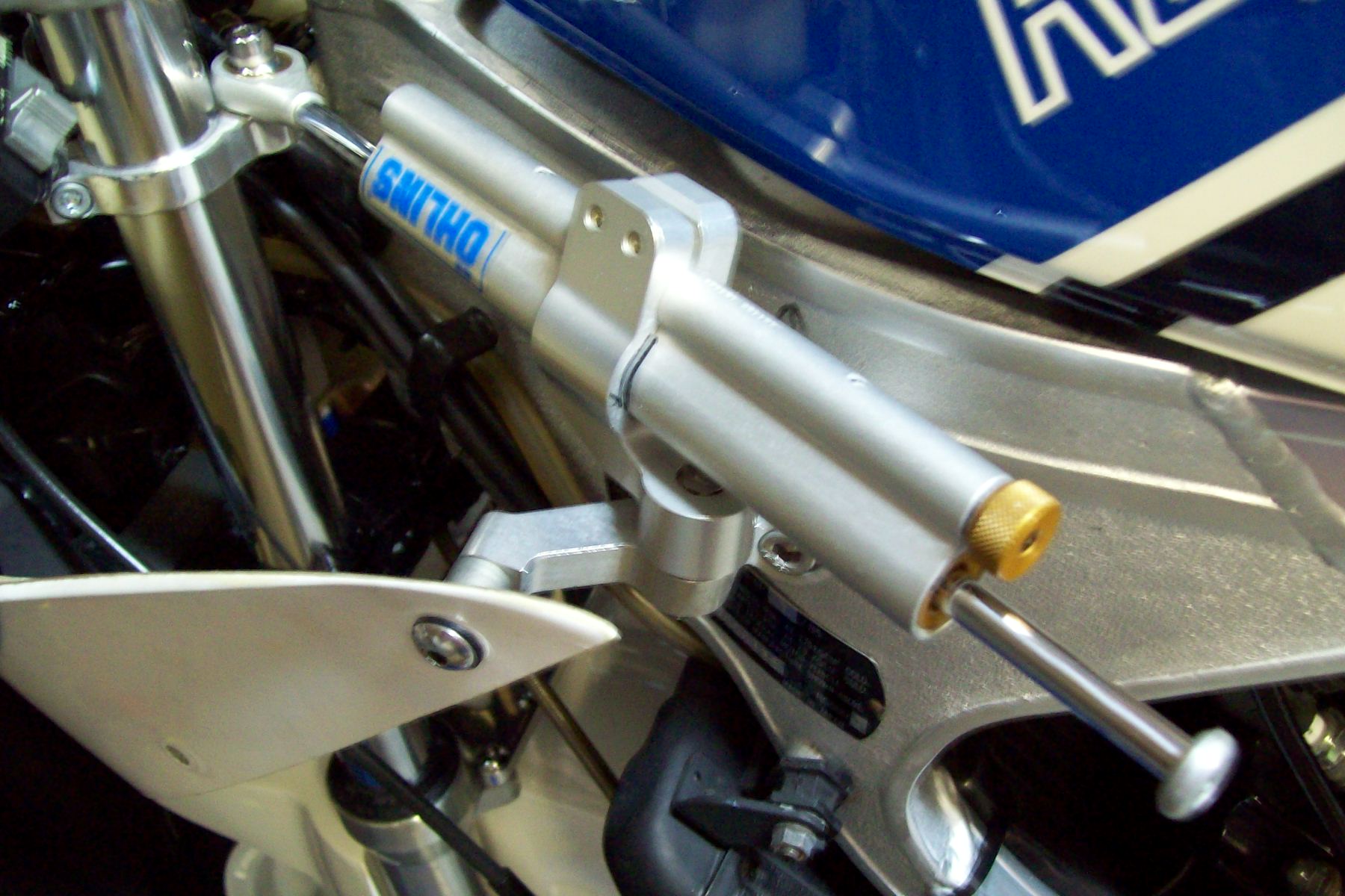

- Dr. Gamma
- Posts: 1231
- Thanks: 706
Re: Saving a '81 KZ750-E
02 Nov 2019 13:25Looks familiar!!!!
The best choice you could have made for a steering damper!!!!
Looks like the very same damper I used on my RG.
1986 RG500G 2 stroke terror.

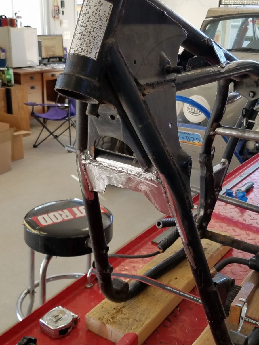

By reversing a bar clamp, I preloaded the lower front engine mounts outward .25" before welding.
After welding in the gusset plate, it came back right on the money. No change in distance! Lucky beats good every day of the week!
No, I don't weld the prettiest, but I get good penetration.

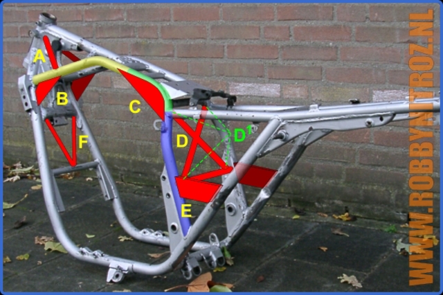

- Posts: 8144
- Thanks: 3527
08 Nov 2019 16:06
Looks like you have added a good bit of metal to that frame. What is your intended usage? It should make a pretty stable road racer.
Not sure if this link will work but this shows where the old skool racers guys used to brace the GS1000 frame (which is one of the better handling UJM's.) Brace point C is one of the more critical so you may want to go after that if you still have a hanker'n to add more.
kzrider.com/forum/attachment/90696

- Skidmark
- Posts: 1087
- Thanks: 312
08 Nov 2019 16:17
I would like it to be a capable track day bike, with a vintage superbike theme. I will ride it, keep it for a while, then probably sell it to help fund the next project (what that may be God only knows!). Originally I wasn't thinking about bracing it, but when it was brought up it made too much sense not to.
