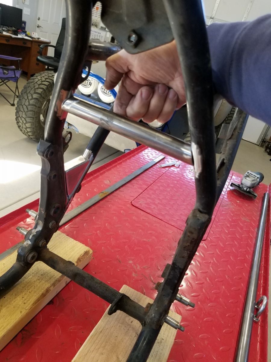

Instead of a cross brace behind the carbs/under the seat, I decided on a single cross tube. It's placed close to the mid point in the frame between the engine mount points and the frame junction at the rear of the fuel tank.
