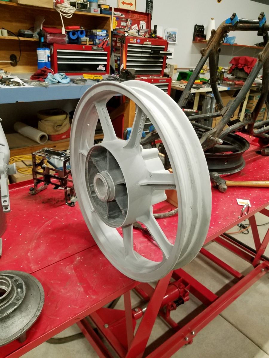

I'm happy with the results, but I end up waiting for the compressor longer than I can blast.

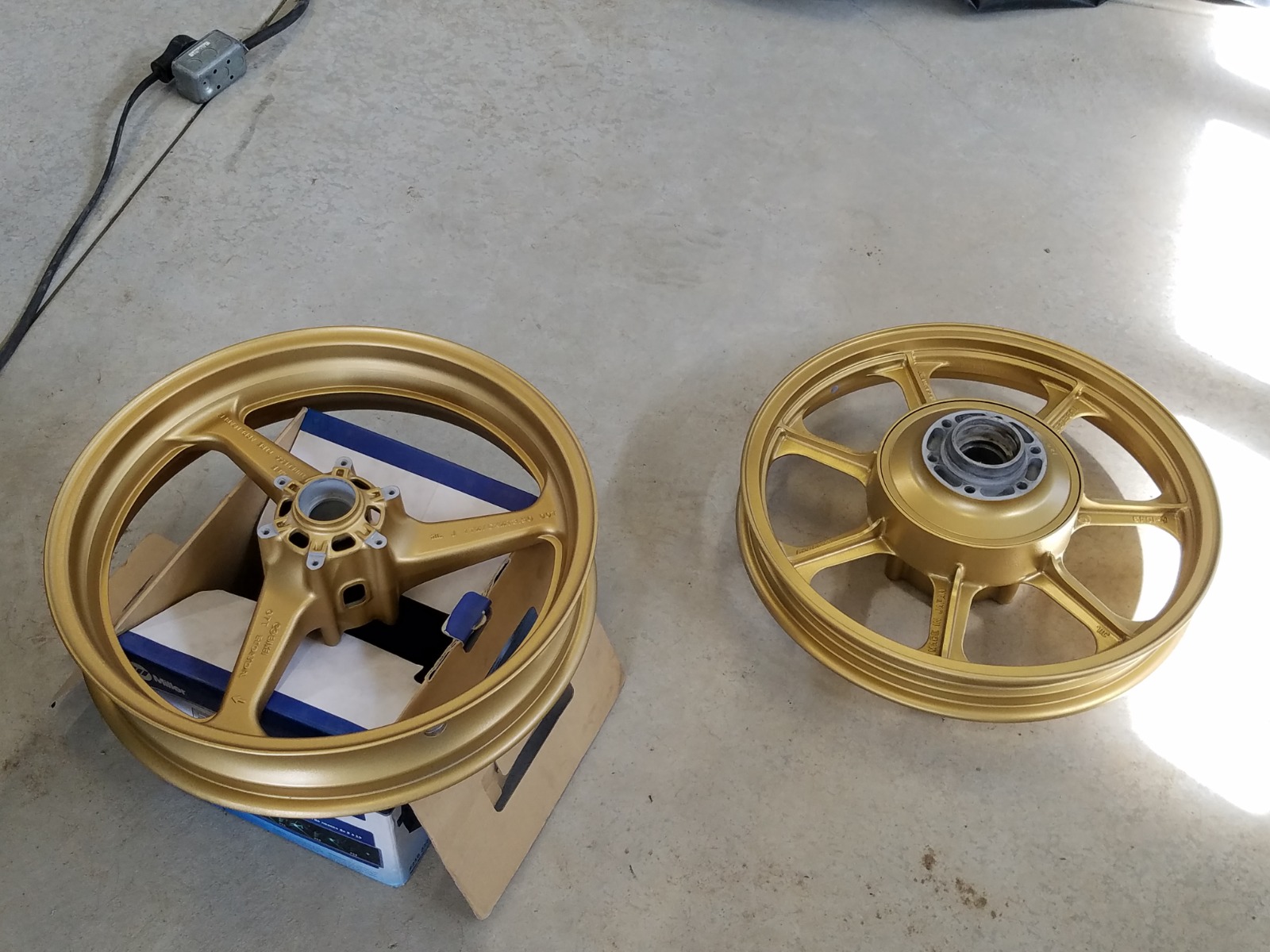

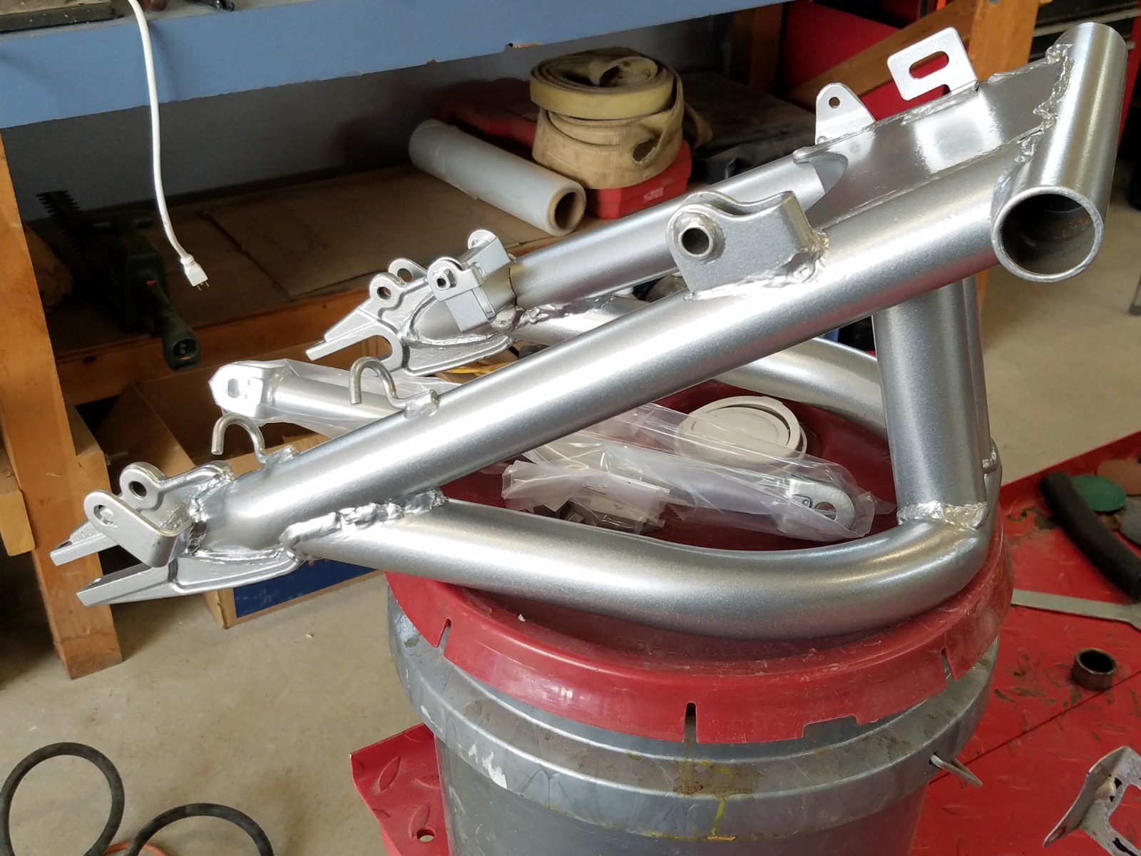

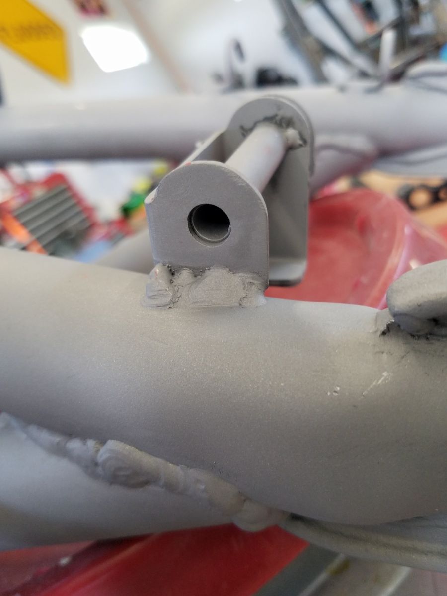

I'm not the best welder, but at least there's no porosity! I dropped of the wheels, drive hub, swingarm, and rear brake stay at the powder coating shop today. Looking forward to making the frame a roller so I can finish the fab work.

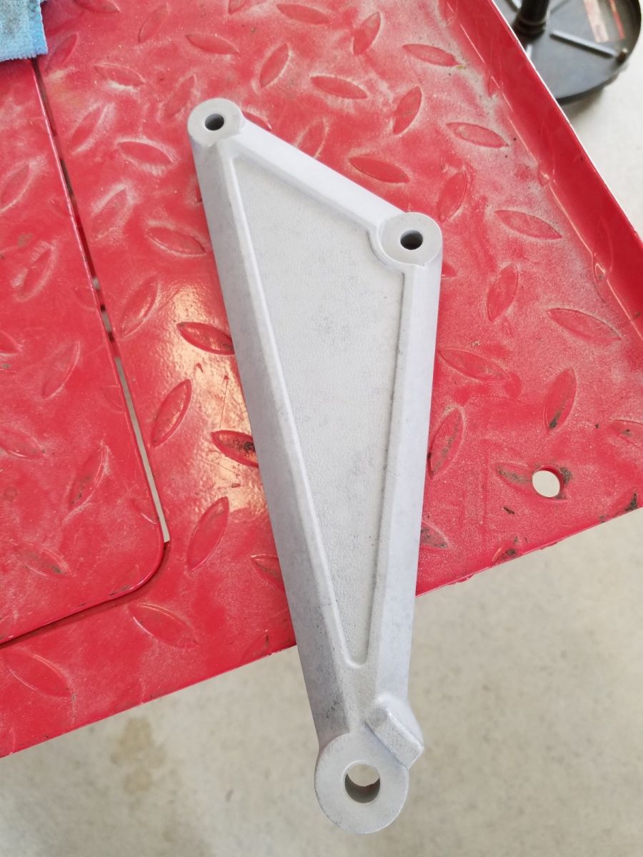

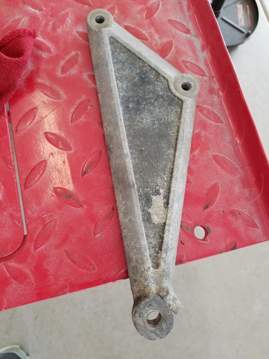

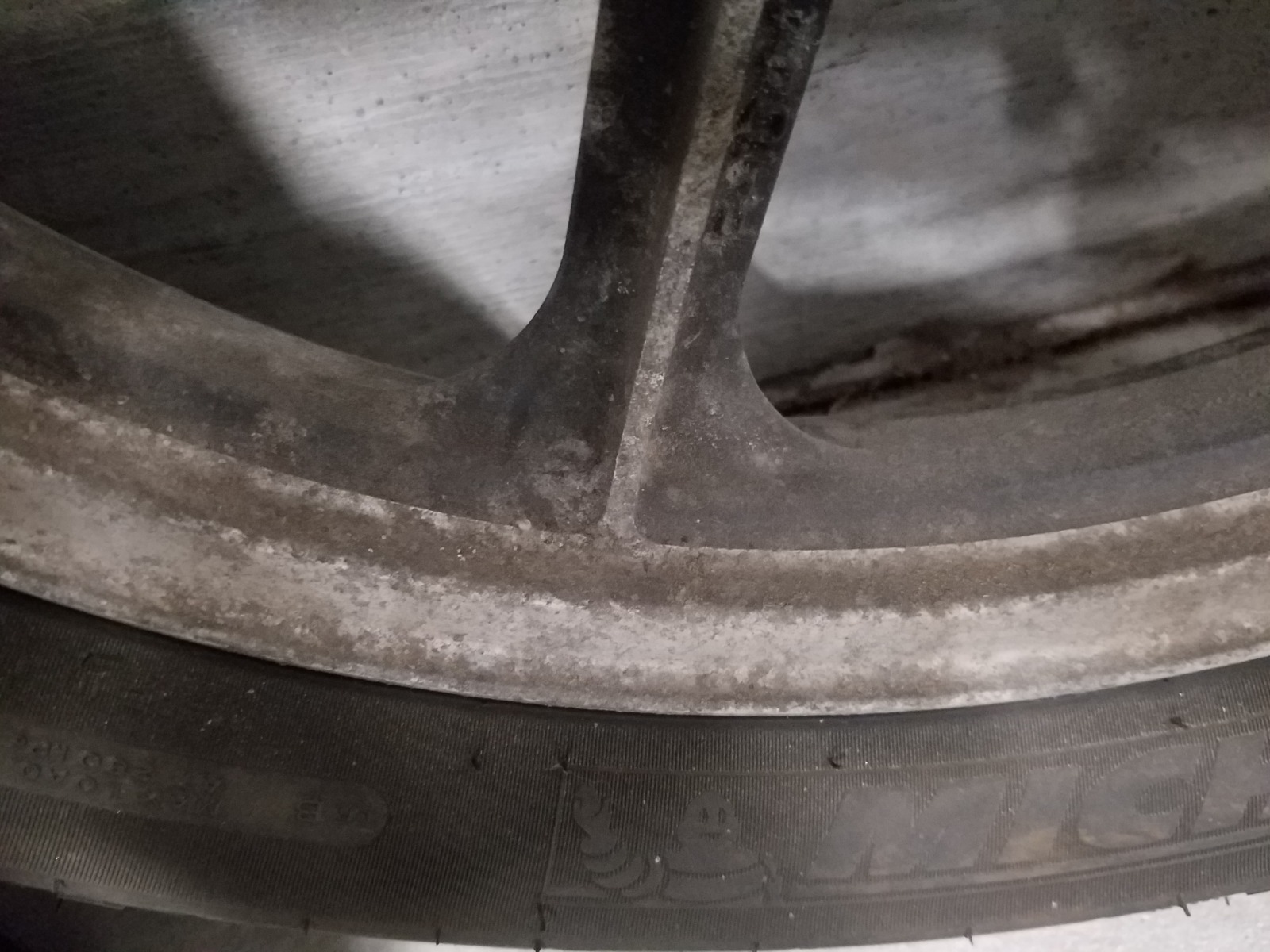

Most of the aluminum parts on this bike look really bad - until blasted, that is!
