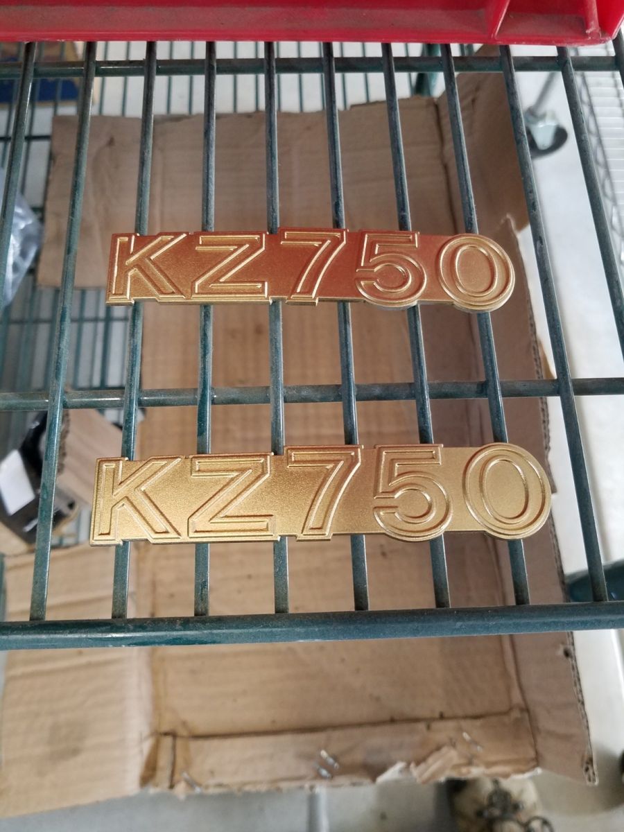

I am a bit concerned that the edges of the raised letters is a bit rounded, which will make it difficult to keep a straight edge with the "masking" grease. Maybe sanding them down a bit would sharpen the edge making masking a crisp line easier. If they don't come out well, I can always blast them clean and start over. Again.

If you just want the raised bits to be gold you could put another couple of coats of gold on, then a coat of black over the top. Then sand the black off the lettering and put a final coat of clear on to hide the sanding marks and protect it all.

that's gonna be tough to get a clean line with the grease. I have painted emblems with a small brush, with some patience you can get a reasonably good job, just use a lint-less rag with some light de-greaser to clean up as you go.

I am starting to think it might be easier to brush paint around the letters with the black paint. With a fine brush I could follow the base of each letter better than trying to brush the paint on top of the letters.

I tried hand painting the black background. I have found I don't have the hand control to pull of anything decent looking. So, I painted one completely with semi-gloss black. When it is thoroughly dry, I will sand off the paint from the top of the letters. If it comes out with good looking lines I will give it a coat of clear and call it good.

I would have preferred the letters to be gold, but the sanding method worked like a charm. I will coat them with a satin clear for the final finish.

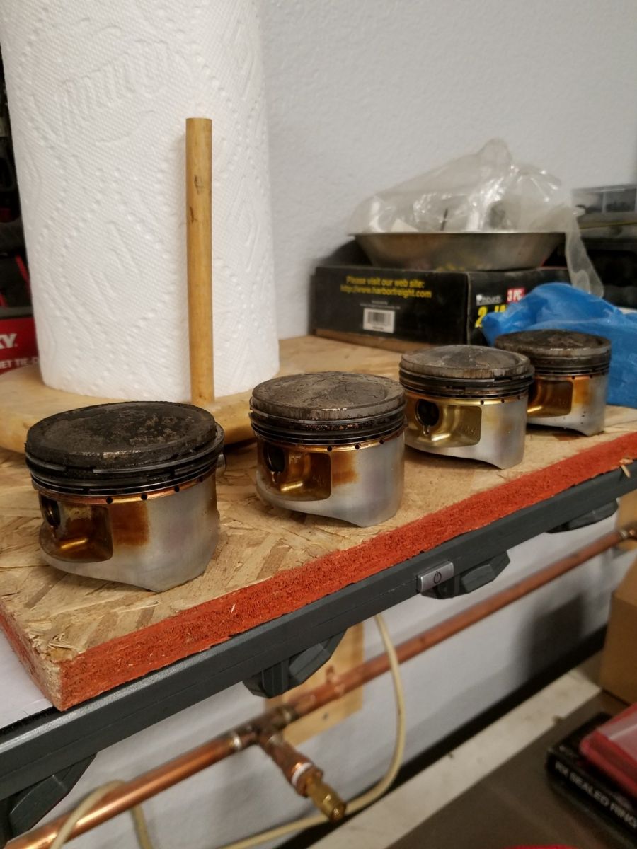

I got the cylinder studs and pistons removed today. Interesting discoloration pattern on the old pistons.

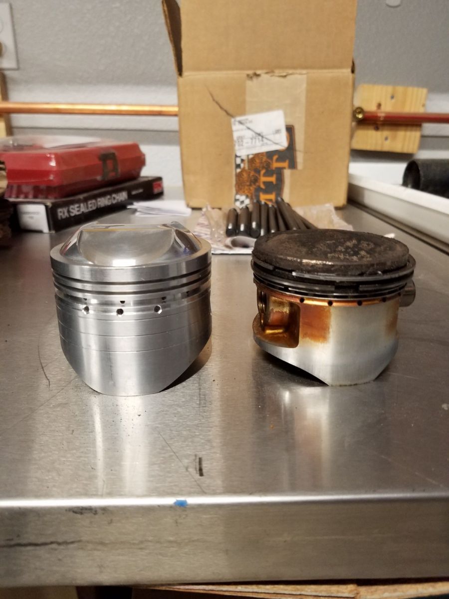

Here is the comparison shot of the stock piston next to the high compression piston.
