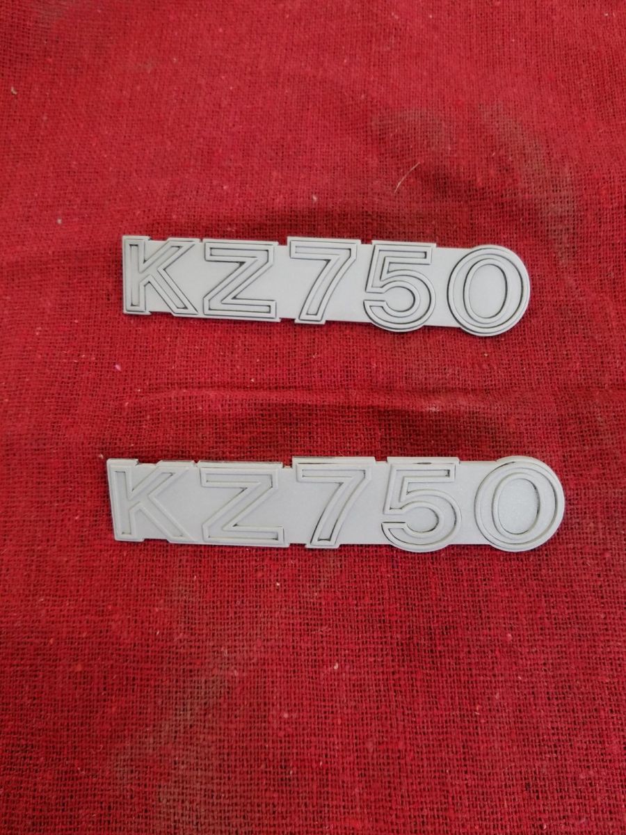

as far as painting the letters, a trick I picked up from a member here is to lightly pat grease on the flat part of the switches. then paint in the letters the grease acts like a mask. once the paint is dry remove the grease and the letters will be perfectly painted. works well.

Thanks for the tip on the letters. I've tried it the other way around (fill the already painted letters with grease and paint around them) but it was too hard to get the surface around the letters grease-free without removing all the grease. Your way sounds easier.

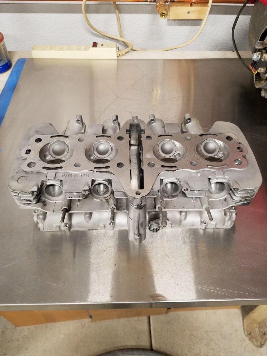

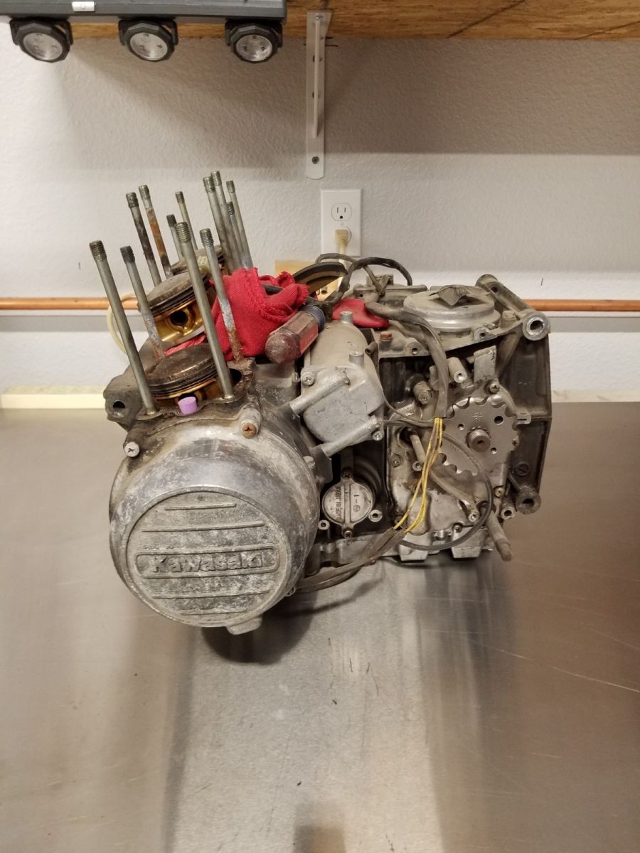

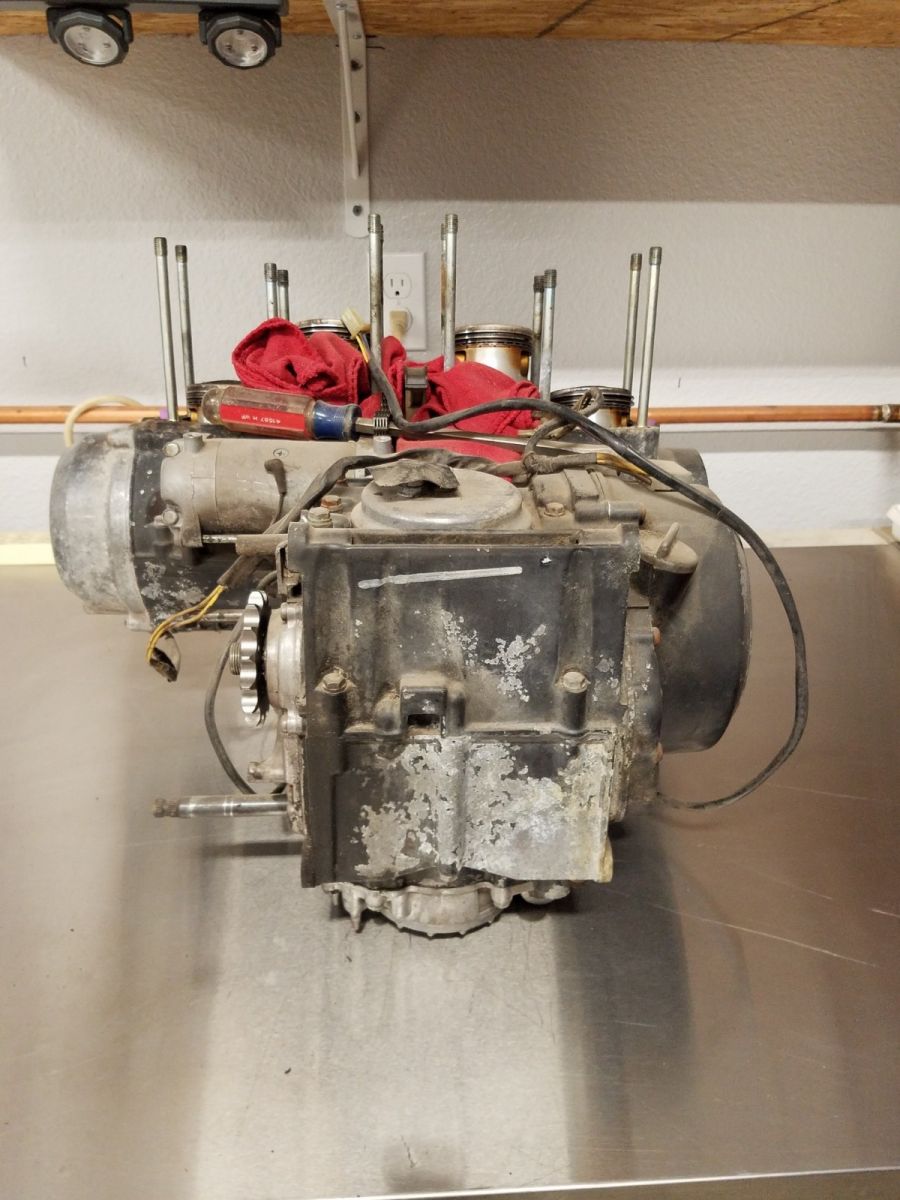

Look what I unburied today.

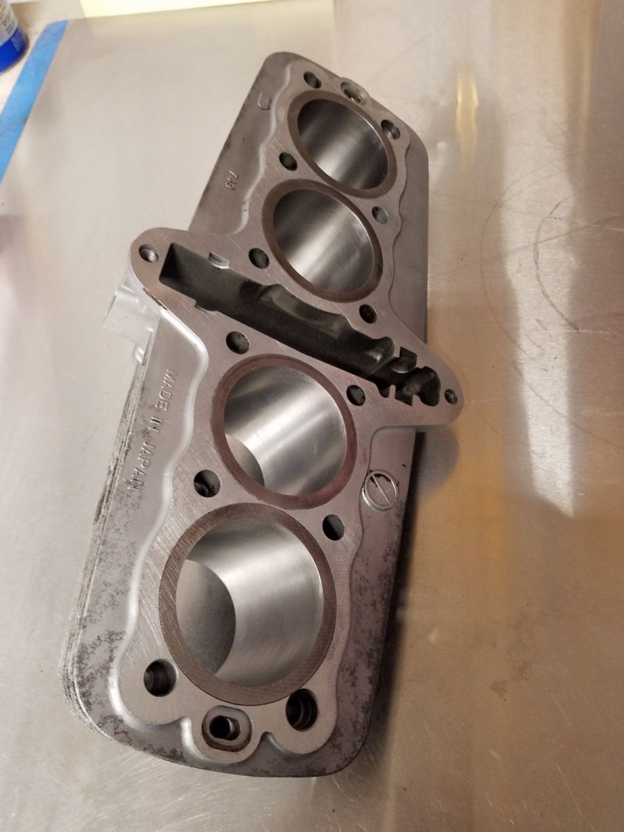

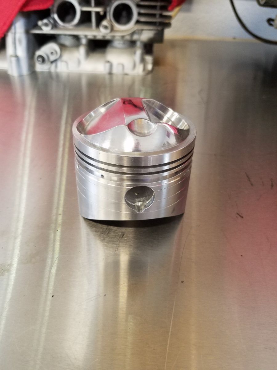

The new top end is ready to go. I had the valves, guides, seals, etc. replaced, and the cylinders bored. I had to go to 67 mm bore, and found a set of pistons in Florida. They are 10.5:1 compression, so all the head studs are being replaced. I still have some cleaning to do before paint on these.

The stock displacement was 738 cc, the 67 mm bore bumps it up to 761.5 cc. With the compression increase it should be fun to ride!

What pistons did you get? 67mm sounds like a good option.
- Skidmark
- Posts: 1087
- Thanks: 312
Re: Saving a '81 KZ750-E
04 Feb 2020 08:15
I purchased them from MTC Engineering. They manufacture racing pistons mainly for drag racing. They stopped making pistons for the older KZ's some time ago, but they had one set left in the back room on the "old stock" shelf. I got the last set they had. The shop I had do the top end machining done at gapped the rings for me when they did the cylinder bore and hone. That shop is Thumper Racing. He mainly does single cylinder four stroke dirt bikes, but he agreed to do my four cylinder as he has all the right equipment.

The polished piston dom is a pice of art.

05 Feb 2020 10:34

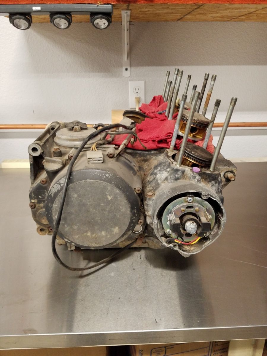

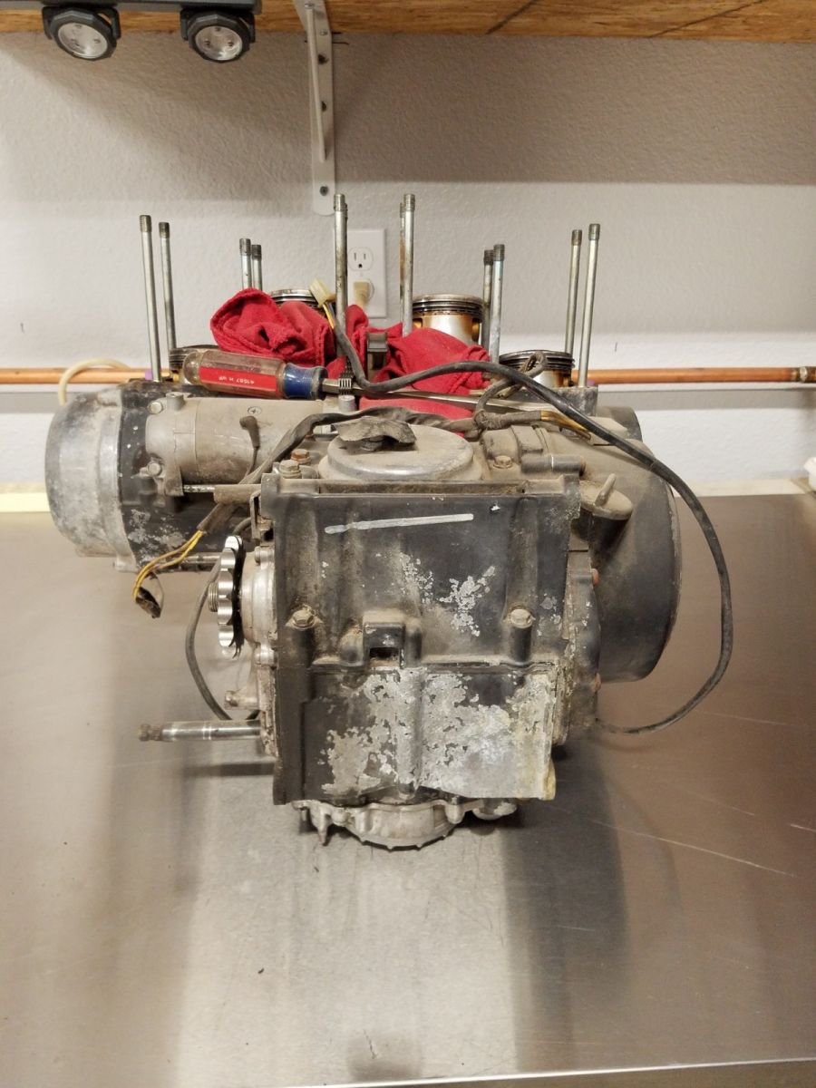

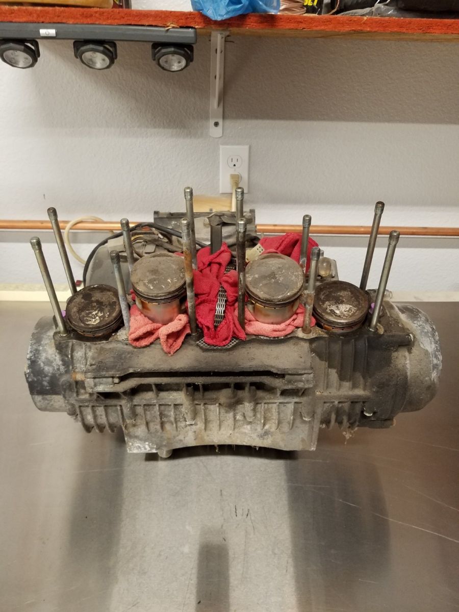

Anyone see an issue with using a propane torch to heat the case around the base of the cylinder studs? The factory studs are not wanting to play nice. I just didn't know if there were any reasons heating the surrounding area would be a problem.

After my attempt to repaint the side cover emblems failed, I am going with the grease method mentioned earlier. I painted the all black, then tried to paint the letters gold using a small brush. I am using Rustoleum spray paint, which is really thin and runny. Bad choice. This time I will spray them all gold, then after a couple days to dry, coat the letters with a light coat of grease. Then spray them over with the black. Fingers crossed that this will look better than my failed attempt to hand paint them!
