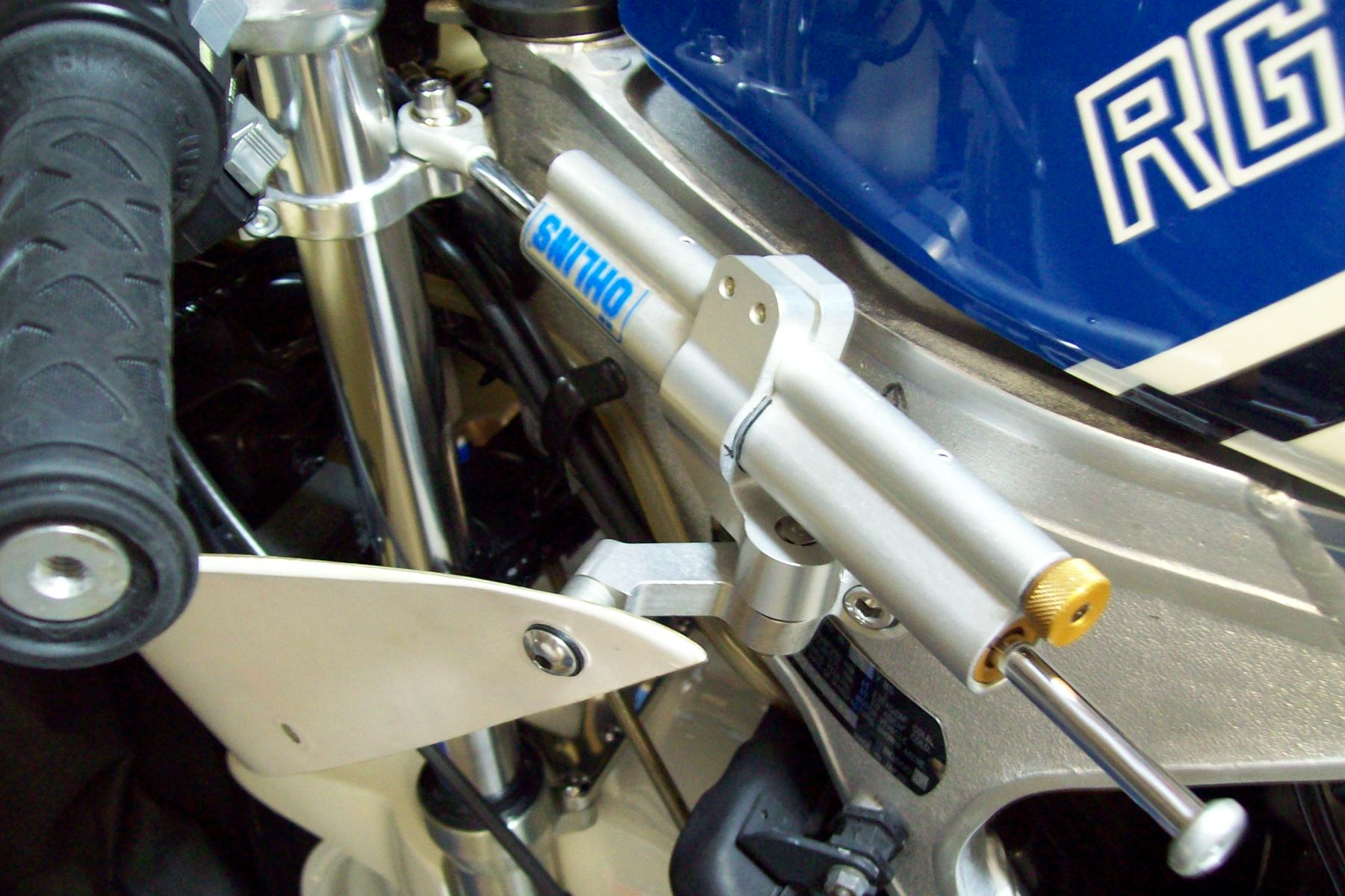

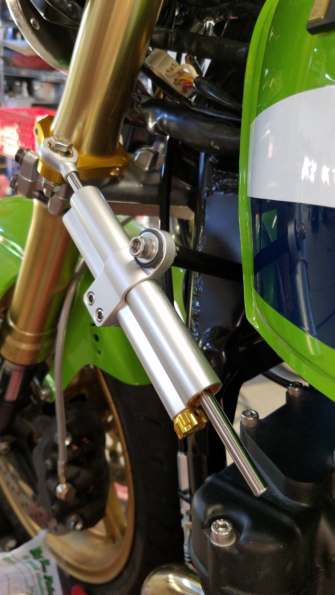

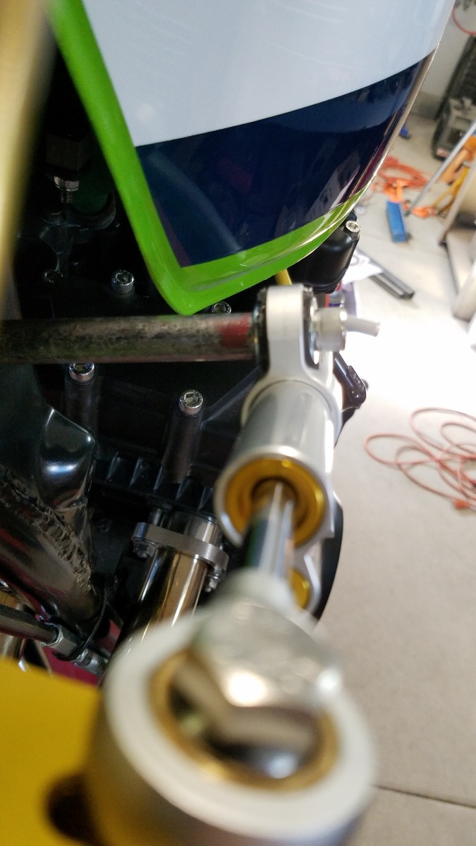

My Ohlins damper did the same thing. I just placed a thick o-ring between the the Ohlins damper bracket with the heim joint to where it mounted to my fairing bracket.
The o-ring limited how much the damper could move back and forth or side to side!!!

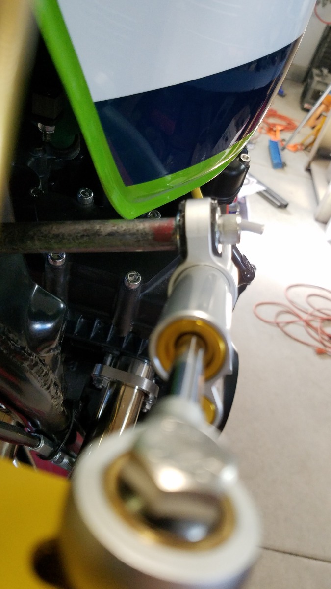

Two flat washers and some sections of fuel line cut to fit and all is good. Had just enough thread length for the washers and rubber.

I used a steel tube as a spacer, and used an existing hole in the frame. Once it is off the lift, I will adjust the rotation of the fork clamp.

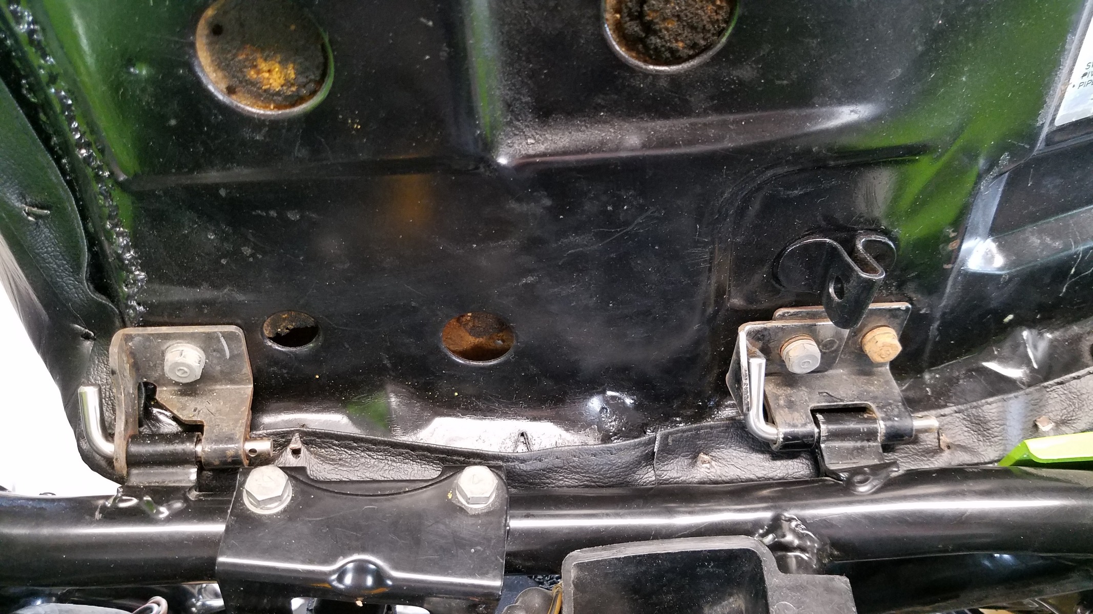

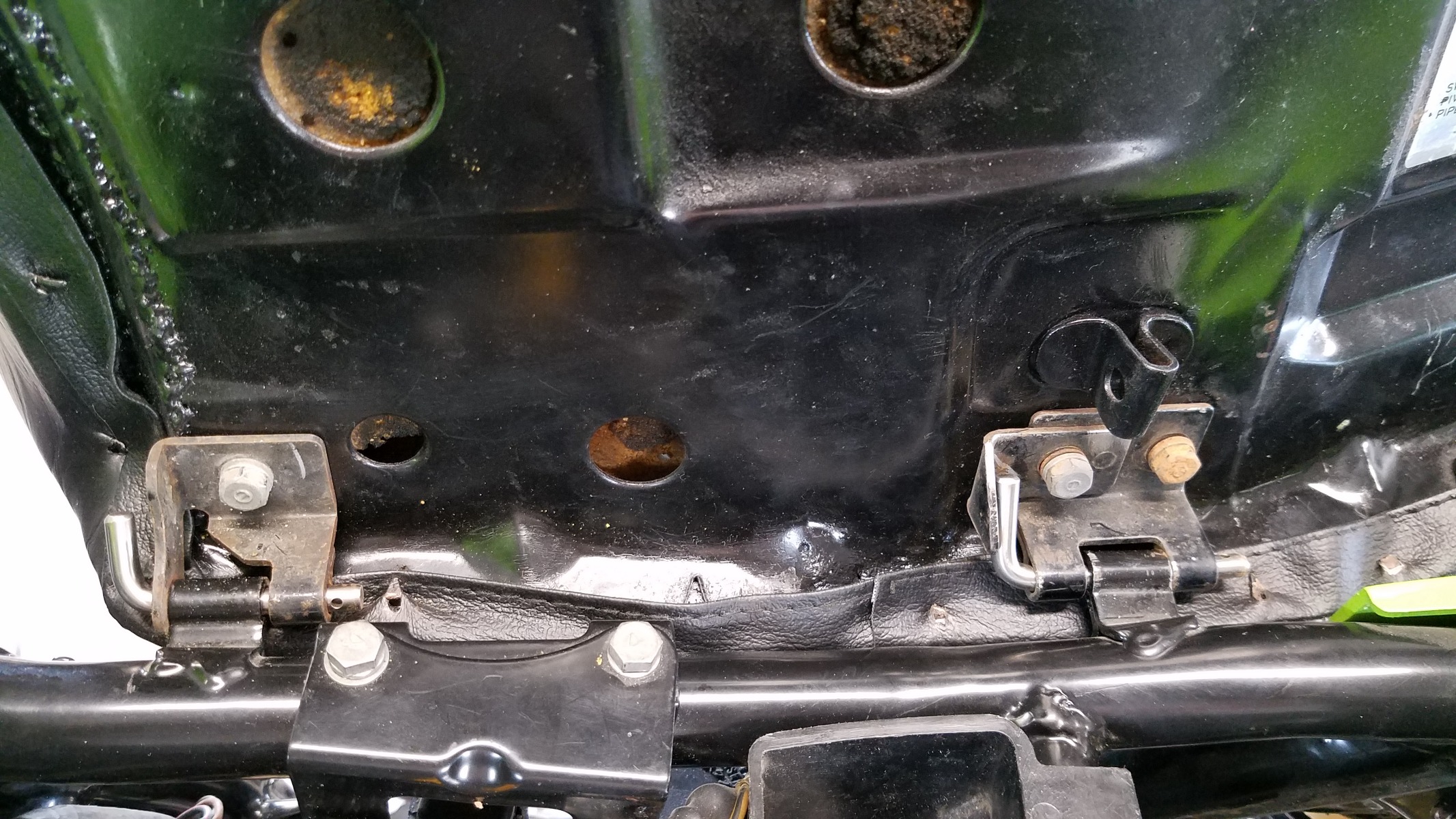

I made two new hinge pins for the seat using 6mm round bar, 18-8 stainless steel.

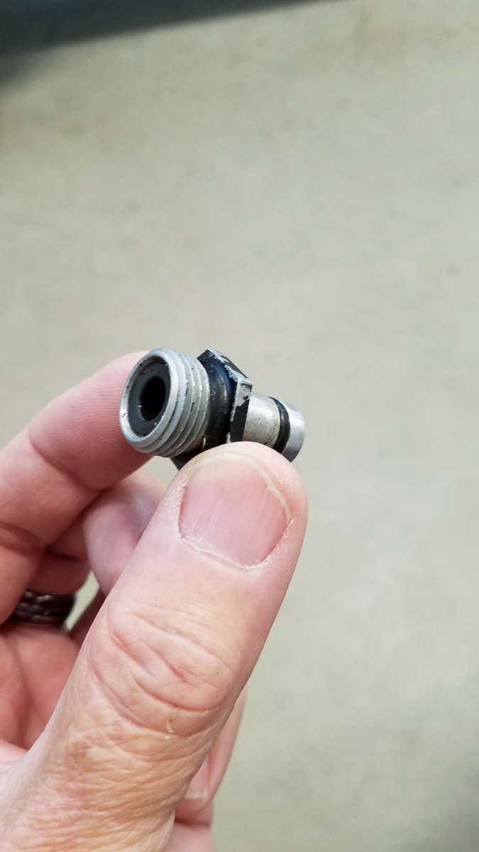

I couldn't help myself and rode it up and down my street yesterday. Discovered a small oil leak that needs to be addressed. I need to change the o-ring and oil seal at the tachometer drive. I must have missed replacing those when I did the head.

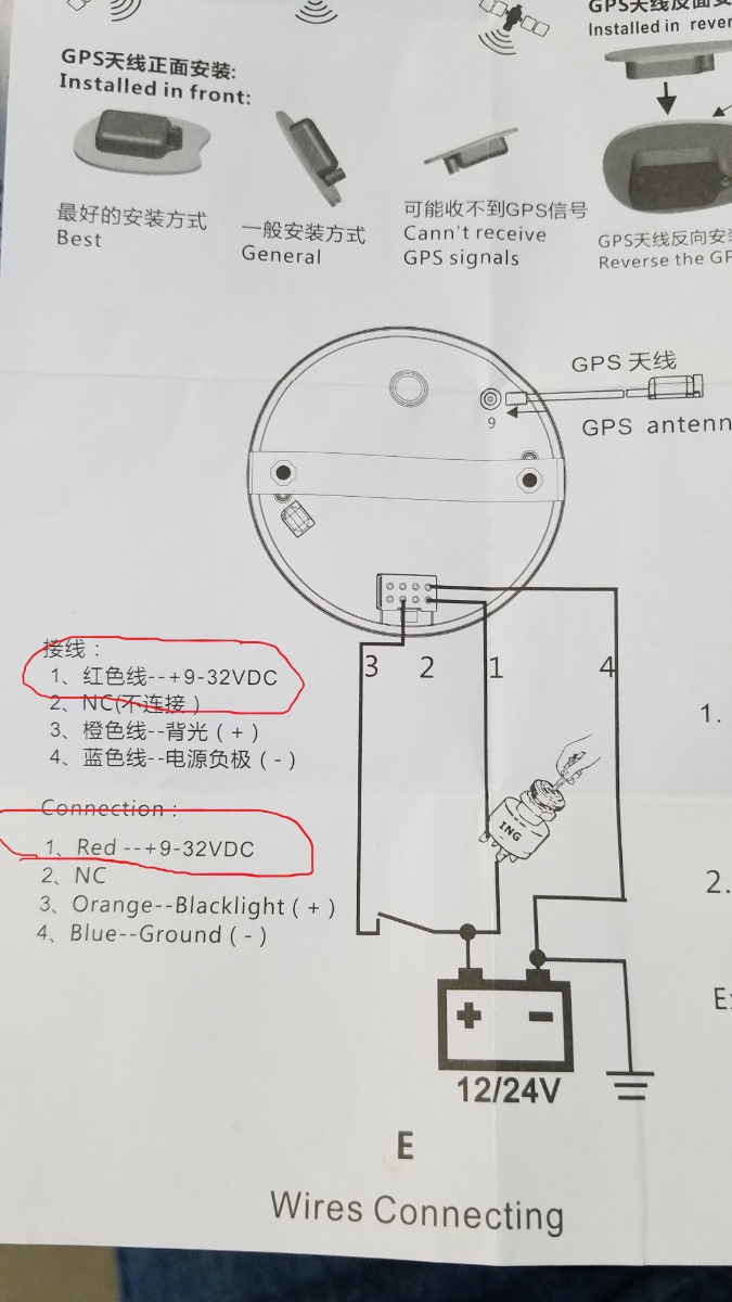

I am having an issue with my "Chinese" GPS speedometer. I must have missed this on the one page instruction that came with it, but it appears the power wire should only be connected to 9 volts. (see picture) The odometer LCD is only displaying the number 19. No error code, just 19. I only rode the bike a little over 1/2 mile yesterday, so the bike (and gauge) have not moved 19 miles. Assuming the voltage may be the culprit, how would I be able to reduce the voltage from 12v to no more than 9v? I am certainly no electrical wizard. The speedometer needle seems to be functioning properly on the short test ride. Unfortunately there is no customer support considering the gauge's origin.
