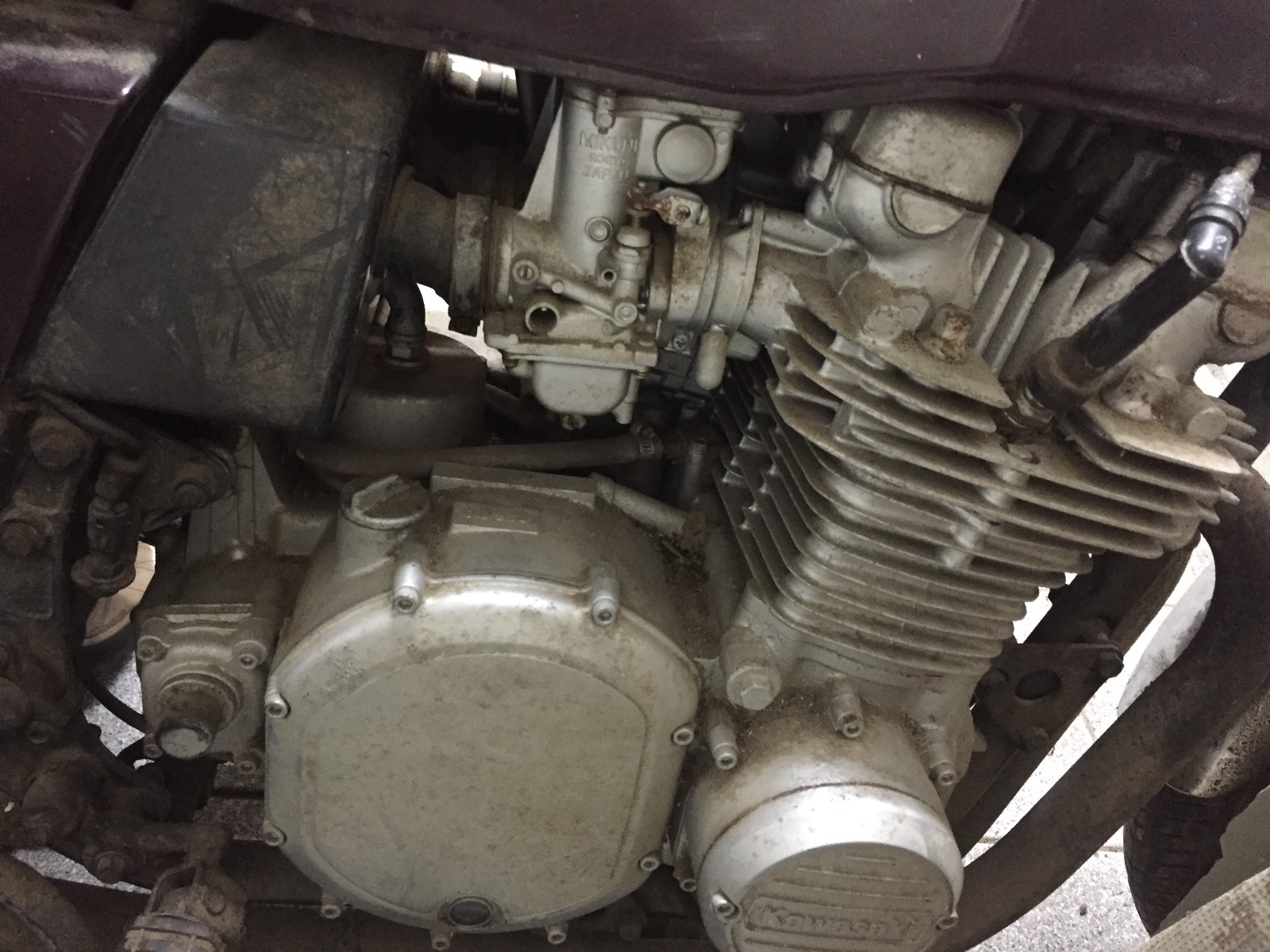

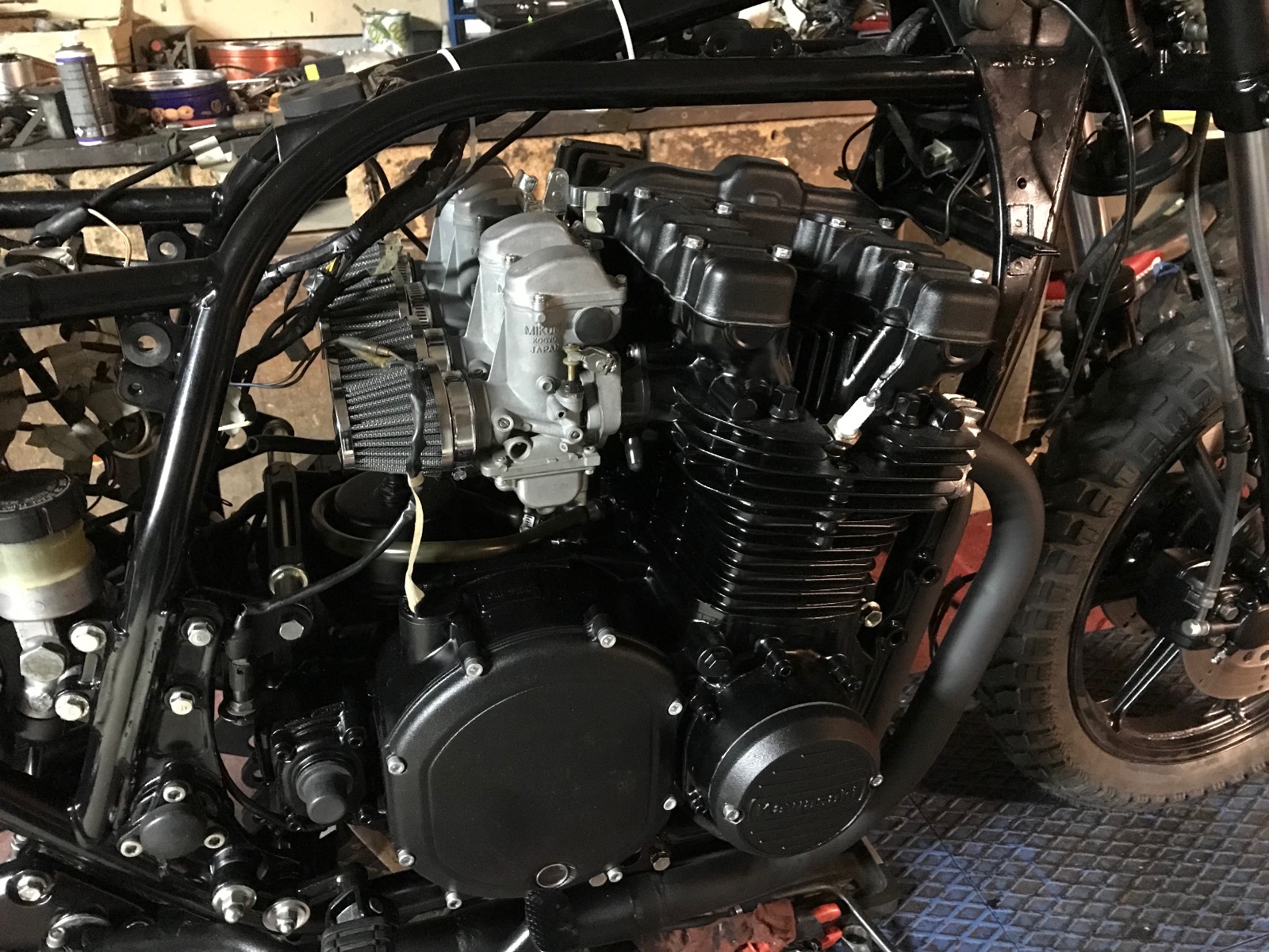

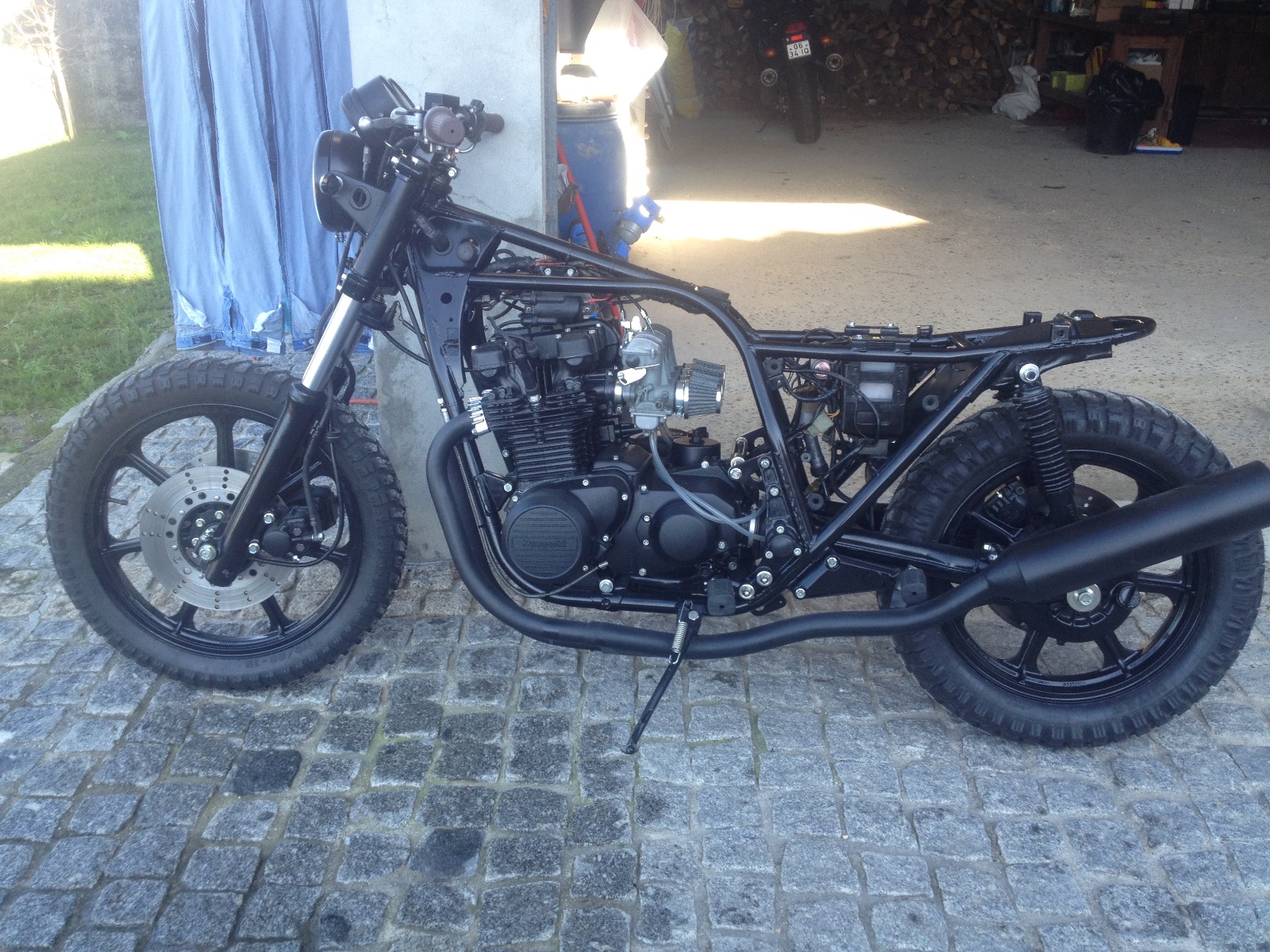

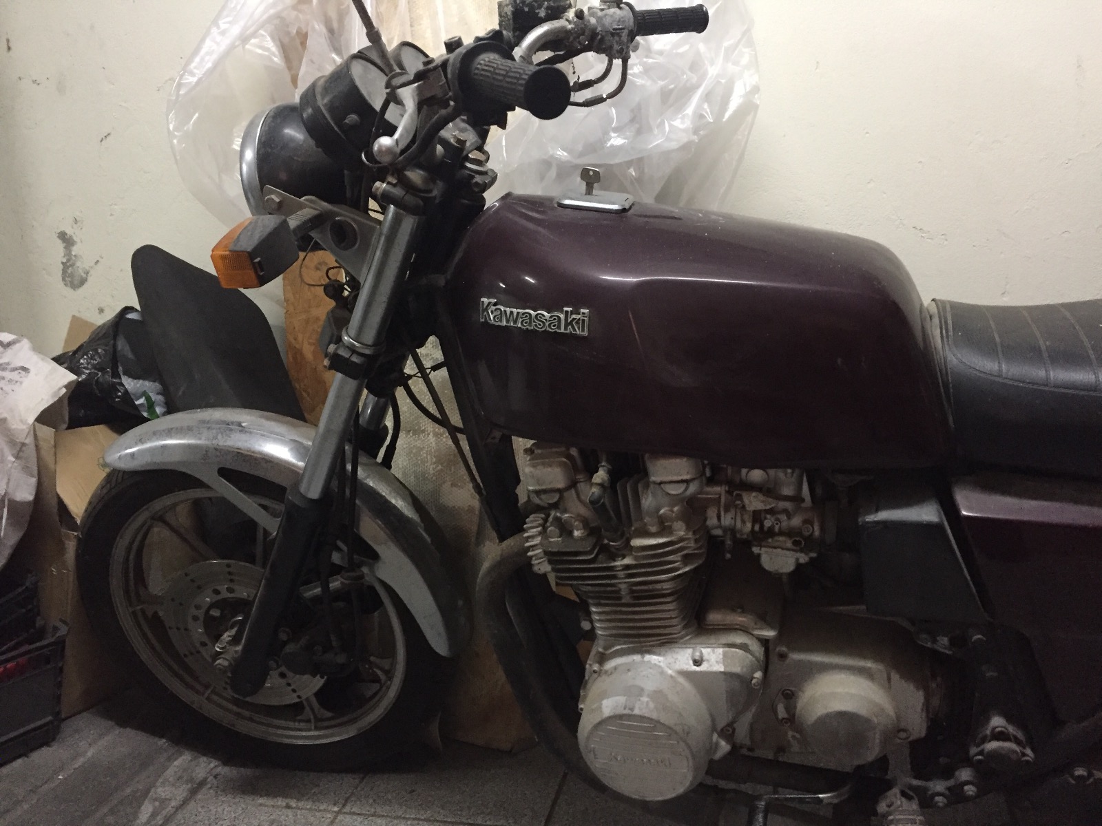

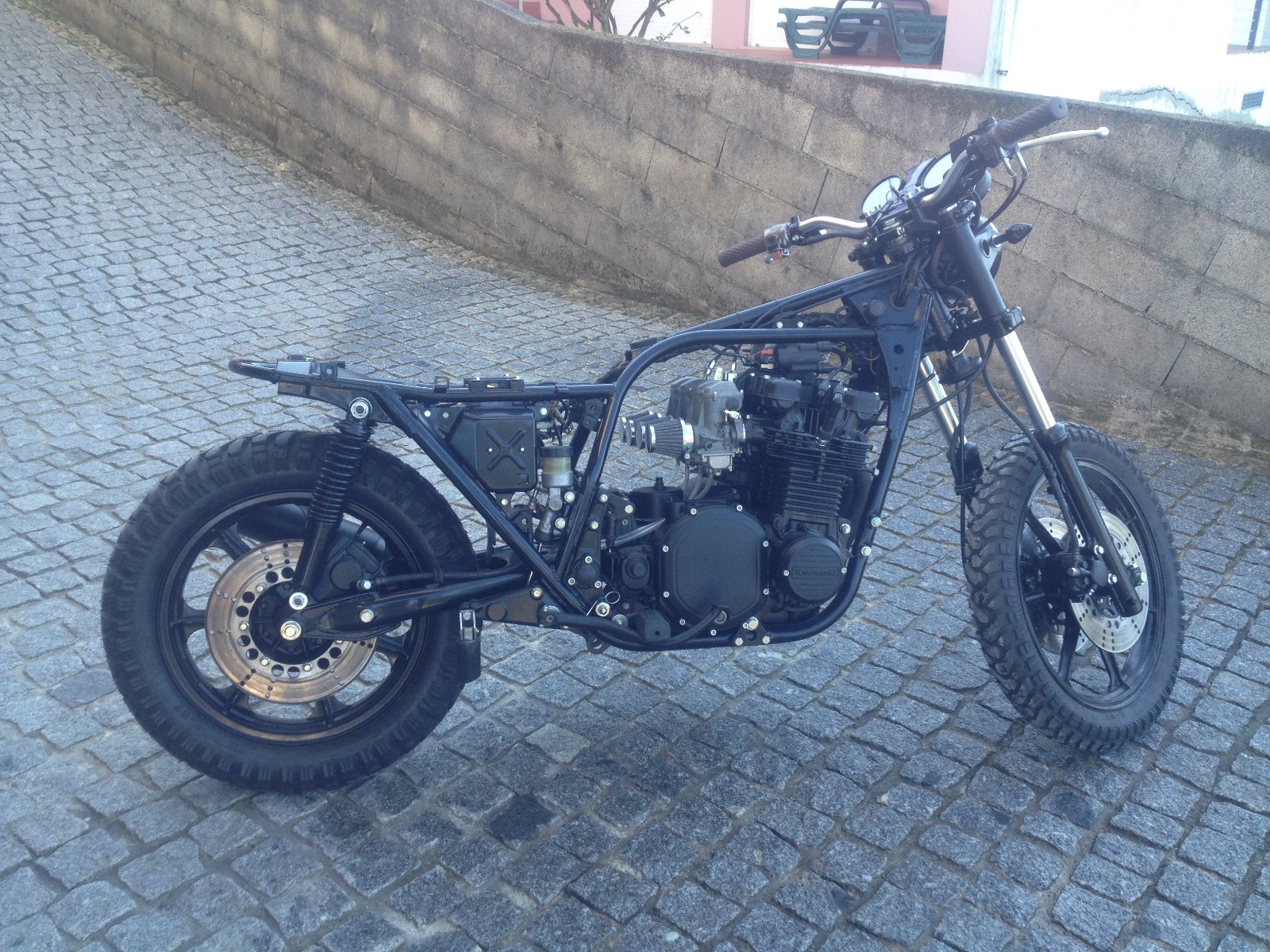

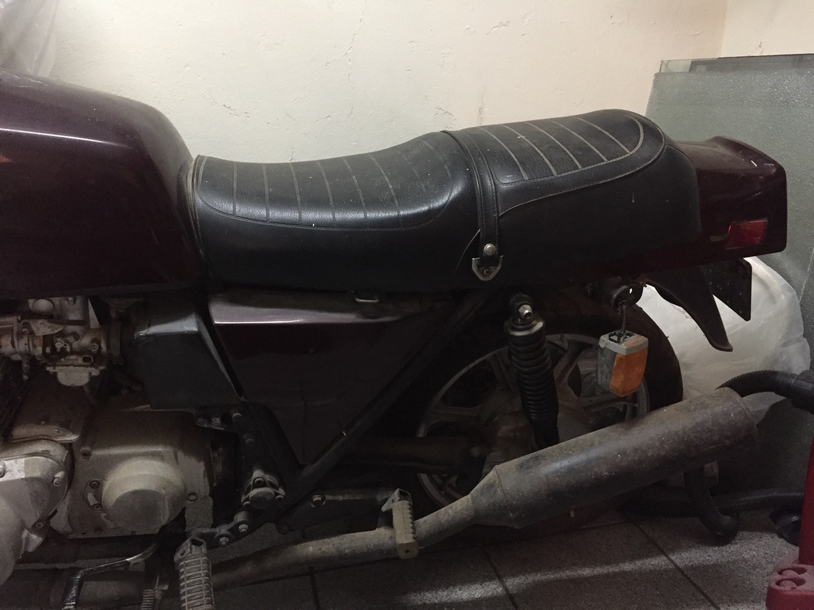

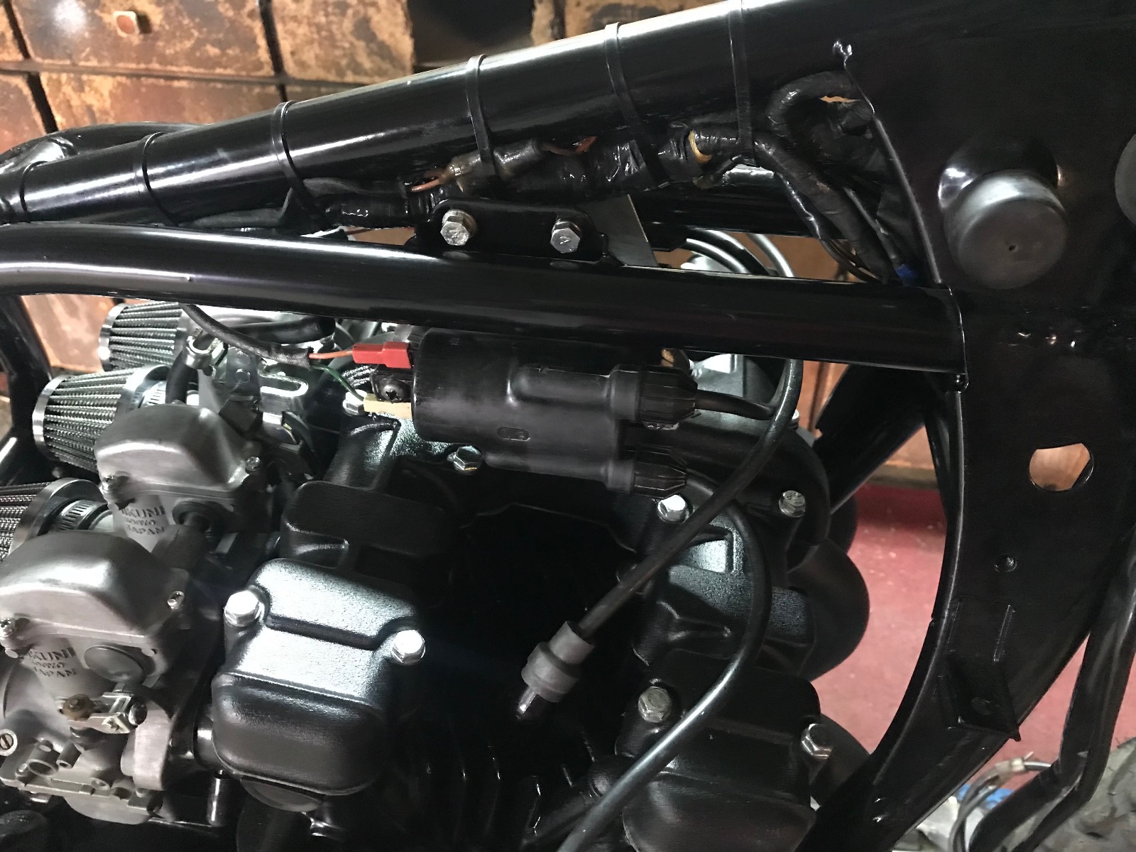

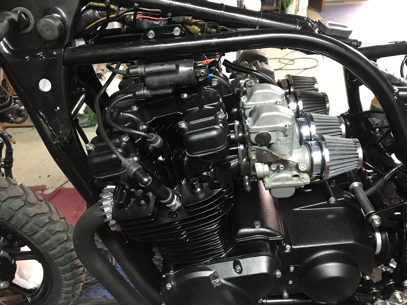

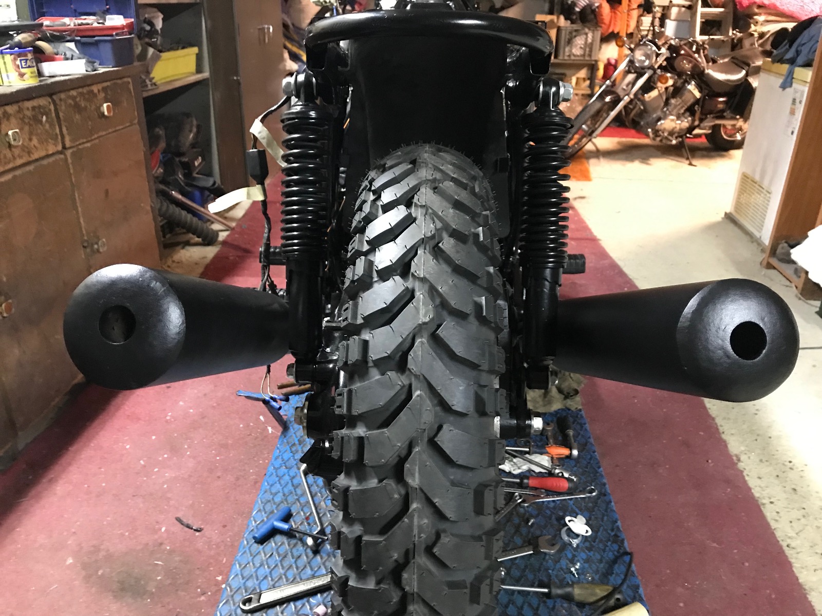

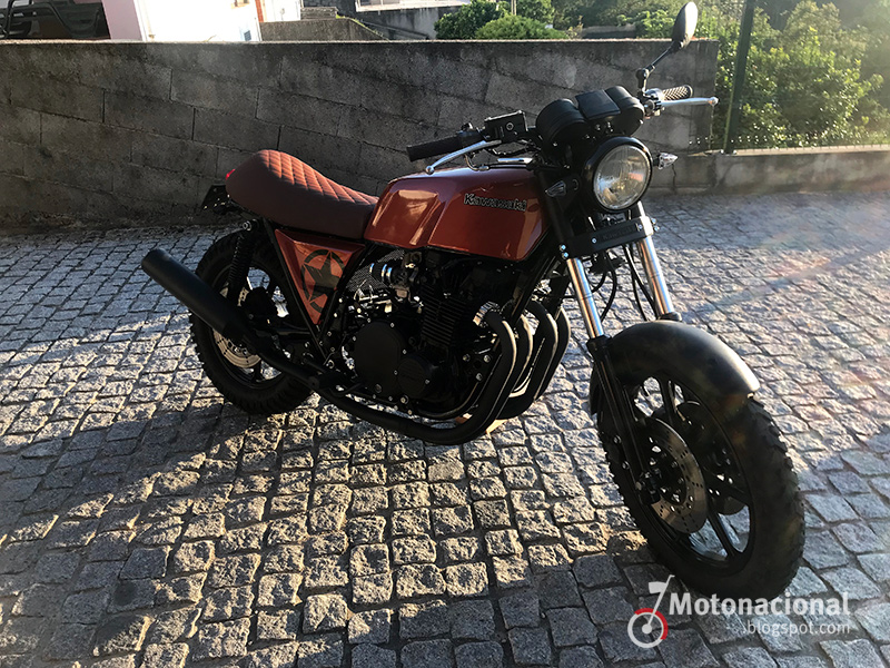

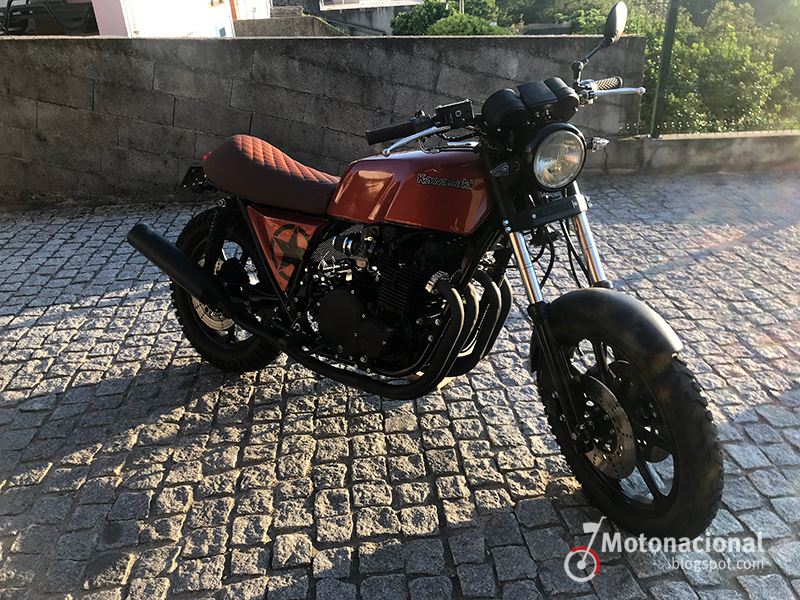

hello my project of KZ 1000 of 1979 to imported canada drive shaft
total restore, but not closed

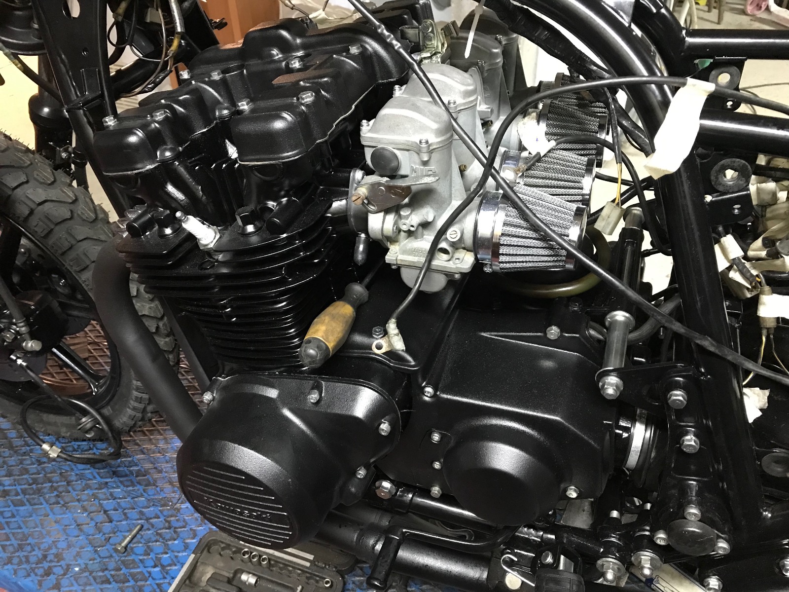

Nice project. Do yourself a favor and throw those cheap pod filters in the trash and buy some quality ones. Those will just cause you problems.

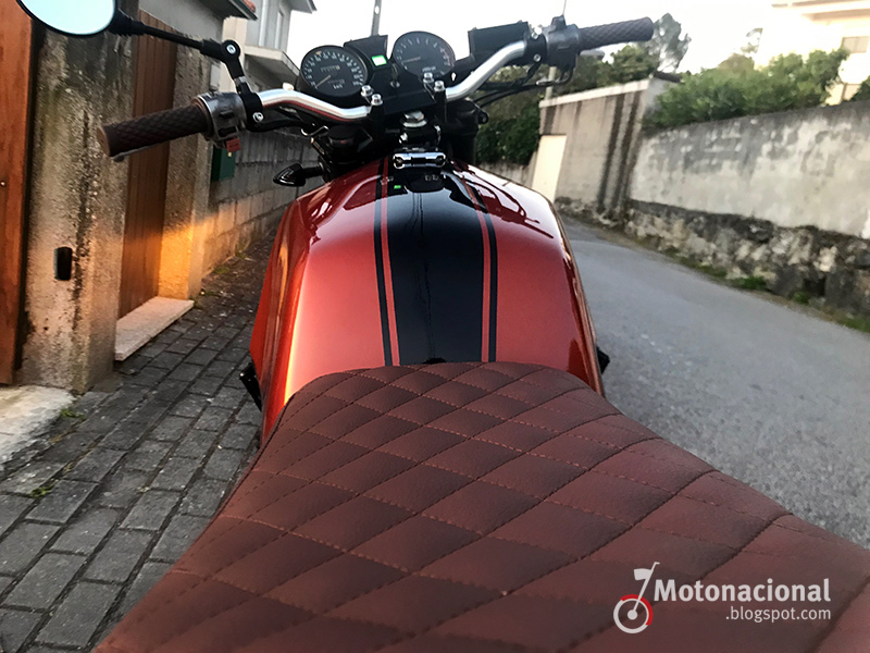

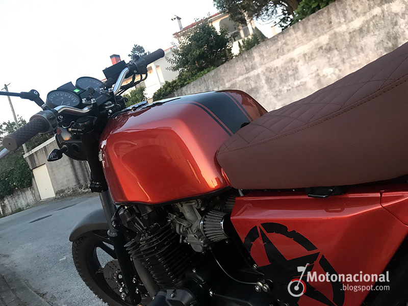

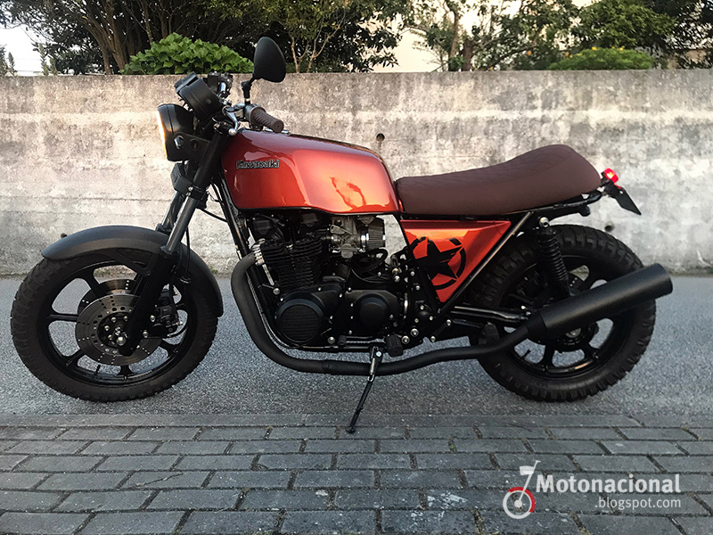

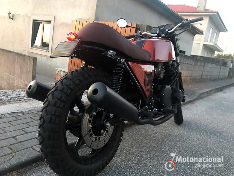

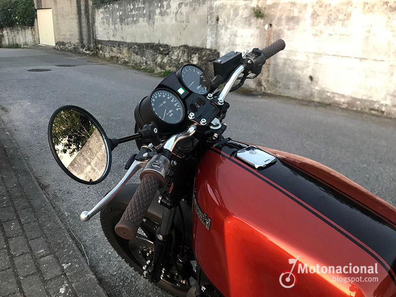

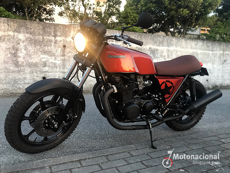

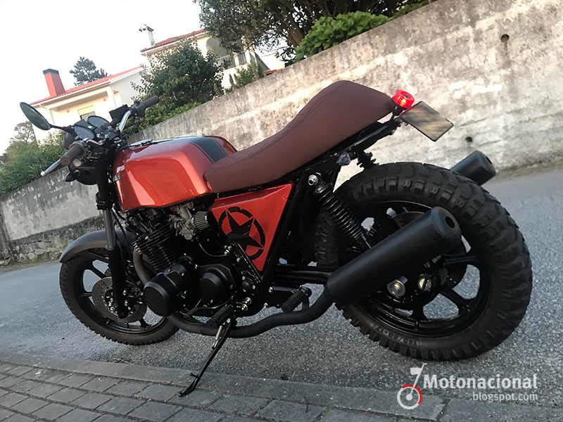

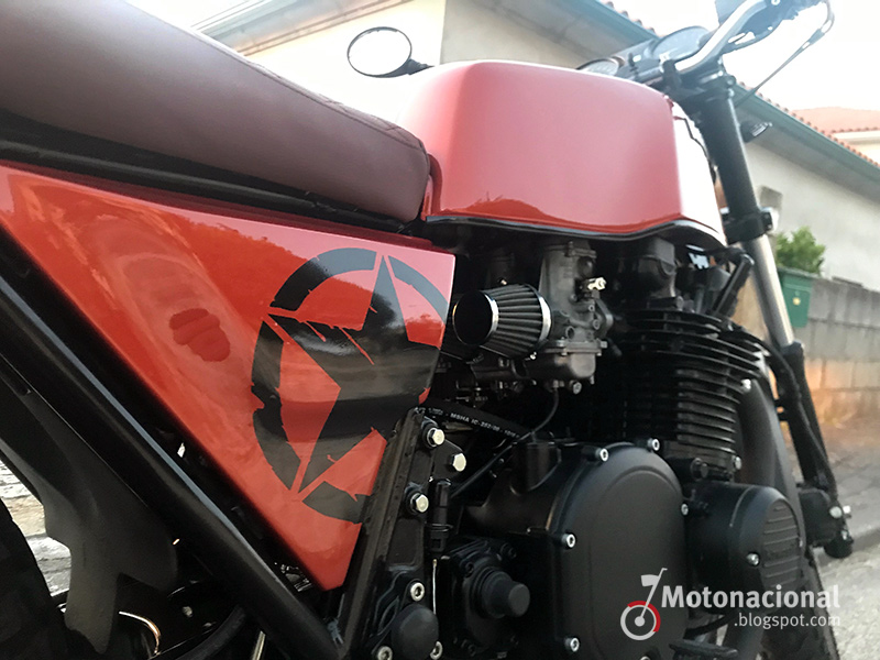

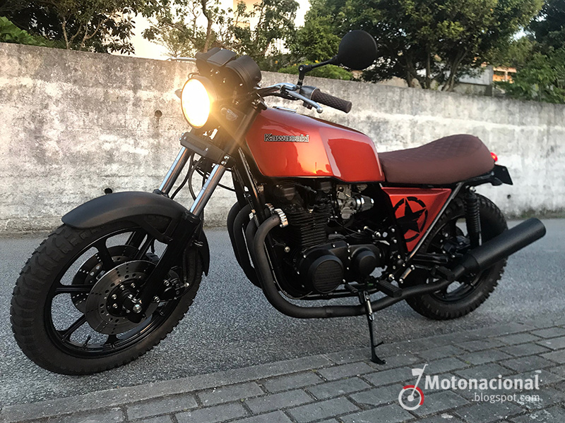

hello the imagens off the finished project...
its a year of work to make this bike....
i have in test and thi bike have very fine, its fun to drive...
the only problem is that stopping at the side stand loses gasoline through the carburetor and has a complete set of gaskets and seals
best regards

25 May 2019 08:49JPAULOCOUPE wrote: . . .
the only problem is that stopping at the side stand loses gasoline through the carburetor and has a complete set of gaskets and seals . . . .
Handsome bike!
Is gasoline escaping through an overflow hose?

Which of the four overflow hoses is discharging gasoline?
An overflow often results from failure of a float valve to close (for whatever reason).
When a freshly reassembled carb leaks through the overflow circuit, it sometimes helps the float valve to fully close by rapping smartly against the carb bowl with the plastic handle of a large screwdriver. Tap-tap-tap . . . tap-tap-tap.
Can try this method with the engine not running, and again with the engine running at idle speed.
