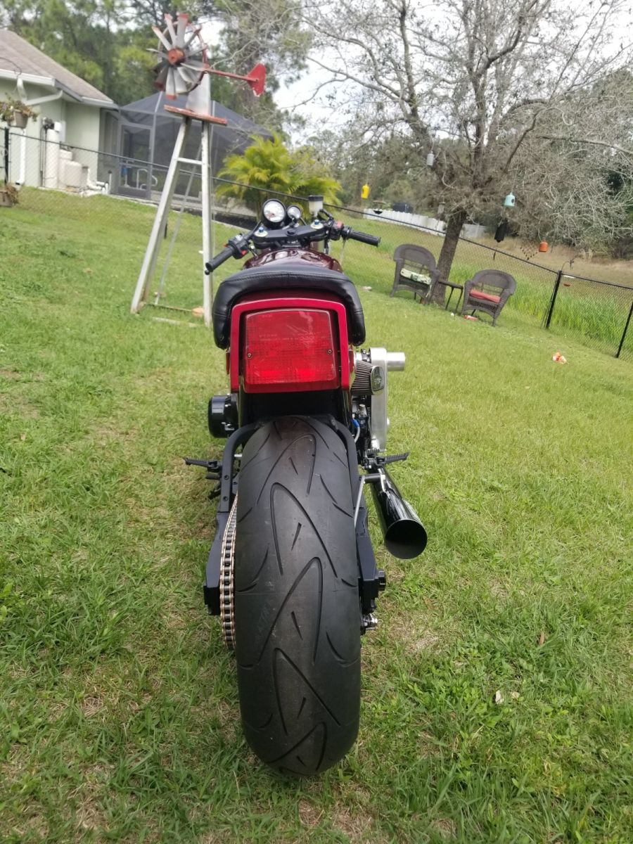

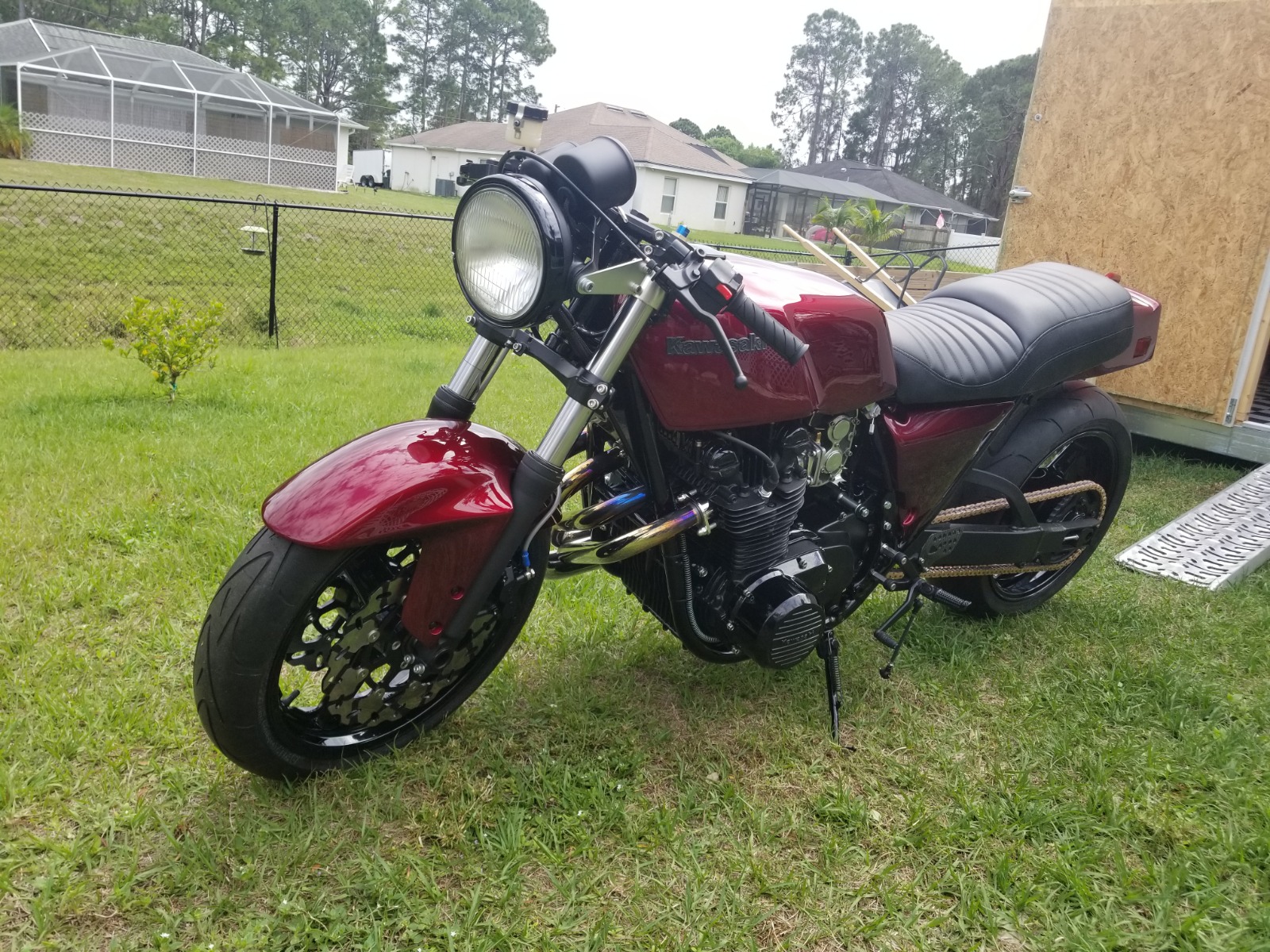

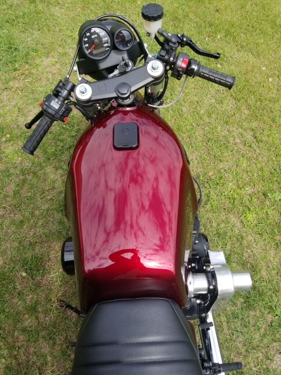

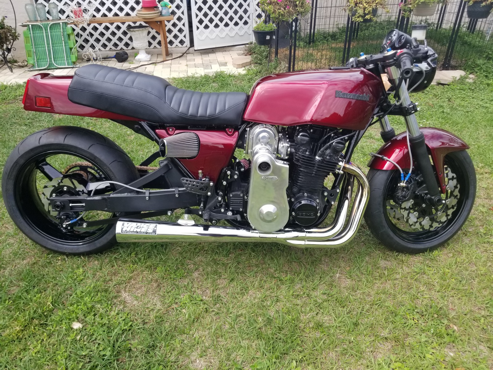

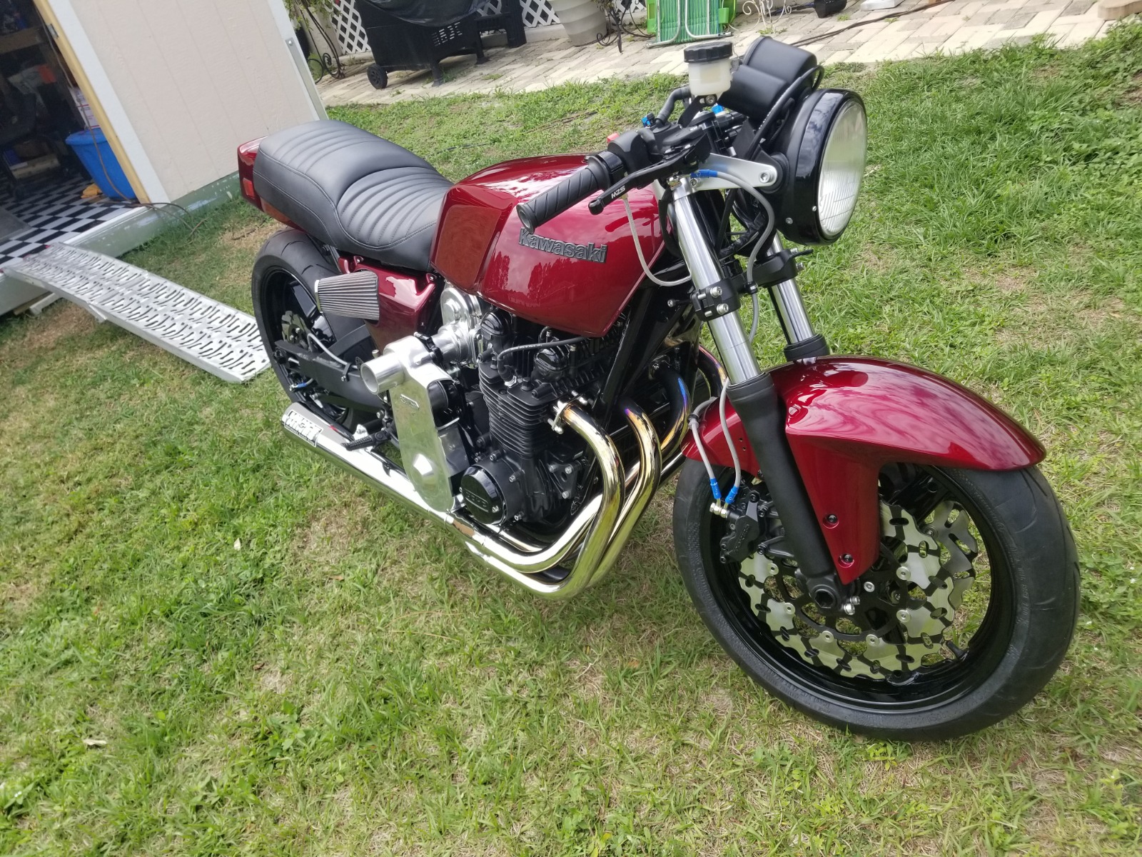

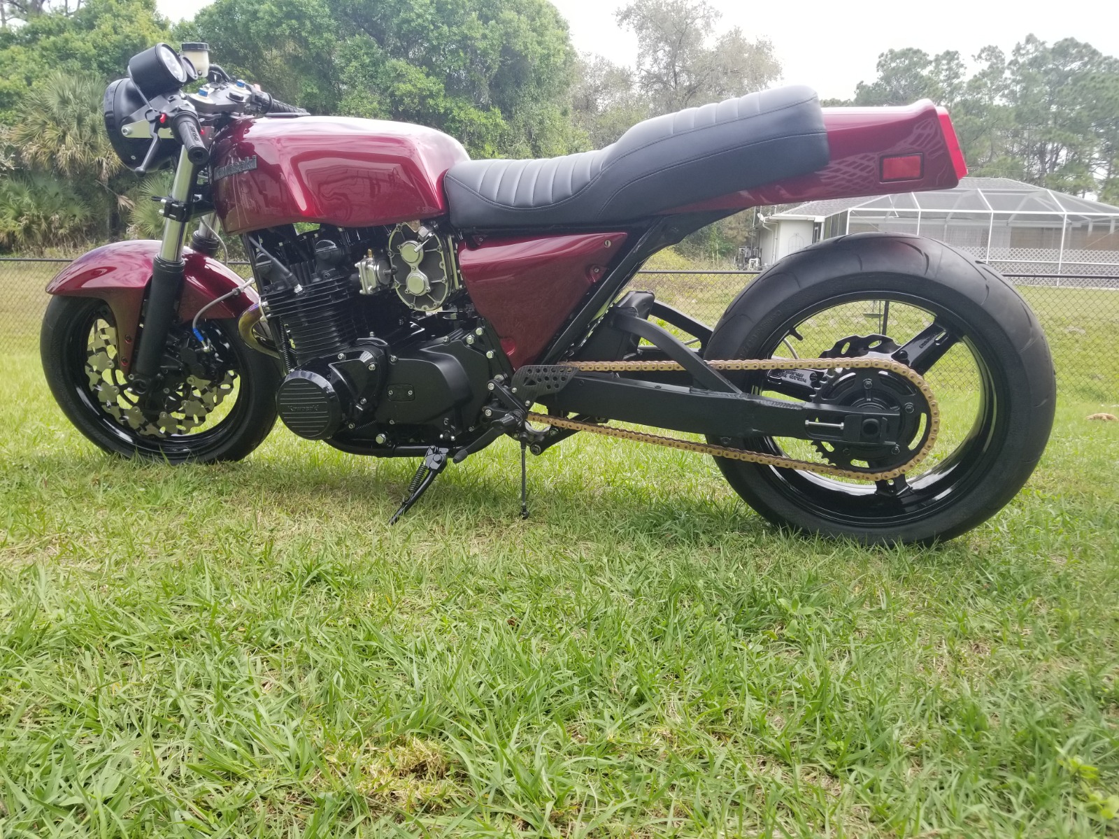

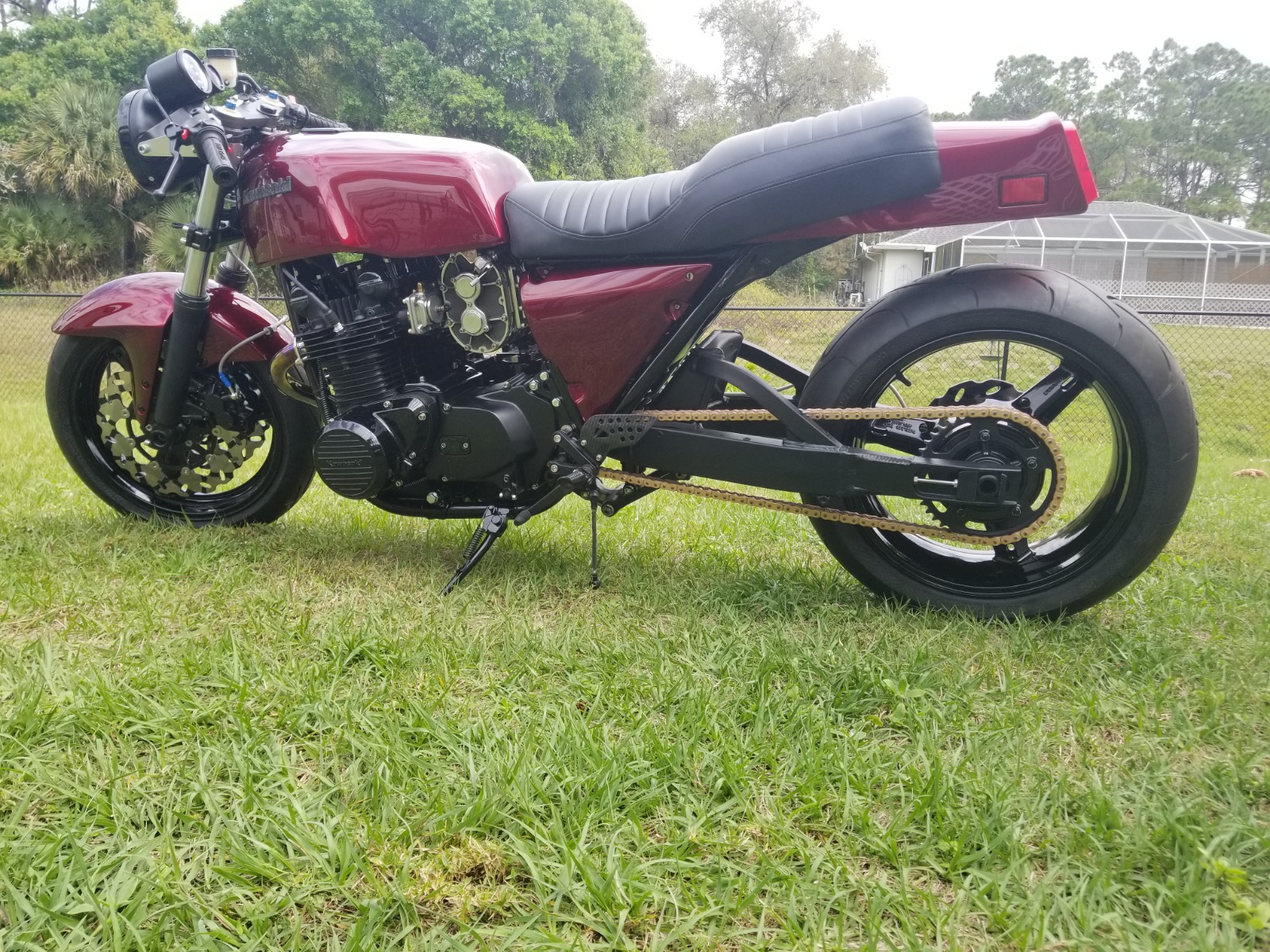

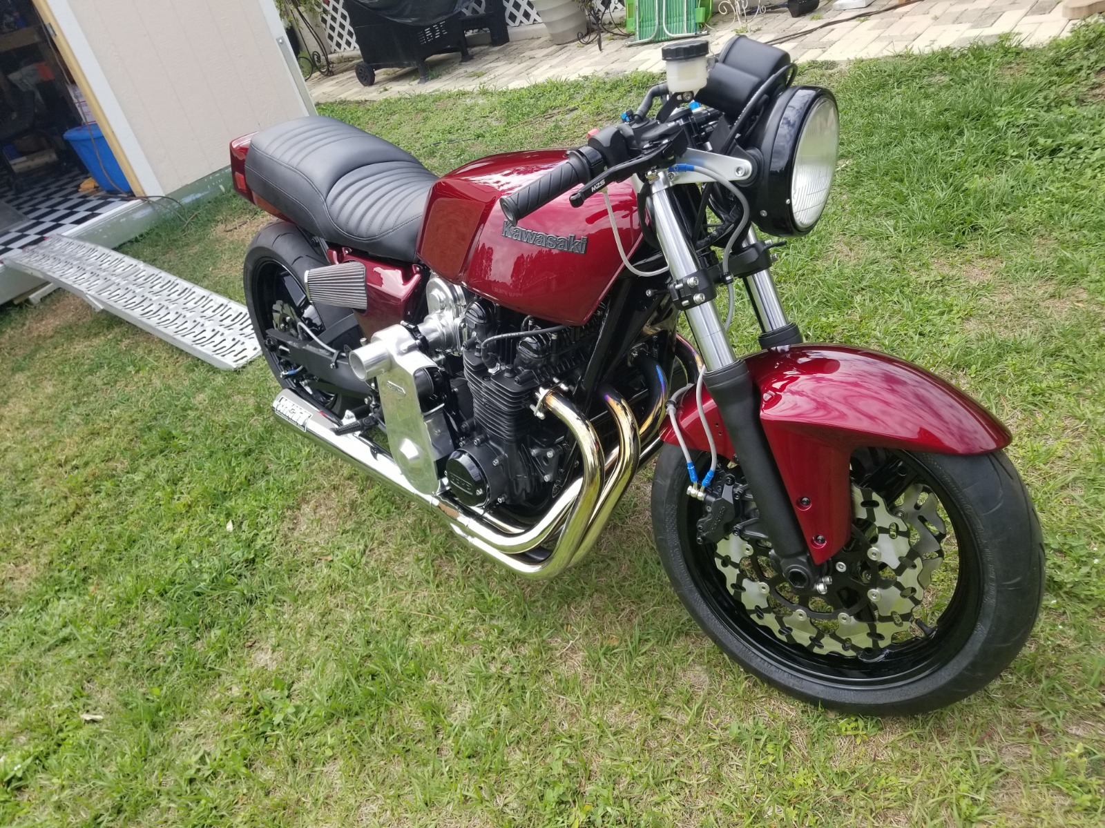

This is actually a bolt on kit made just for the KZ900/1000 back in the early 80's, from what I'm told. Hard to find info on it. Originally, the carb sat straight under the seat, but I added a 45 degree angle to the intake to get the filter out the side. Just to give a little more of a look to it

1980 engine with 1075 kit
8:1 pistons
Magnacharger blower kit
S&S carb
Dyna 2000 ignition
01 GSXR 600 front end
03 GSXR 1000 rear end
8:1 pistons
S&S carb
Dyna 2000 ignition
