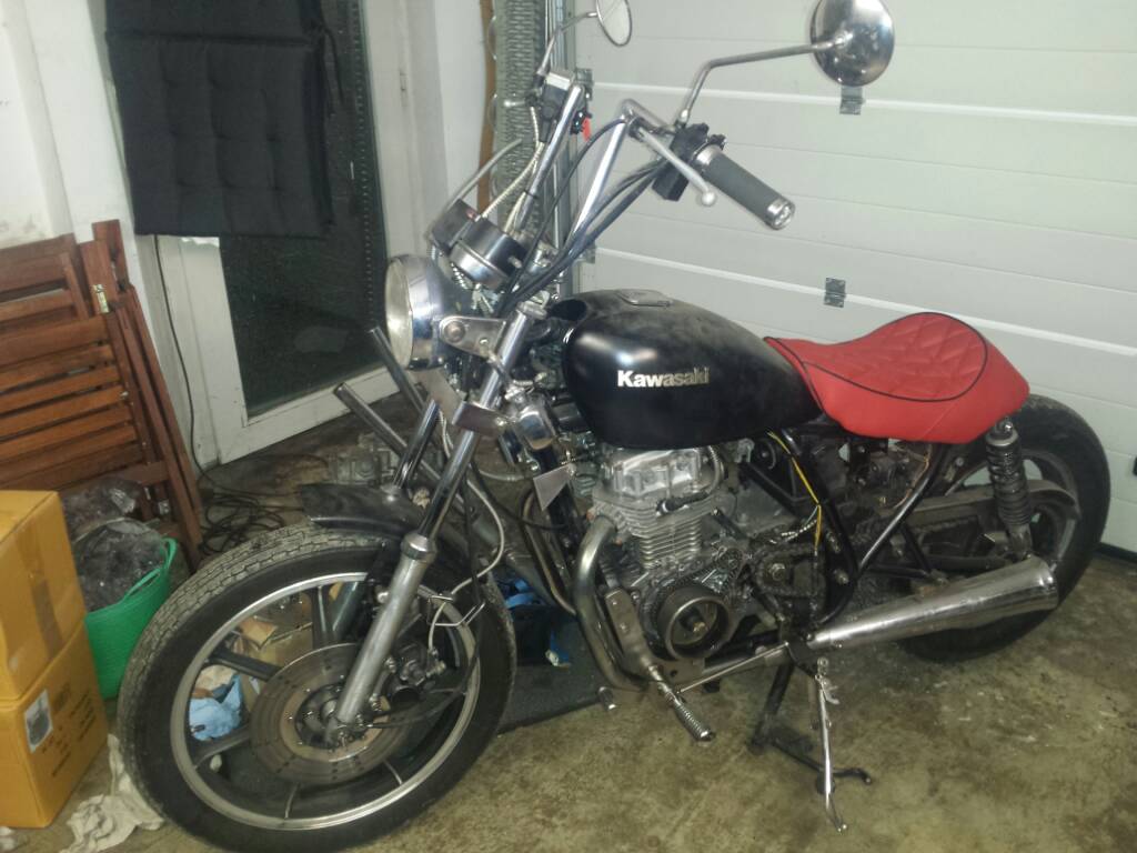

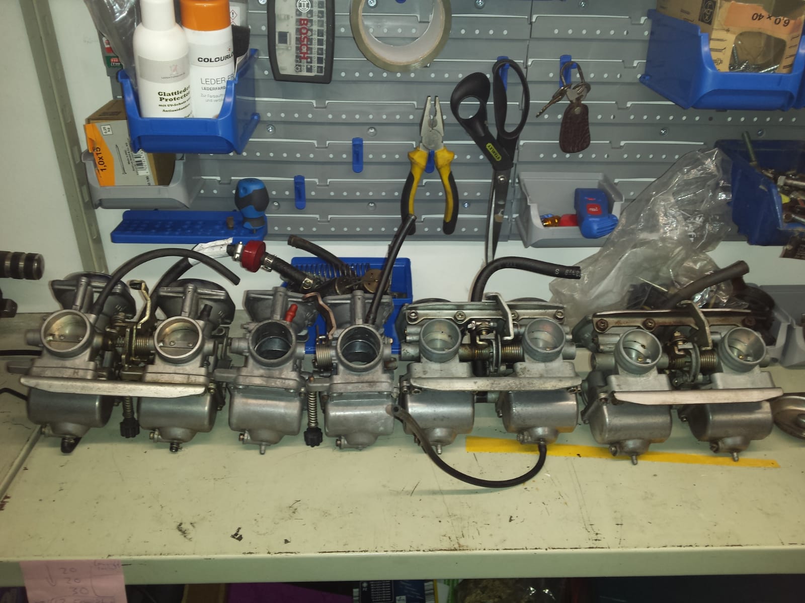

Yesterday i fetched up a Kawasaki 440 for 300€. 2 morors, foot rests, a stupidly sawed off rear, super ugly bench, 2 carburettors with the short sliders and a lot of headlights, indicators and other Gelump:
- kosmodian
- Posts: 13
Re: KZ 440 LTD - Shiny shiny!
04 Feb 2019 04:51
Of course, it can't stay that way. First the whole thing is taken apart to connect the frame with a reasonable loop again. I will repair rust spots on the frame and repaint with 2k can paint.

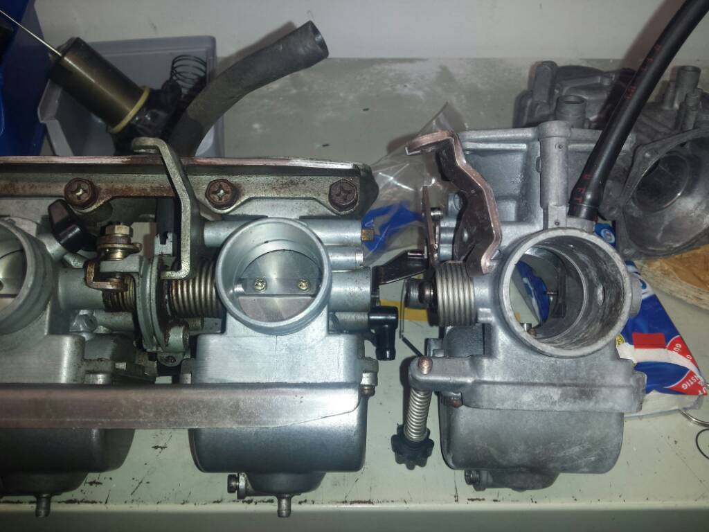

I got an international carburetor before I had the bucket in the garage. It has a diameter of 36 instead of 32mm and prevents the torque from dropping at higher revs. The German carrots were castrated with the smaller carburettor (with mega complex cold start mechanism) and short sliders on at that time insurance-favorable 27PS.

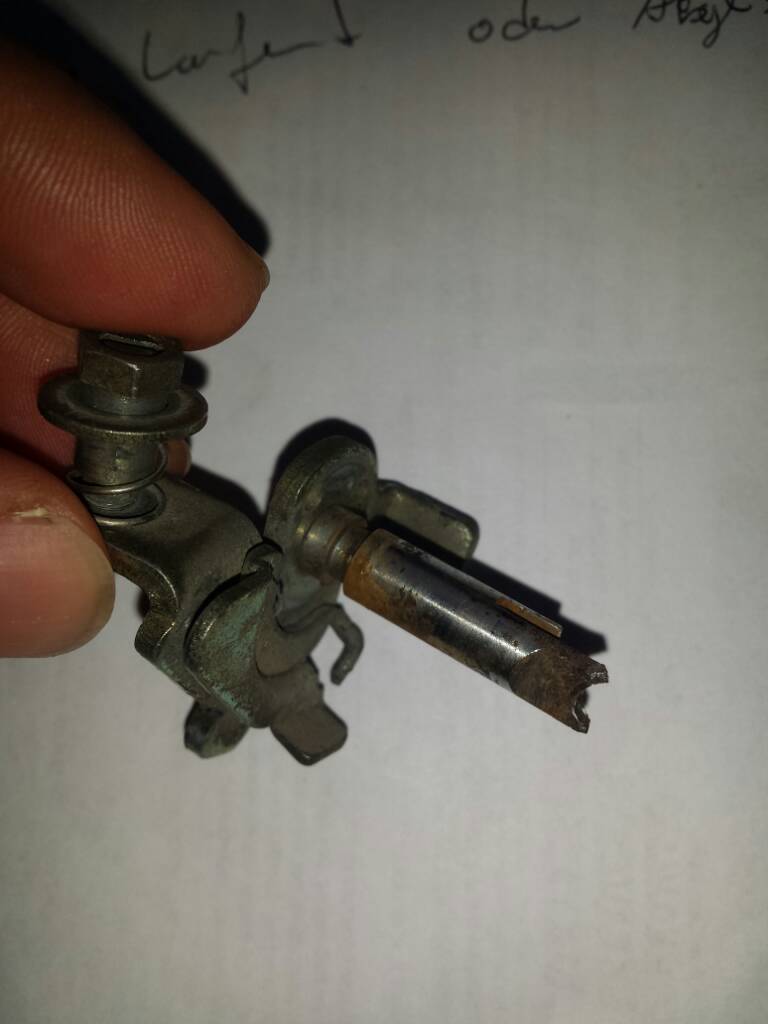

Unfortunately, I destroyed a throttle valve shaft of when I was trying to get the thing going. Lesson money for the impatience : 100 € for another carburettor ( Nr.4 ).

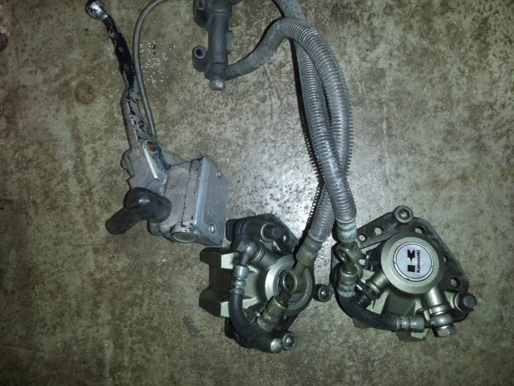

But I saved 35€ yesterday when I discovered a second brake disc in one of the boxes. Together with the brake system of a GPZ 900 I can control the murderous power of almost 40hp with a double instead of a single disc brake.

Carb No. 4 has arrived and looks pretty good:
I think no sound bath neccessary.
One one the previous owners has already replaced most of the screws with VA-Inbus Screws and secured them with spring washers. I think that makes sense since the KZ isnt free of vibrations. But i think i will use loctite instead of spring weashers...what do u think?

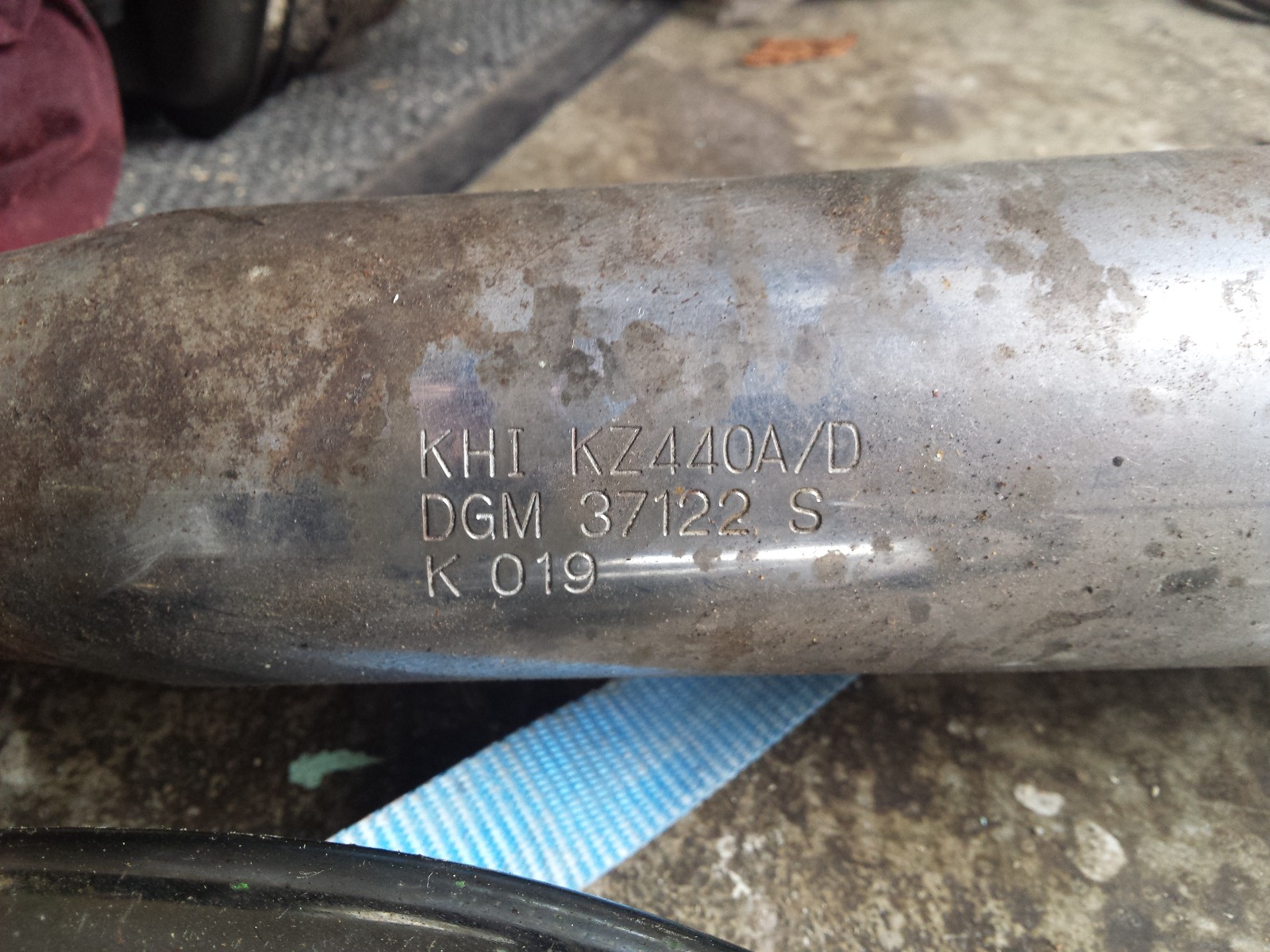

Are the mufflers/exhaust of the kz440 in germany different from the international versions?

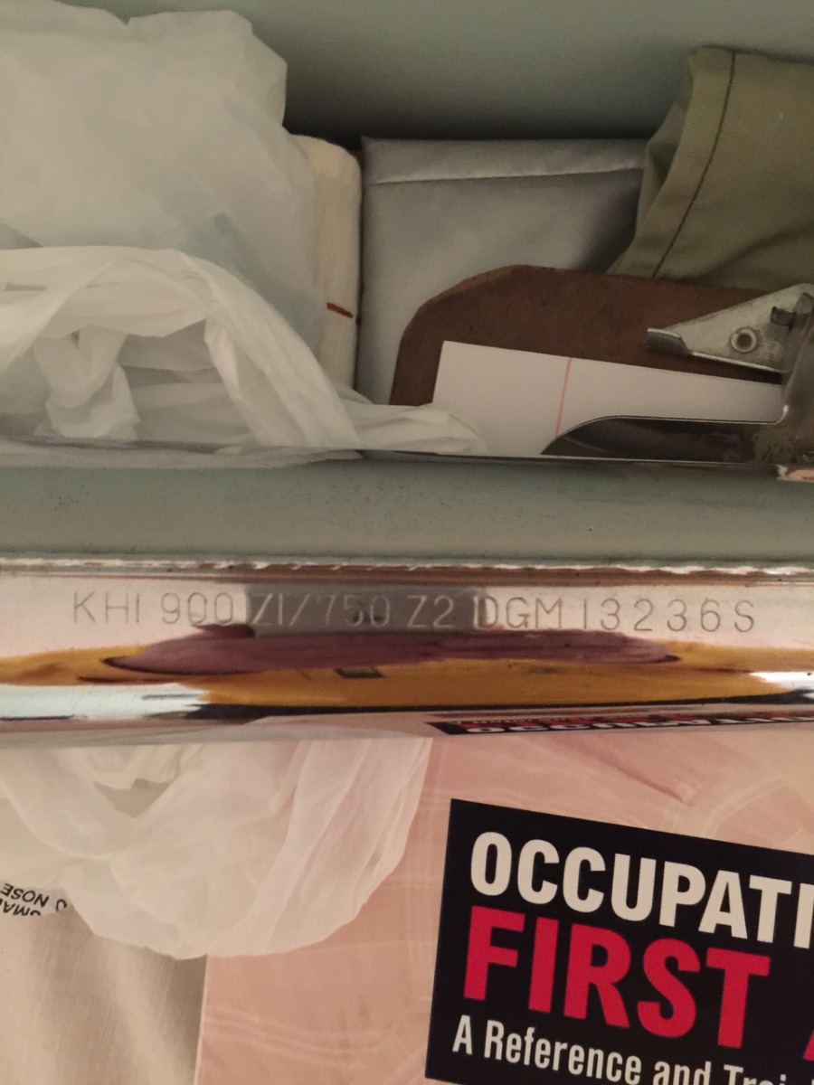

The DGM number is a requirement for import into Italy. It's on a lot of parts. The photo shows it on a Z1 exhaust.

Thanks; so there is no need to change the exhaust in the search for more power. But unfortunately my exhaust are so rotten, i will have to exchange them anyways...
