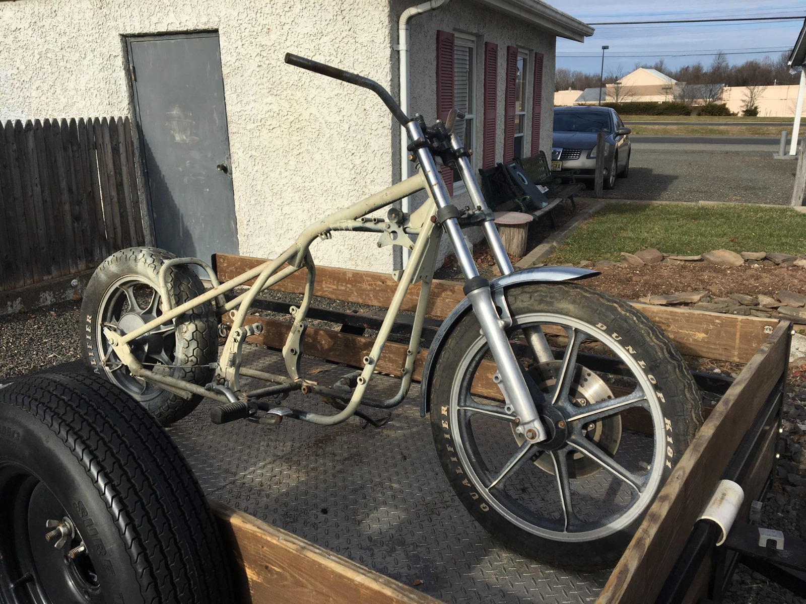

Hello everyone, new member here. Looking to find parts for my 79 KZ400-H project I just started and I'm having trouble. Would really like to find a parts bike with running engine, or at least a running engine or complete rebuild kit for my existing engine on the cheap. Have searched Google for hours and come up with minimal results. Please help!

I won't know until I tear it down and inspect it. But if I'm going to go through the effort of tearing it down, I would like to at least rebuild the top end before re assembly. Can't find a rebuild kit for it, maybe I'm just looking in the wrong places, so for me it would be easier to just slap on a running engine and be done with that end of the project. I do know from the guy that I bought it from that it had no spark, but that is all I know about it. Just picked it up today and stripped it bare before it even made it off the trailer. Gonna start the sand blasting process this week and soak the carbs to prepare to rebuild them while I continue to research. Any technical knowledge on these bikes would be much appreciated!

Yes I can diagnose a simple points ignition. Kind of hard to attempt to start or compression test an engine with no battery, no kick starter, carbs removed, and half of the the ignition parts missing... Starting from the ground up on this one. Will disassemble the top end, lap the valves, replace rings, and inspect for any damage or wear. Worrying about internals first before I start throwing coils and condensers at it. I am very familiar with motorcycles, but have never worked on one of these old Kawasakis. I bought the bike as a basket case for $150 with half of the basket missing.... Will get a clymer, but in the mean time just trying to get some direction from people experienced with these bikes.

In your first pic there is enough there to check compression and spark.
