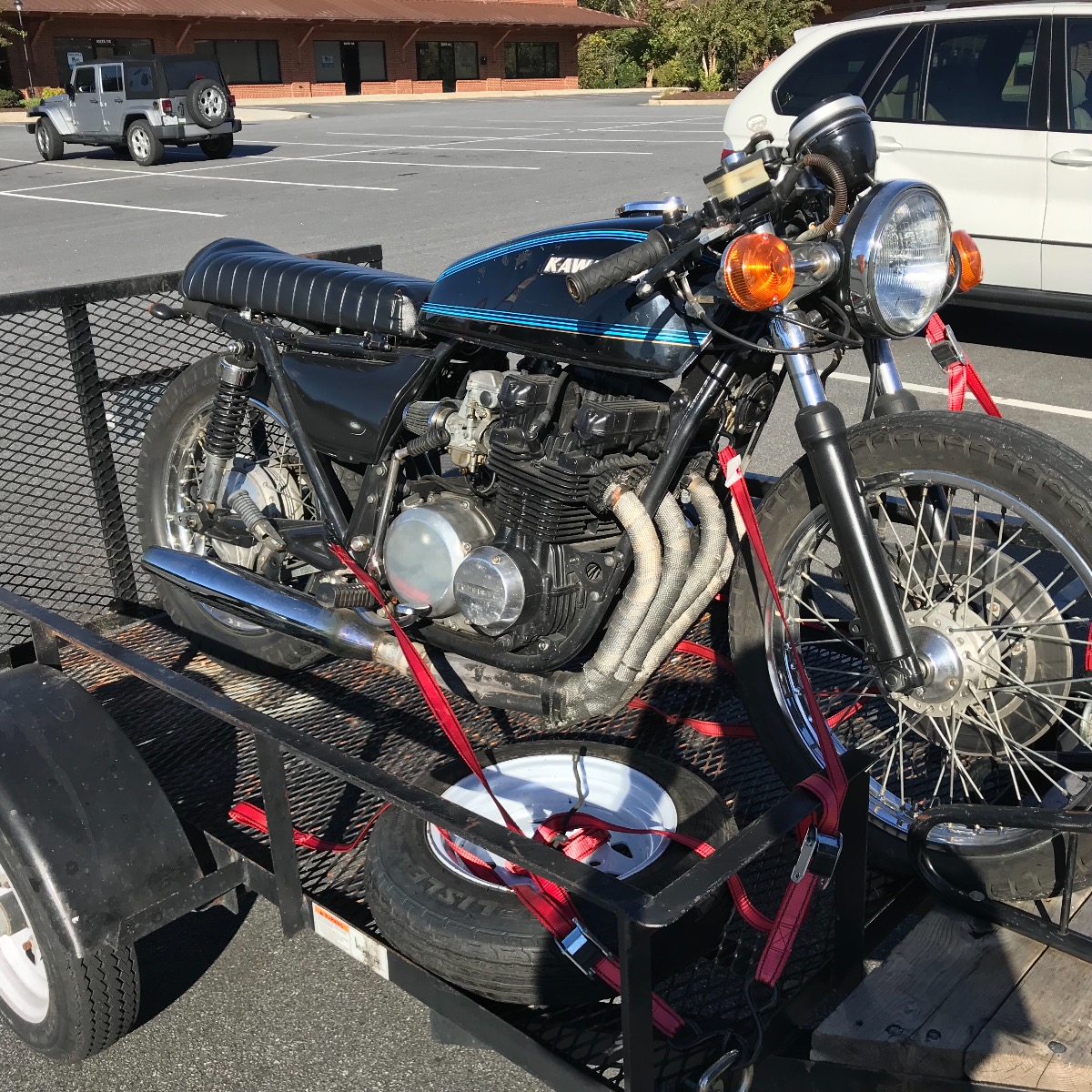

I’m an addict. I guess I’m starting a brand of wakt out bikes. (William Anthony Kyle Taylor es me nome)
This bike will be returned to mostly stock form. Has a battery draw so I’ll get to checking and chucking electronics. Hoping it runs with some carbs cleaned and fresh gasoline.

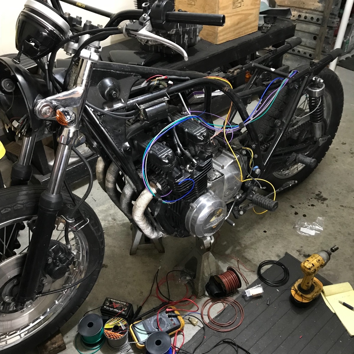

Fresh gas, plugs, flushed the carbs and used a pumper battery. Fired up on the first try. PO said it ran fine when he parked it 2 years ago but had a battery draw.
Turns out the R/R is dead. That’s fine with me. Easy enough. I found fired wires so I’m gonna clean up the harness. I may upgrade the stator and R/R for a lithium battery. I have an older 8 cell Ballasitic that kicks it over just fine.

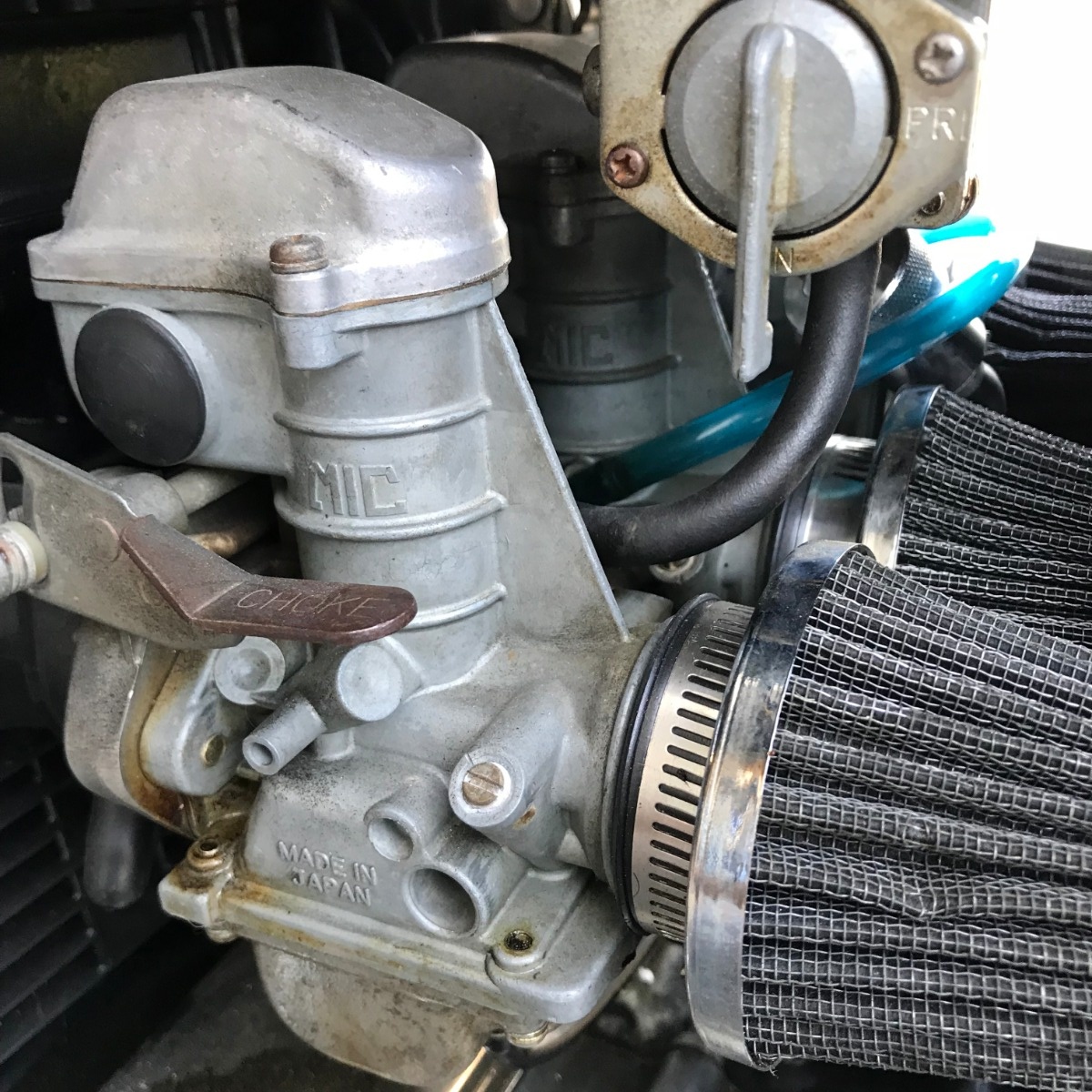

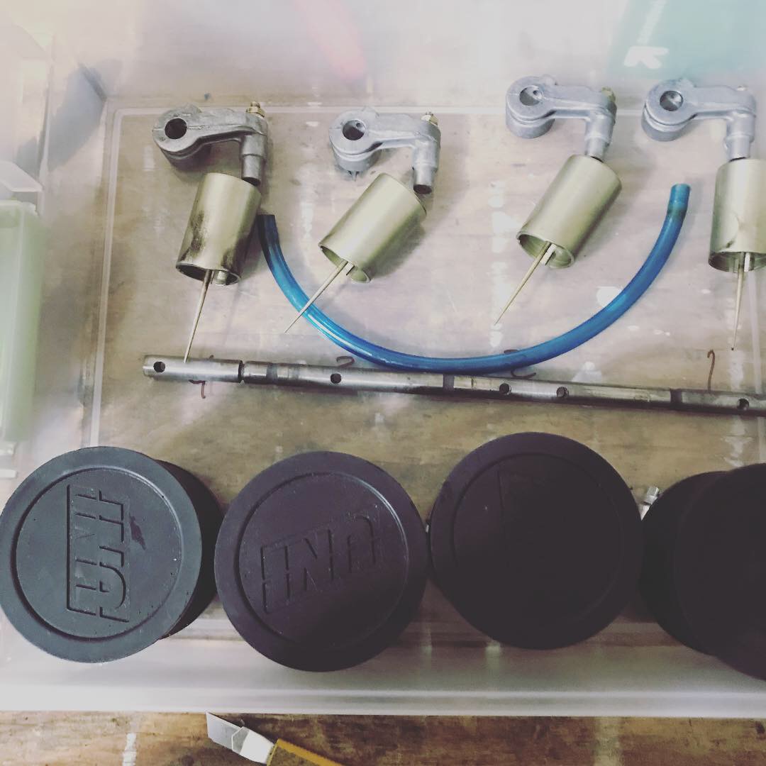

The bike ran, but poorly. I pulled the carbs and found 102.5 main and 15 slow jets. With Pods and the 4-1 exhaust these jets are too lean. Also found a bent needle so I ordered some parts to get these carbs in order.

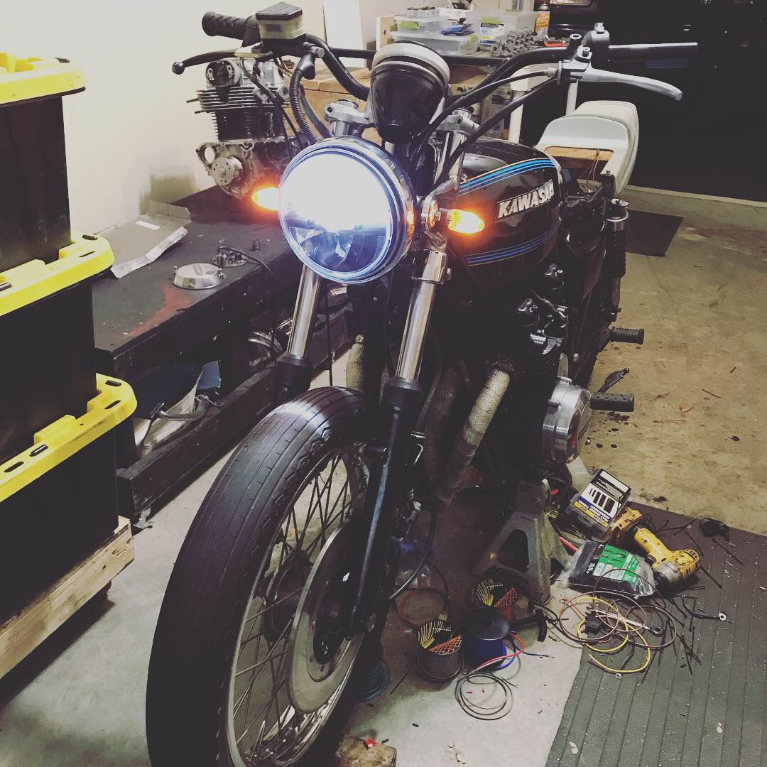

Small update since I’m out of town this bike is calling my name. Fresh wiring everywhere and some what simplified. More pics to come

My new favorite noise maker didn’t ride well. Would fire up immediately but no good at anything past 10% throttle. I pinesol soaked the carbs after disassembly (I ruined the slides in my kz1000 carbs I found out recently). carbs cleaned up and replaced a bent needle. The K&L kit needle was not the same as outgoing needle so I replaced all 4 needles to keep them the same. They were all on #4 notch. I upped the slow jet to 17.5 from 15 but kept the 107.5 (or maybe it’s 102.5?) for now so I can change just one thing at a time till it’s right. I have some larger jets but let’s wait and see. I replaced o rings and installed new air bleed screws. Turned the all the way in then 2 turns out for now.
After setting the timing on the Dyna S the bike fired up on first try.
Engine idles just fine. A little “lopey” but the 10 second ride I took was exciting the throttle response seems good but I ran out of gas and for 100 other reasons I didn’t ride it more.
Working out of town so I’m dying to get back and fine tune this little monster.
New gasket set arrived so I can set valve clearances and really fine tune it. Can’t wait.

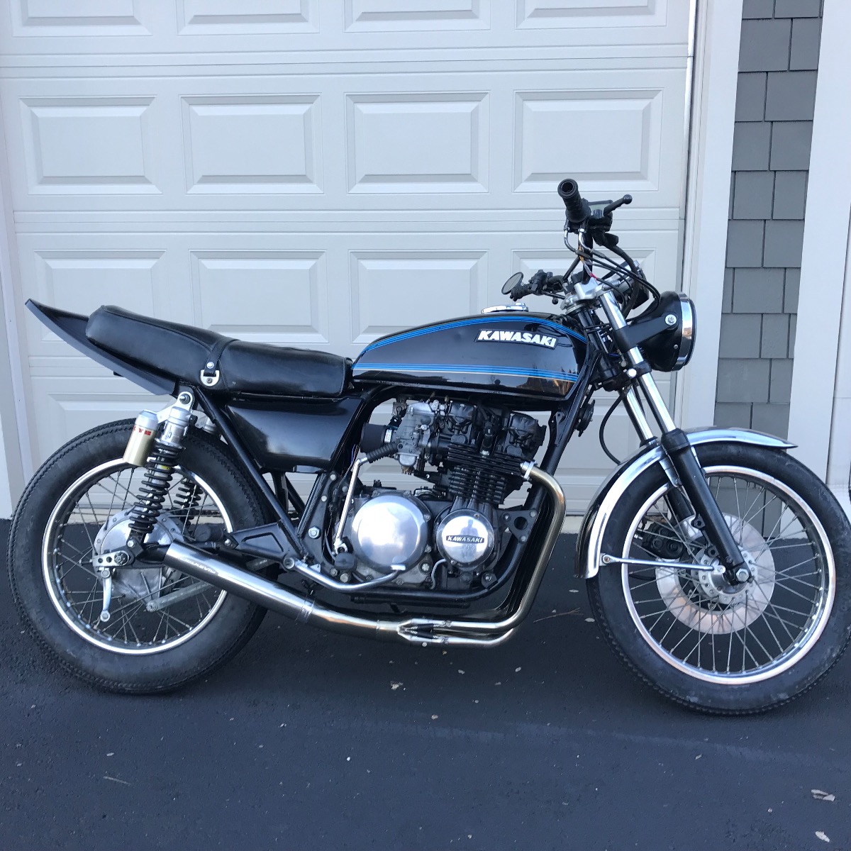

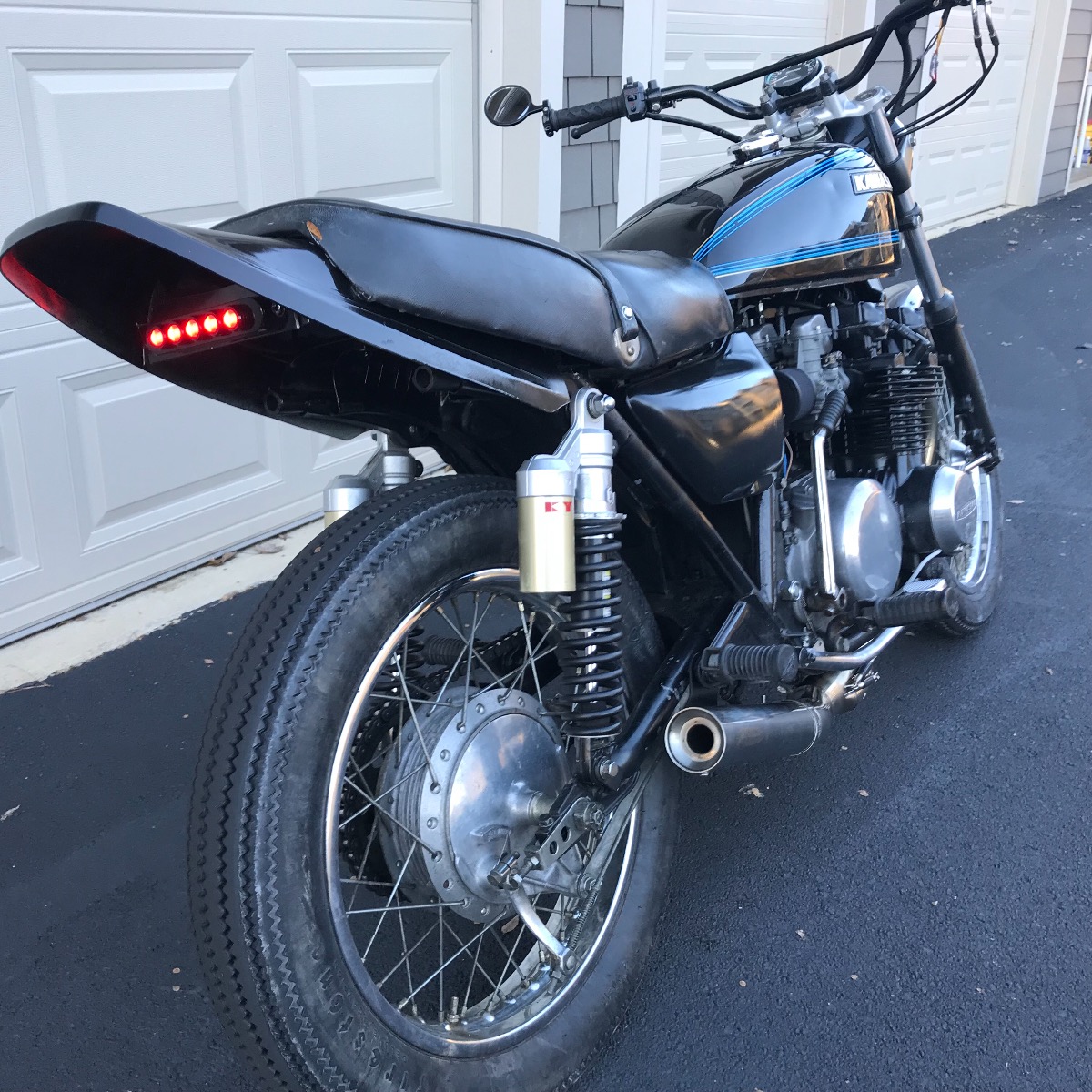

Fast forward a little. Trimmed and installed a stock tail. New Firestone Champions which seem to be good tires so far. Rode on cold we pavement and she felt goood.
All new wiring.
Ricks lithium Regualtor Rectifier
Ballistic 8 cell lithium
Moritomoto 5Stop tail/brakelight
ZXR Shocks I like these. Lifted the booty the way I like it. My girl rides with me a lot and she enjoys being able to see and I enjoy the added suspension.
Next:
Mount turn signals from Rossa Engineering. Quality aluminum bodies
Something seems amiss with my rear drum brake. The axle nut is tight. The brake stay and bolts are tight. No play in pivot arm now tho there was quite a bit when I purchased the bike.
Every few times I accelerate and then press the rear brake it seems to catch. Sometimes this abrupt. I had the drum off while installing new tires and the linings looked new and were in place.
Could the stay be too short now with the suspension lifted?
