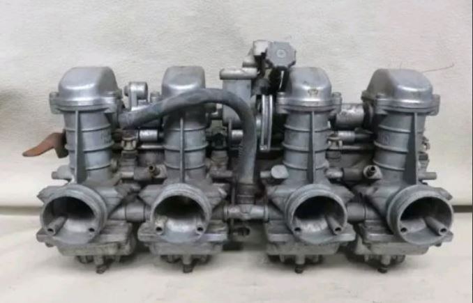

25 Oct 2018 15:23 - 25 Oct 2018 15:29TheeGreenRanger wrote: So these would be a vm24?
Yes. That photo is of Mikuni VM24SS carbs. They appear to be the ones from a 1977 KZ650 in that they don't have the accelerator pump gadget on the bottom of carb #2, the accelerator pump related tubes between carbs, or the petcock vacuum orifice. They look like the ones on my 1977 KZ650-C1. Ed

Do you know if my intake boots for the cv's are the same size?
Re: Bobber kz650
25 Oct 2018 19:27
Sorry, I don't know if they are. Ed
Re: Bobber kz650
25 Oct 2018 19:47
No they are larger. The setup you posted will work with those carbs. Carbs with the pumps have 2.0 slides typically. I'd get the ones without it.
