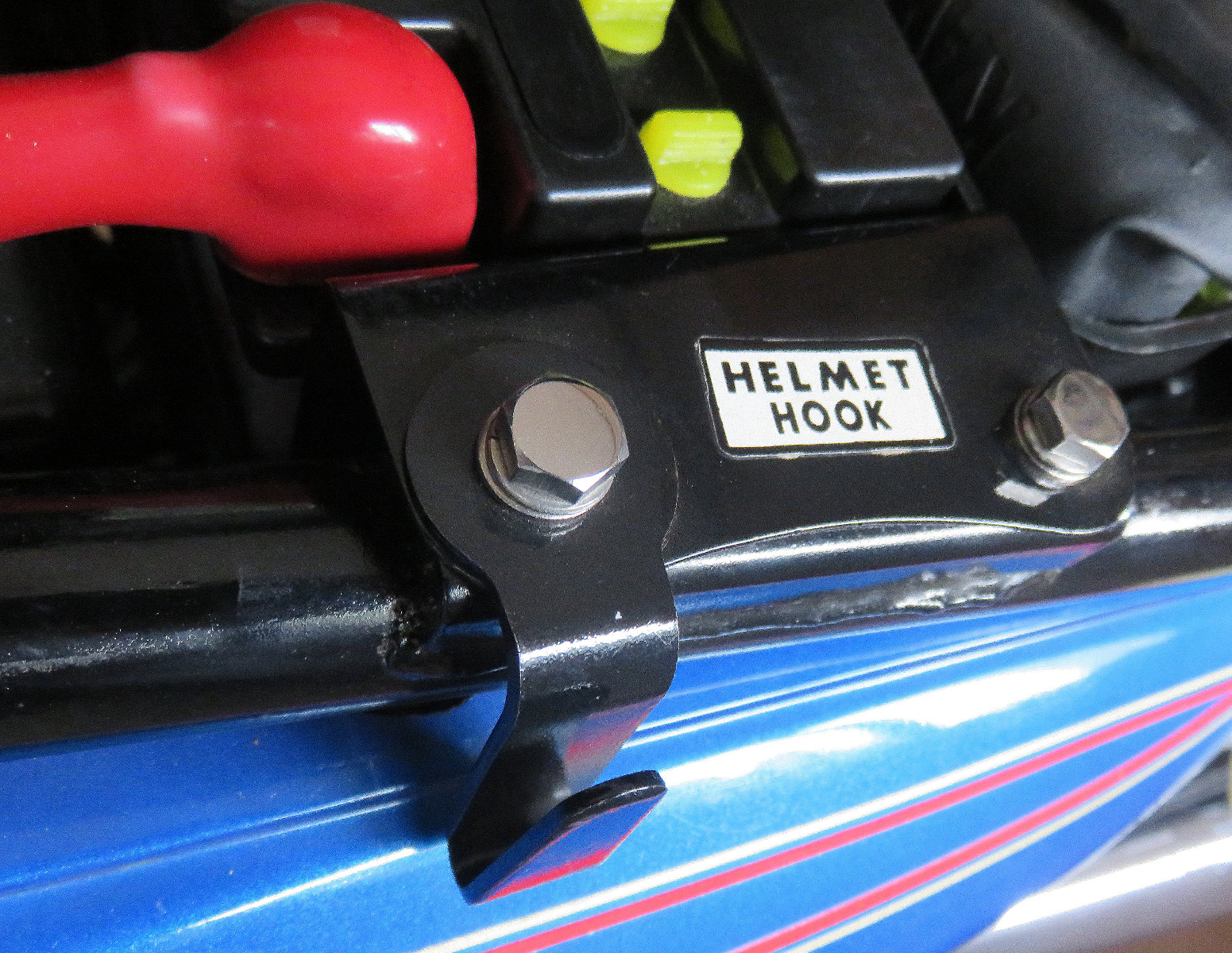

PLEASE add your bike's exact year and model to your signature line. That will help us help you. The helmet locks on different models are very different. For example, my KZ650-C1 does not have a helmet lock on the right side of the bike, it's on the left side. Also, mine is a simple hook with no buttons or other gizmos (see image below). In the case of the KZ650 the closed seat prevents the helmet from being removed from the hook. Ed

No eBay APP ID and/or Cert ID defined in Kunena configurationIf you are not able to get it working you may want to buy a new one. Assuming the one in the image below is correct you should be able to get one from eBay. Ed
