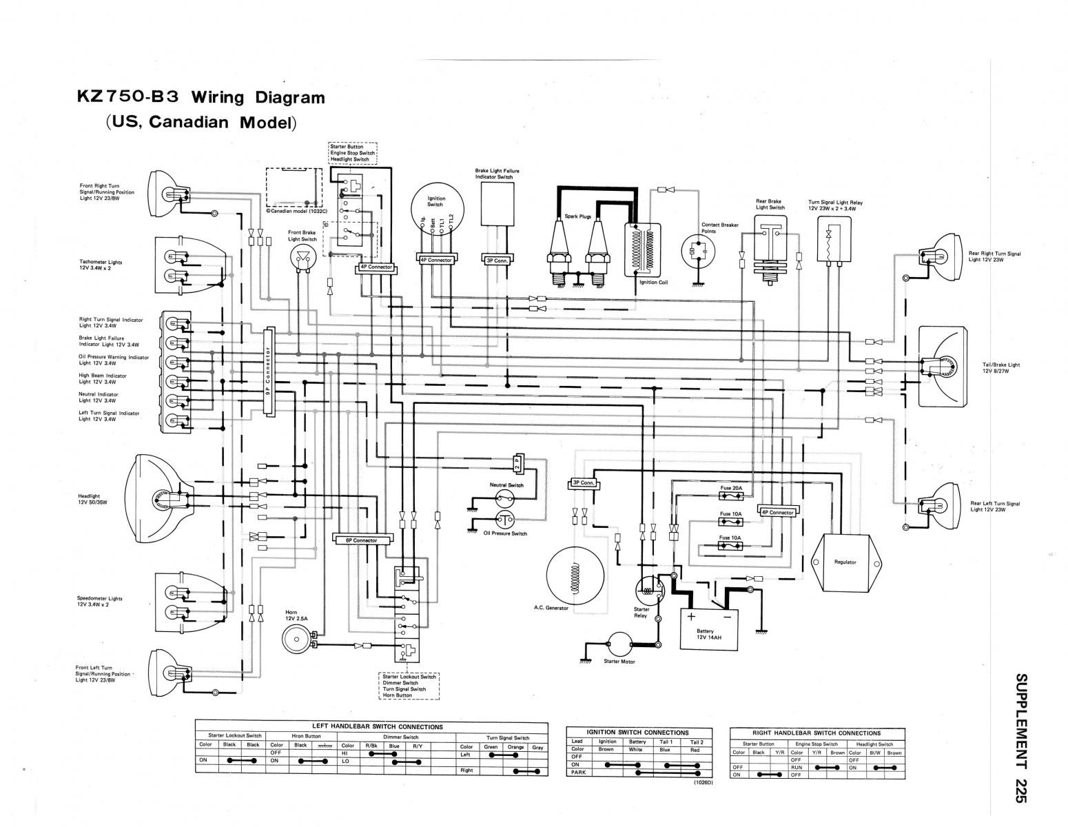

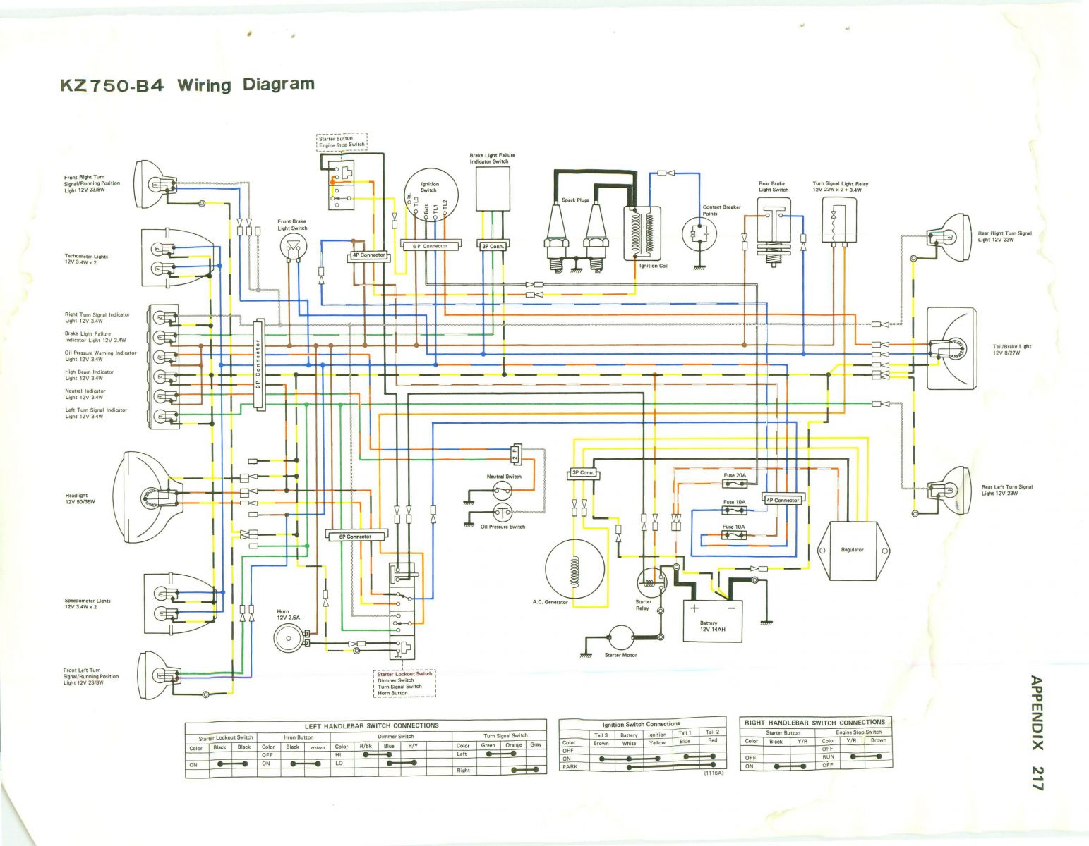

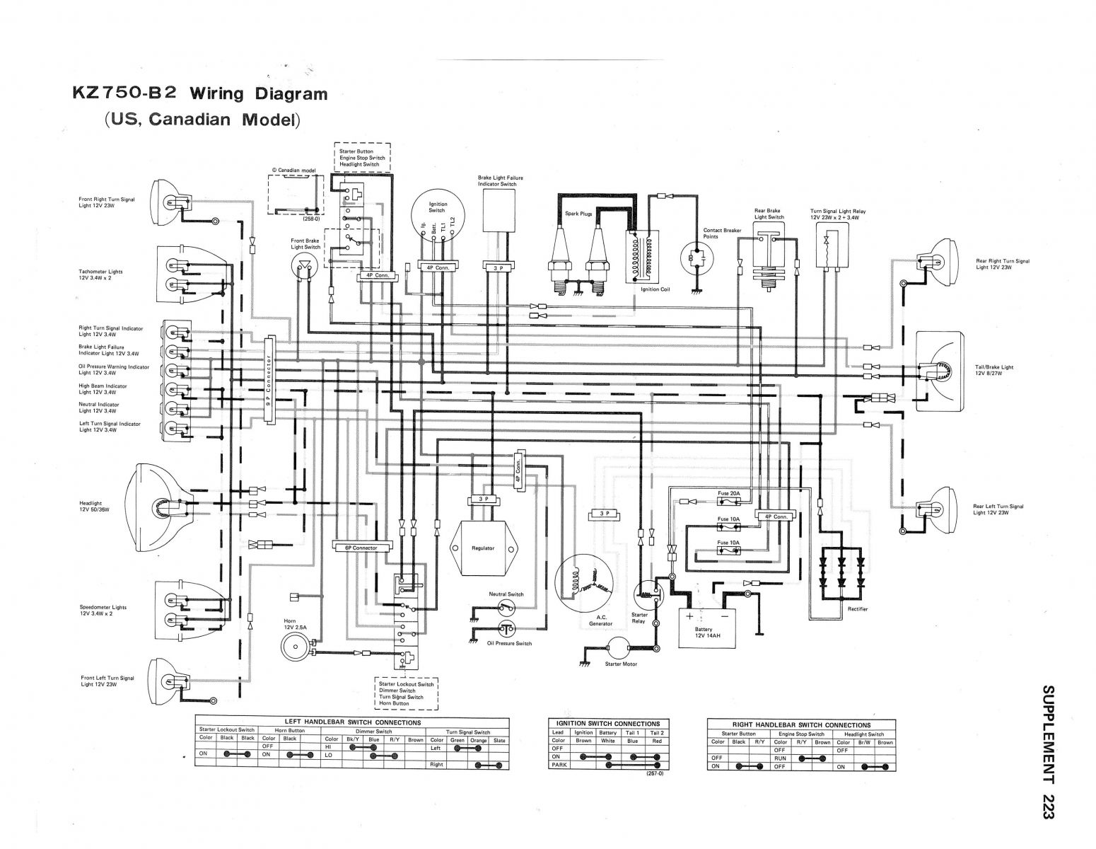

Re: 1976 KZ750 starting problems
10 May 2018 12:01
10 May 2018 12:50 - 10 May 2018 13:02
