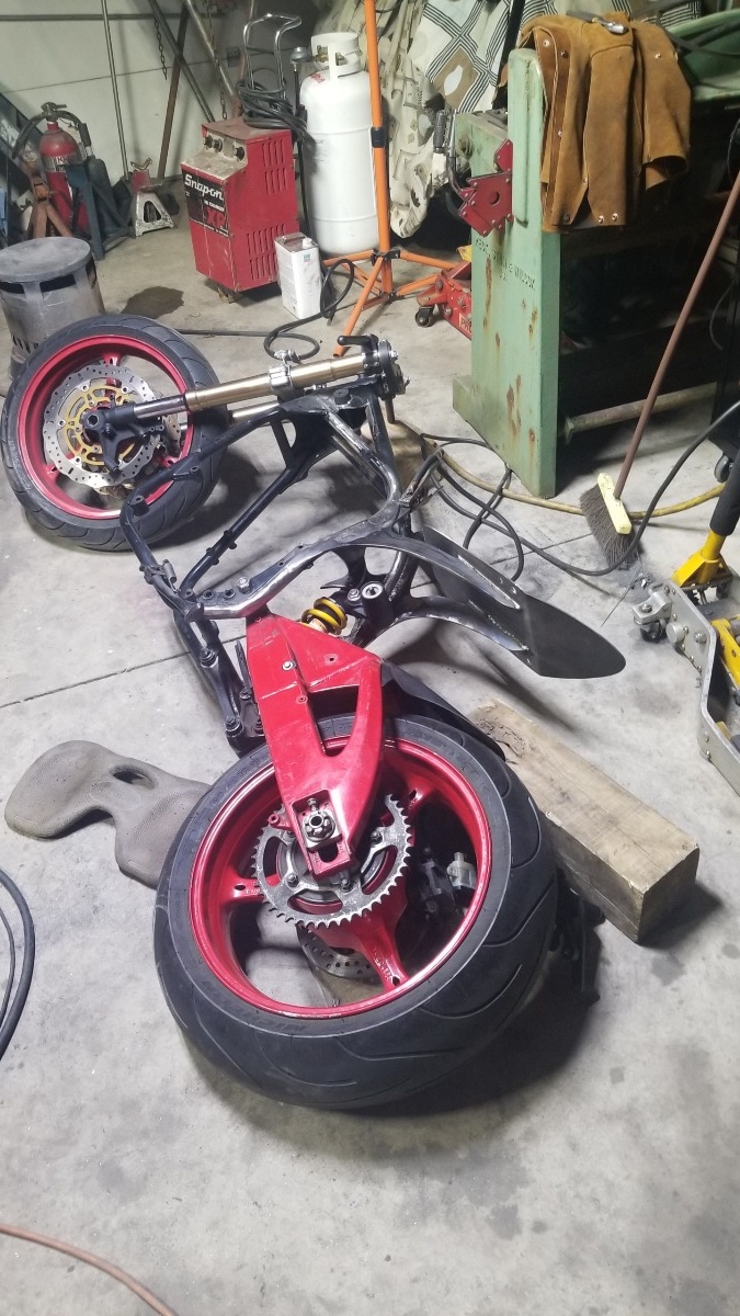

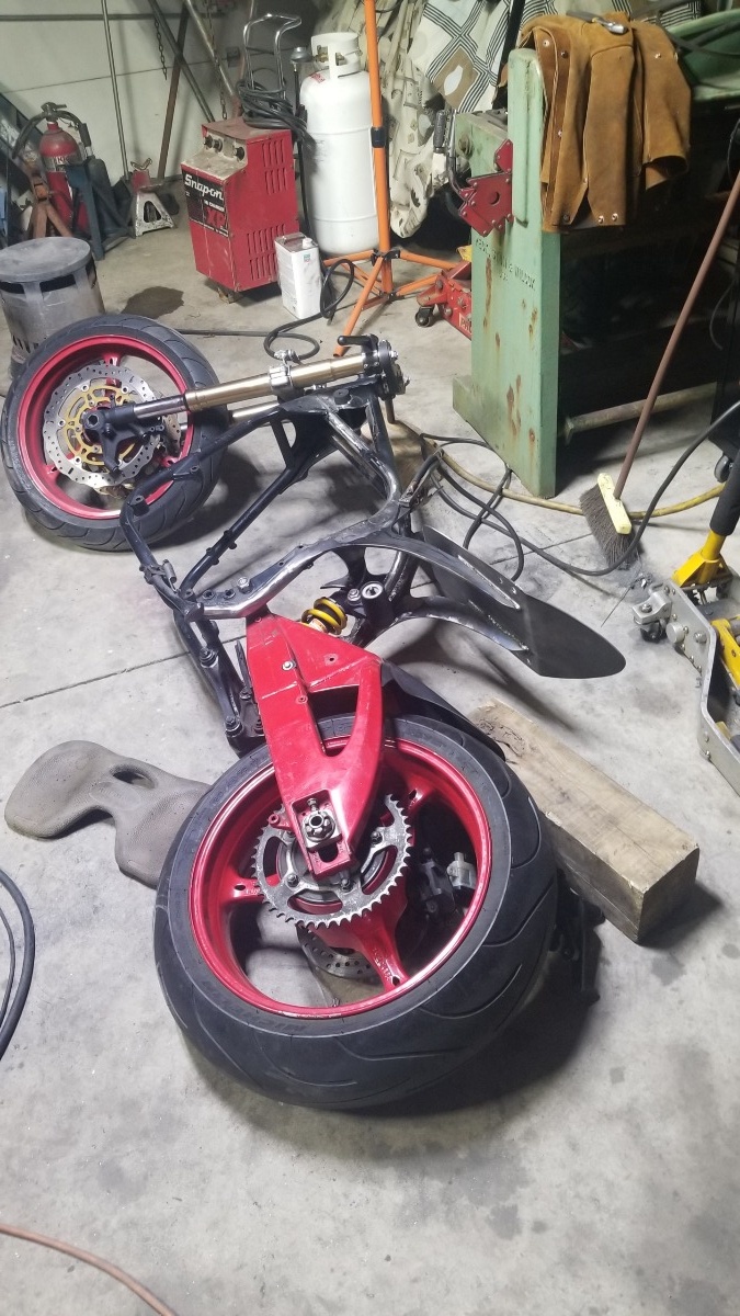

I dont have any pictures of the pieces that made the final cut but i have a few pictures of the bad ones of course.
First mocked up with the paper temps.
Tacked on ready to burn

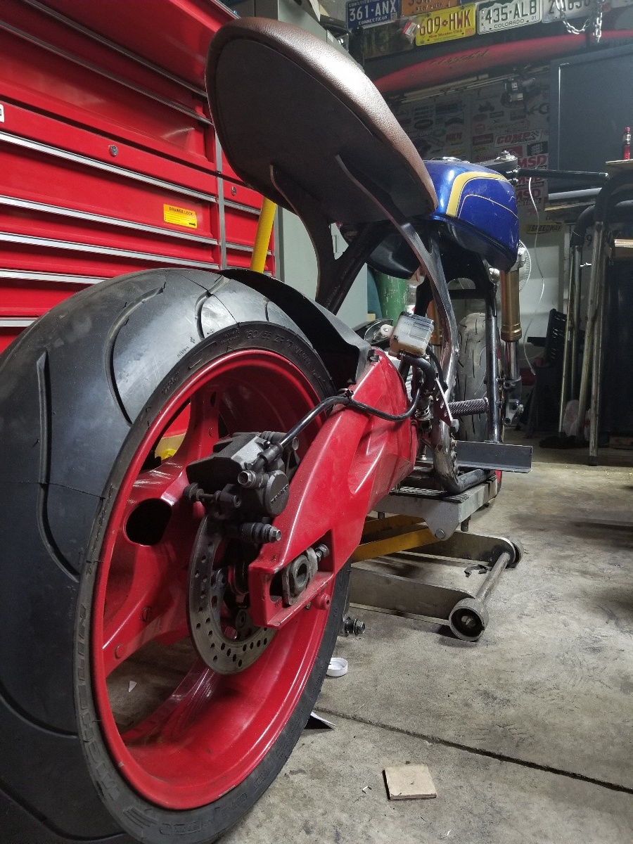

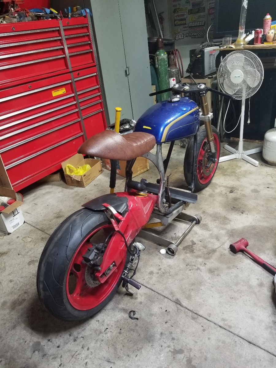

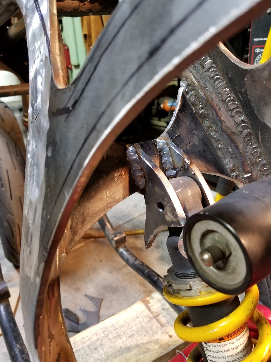

Forks and swingarm went on and the bike was set at the ride height i wanted. I took this time to make a seat pan and i was also able see where my shock mount would be and i made that up and welded everything

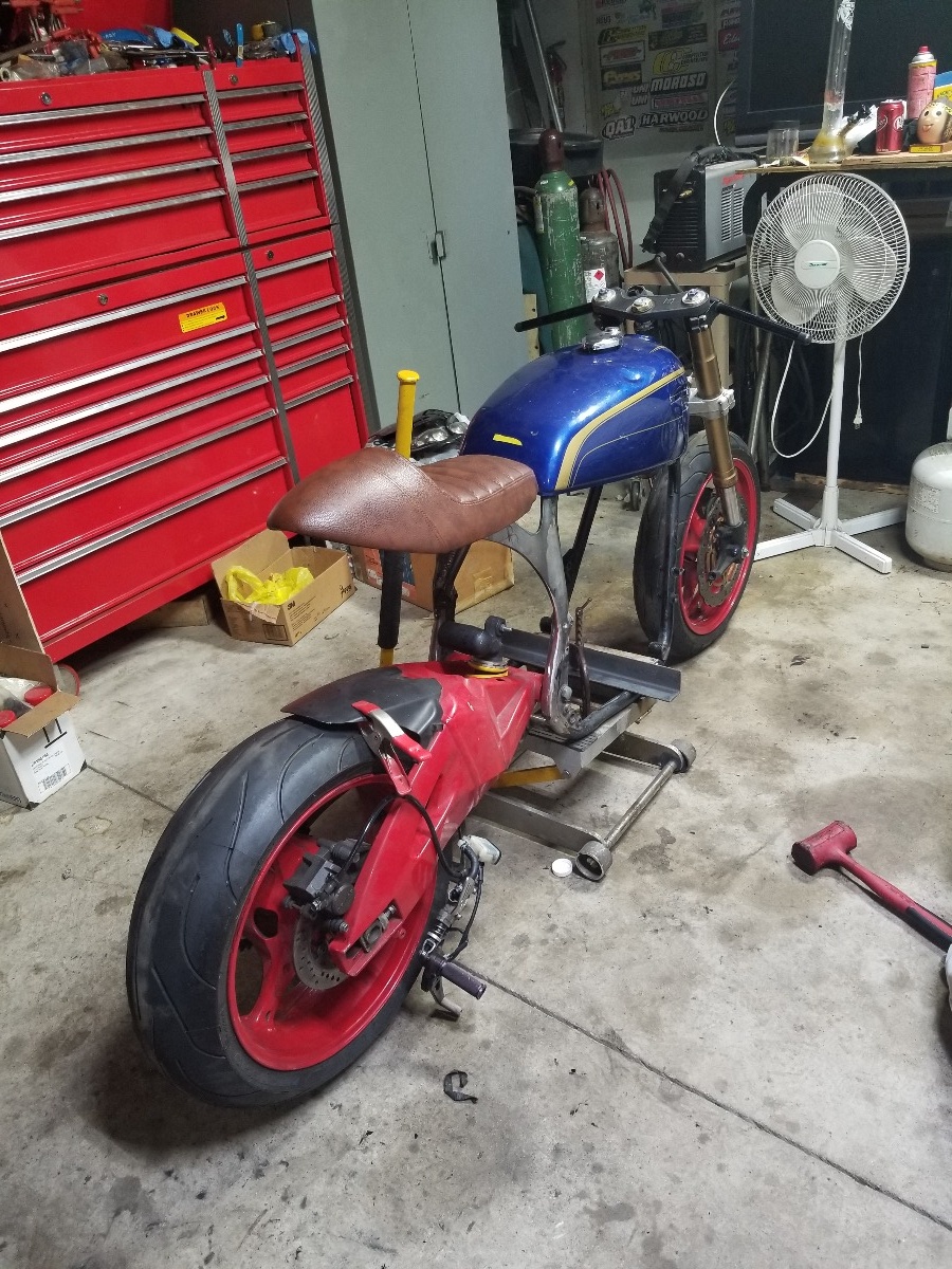

Here is the bike as of tonight, got too late but it does have spark. Back to it in the morning
