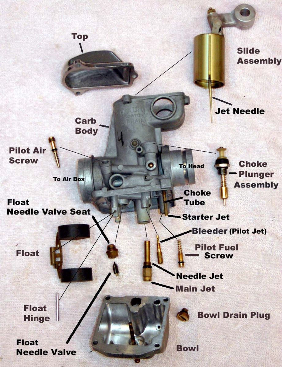

A good ultrasonic cleaner if you're gonna do the carbs yourself.
Good quality carb kits. Don't cheap out on these.

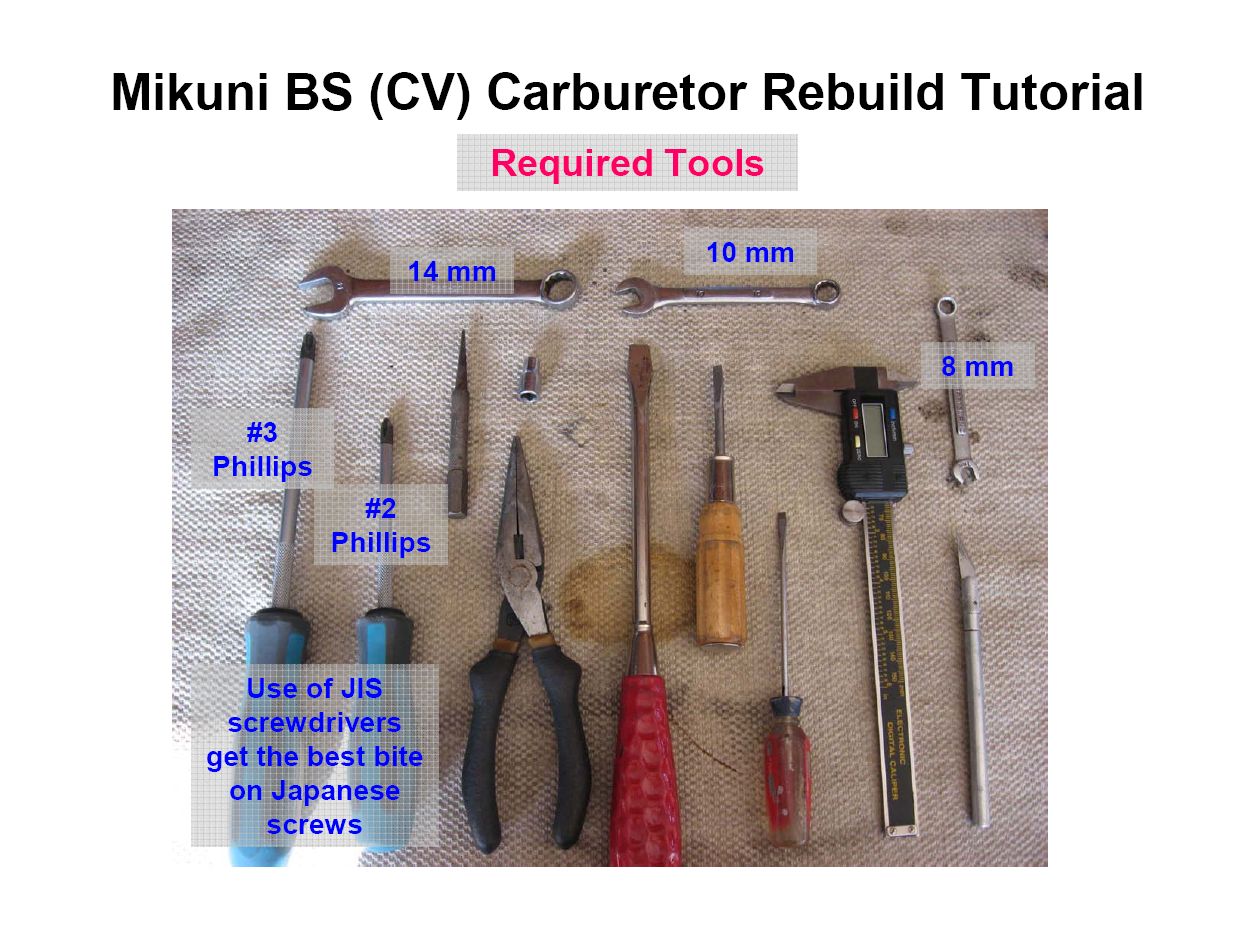

Good JIS screwdrivers.
An impact screwdriver w/JIS bits.

Disassemble and clean the carb internals like, carb bowls, needle valves, jets, fuel and air passages.

As stated earlier in this thread be sure to use JIS (Japanese Industrial Standard) screwdrivers - NOT Phillips; they definitely are different even though the screws look very much alike. Ed
