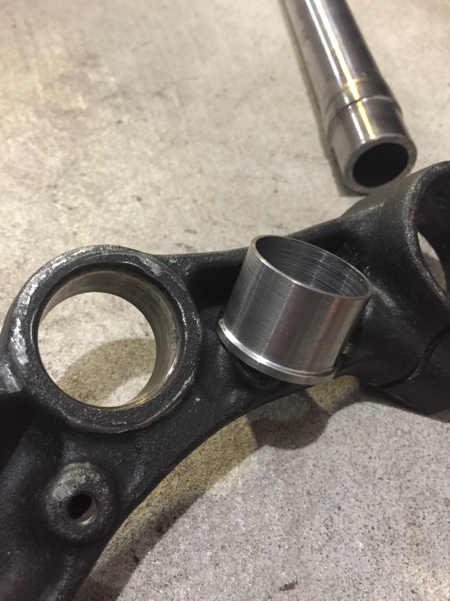

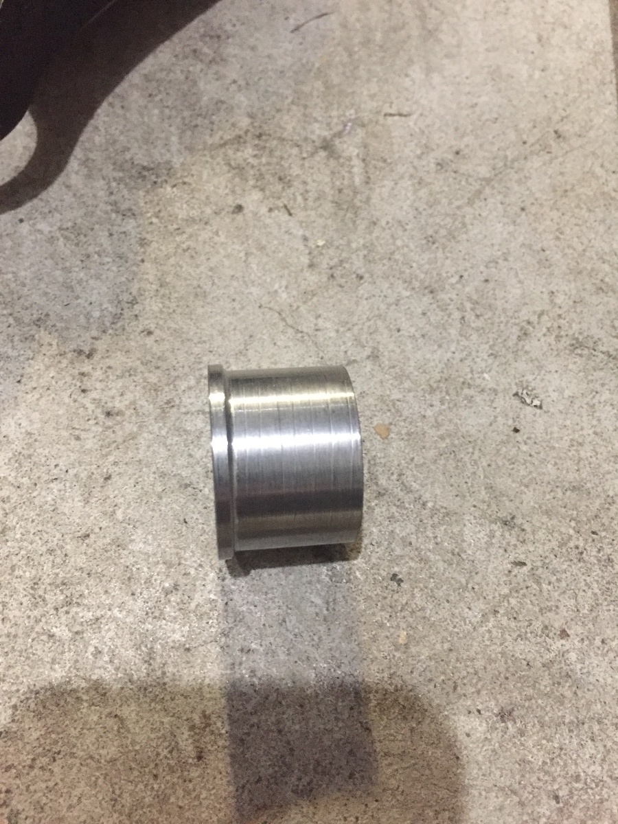

the kat lower triple is forged .not cast. which anyone that calls themself a welder would know with one touch of a grinder.
when you need such a thin walled bushing.
i get an oversize slug of steel and bore the hole to match the kz stem and press it on the stem.
i then reach inside and weld the bushing to the stem.then i chuck it up in the lathe and machine it to be a press fit into the donor lower triple.
here is a thread on the subject. www.kzrider.com/forum/5-chassis/325862-triple-tree-custom-work page 3 has some pics to illustrate the process.
lemme know if you need any further help.

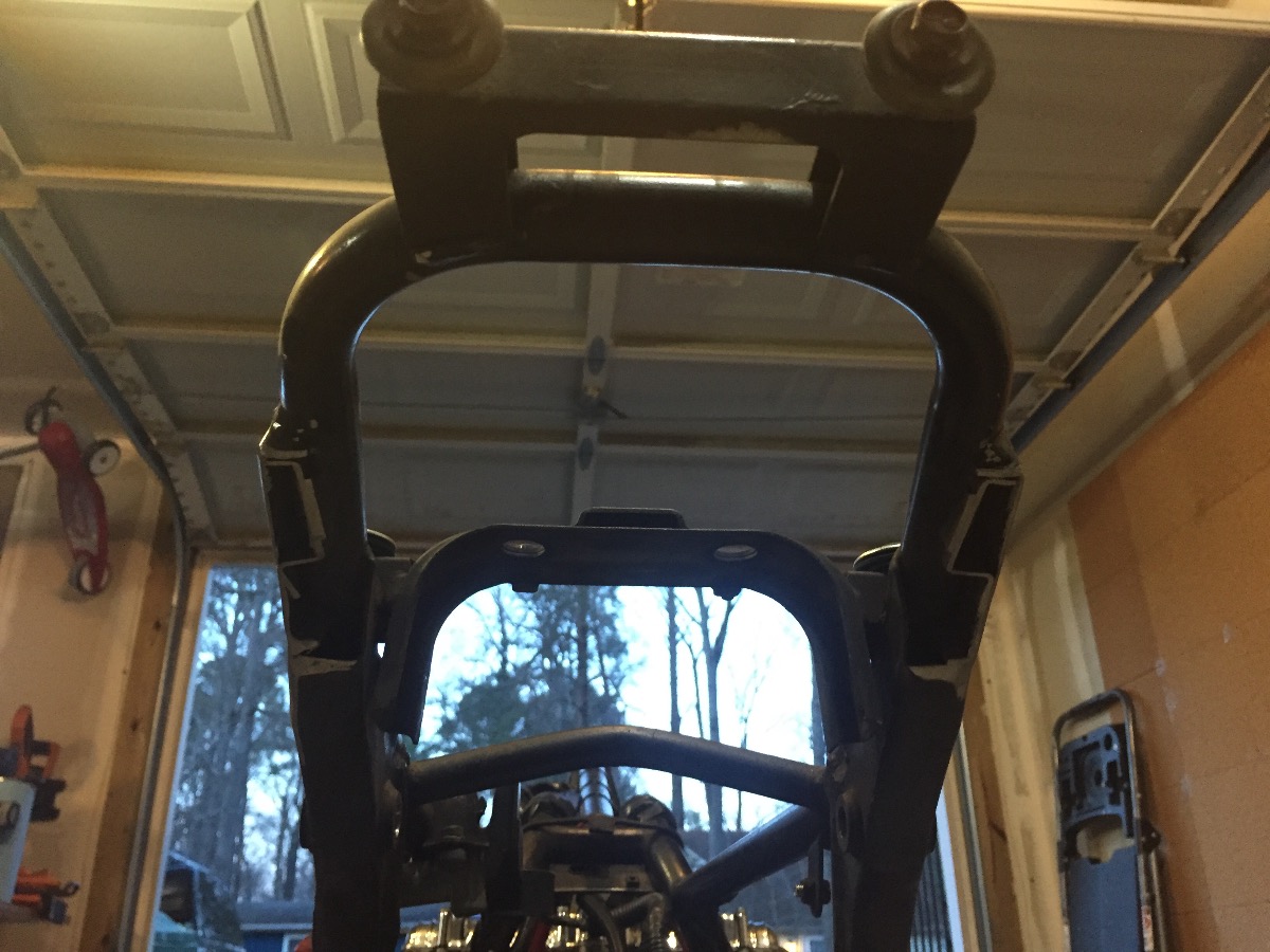

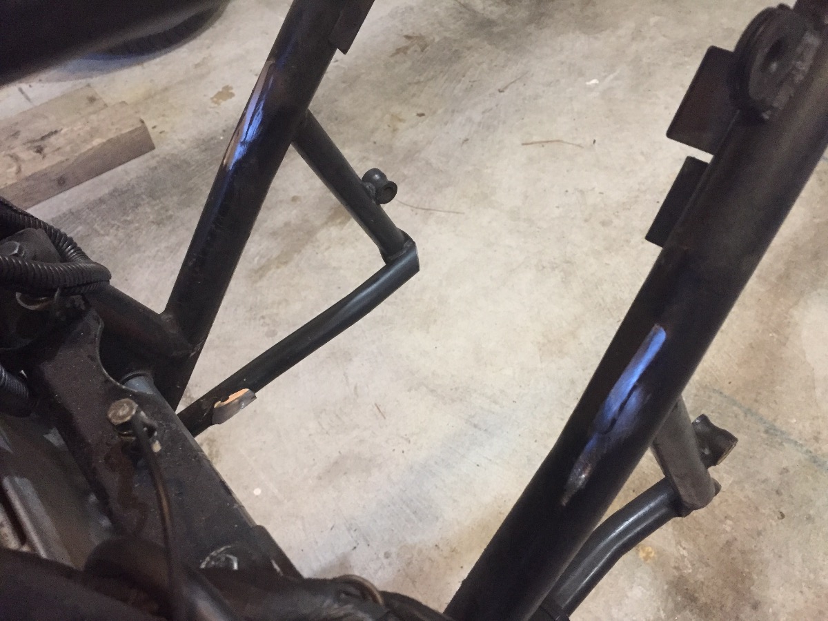

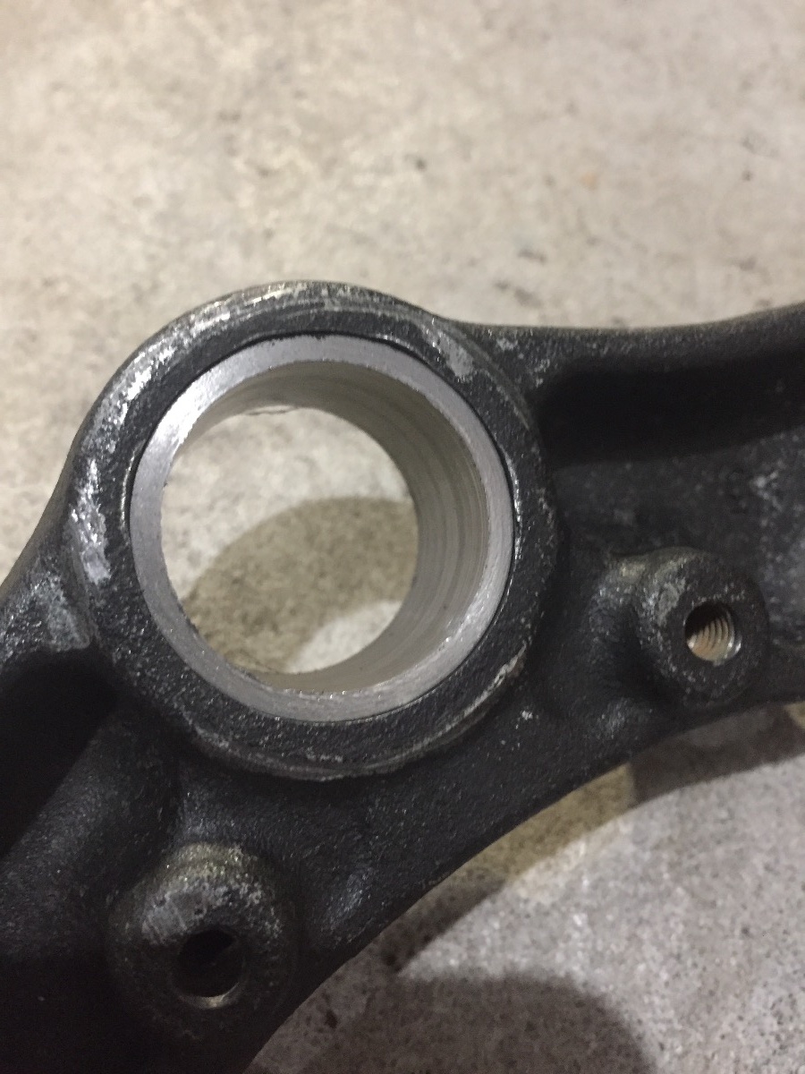

Cleaned up some cuts and grinds. Cut off the stock turn signal/grab handle mounts and the rear battery box mount to make room for the monoshock mount.

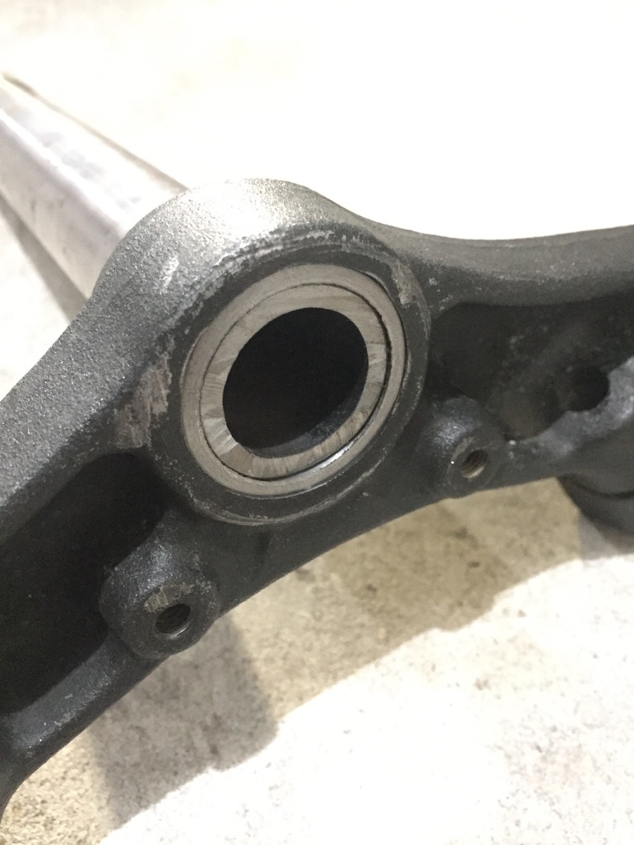

My buddy ended up making that sleeve for the steering stem and lower triple. It turned out awesome. He’s going to weld it all up underneath so it’ll be ready to mount up.

I appreciate it, Leon! Thanks for being there for back-up. He got it all welded up last night and it's ready for install.
