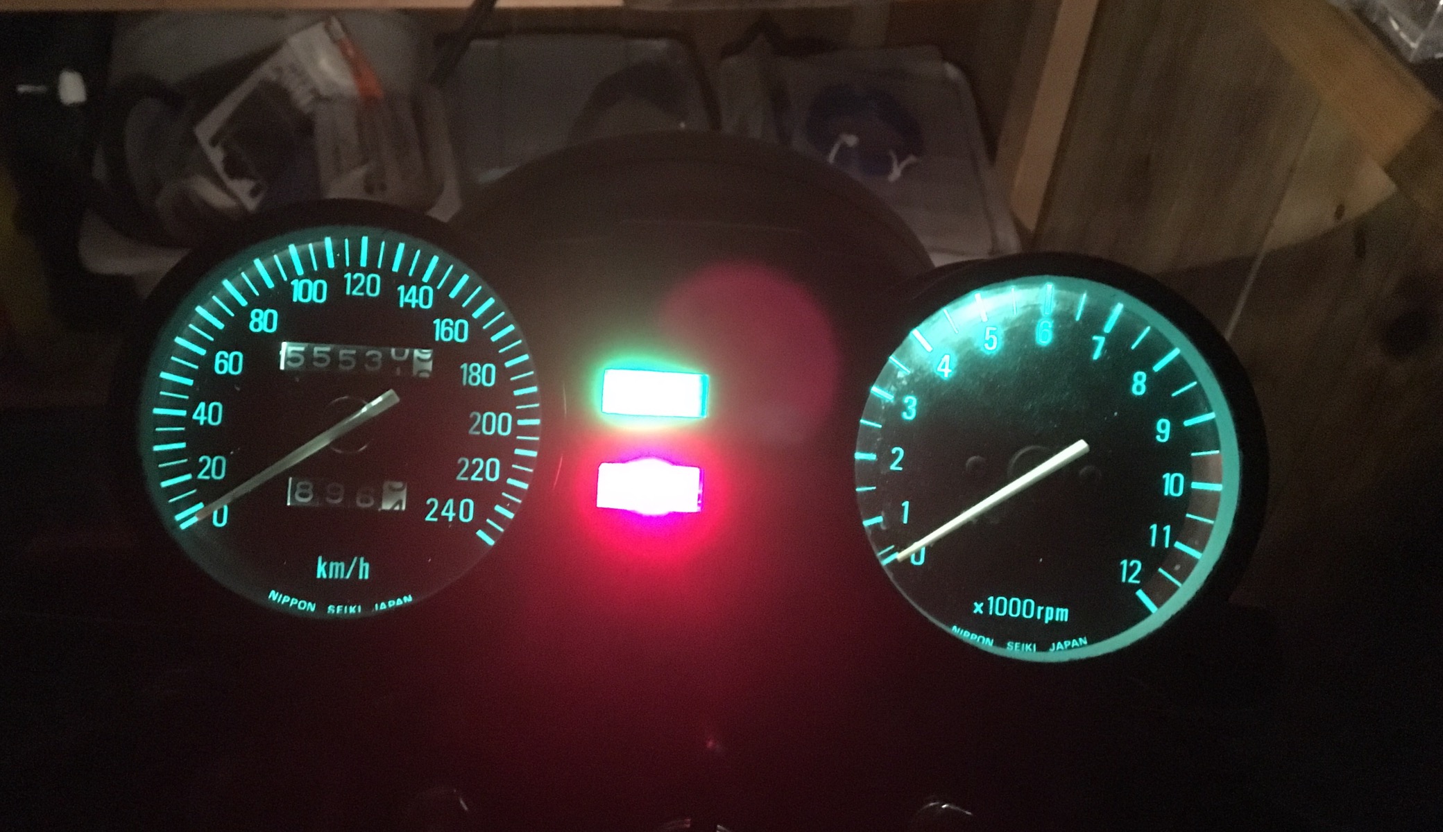

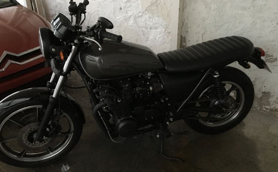

Today have I replaced broken lightbulbs in the instruments.
Starts to got close to season start
Install exhaust and fasten the front brake lines, and then be good to go

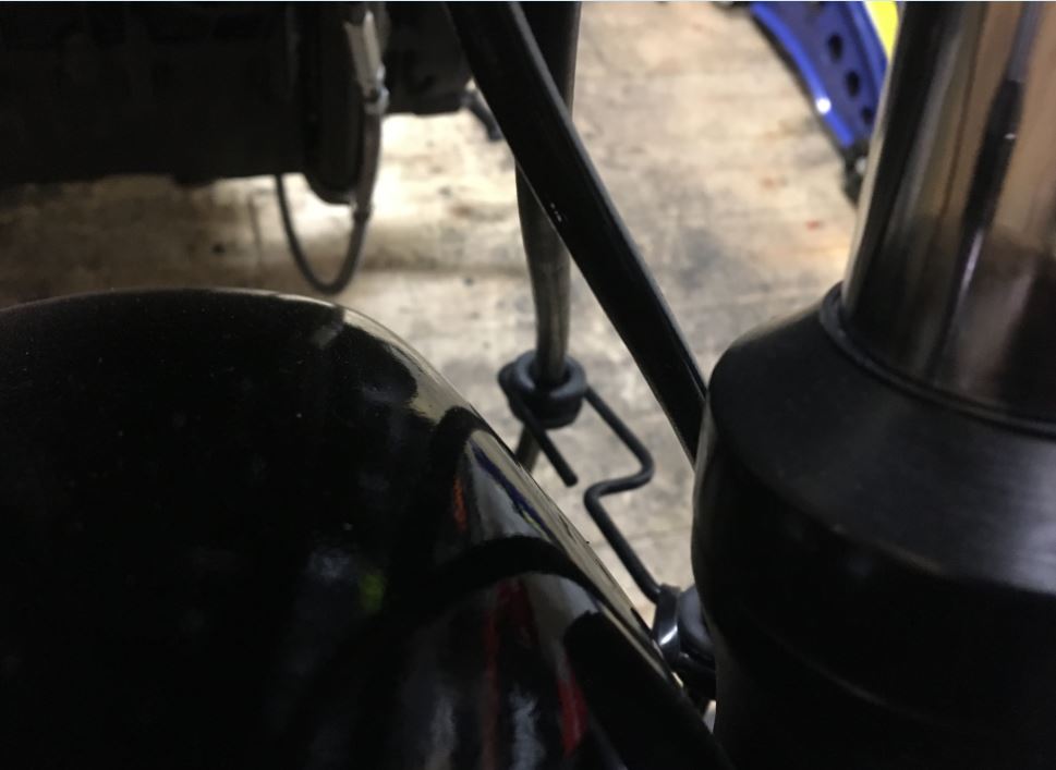

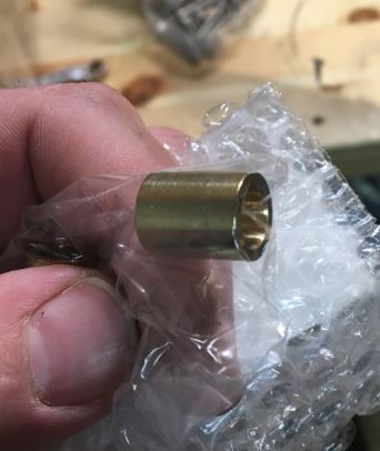

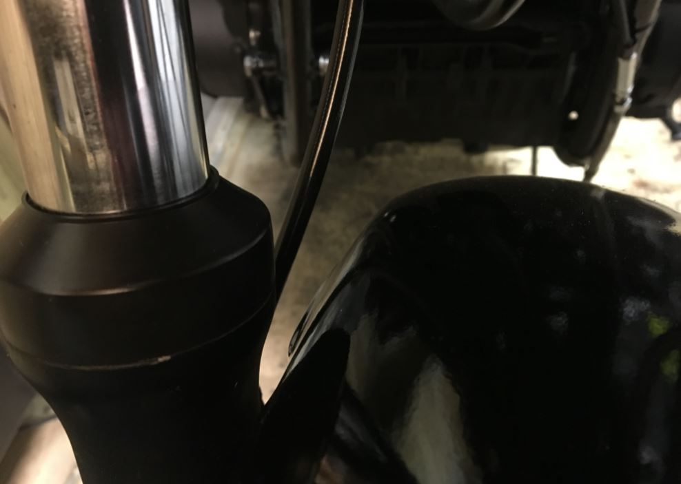

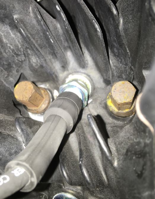

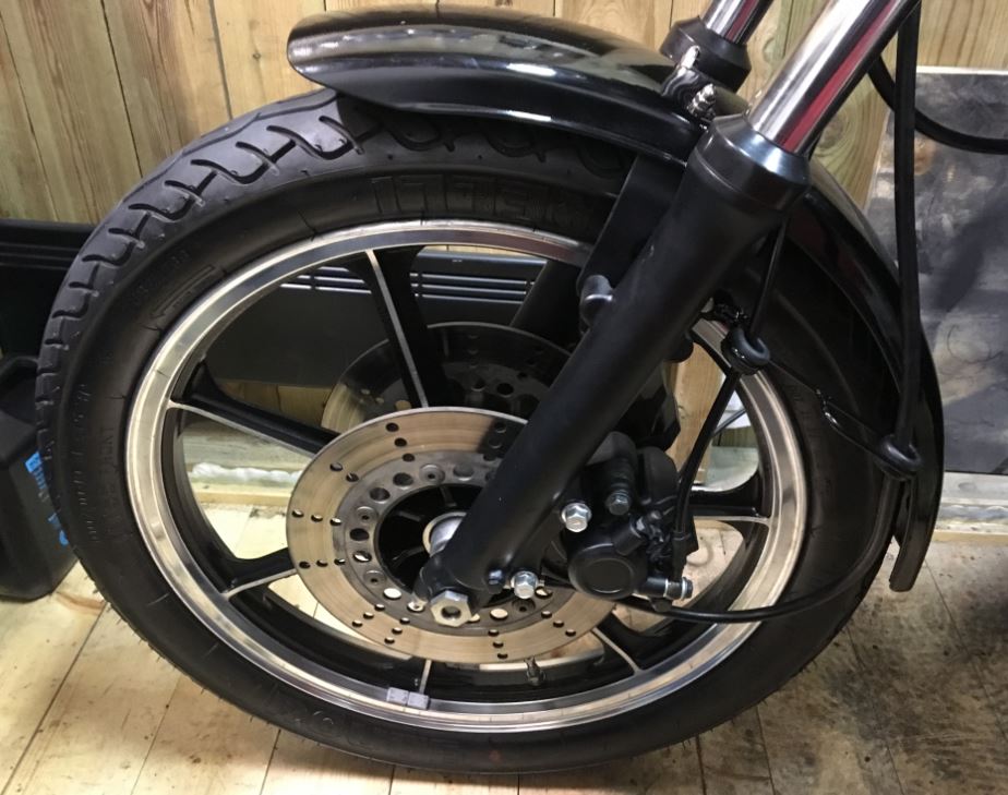

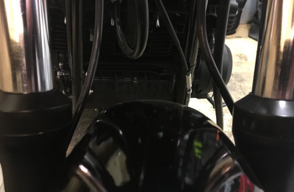

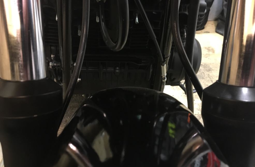

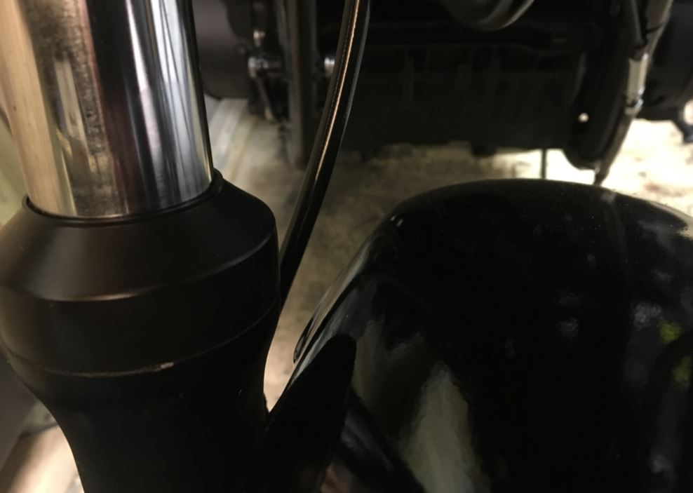

I have had problem with the brake lines touch the mud cover, I ordered some spacers on eBay and painted them black, I think the problem is solved now.
I have gotten some help here:
www.kzrider.com/forum/5-chassis/609666-b...uch-mud-cover#801018
www.kzrider.com/forum/5-chassis/610212-what-is-these-called

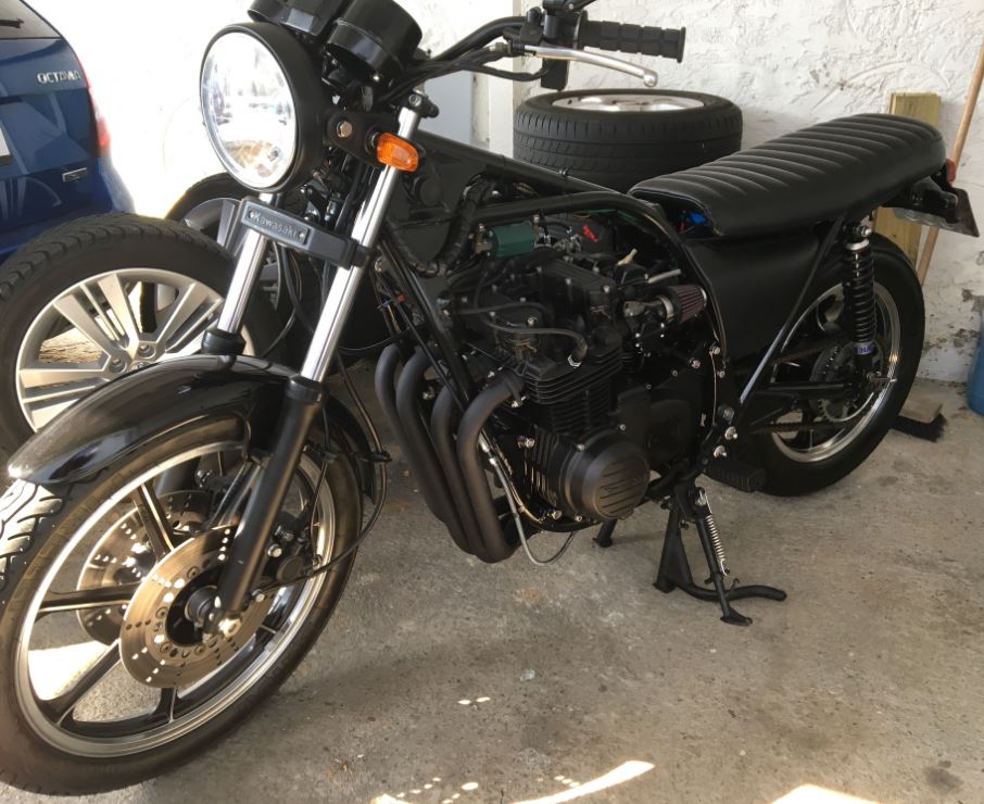

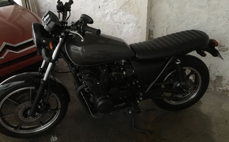

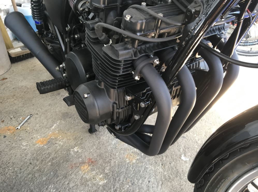

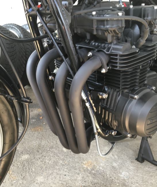

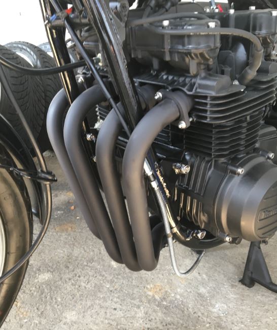

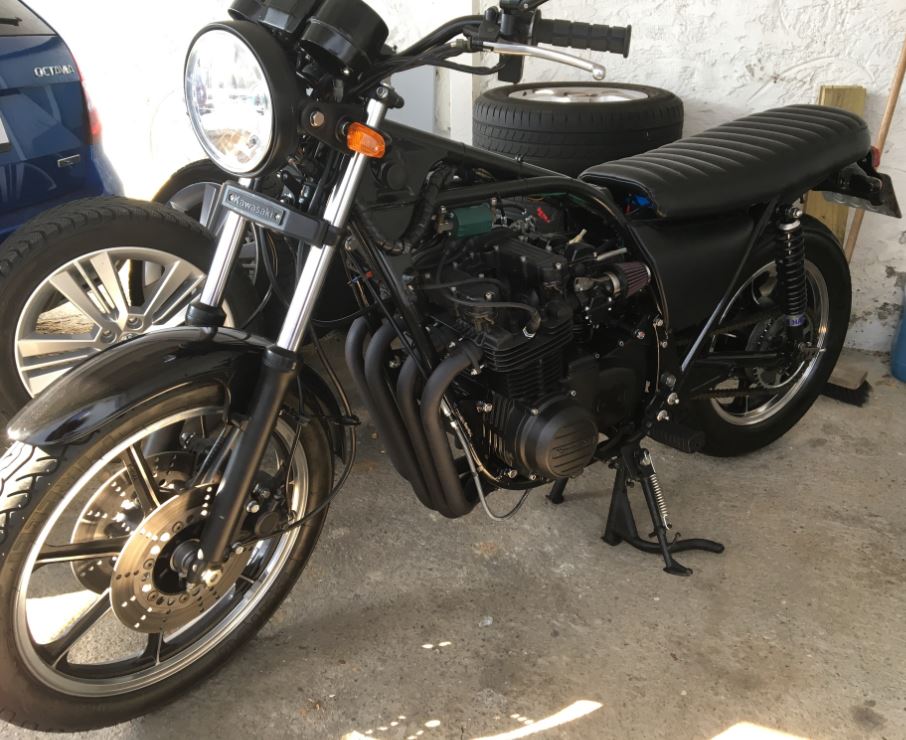

Today took I the bike out for the first time from winter storage, spring is here now

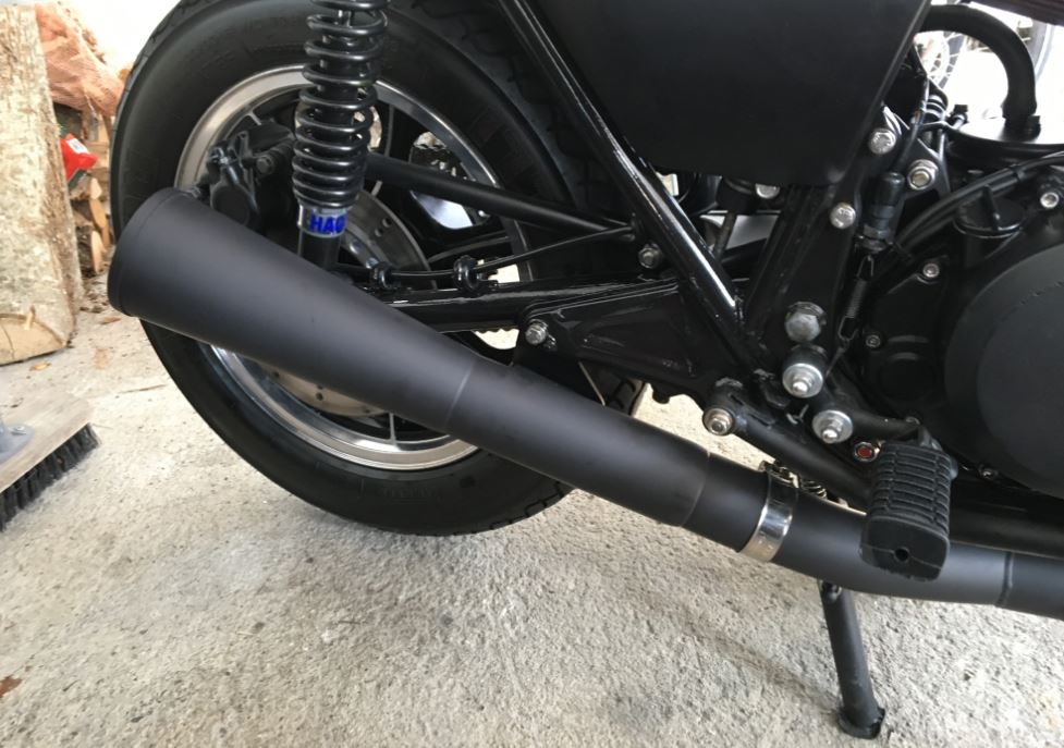

I installed the new exhaust system, happy with the results. I also flushed the gas tank with new gas (have stored it with WD-40).
Looking forward to start up the bike with the new exhaust system, maybe tomorirow
Some picture from todsys work:

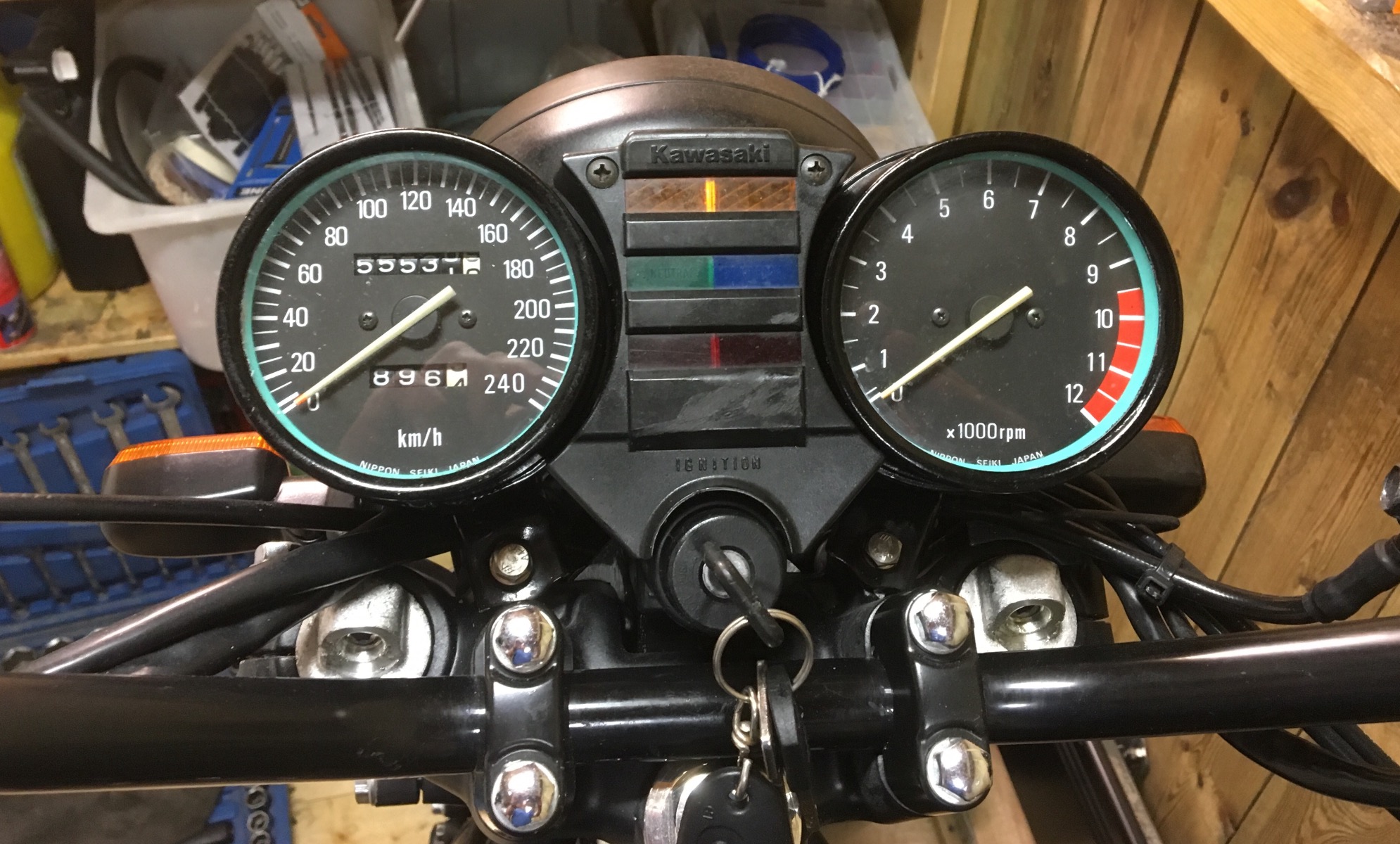

The tacho meter was not working, wire was broken so have order new...
The speedo meter was also steady.., have jumped around before! Greasing the cable have fixed it.., thank you for the help there

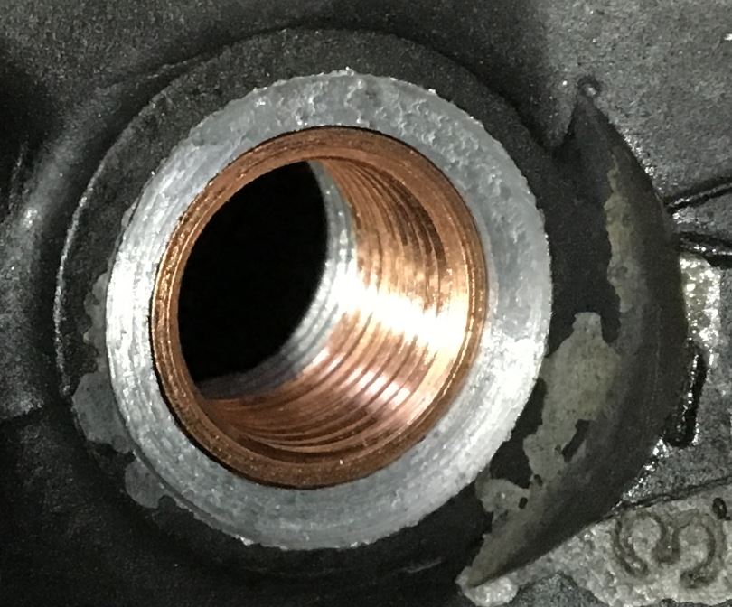

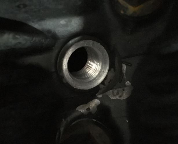

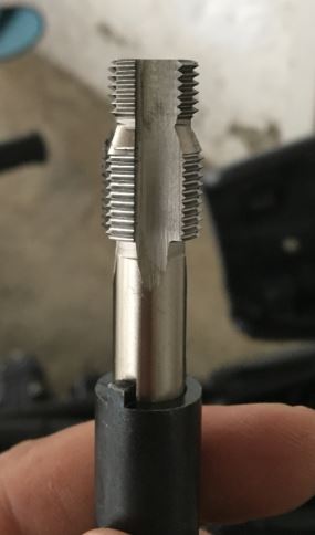

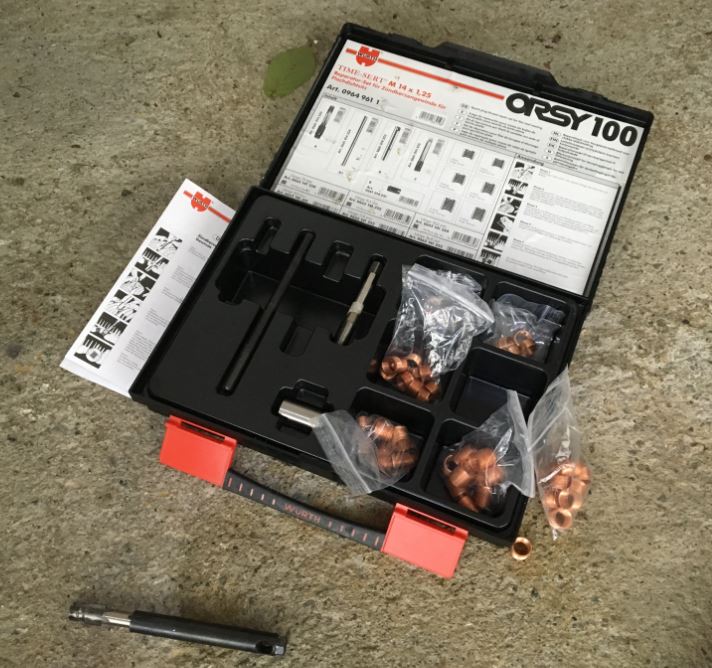

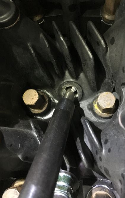

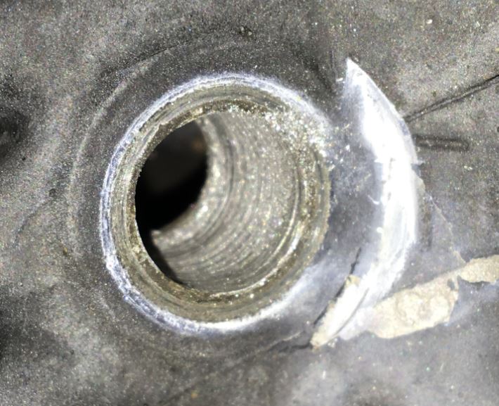

I damaged the spark plug threads on cylinder 2 some days ago, have got some help here:
kzrider.com/forum/2-engine/610761-damage...eads-to-spark#804935
Today was I at the mail office to get the Wurth timecert kit I have bought for a good price. I don`t know if Wurth is common in US? In Europe in stand for quality parts...
I diden`t had any problem using it, and I think the results is quite good. The insert could have been longer, you can see it from the picture, but I have now threads from approx. 80% of total.
Fun to be able to fix things self
