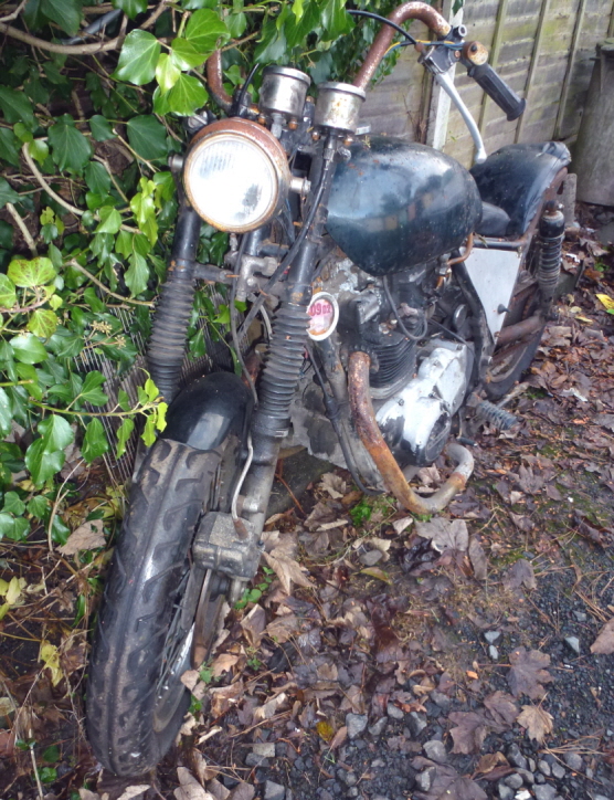

Just for a laugh - this is what I started out with !! It was 2 days away from the scrap yard. Despite the looks, the engine had been refreshed - rings, bearings, chain etc. and then just left outside in the weather for 3 years !

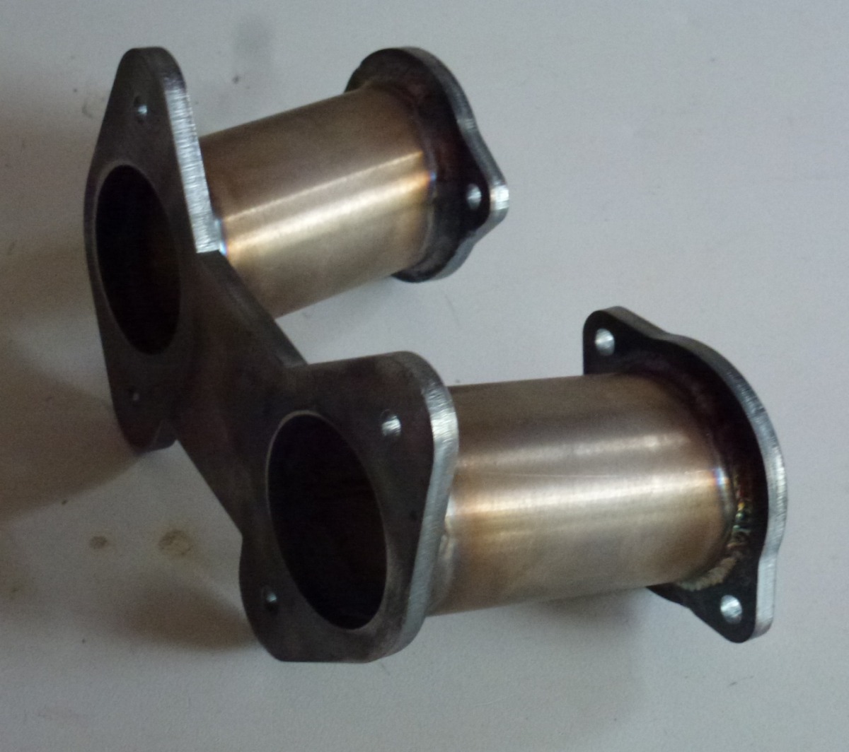

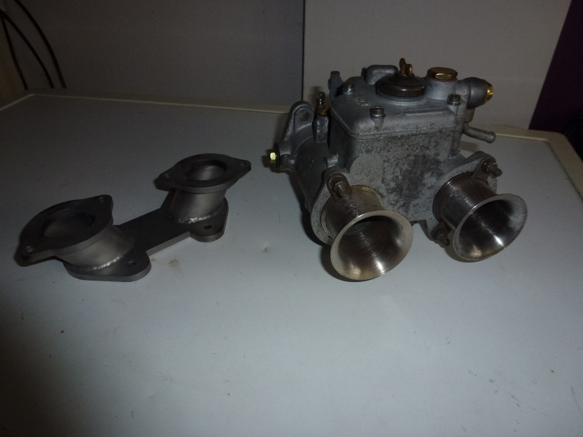

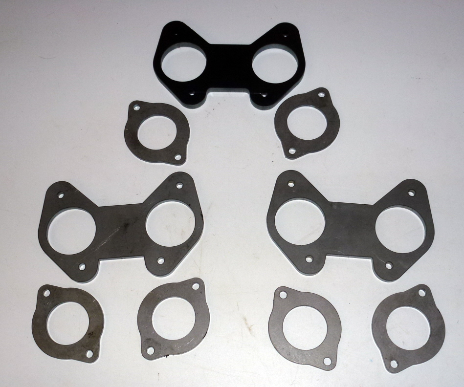

Here's the Weber conversion I designed. I had the two different length manifolds made so that I could play with different airflows. I'm probably going with the shortie version. One will end up as a spare or get sold.

Nice head. Two plugs per cylinder must have taken some precision work since it looks like little room for error there.
It will be interesting to see how the weber works.
I'm thinking you have done this kind of thing before

Thanx for the kind words JR. My pal made a jig for the job and I can't take any credit for the machine work !

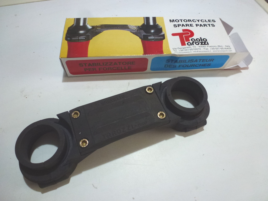

The last part for the chassis arrived today - courtesy of Tarozzi. The bike is now stripped to the bare chassis / forks / swingarm and bubble wrapped ready to go round to my pal's garage. I hope to have the rolling chassis mocked up on the ramp before Christmas - then it's making up the spacers / sleeves for the Grimeca spindle and a spacer to centralise the rear and the chassis will be truly rolling !

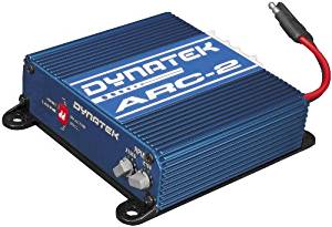

Dynatec have been very helpful in suggesting an ignition [ DARC-2 ] to suit the supercharged engine.
