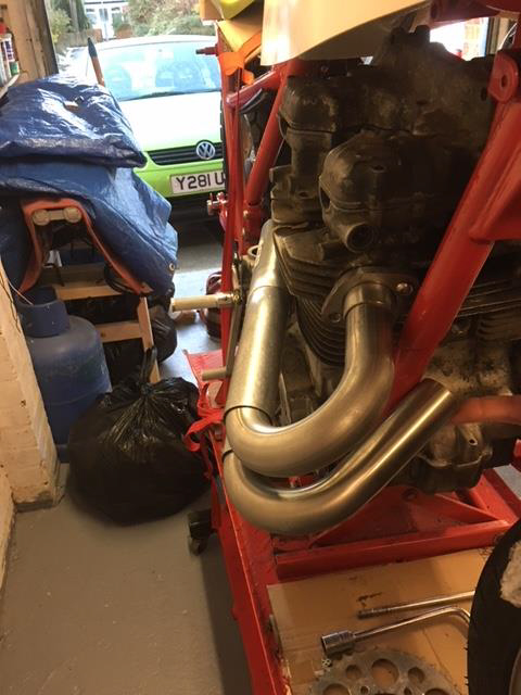

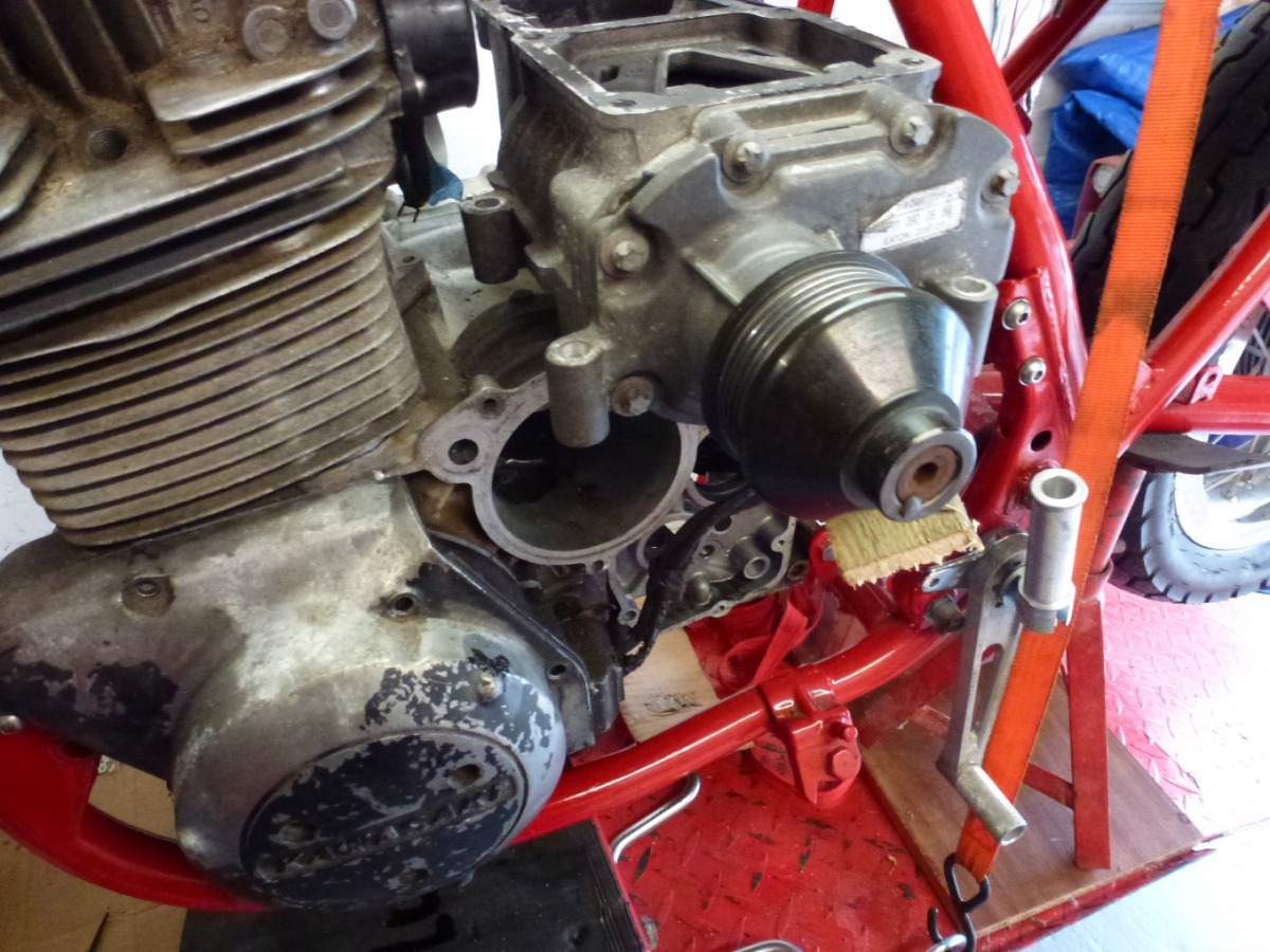

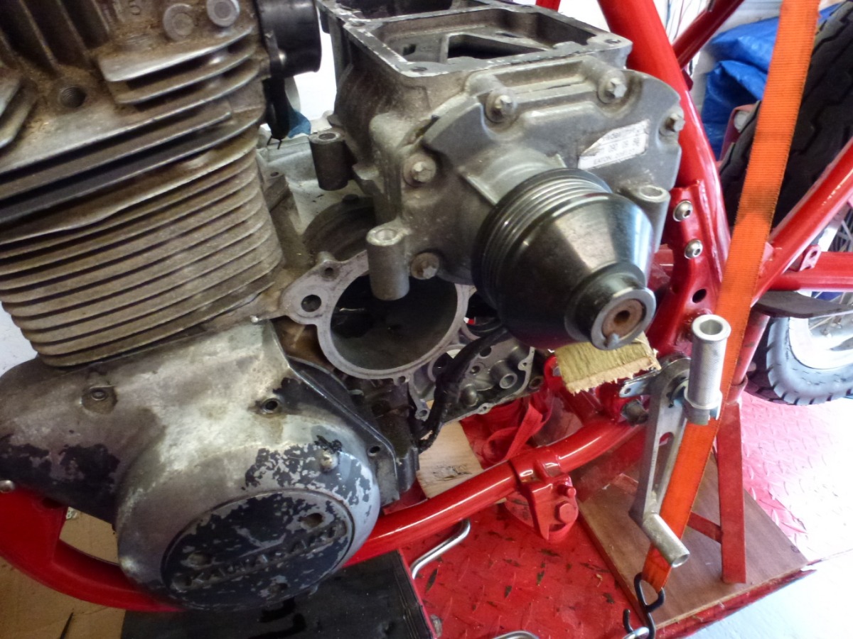

back to the main plot ...... what a difference a day makes - or to be precise - half a day !
After a bit more research, I've worked out a satisfactory method to drive the blower, and blowers are my thing !
As well as the obvious progress in the pix, the blower manifolding / mountings have been worked out as well as the carb intake for the SU - which I guarantee will make you go weak at the knees !
. The exhaust has been swung over to the other side - and will also look the bollox.
Also rough mounting points for the seat and "tank". The seat is sitting 2" high in the pix as it's currently over the tie down straps. The Tarrozi fork brace is total bollox ............. nowhere near - after I had to order it specially - and of course pay a premium.
There is loads of room for the fuel cell [ under frame ] which again has worked out a treat. Room for TWO NOS bottles hidden under the "tank".
A lot of other "whatif" ideas have also been crystallized.
Thanx to my pal Brian - who is barely well enough to move into the garage, never mind carry out the precision fab work.

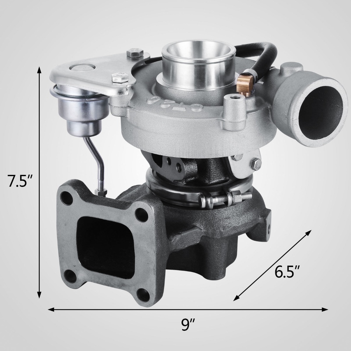

So YES, it will be Eaton blower now, anyone want a new CT20 turbo !!!!

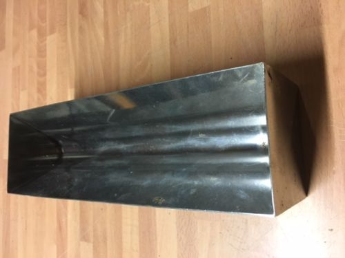

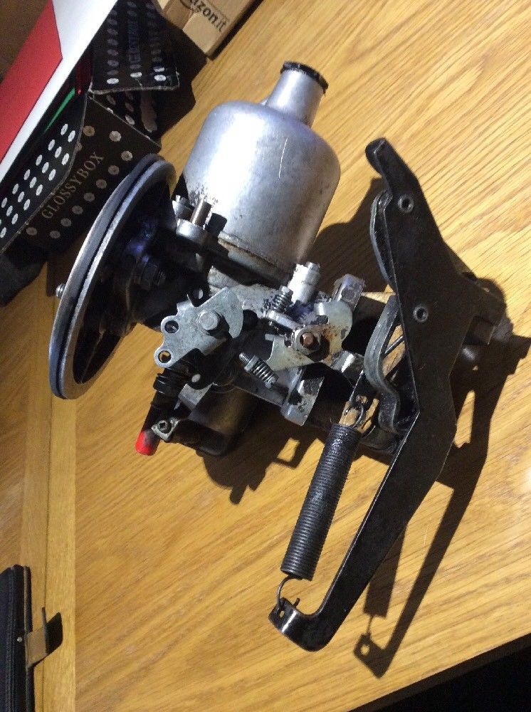

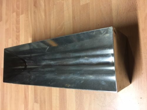

A few more parts arrived ready for an onslaught after the Christmas break. i now have an 1 3/4" SU in excellent condition - so I have a choice now of 2" and 1 3/4". I also bought some stainless steel terrine moulds [ !! ]which are ideal size and shape to base the blower plenum on ! At £2 each - cheaper than getting something fabbed up ! I also ordered some more random stainless steel bends to make up the blower manifolding. I've found a guy who can fab up the under frame fuel cell and also a couple of belly fairings that might do the job of covering the tank.

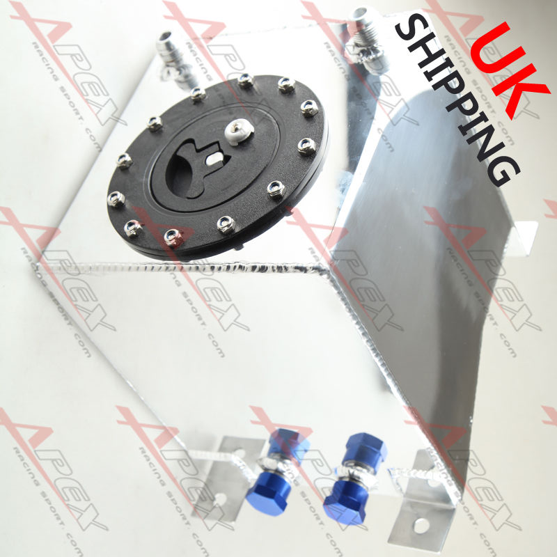

What a difference a Christmas break makes ! Out goes the underframe fuel cell - not allowed in the regs. With the switch back to using the Eaton supercharger THERE'S NOW ROOM IN THE FRAME TRIANGLE BEHIND THE ENGINE FOR A 2.5 GALLON [ IMP ] FUEL CELL. !
After getting quotes of £125 - £175 to get a fuel cell made in the UK - I found a unit on Chinabay with almost the exact measurements I needed - price ??? £56 delivered ! That should be here next week then we can get on with mocking up the blower / carb plumbing.

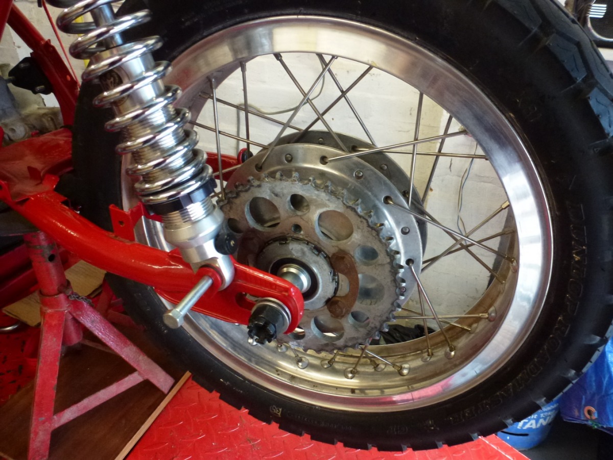

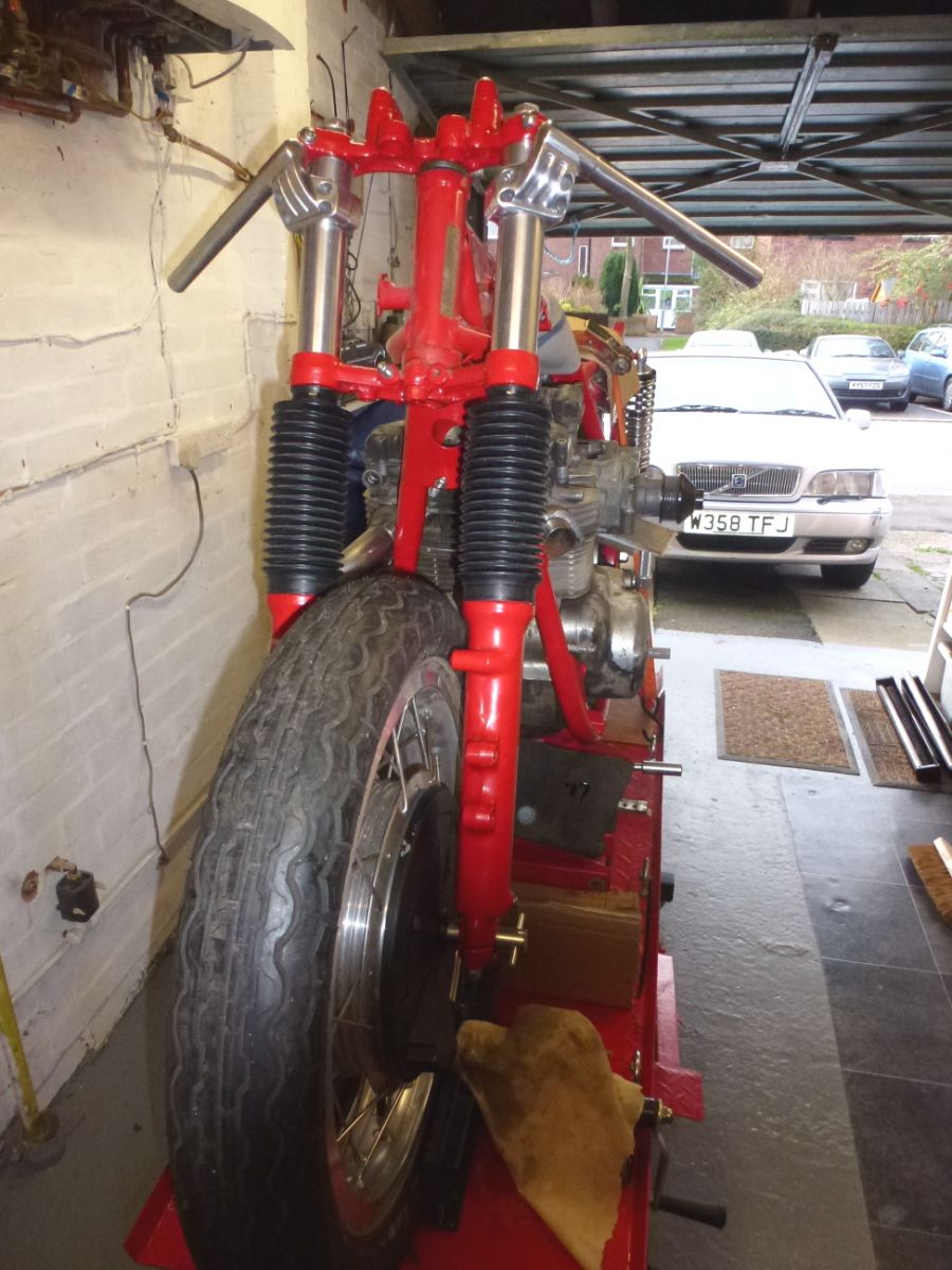

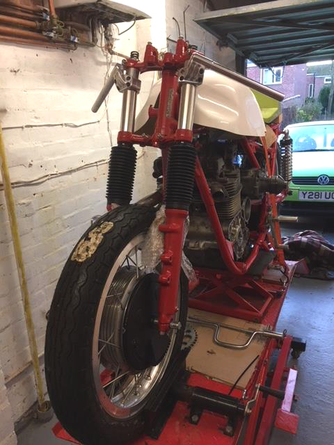

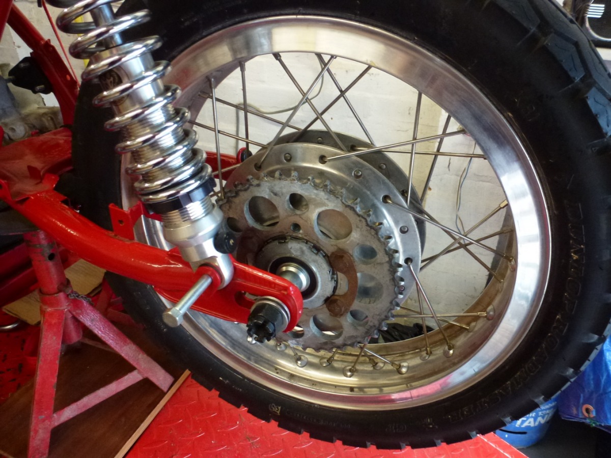

The forks have now been assembled with the new springs - actually managed to get the fork caps on without cross threading them ! That means we can now finalise the front and rear wheel spindles and once they're made - the chassis is truly "rolling "

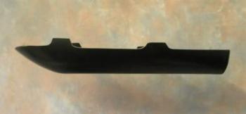

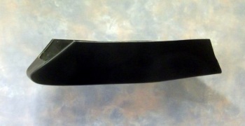

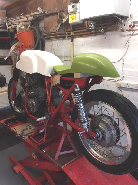

Oh dear ..... my pal measured wrong !! The tank I bought will NOT fit in behind the engine as thought. back to plan A. The tank WILL now go under the frame ! Having declared it illegal in the regs. it appears they didn't read my specs correctly and the fact there is a reinforced GRP belly tank fairing covering the tank was overlooked - now LEGAL again. I've ordered a generic Superbike belly pan from ragged Edge Racing here in the UK. Should be here in the next week o two. It's the one on the right [ scroll up ]. I've now collected my new twin plug head and donor late engine [ 1980 ] together with new pistons and rings, gasket set and a spare exhaust cam that I'm modifying to go in the intake position [ ie ex. spec cams for intake and ex. ]. Next job is to make templates for the blower mounting and finalise the front and rear wheel spindles and spacers so the chassis will be truly rolling.
