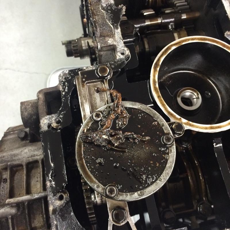

14 Jan 2018 18:02 - 14 Jan 2018 18:06Is that the remains of their pet frog that went missing 5 years ago (on the oil pump mesh). Sorry about the late entry I just saw this thread, its great to see that you are going ahead with this build.GregZ wrote: This by far is the biggest piece of chit I ever seen. I knew it the day it showed up on the trailer, I knew then to cut my loss and sell, let some other idiot restore. But I'm a dumb ass so I'll give it my best.
There is nothing good on the bike. I'm starting with a frame and top engine case. The crank is junk , trans is junk and I'm hoping my buddy can repair the lower case, it;s cracked and and one of the mount lugs for the point housing is busted off. the timing chain guide was broke off, in two pieces caught in the crank etc.
look at this crap

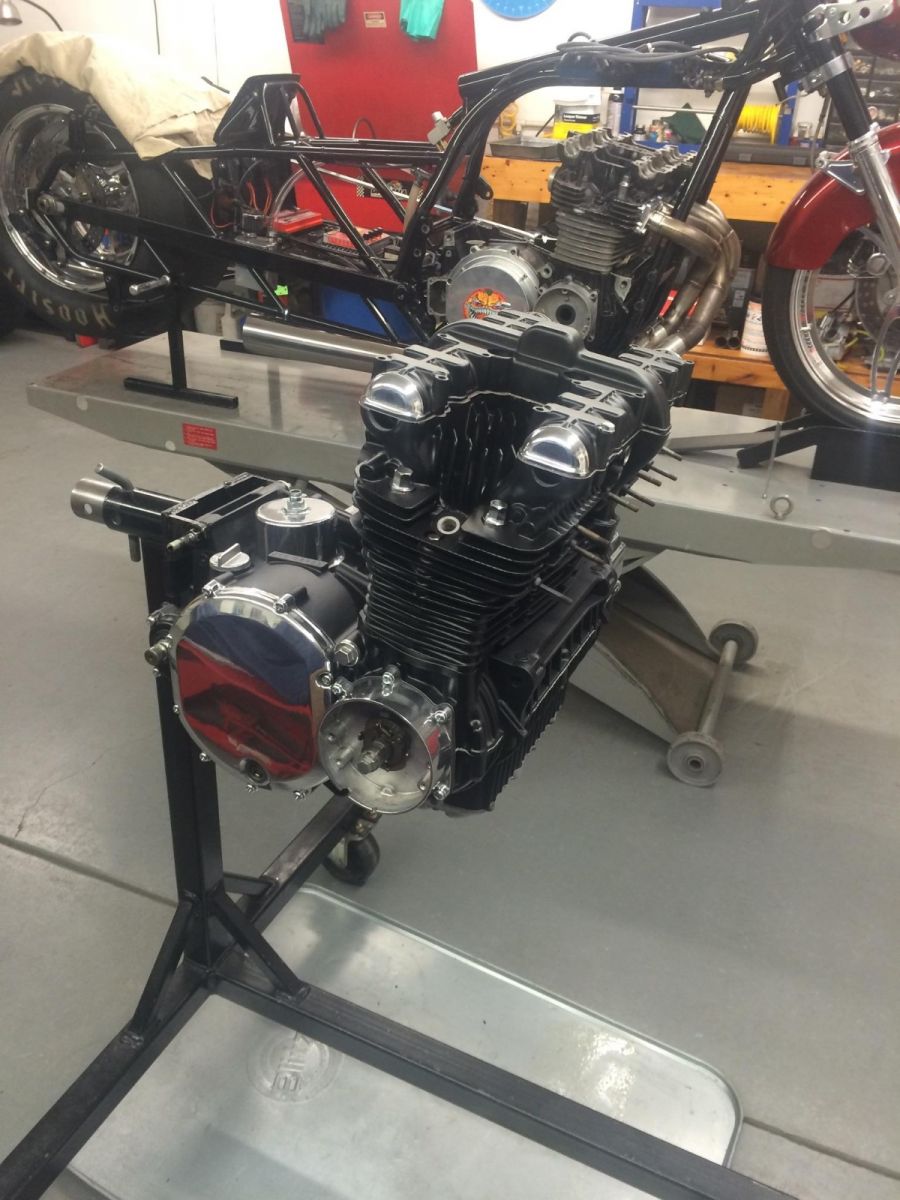

27 Jan 2018 13:05GregZ wrote: It's looking better. A few more minor things and the engine will be done . Nothing was reused from the texas turd engine except the cases. New used crank, block stock bore pistons new rings. New used head, new valves , guides and seals. New used clutch basket and brand new clutch plates. trans thoroughly inspected and near perfect shift forks. New cam chain and rollers and gromets An incredible rebuild
Nice work! What did you spray the engine with?

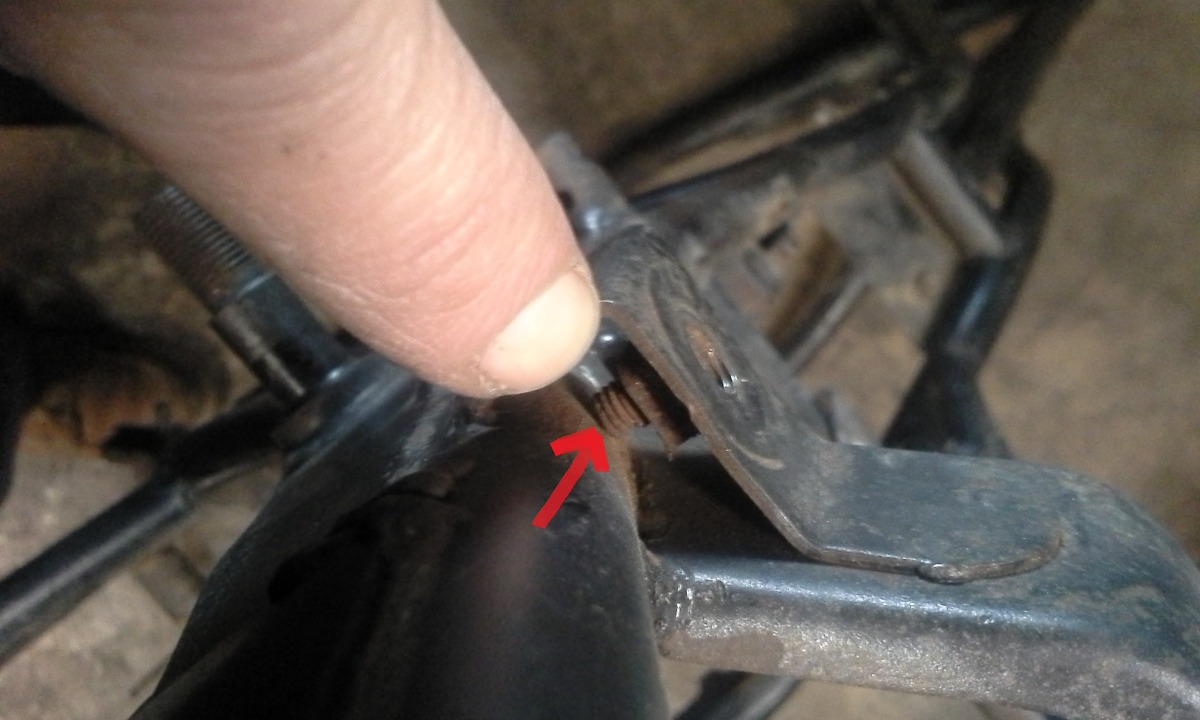

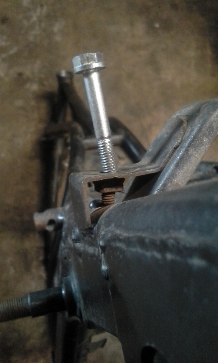

Today I was going to drop off the frame to get media blasted, figured with all the repairs that were needed i'd give it one more look see inspection. I chased out all the threads and found a broke bolt in the tail section mount. How the hell does someone break off a bolt here wtf ? So instead of proper repair the idiot PO drilled and tapped a new hole.
Fixed Texas style
Fixed Texas style

I'll have to cut that piece off and remove the hacked up nut and tack on new nut or try to drill and heli coil it if possible. This bike is starting to be a headache

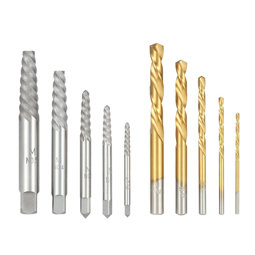

Sorry, but a broken M6 screw should be an easy out for you (me) with the right tools!!!
Make a center punch and use a counter clockwise drill 4mm.

For that broken frame bolt, I'd first drill out the stub of that original M6 screw. LH bits work well. Then weld up the buggered hole, drill, and retap. I think that would be easier than trying to remove and replace the entire tab.
Good luck
Good luck

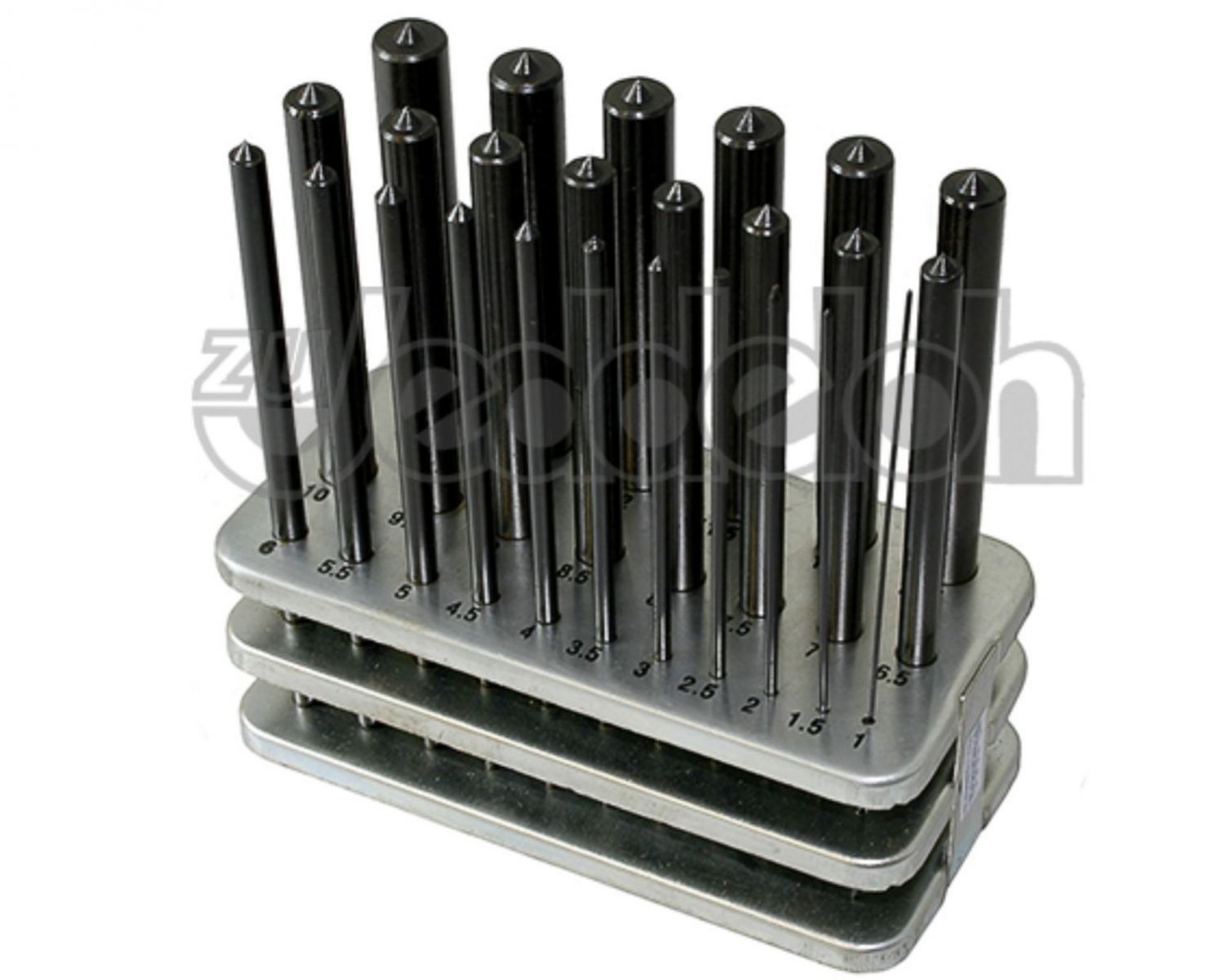

Scirocco: I don't have any background as a machinist. Your pics of the various sizes of center punches has answered a long time question of mine. That being "How in the bloody hell do you get a bolt punched in the exact center." Punching one free hand guarantees this guy will be helicoiling or weld/drill/tap. Now I get it.
