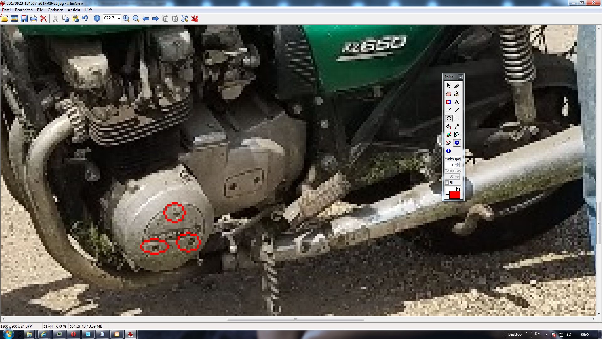

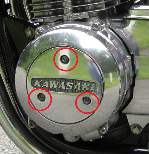

Congrats on a great find and buy! The bike may have been built in late 1976 (look at the label on the steering neck to verify) but it is a 1977 KZ650-B1 model. The engine shown in the photo with your brother looks like a 1977 KZ650 engine, but it's a little hard to tell. If the generator cover has the 3 Allen bolts as shown below it is a 1977 motor. Also, take a look directly above that cover and you should see "652cc" marked there if the cylinders are that of a KZ650 engine. Ed

Date on the frame is 7-76. So it would be a early 77 then. It has three screws on the stator cover.

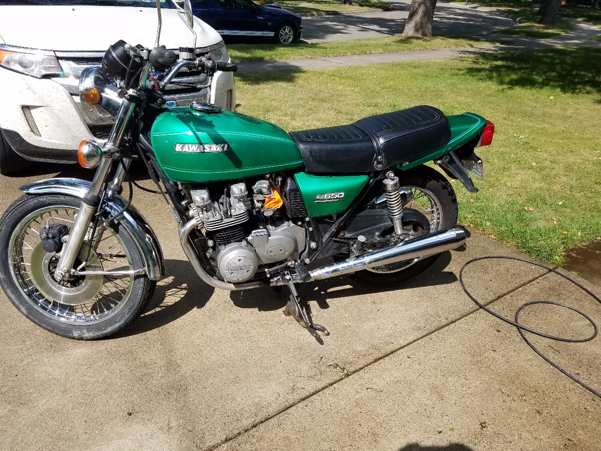

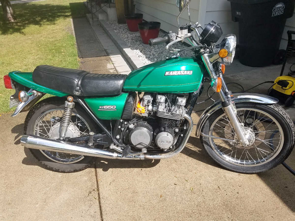

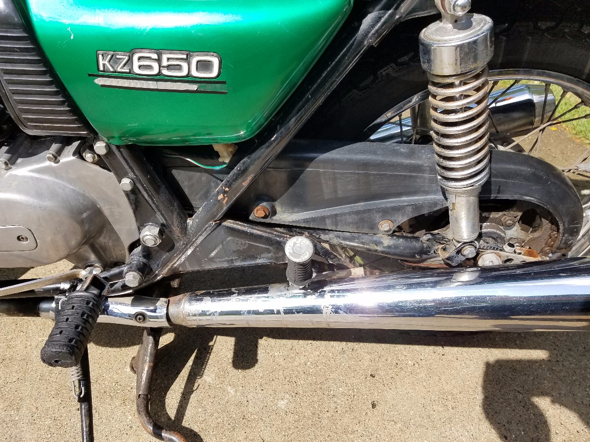

I washed her up today and looked her over.
She cleaned up well, Paint is poor, the clear coat is gone from the gas tank and its pretty scratched up. The gas tank appears to have been red at one time, the rest of the body work is original paint, so the tank has been replaced, or maybe the rest of the body work too.

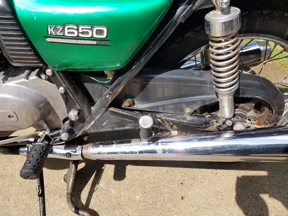

The wheels are really nice, still some hard grease on a few spokes, but no rust. Rusty spokes just plain suck, but these are great. Front tire is probably the original continental, it's really cracked, but it does hold air. The rear tire is a Kenda and looks new, I'm not sure how old it is though. The exhaust is nice. Unfortunately on the left side there is some rust spots on the frame and the chrome on the muffler has been removed in spots, typical damage from a battery vent.

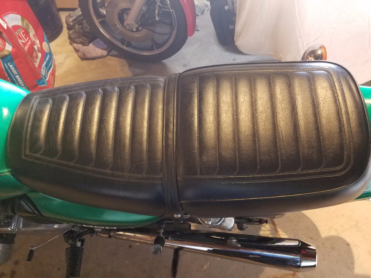

The seat is fantastic, just a few tiny pokes in the cover. Great original seat cover.
Very nice complete bike, the missing rear turn signal just needs a hollow mounting bolt and I have one of those.

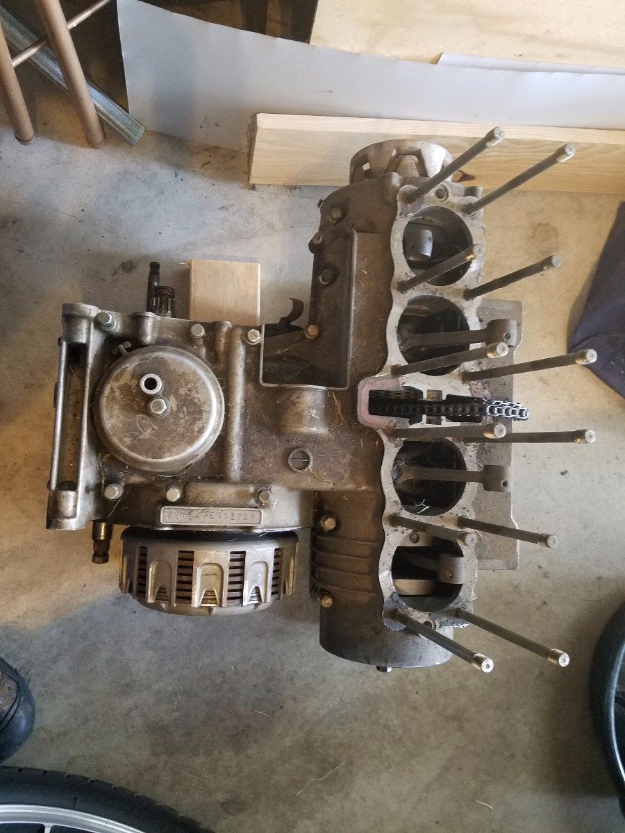

Here is the original engine. the bottom end was covered up in his garage.

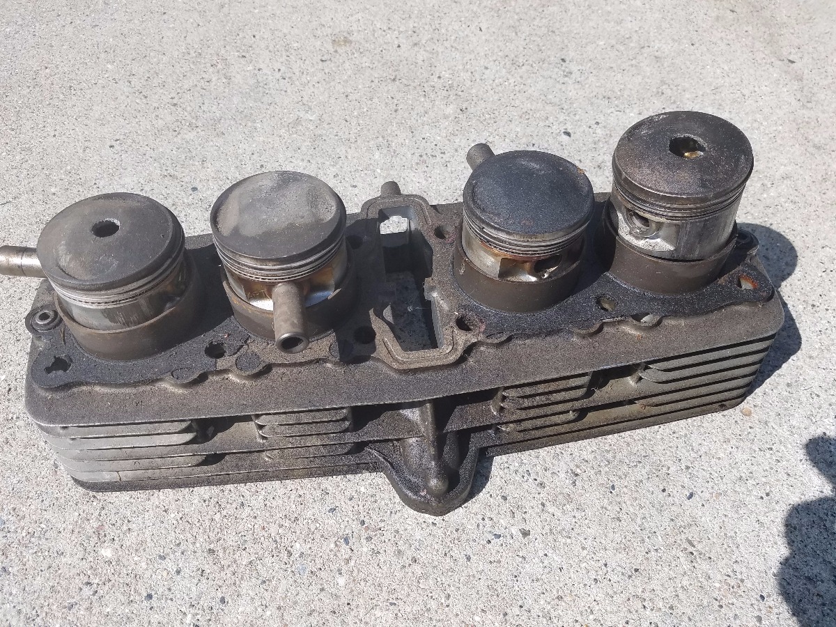

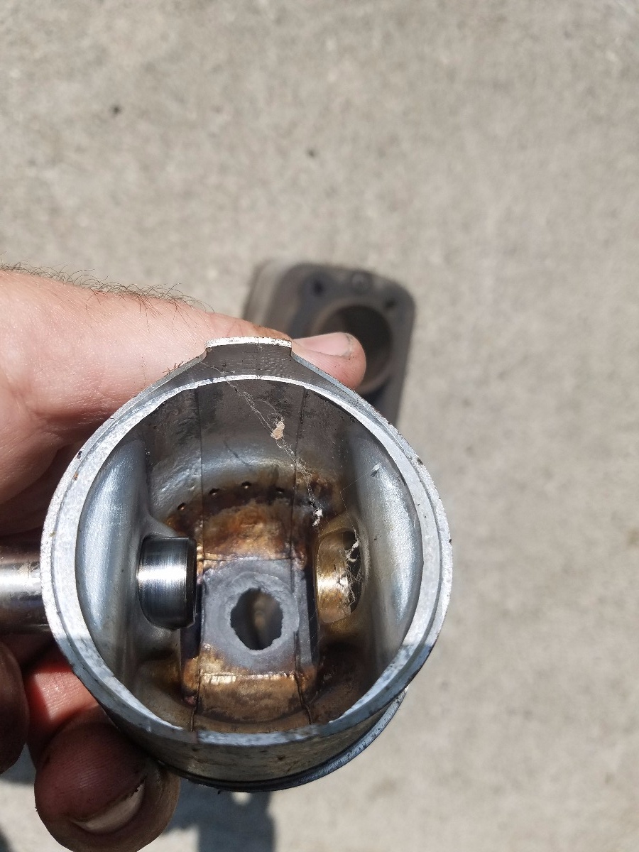

Here are the cylinders and pistons. Two pistons have holes burned in them and are scored badly. The bores are scored too, but not very bad at all. I will mic them out, but it looks like they can be cleaned up.

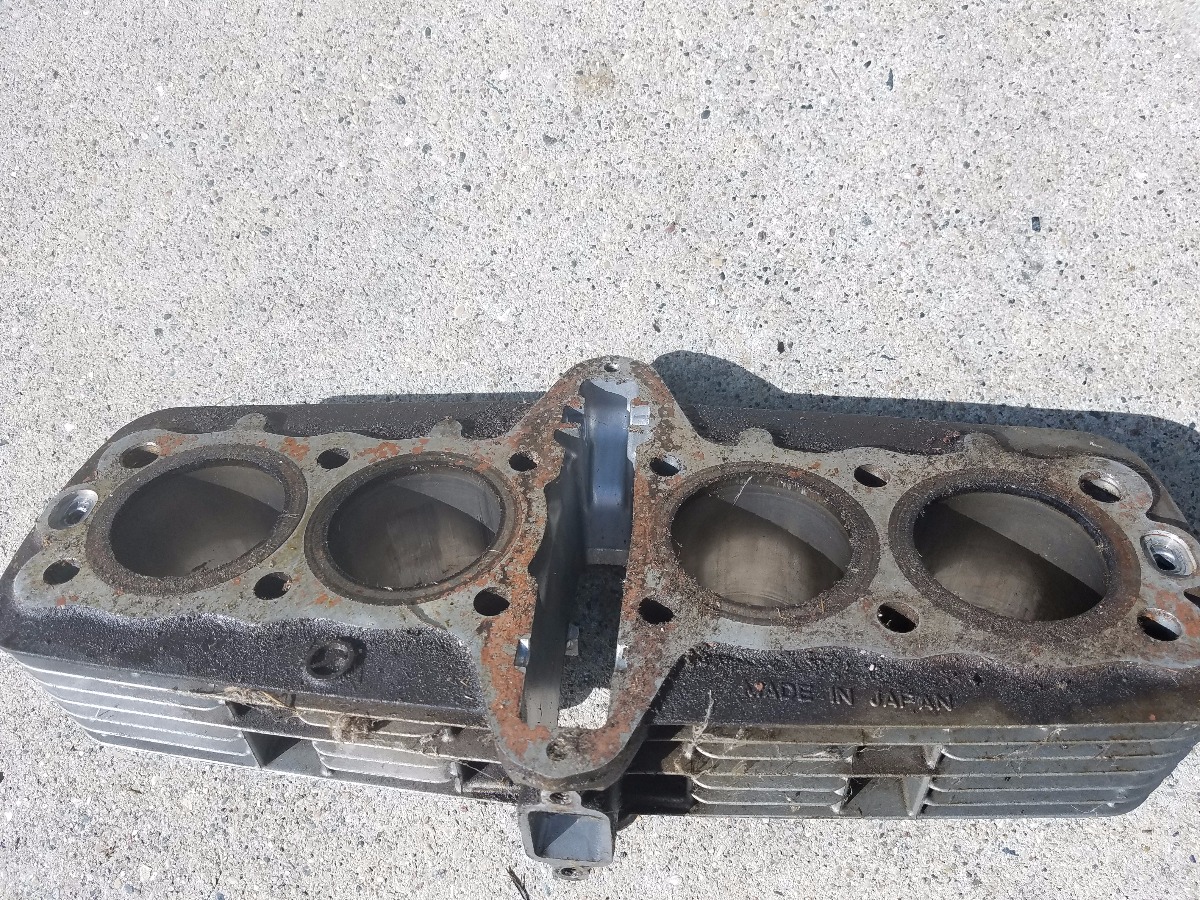

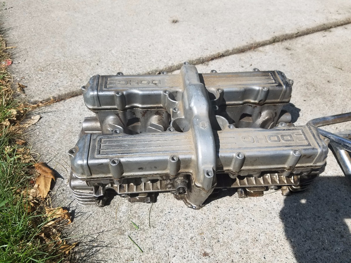

Here is the cylinder block, the head and the rest of the parts.
The engine covers are in nice shape, that's good because banged up covers take loads of work to clean up again.

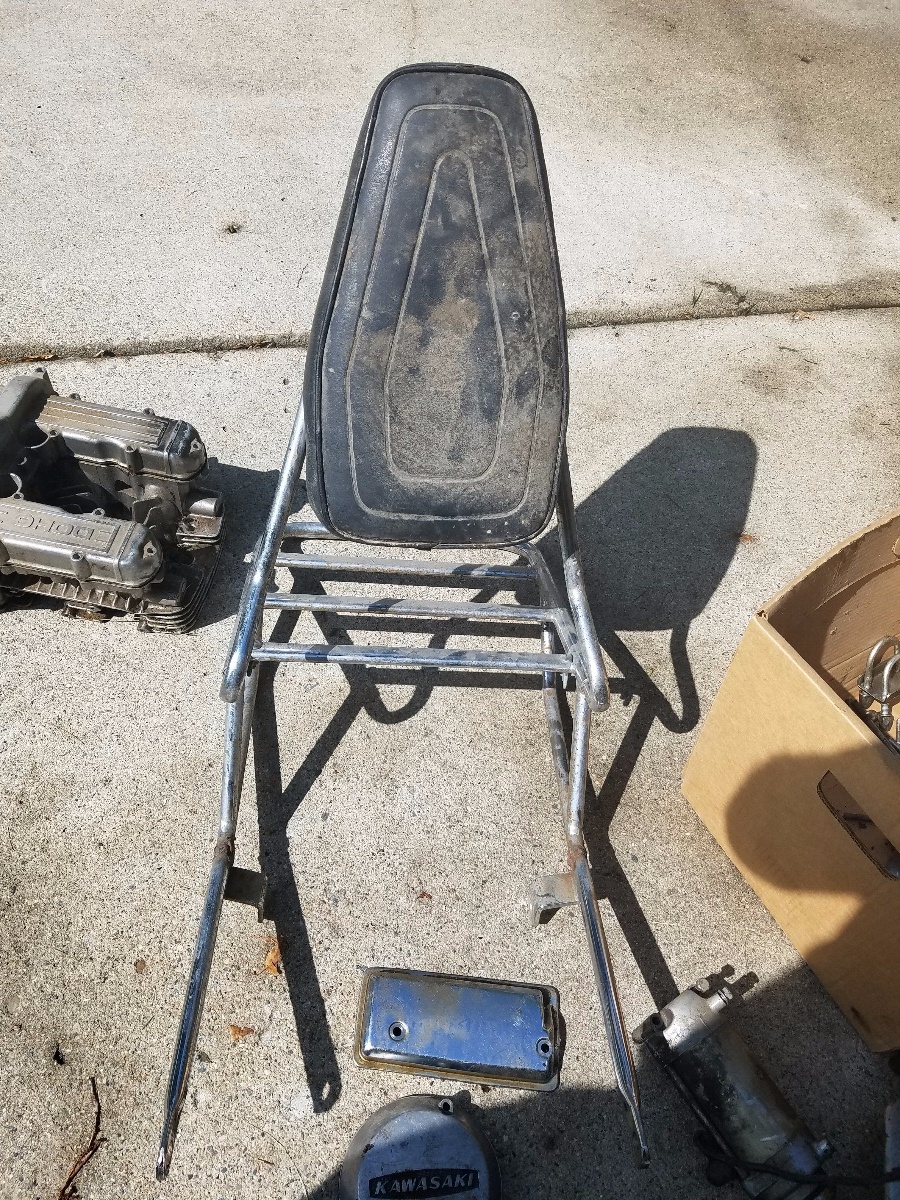

Here is a bunch of miscellaneous parts and a very stylish back rest... oh the 70's...
