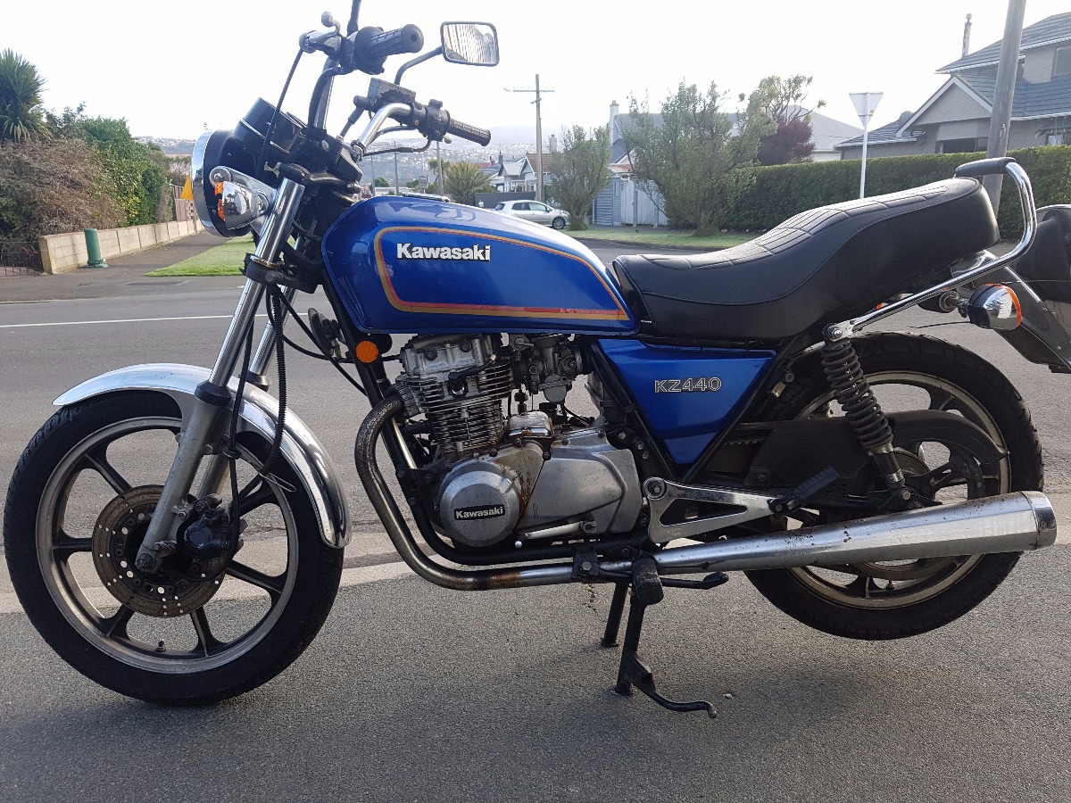

Hello again my KZ loving friends. I'm at it again. I just purchased an 82 KZ440 G1, it's another belt drive and fortunately not the Ltd model. I'll get it shipped down in the next week or so then I'll get to work on getting her back on the road. I'm thinking I'll just leave her stock at this stage. She looks pretty clean so maybe too good to chop.

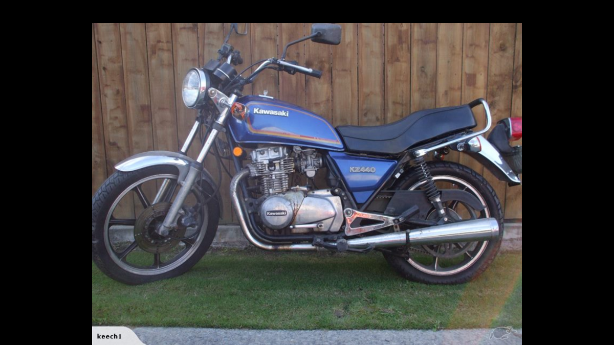

Thanks guys, that helps. I had already ordered a tin of Kroil, the Marvel's Mystery Oil is not available here in NZ but I had great success with Kroil on my last barn find. The bike was last registered in 2001 so over 15 years since she's been running. It was an old timers pride and joy. I bought it off his widow. She said he wouldn't let anyone else touch it! I think some turkey must have dropped it taking the photos for the listing. In 2 of them the front left turn signal lens is good, in the 3rd it's broken. Anyone have a spare?

It seems my 440 G1 model is quite a rare beast. I'm sure I saw a recent post in New members who had a real minter and 3 lovely photos but I can't find it today. Then I had a look through the gallery and found images of 1 bike that someone had worked on and posted back in 05. Anyone know much about the G1?

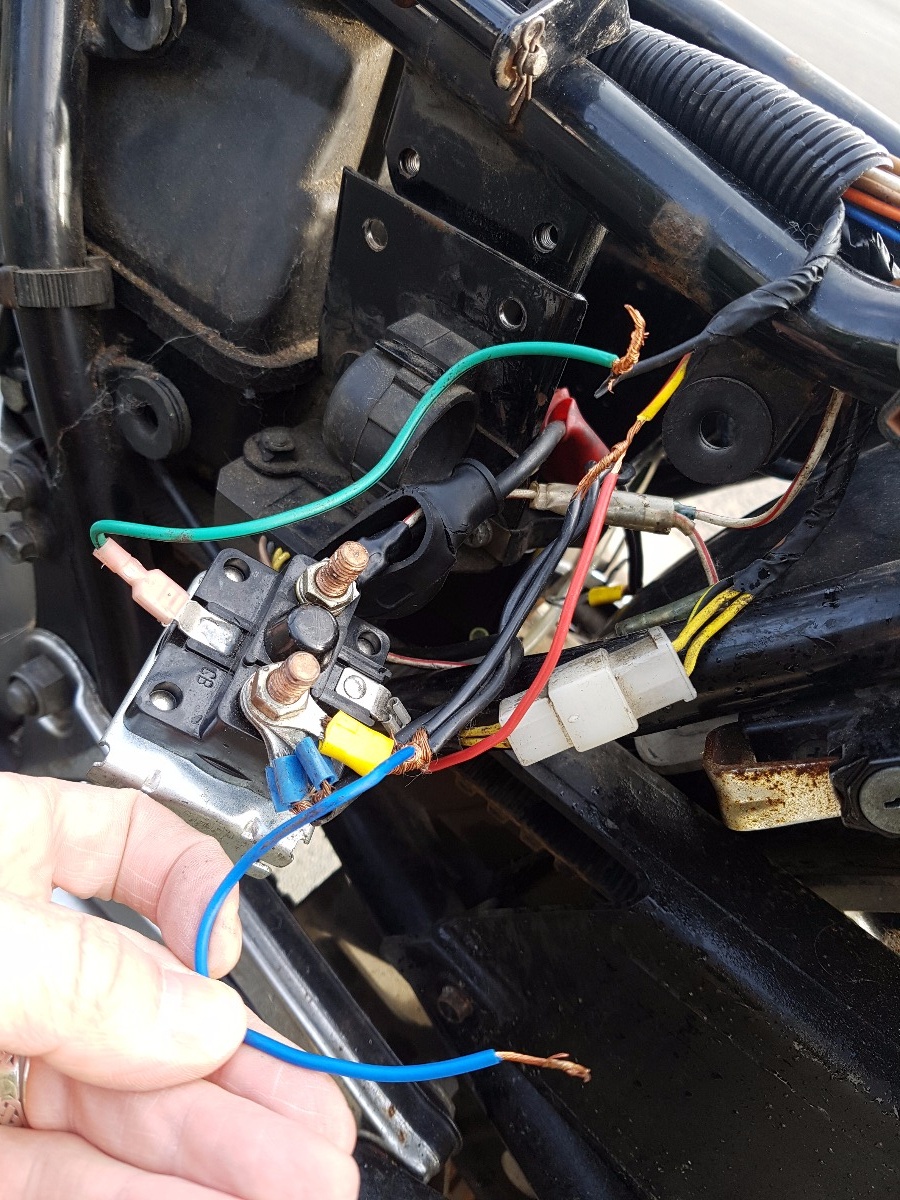

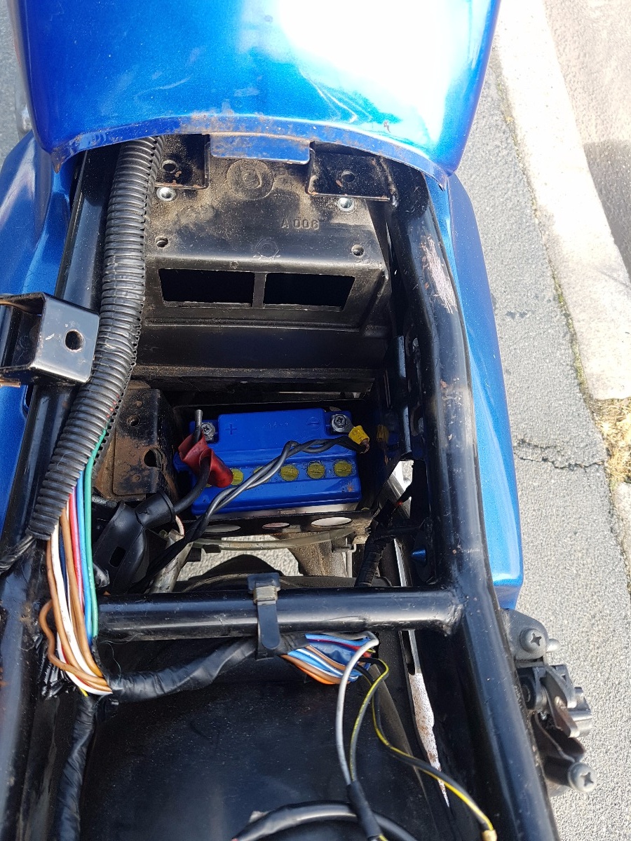

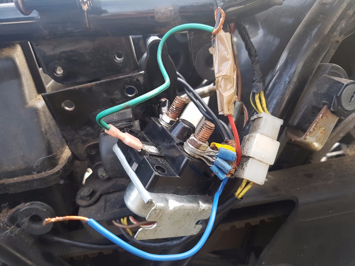

Got the bike yesterday not as clean as I'd hoped. It was reasonably clean but it's been messed with by a Muppet. The first thing I noticed was the non stock starter relay I think it's called, there was some very ugly wiring around that area, twisted wires covered with brown packaging tape - yikes.
The worst and most disappointing issue it the incomplete air filter. It has the air box but no filter or housing. And the boots from the air box to the carbs a hard as a rock so stock air box arrangement is looking less likely.
The brake fluid is all brown and disgusting with no pressure but that's to be expected.
There's a bit of spot rusting in the tank but I'll probably fill it with old bolts and some sand and give a bit of a shake. I think I have some acid too for that job.

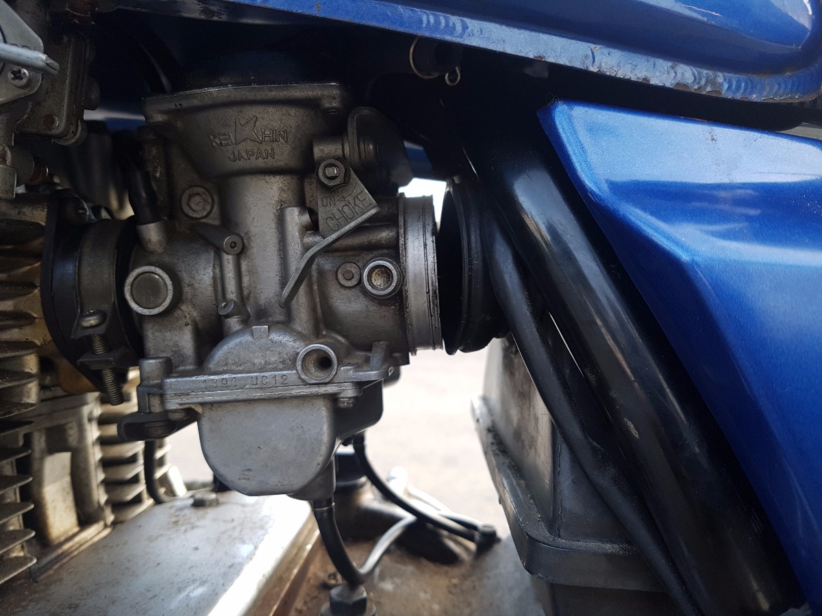

So I have the carbs off and opened up all. The fuel has done the varnish thing and the diaphragms are shot but no corrosion and tidy enough on the exterior.
Other than that everything else is pretty much unmolested. Oh there is a GS450 headlight on it with no bulb too! Some old timers pride and joy? Hmmm I doubt it. Luckily I'm a sucker for these bikes! First things on the shopping list are replacement diaphragms and carb holders. And I'll have a think about what to do with the filters. I know it's a pain in the ass but there are plenty of 440's out there running pods, so I'll just ask around probably on do the ton.
I'll add some photos soon.

Doesn't look too bad. The wiring can be fixed. Just not much fun. Look forward to watching this.

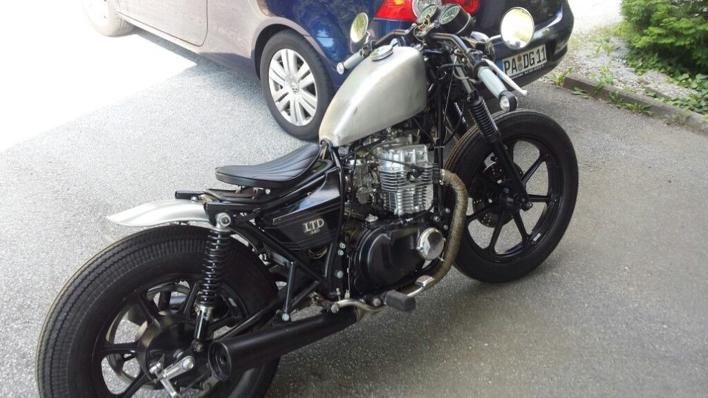

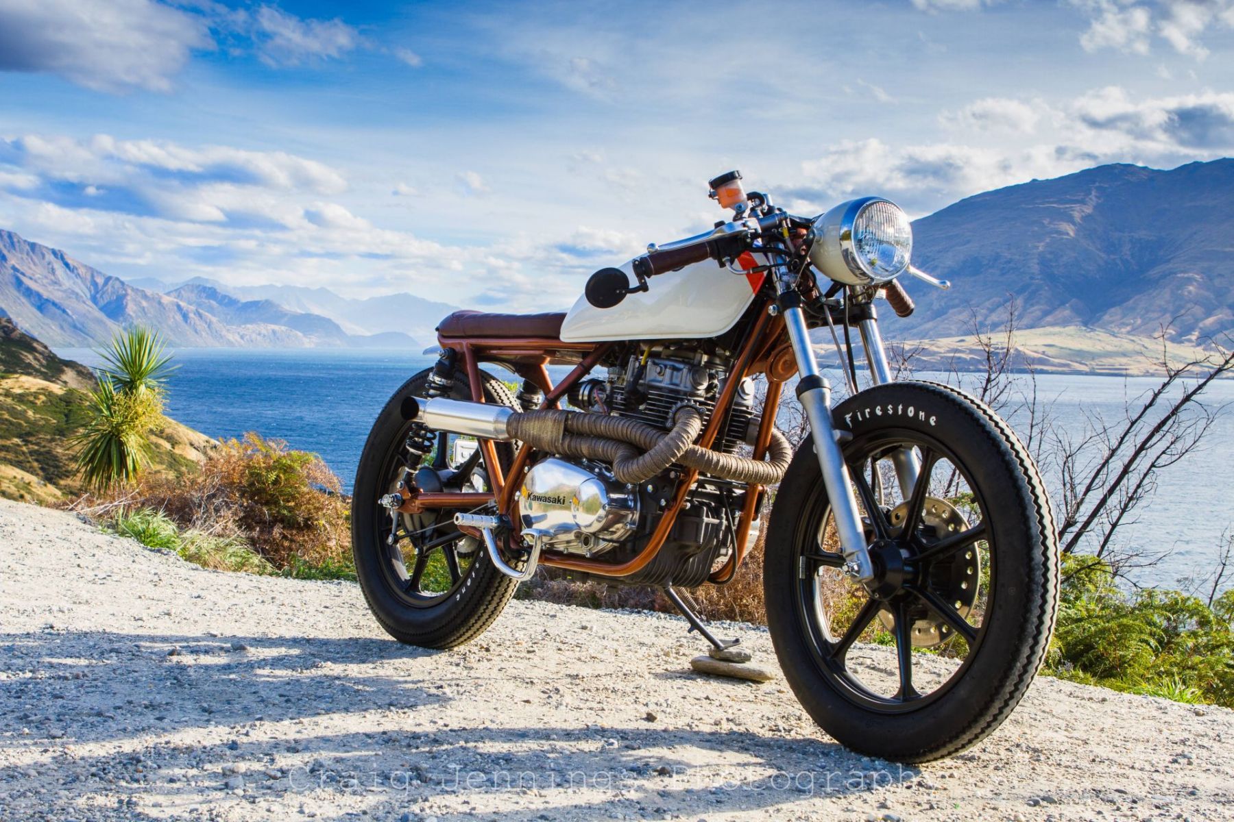

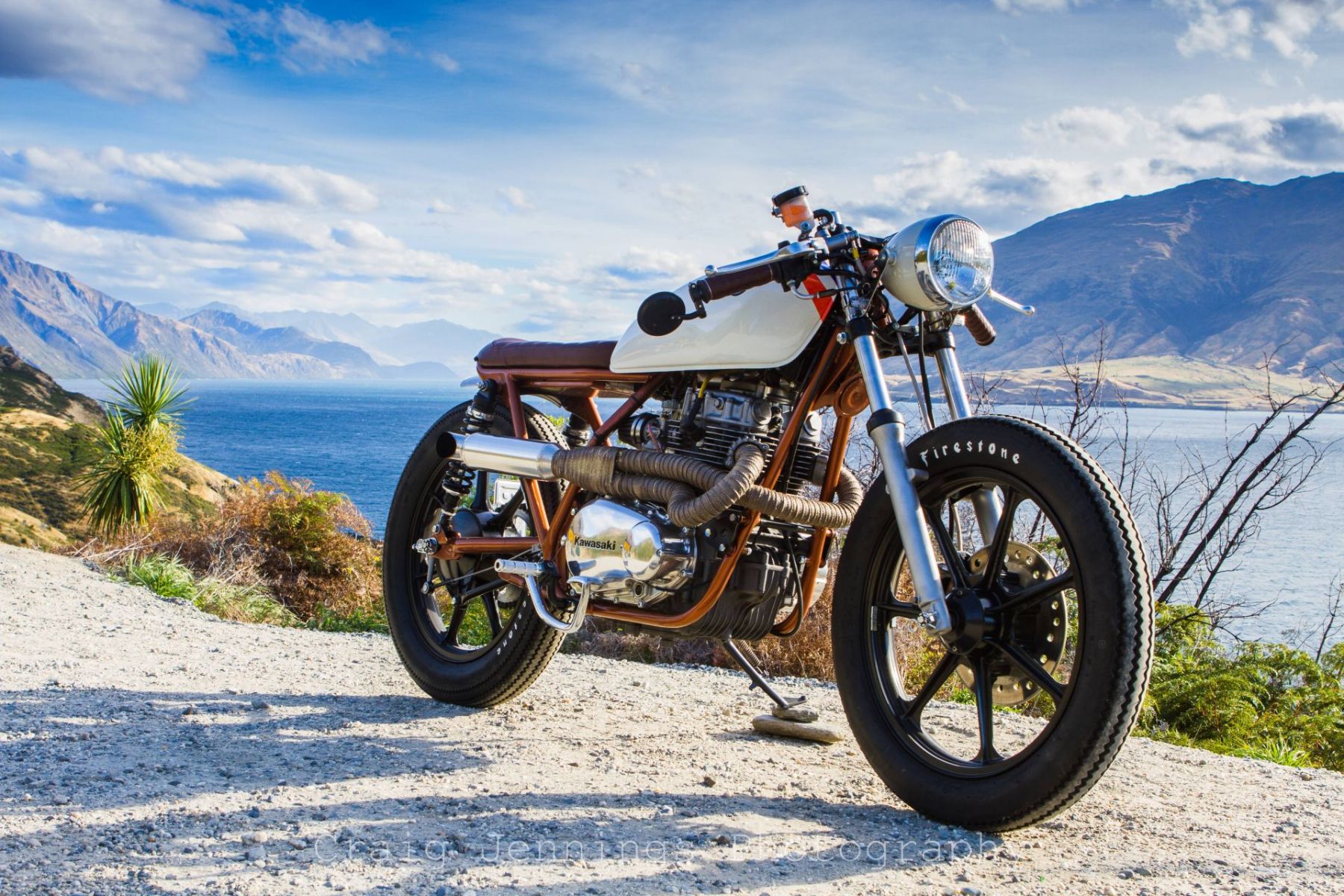

It was interesting to listen how many members here jump on the little 400/440 twins to mod them.
KZ 440 G1 from my missing or lost reply
from a member in New Zealand, and his first build!!!
Impressive performance
