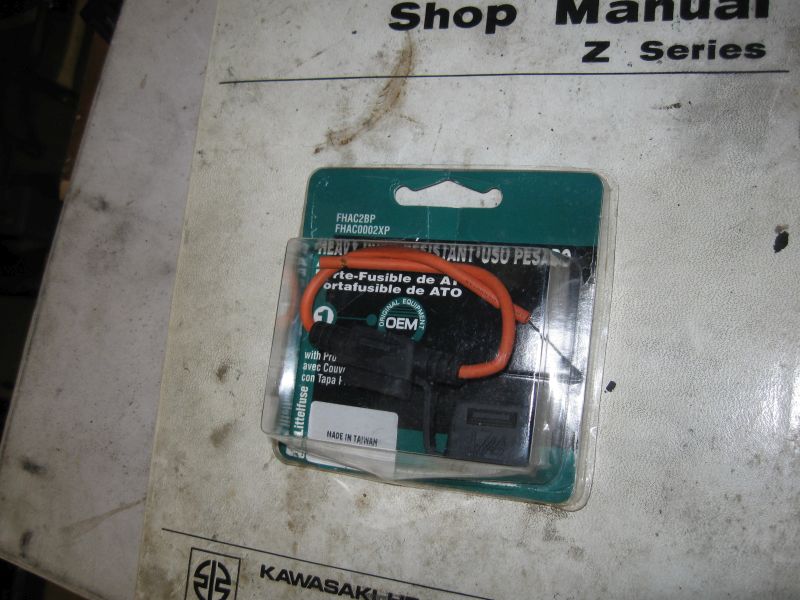

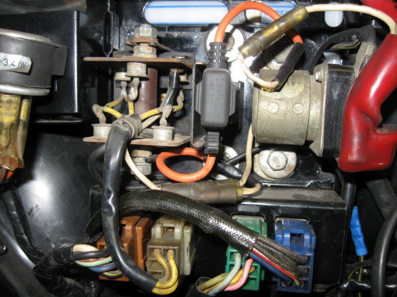

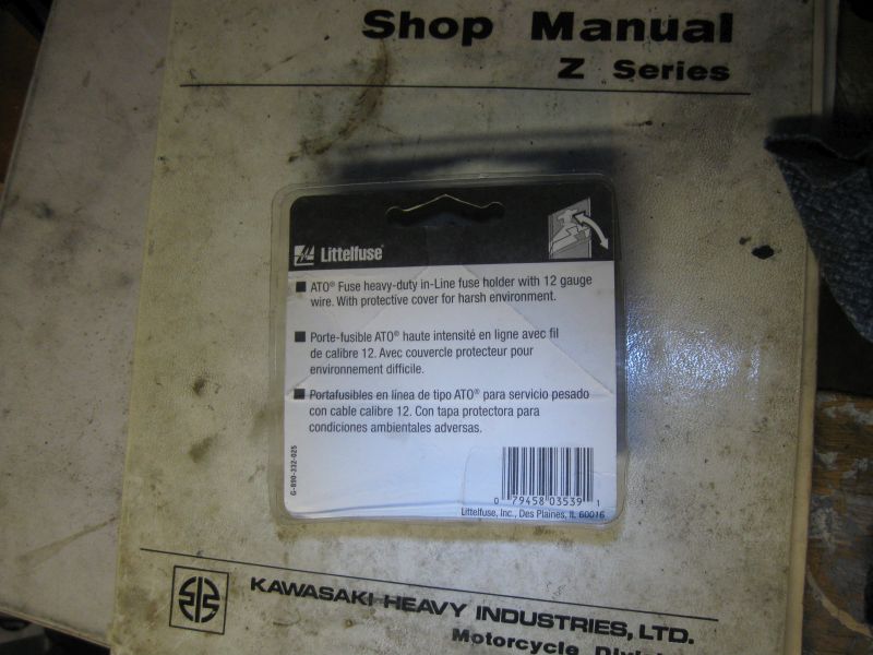

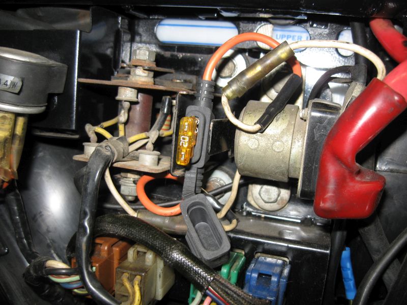

We don't have a shop, per se. We're just eat up with Z-1 fever. It's an affliction. Our (private) shop is the result of slmjim living & breathing Z-1's since he bought his first one new in 1974. Over the decades that first Z-1 has grown to a collection of six Z-1's, with the help and encouragement of The Lovely Z1BEBE. If you browse our introduction in the New Members section you'll see it and all of our other Z-1's, along with short versions of their back stories. We're not really a business, more like an enthusiast's shop/toy room/aZylum, but we will assist a fellow Z-1 enthusiast in any way we can, remotely or in person.
slmjim did work part time in a very good local bike shop for many years that specialized in Z-bikes, until they closed during the recession.
As promised, the main fuse modification. The holders were purchased at PepBoys. We spliced two OEM bullet connectors w/wires onto the pigtails, so they could be plugged into the original connectors for the OEM fuse holder. The blade fuse holder fits the space occupied by the OEM holder perfectly.
