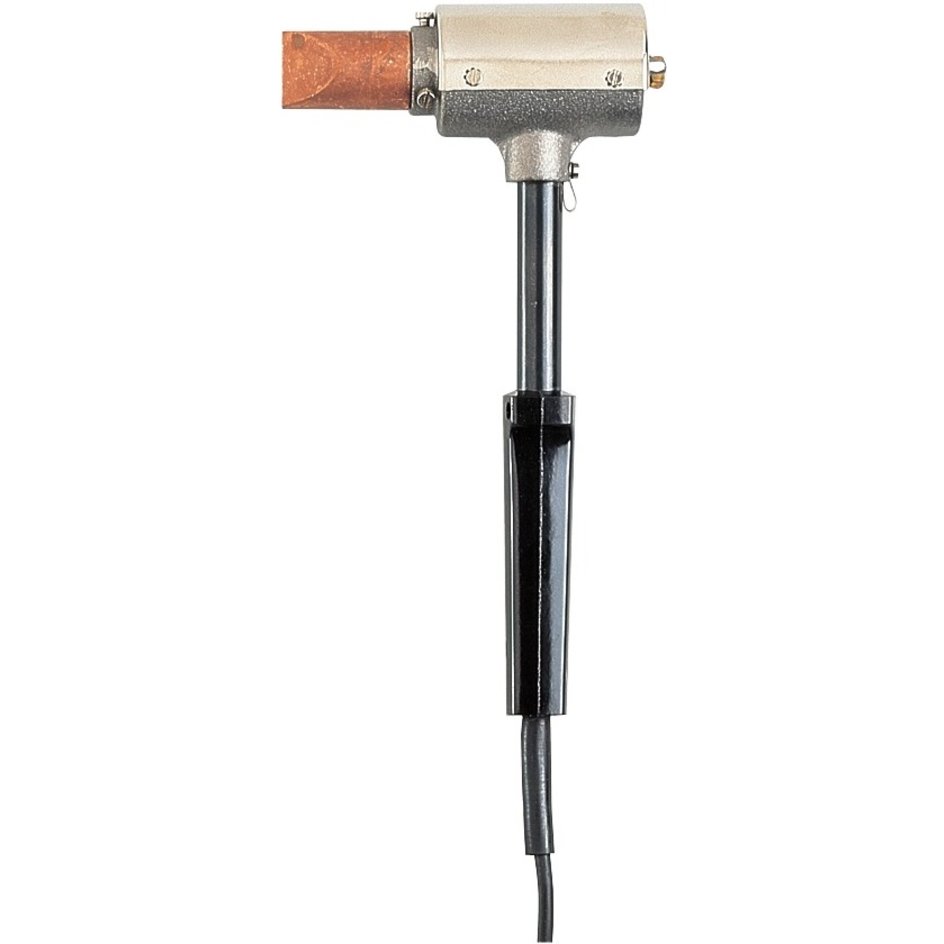

Got the tanks soldered up. Was able to do it myself. Wen 450 watt iron, silver solder and some flux.

Good job getting the holes plugged up. Are you sure that is silver solder? I don't think a 450w iron can generate the 1,100 - 1,400 degrees needed to melt it.

I should say, silver bearing solder. 430F melting temp. We'll see how well it works. The iron does get really hot. Wouldn't be surprised if it wasn't around 550-600F. But definitely not enough for pure silver solder.

I suspected as much. I wonder if a 50/50 lead - tin mix would have been easier since it has a pretty wide plastic state......

I have tin plated my complete fuel tank from the out side surface, plus fill the emblem depressions
with tin (after removing the emblem holders) and some very little dents before i sealed the inner tank surface with POR15.
I have used a little bigger (550 Watts) soldering iron.
