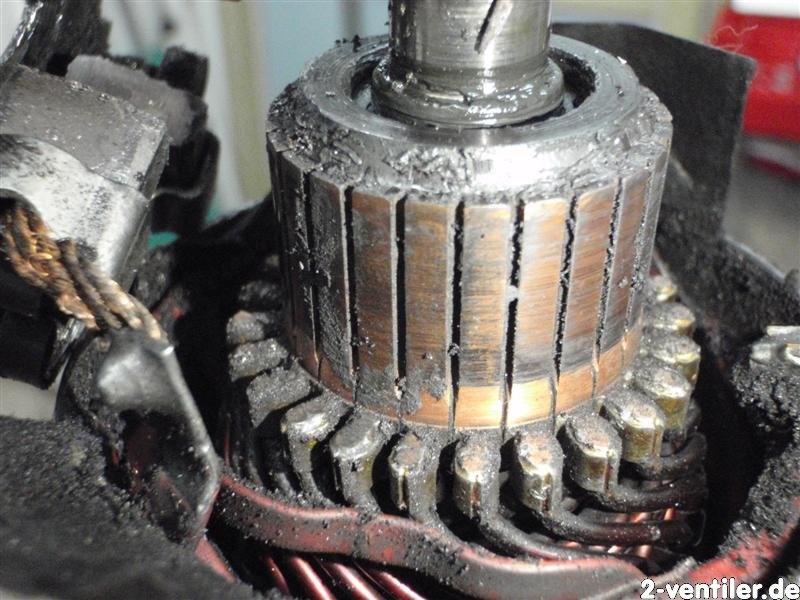

Re: 1980 KZ440 project build...err... rebuild...
06 Mar 2017 18:42
Hello CPLSeraphim
It looks like your starter motor was blocked.
Can you turn the starter motor by hand (if removed from the engine)
If the starter motor does not turn the commutator will short cut.
This will cause your voltage drop. This will end up in a burned up stator winding.
Have you cleaned the commutator with a fine sandpaper or file? the gap between can be short cut!!!
Are the brushes in good shape?
Michael
Michael

Nebr-Rex: I have been keeping the battery charged with a trickle charger. reading a good 12.6 ish before trying to start.
Scirocco: I could not move the starter the last time until after I rebuilt it. When I rebuilt it, it spun nice, and would turn the bike over. It was cleaned, but I did not sand it. there were no gaps being shorted at that point. I will be removing the starter tomorrow, and will take a look, and try to post pictures then, at least of the starter.
It was a lot cleaner then the one in your pictures, just had a lot of black dust on there. I am worried that the magnet came loose again, and might be stuck to the commutator. That would make sense, I suppose, on why it isn't turning, and a big magnet stuck on would surely short it out.
If that is the case, what can I use to glue the magnet down that will secure it?

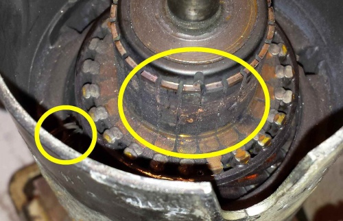

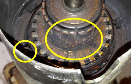

Will update during teardown of starter:
I pulled it, and it does not turn by hand, and when power is applied, it does not start.
and I found the problem....
The magnet that wasn't secure shattered inside the starter... looks like I'll be buying a new starter.
