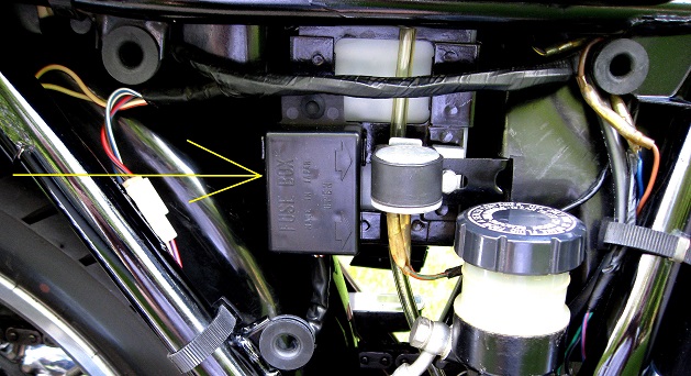

Real quick question, are these bikes supposed to have a fuse box? I ask because everything is hardwired, and I don't remember from my older KZ's. its been too many years.

There should be a small fuse box probably with 3 fuses much like that on the KZ650. On my KZ650-C1 it is under the right side cover. Here's a pic of it. Ed

10-4... that is all and good then. BTW, found that fuse box... she be little. 3 fuses, main, front and tail. easy enough.
