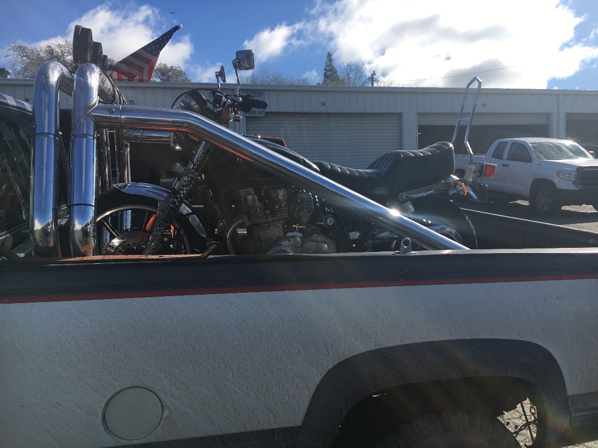

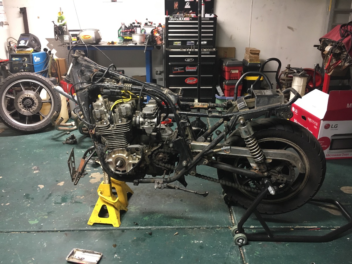

I found the bike Friday morning and was on the road that night, I drove for 20 hours straight from Las Vegas to Sacramento picked the bike up and drove back. stopped by Reno on the way
Once I got the bike home first order of business was to safety check the bike then take it for a spin

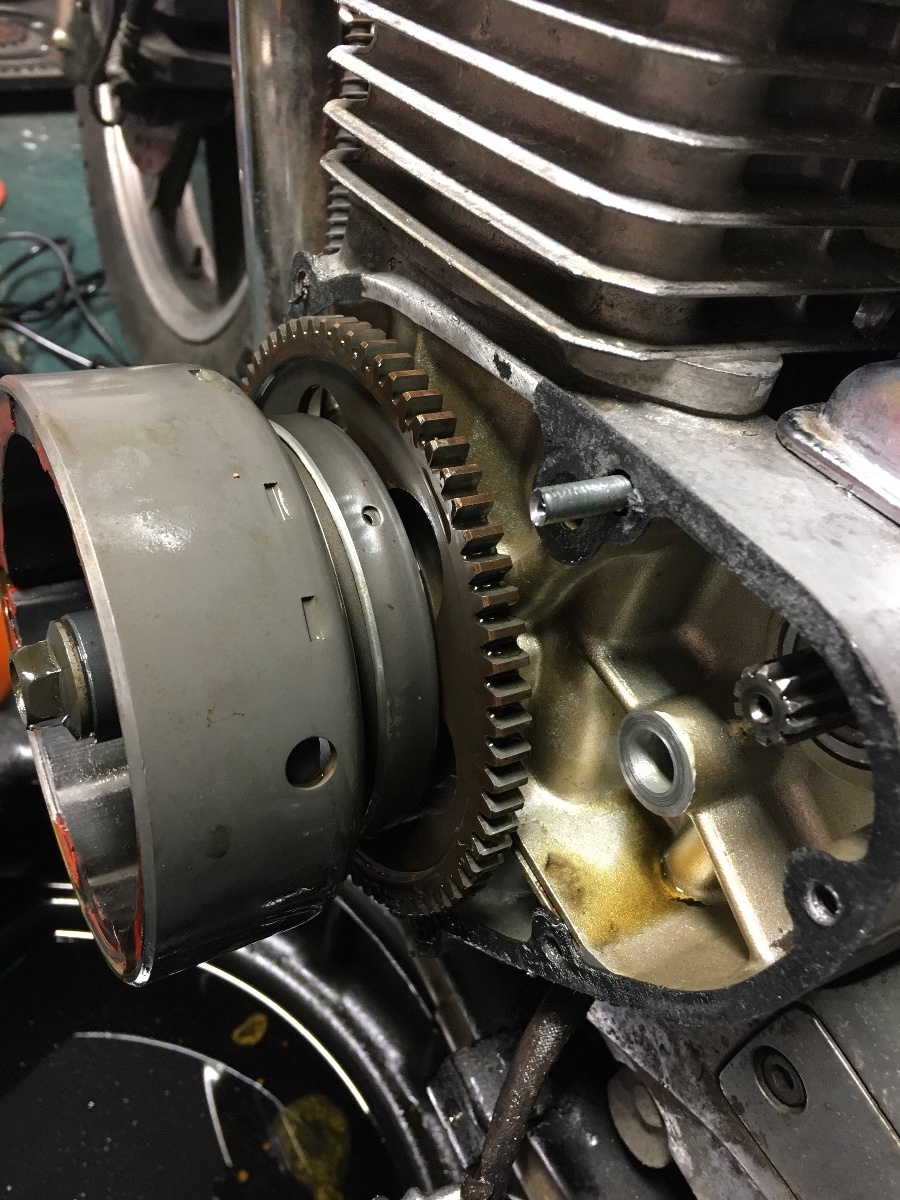

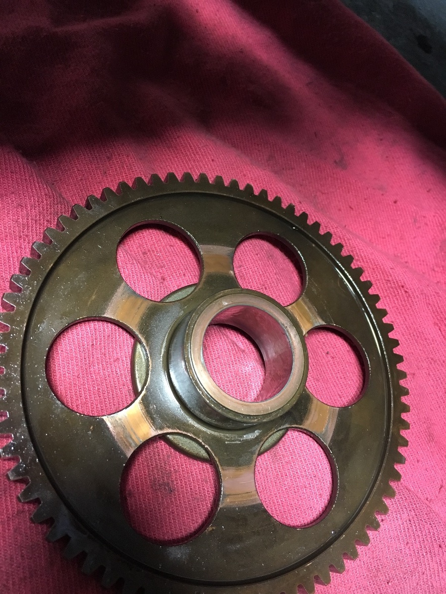

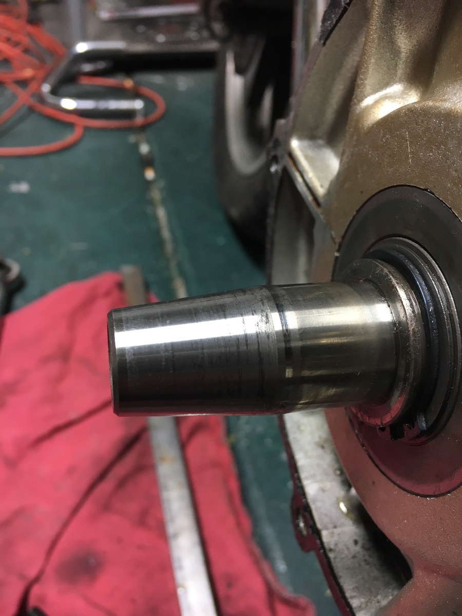

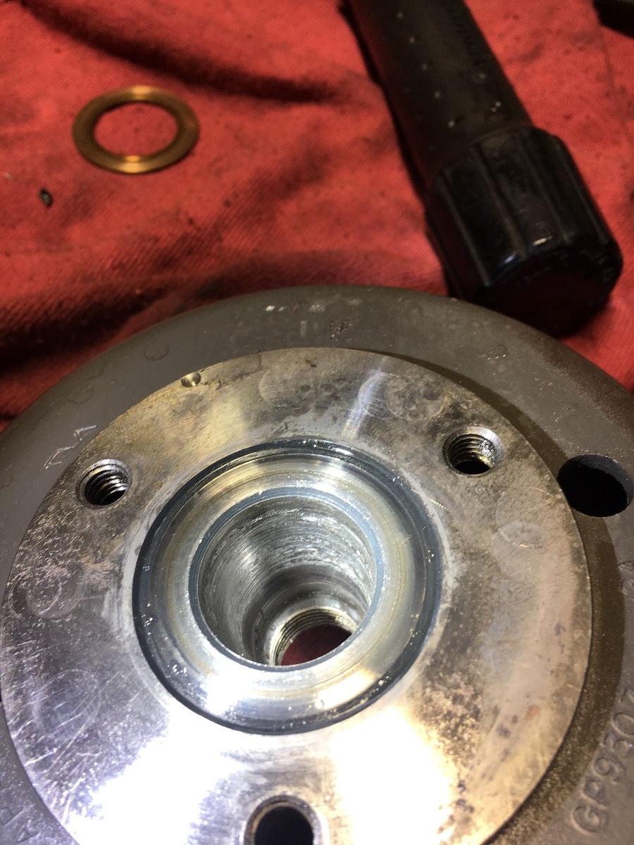

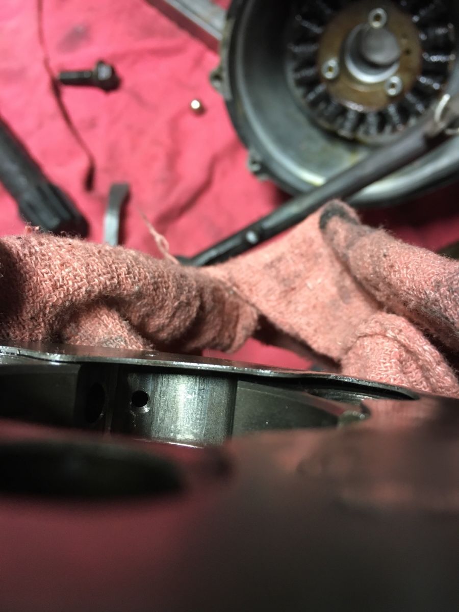

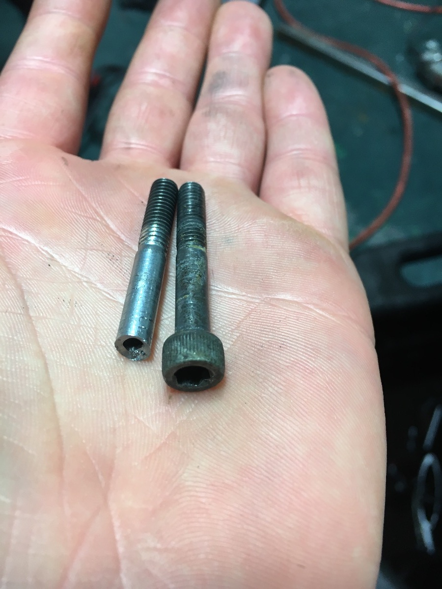

When I got the bike the seller told me it needed a starter clutch and some intake gaskets, what I didn't realize was how bad the starter actually was, it would just spin and fail to engage the starter at all, once I got it started I rode it to my job and was honestly impressed with how fast this bike is, unfortunately when I was trying to ride home the starter would not engage at all and was just spinning, long story short I got the bike home and pulled the side cover I wish I would've got a picture of this bolt that had a screw driver tip broken off vertically through the head of it. 15 minutes of drilling later he bolt was out and the cover off.
Once I got everything apart I found a police version of the generator and clutch hub and flywheel, it would appear as though the starter clutch had been replaced but the bearing that goes on the crankshaft had been left out/forgotten my original plan was to ride this bike for a week and feel out all the things that need attention but I guess I'll just start the tear down now.

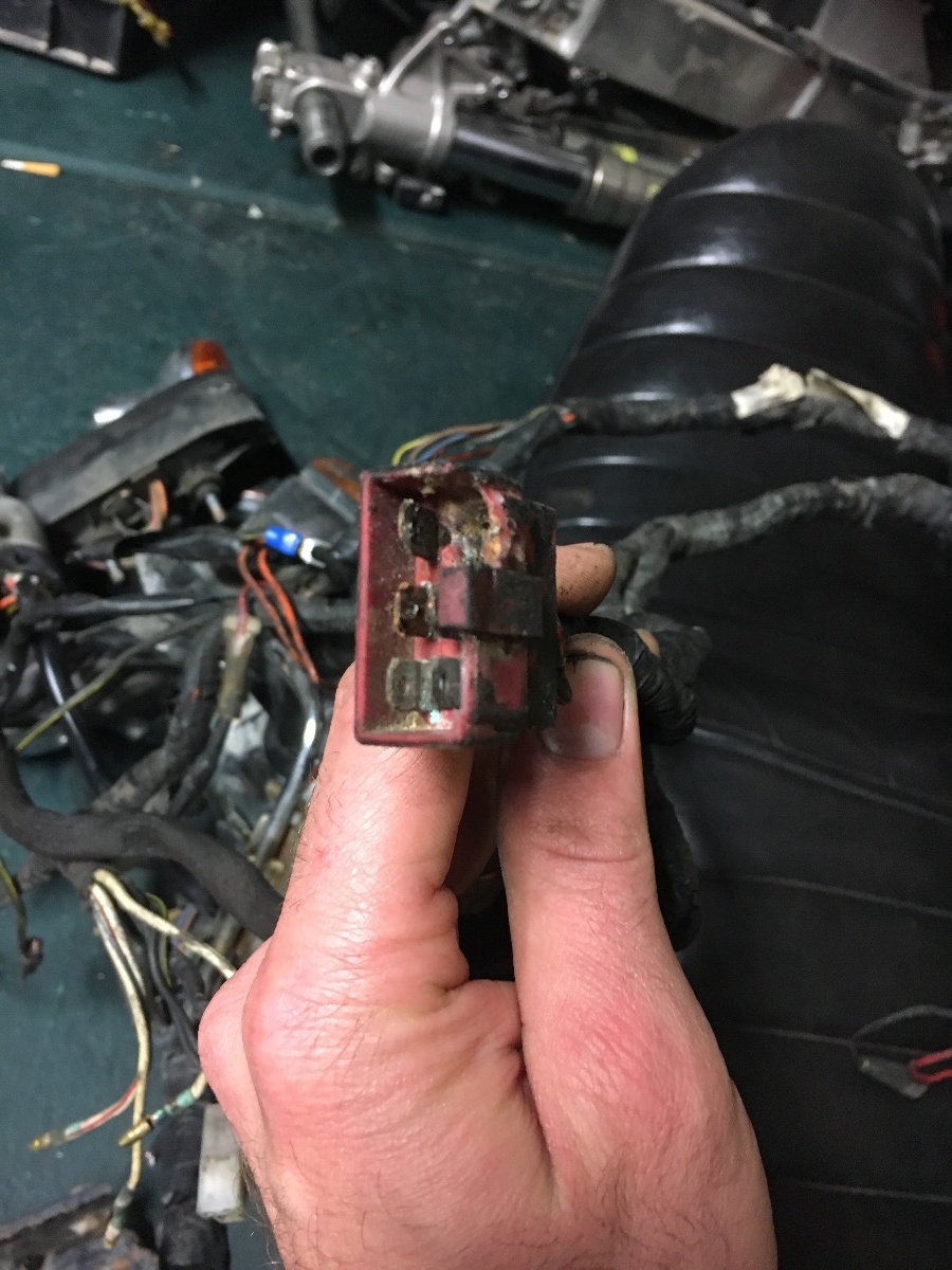

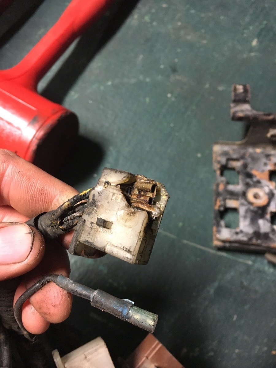

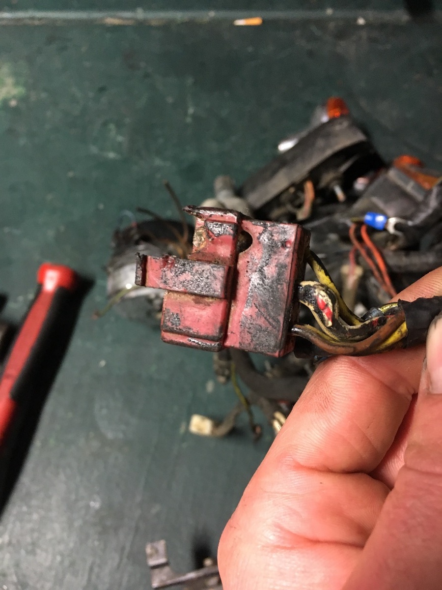

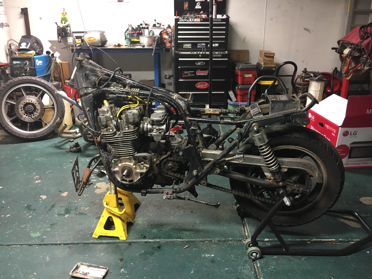

Small update, got the nightmare of a wiring harness out
during removal I found this connector to have had a "thermal incident" that unfortunately damaged surrounding wires as well
at this point looking over the factory wiring diagram and finding all the attempted repairs and damaged wires I'm just going to be making my own wiring harness now.

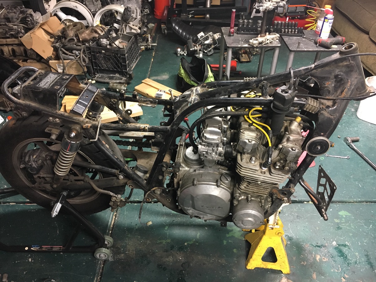

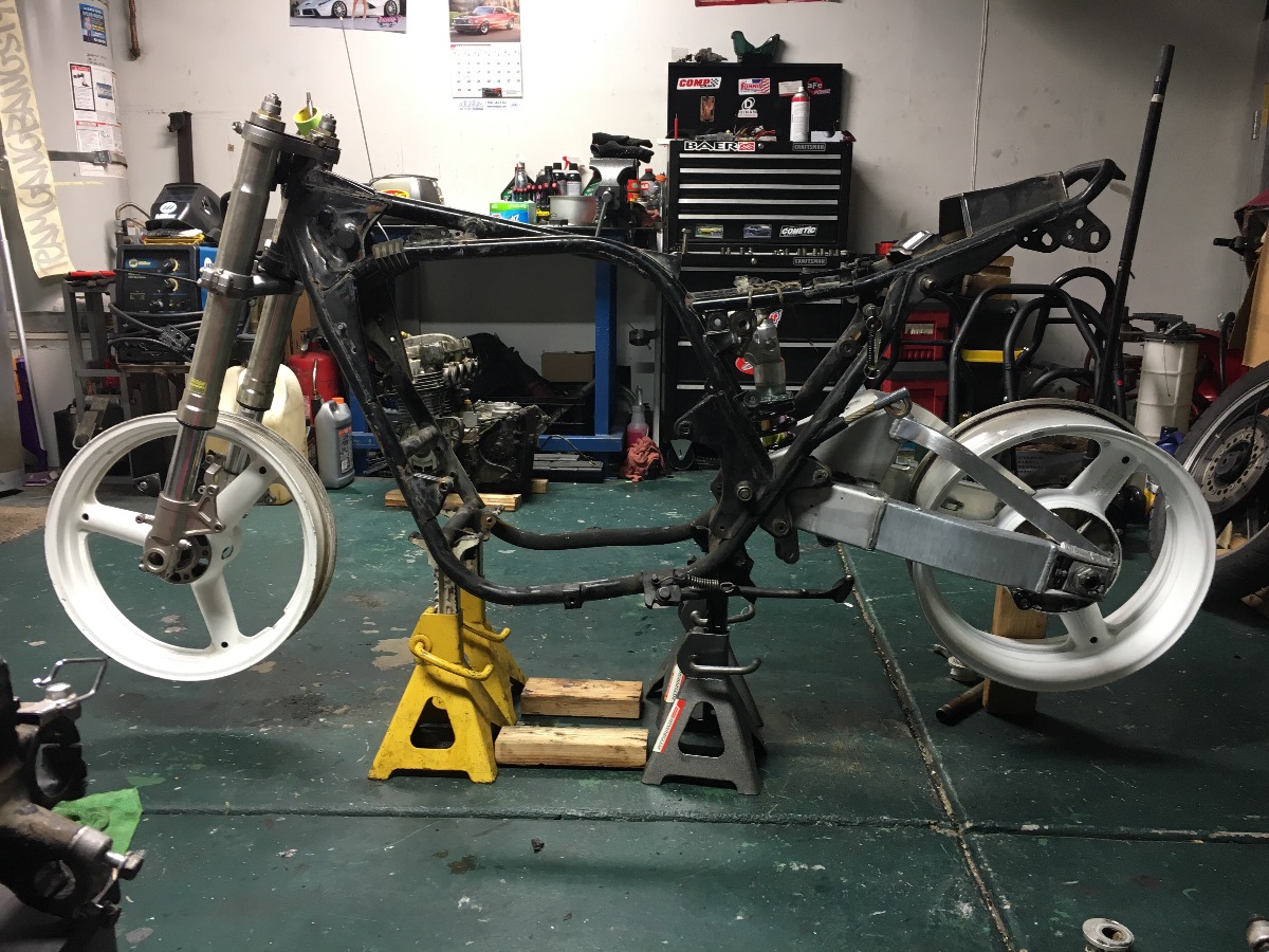

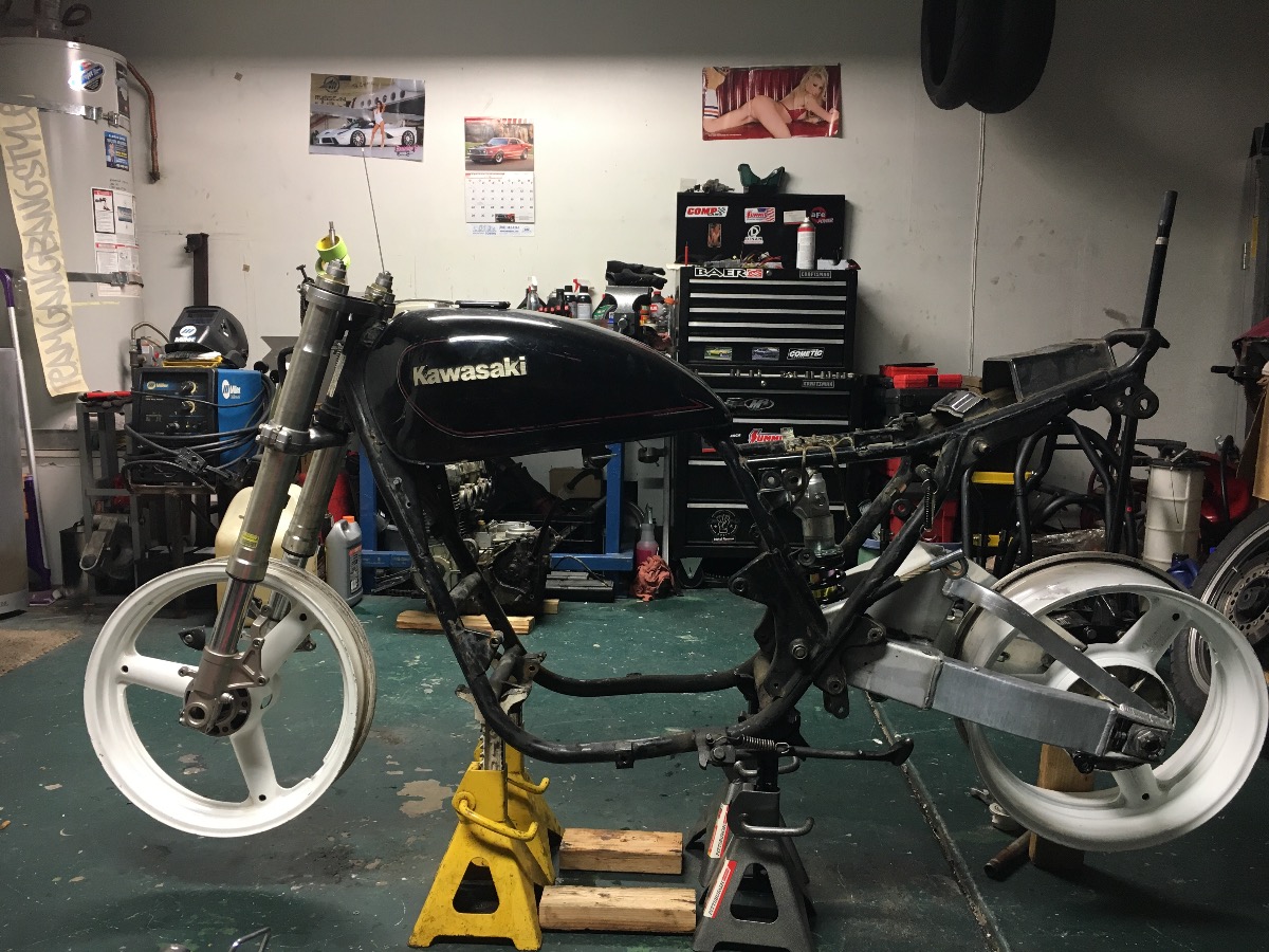

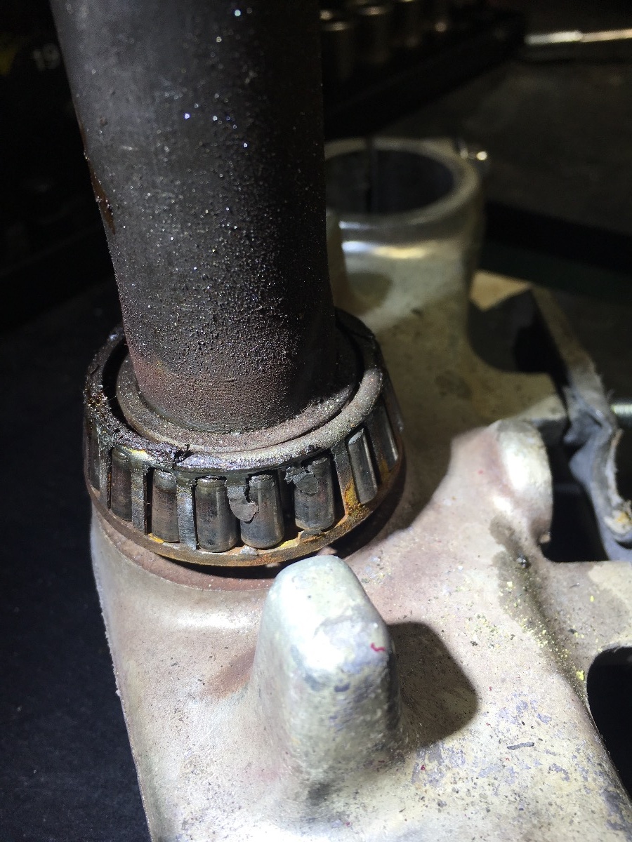

Small update cont. Removed all the body panels and fenders along with the front suspension.
During my two day ride I couldn't help but feel how stiff the steering was when turning and how loose it was in a straight line. Now I know why!

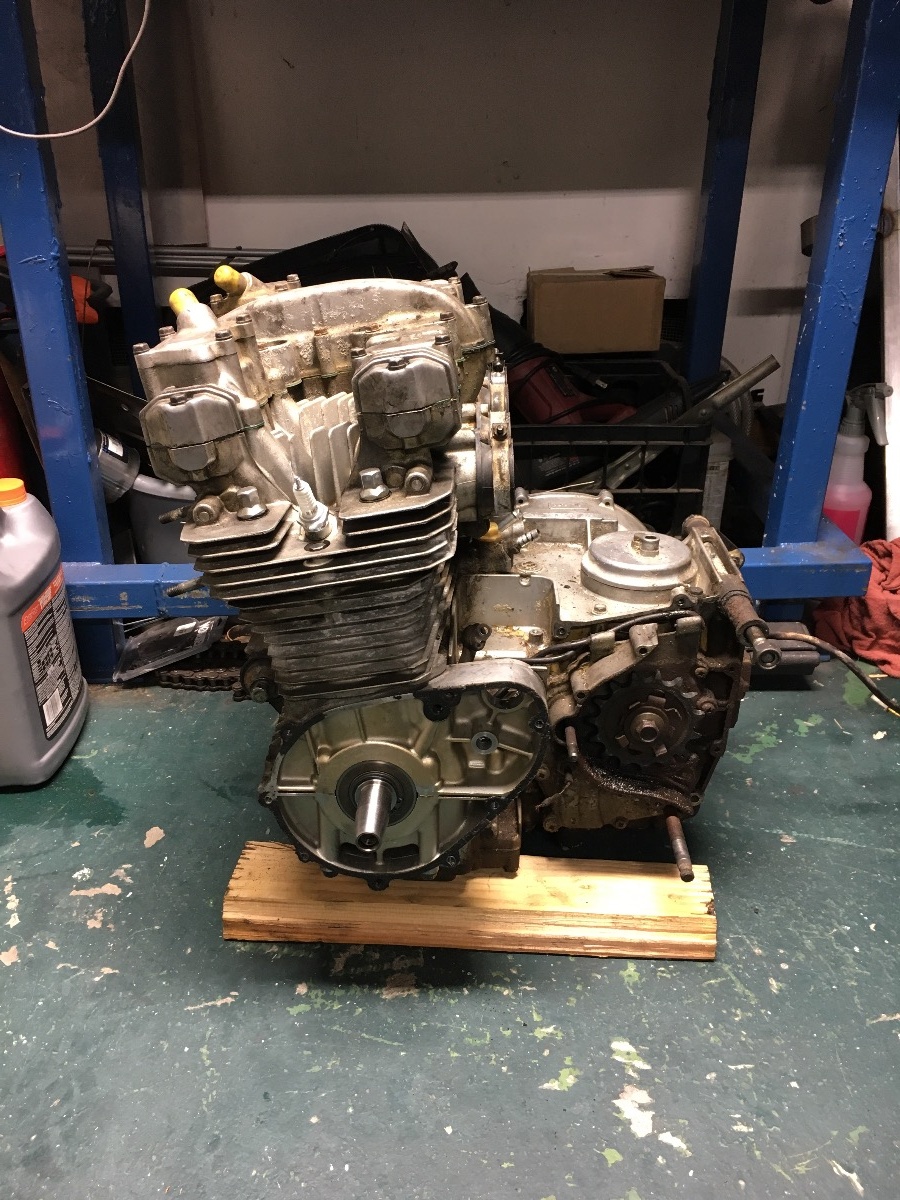

Finally got the engine removed!
This little guy is gonna be on hold while I get the rest of the bike sorted.

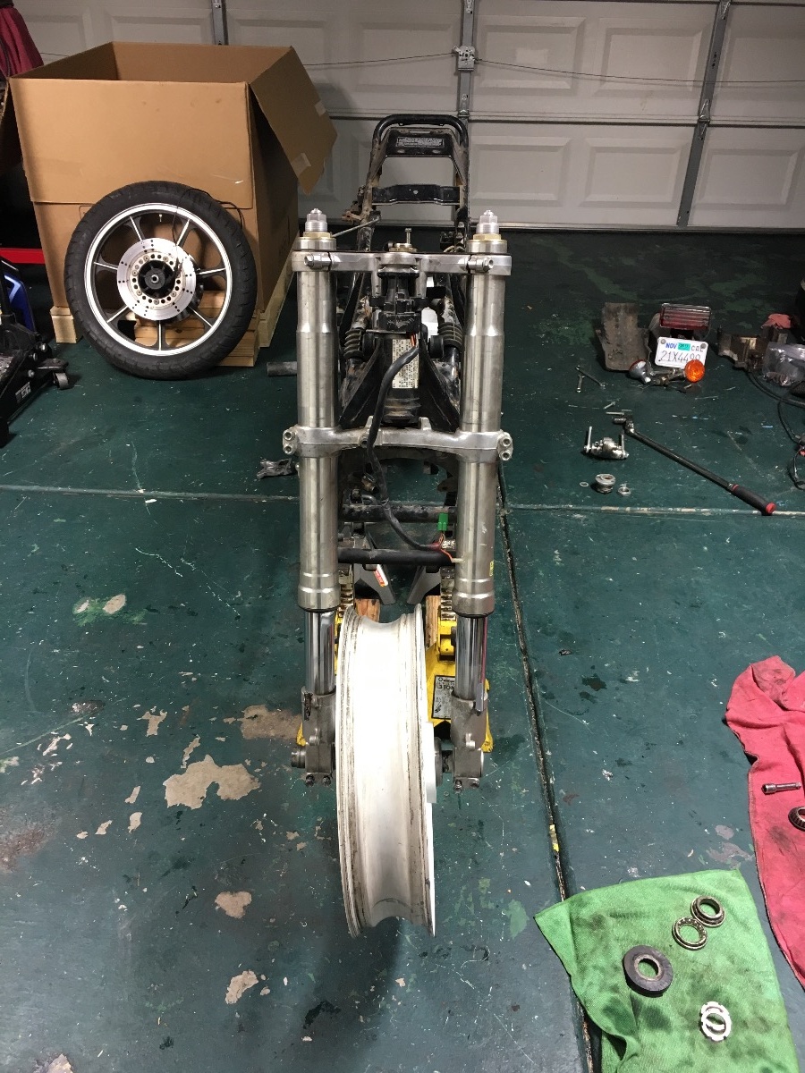

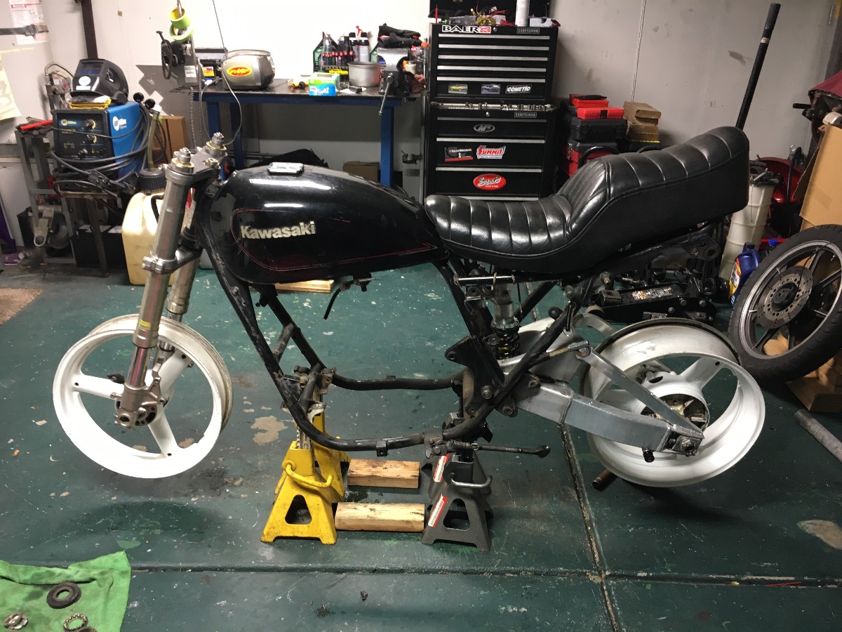

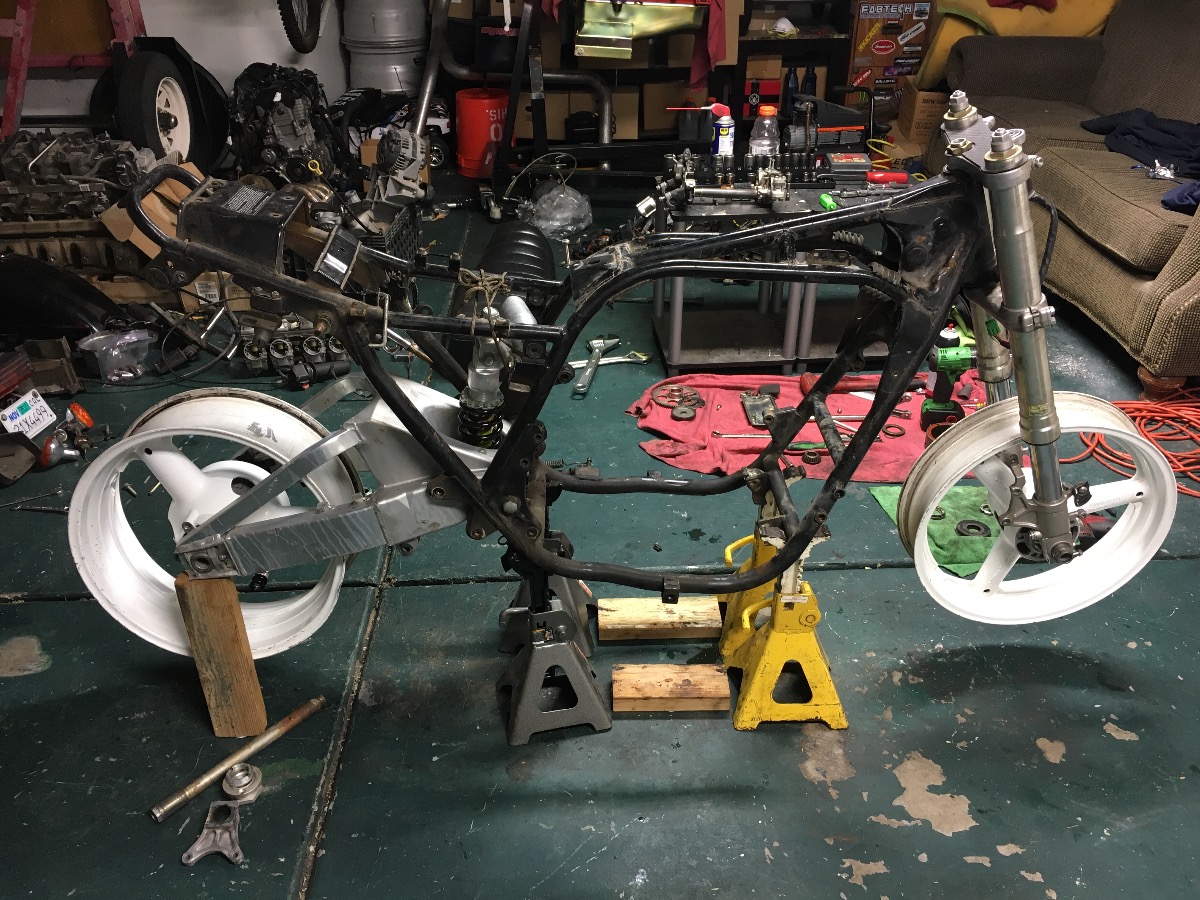

I decided to mock up the suspension to get an idea of where all the issues are going to be.
does anyone else hate this twin size mattress of a seat as much as me haha!
I figured the front would be pretty simple, I'm going to press the KZ stem into the GSXR tripe clamps using a bushing/collar, most likely I'll bore out the GSXR stem ID to the same size as the KZ stem OD then cut the GSXR stem the same height as the triple clamp. Drill a set of handle bar mounts in the upper clamp to keep the original bar style and control mounting locations (start button, lights, turn signals, etc) instead of clip ons that won't look right or fit right without hitting the tank for that matter. Weld on new steering stops
And finally make a bracket for the head light and gauge cluster. Unfortunately I can't figure out a way to retain a steering lock? But that's not a big issue to me.

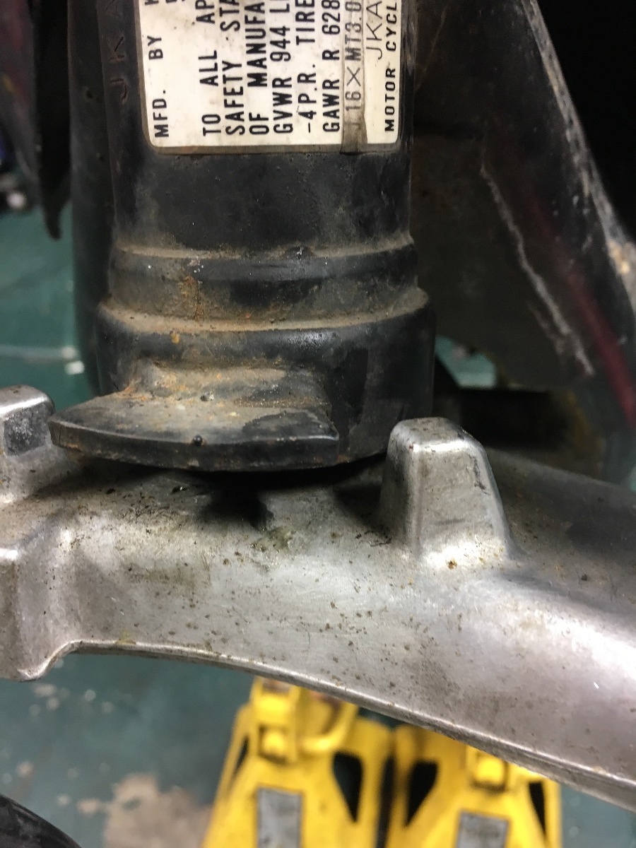

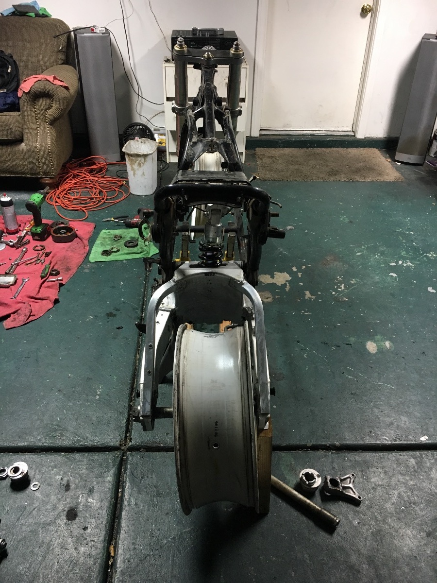

The rear suspension on the other hand is going to be a completely different story... the swing arm is hitting the foot peg mounts
So I'll have to cut the mounts off and smooth the frame out and see where it's at after that.
The next issue is the Grand Canyon size gap between the inner frame and the outer of the swing arm pivot.
this is not a huge issue seeing as the GSXR pivot bolt sits slightly recessed into the swing arm so the gap is easily corrected by machining a metal washer/bushing to the correct dimensions to get everything squared up and make it a snug fit.
The next issue is the GSXR pivot bolt is twice the size of the KZ, so much so they fit inside each other with room to spare :laugh:
I can bore the swing arm pivot hole to the same size as the GSXR bolt no problem, my only concern is that the GSXR bolt is almost the same size as the welded in bushing,
My last issue is, even though I thought my string was pretty funny!
I have some doubts about it holding up under serious riding conditions :laugh: I'll be putting a mounting bar across the frame almost directly above the swing arm pivot with a mounting tab, add a similar mounting tab to the lower bar where the center stand was while attempting to keep as close to correct geometry as possible. Finally I'll have to figure out where to stuff the battery seeing as there will be a shock where the battery box used to be?
