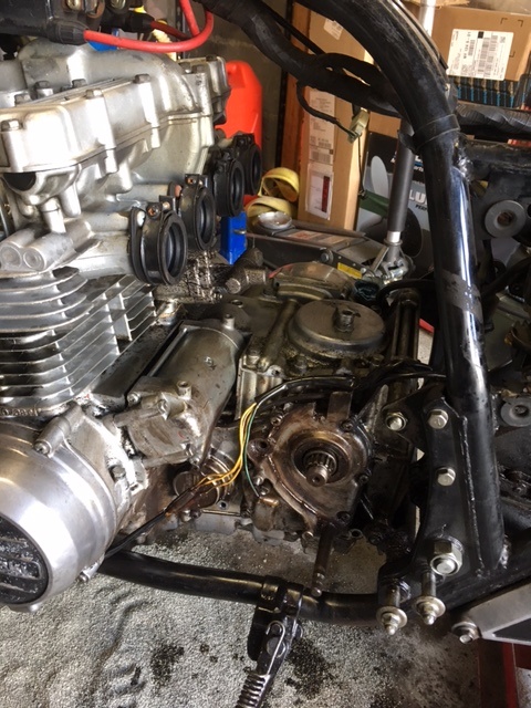

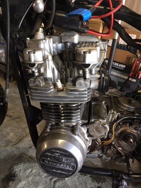

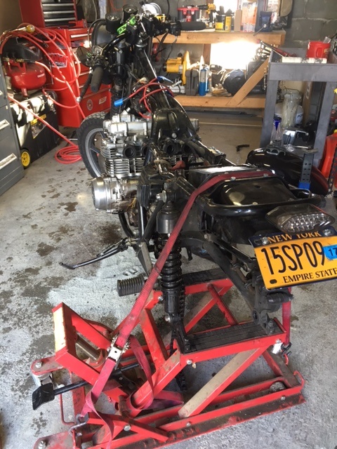

So I finally got some semi-decent weather up here in NY and spent the afternoon out in the garage working. Slow going as this is my first bike, my first tear down.
I got the carb bank off, the side cover, the chain and sprockets as well as the back wheel and tire out of the way. Needed to come off anyways because I'll be changing out the chain and sprockets when I put her back together.
My next thought would be to pull off the cylinder head (Need to replace the gasket anyways) and take the motor out in two pieces. Is it possible to leave the valve covers in place and remove the whole top half as one unit while it's still on the bike? The valve covers don't appear to be leaking anywhere.
Or maybe I'm going at it totally wrong and should I just pull the whole motor out and then separate on the bench? Any tips and tricks would be greatly appreciated! Thanks in advance.

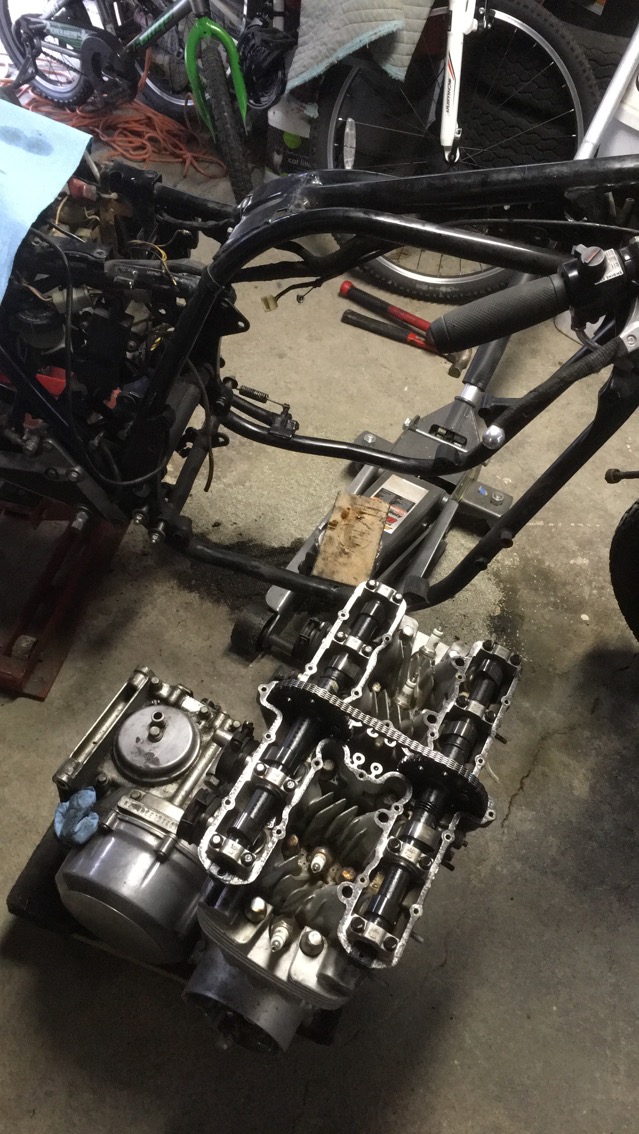

Couple more hours in the garage today... Got the motor off the bike:
Stopped by napa to get some feeler gauges so I could check the valve clearance before I pull off the Cam Chain. I know there is a alignment process with the cam... Is there anything I should take pictures of or take note of before I take the chain off or is that just something I have to do on the way back together?
Also, this is my scratch list of things I will need... if anyone knows something I ought to get that will save me heart ache please let me know!!
Another question I have is since I'm going thru all the trouble should I replace that starter clutch while I'm here? I don't think I have had any problems however sometimes when I hold the start button nothing will happen for 20-30 seconds or I'll have to tap it a couple times before it will engage.. not sure if that's related or some sort of electrical gremlin. One of the reasons I'm tearing this down to add that kickstarter... I'd still like the push button to function tho.

There are threads here on how to retrofit a kickstarter into a 750 bottom end. Seems like a lot of needless tinkering to me though.
Any time the cylinder head is removed you should also remove the cylinders and replace all the various O-rings as well as the base gasket. Kawasaki does not sell gasket kits, other than some aftermarket kits they relabeled back in the day. If you come across one of these kits stay away. These gaskets were junky and now that they have aged 35 years they are really junky now. Your best bet for gaskets and seals are OEM Kawasaki. Aftermarket gaskets range from passable quality to downright criminally poor quality. It's not worth the time and effort to use subgrade parts when working on your engine.
