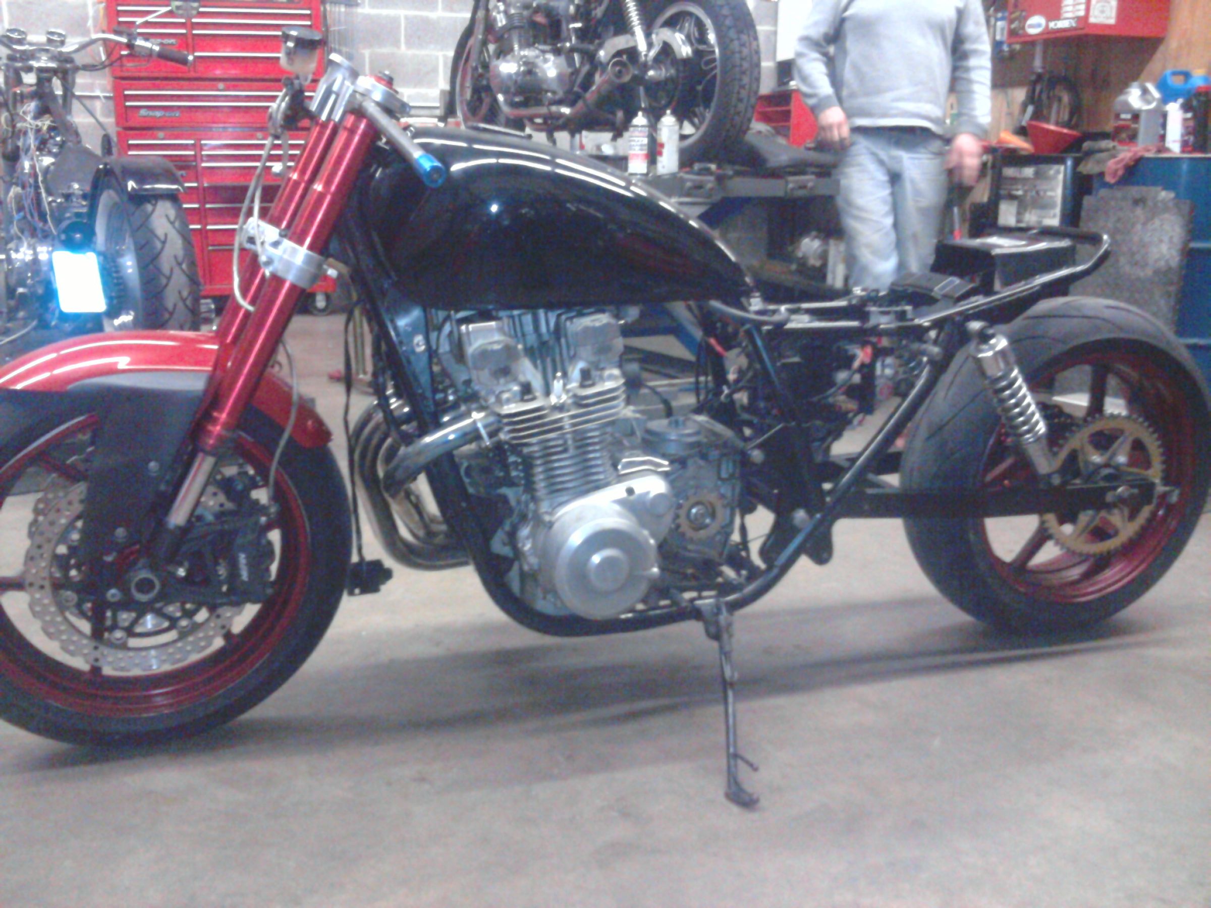

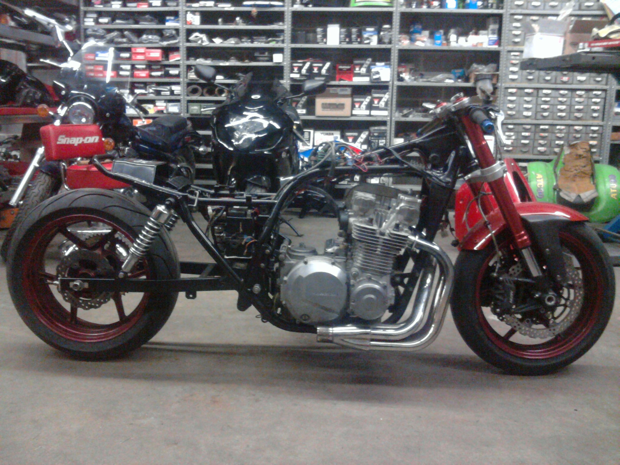

here is an old members bike i helped him convert.
this is using a zx636 front end.
the zrx swinger can work with some mods .

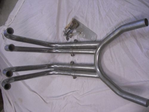

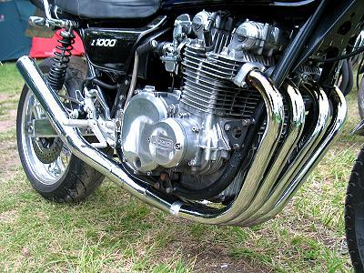

thanks for the kind words man.the sidewinder in the pic has ground clearance but hinders right hand cornering clearance.you have to slow down slow enough not to touch it down or it will punt you out into the bean fields(ask lesholt).
imho the marving 4 into 1 offers the best ground clearance.
exactrep.com/acatalog/Kawasaki2.html
i've always kept this pic around thinking i might try this design if i wanted dual outlets on a custom.
