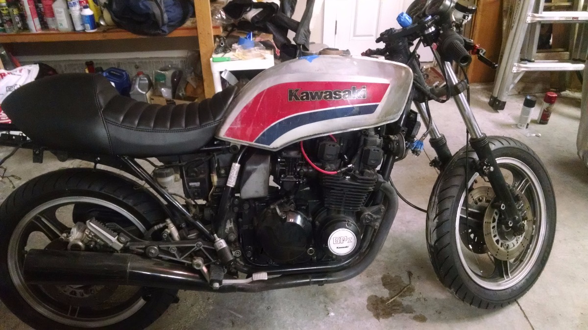

This the good news post:
She LIVES!!! finally fired it up after total carb rebuild new plugs, wires, cleaned and replaced airbox, installed fresh rubber (Avons, as recommended here)
Once we used an 'IV' for fuel and it fired right up! very exciting. a little adjustment to the idle/mixture know and it sounds and revs fantastic!
Also got the seat installed, new sprockets, chain. Picture;
I think it looks amazing already!
Still to do, finish front caliper rebuild, Install SS front brake lines, install headlight, install taillight. then... figure out what to do with the tail section.
then... there is the tank..
-Lee
