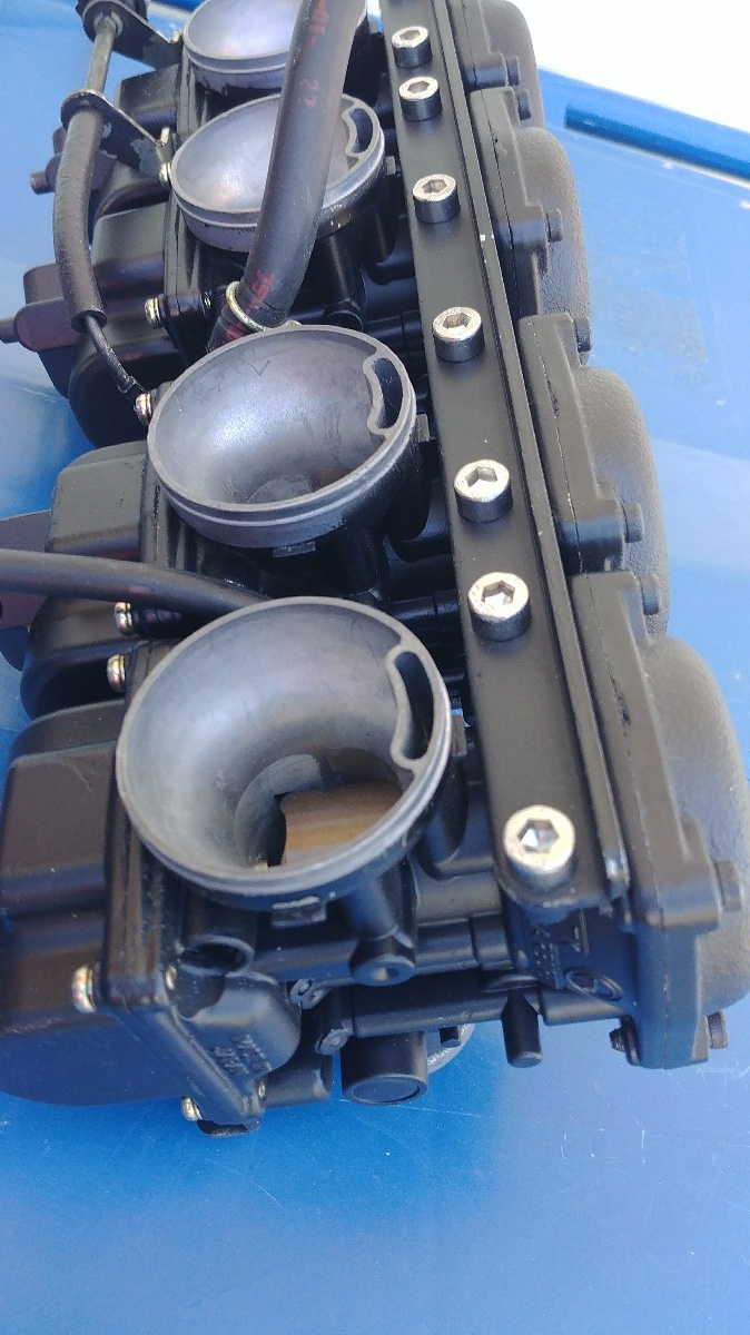

Carbs cleaned up, ready for re-assembly
Several parts on the way - 4 rebuild kits (mostly for the float needles), float bowl gaskets, all new bolts with hex head, lots of misc O-rings.

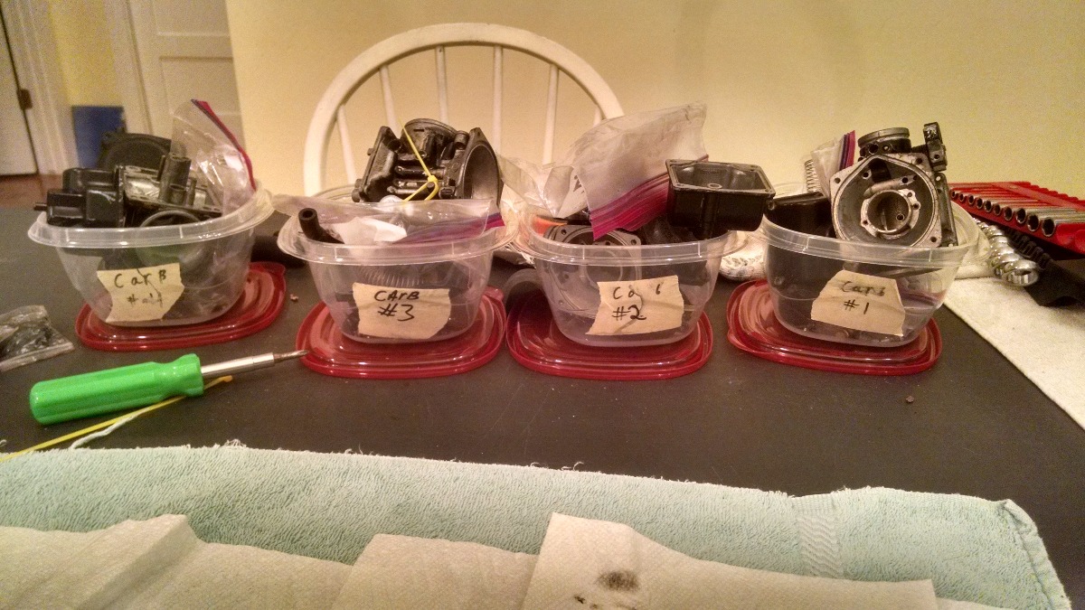

Carbs rebuild and waiting for assembly;

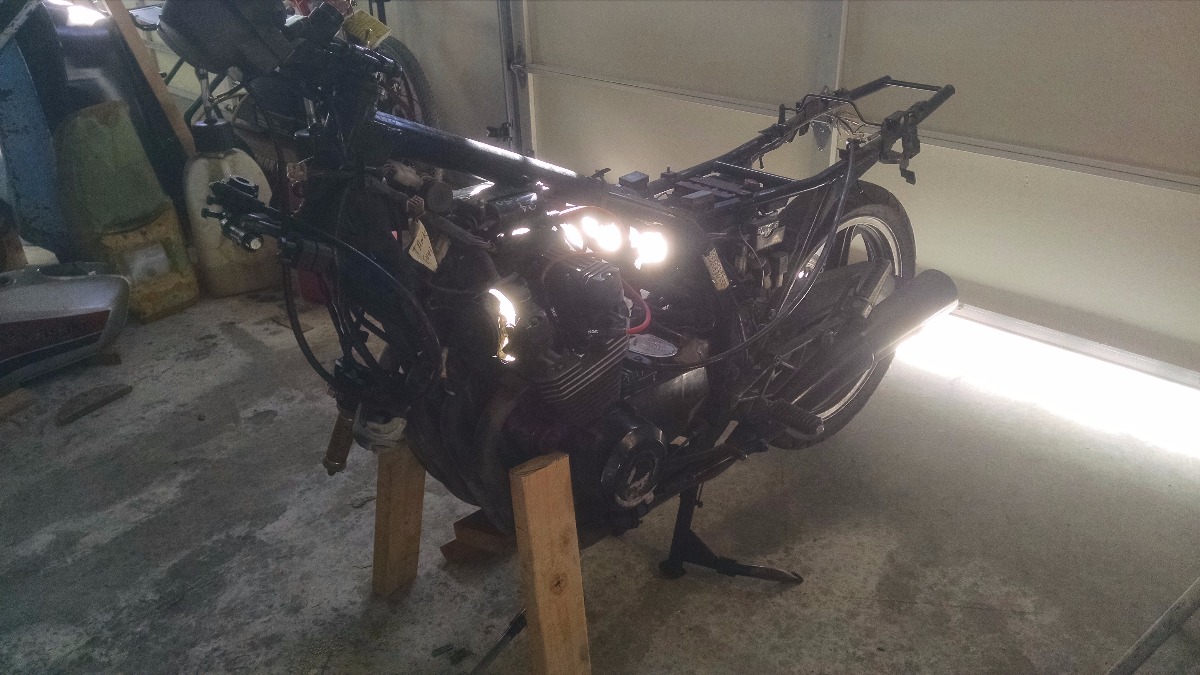

Bike 'waiting' for me to get moving;

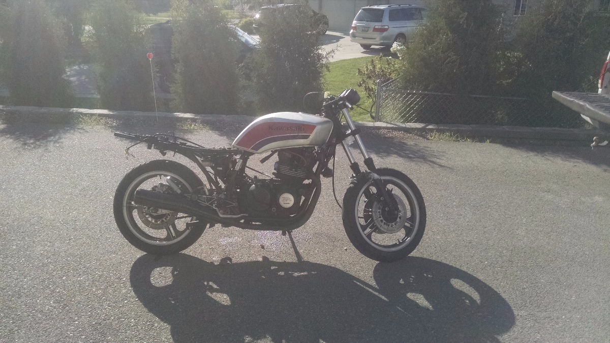

As it currently sits (clip ons installed);
